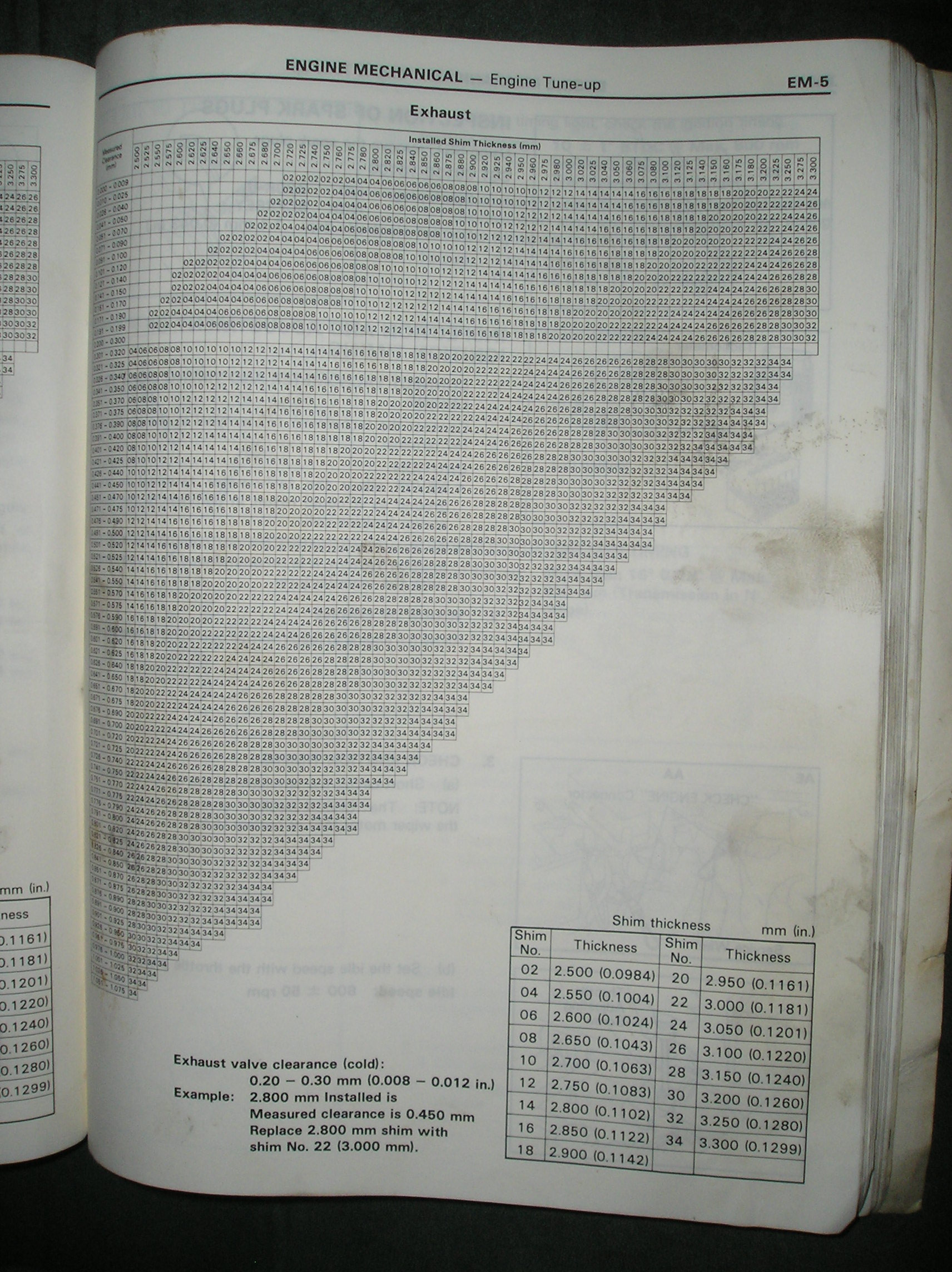

those shims bring back nightmares of the feeler gauge...!
The proper table recomended to be used is no less a nightmare.

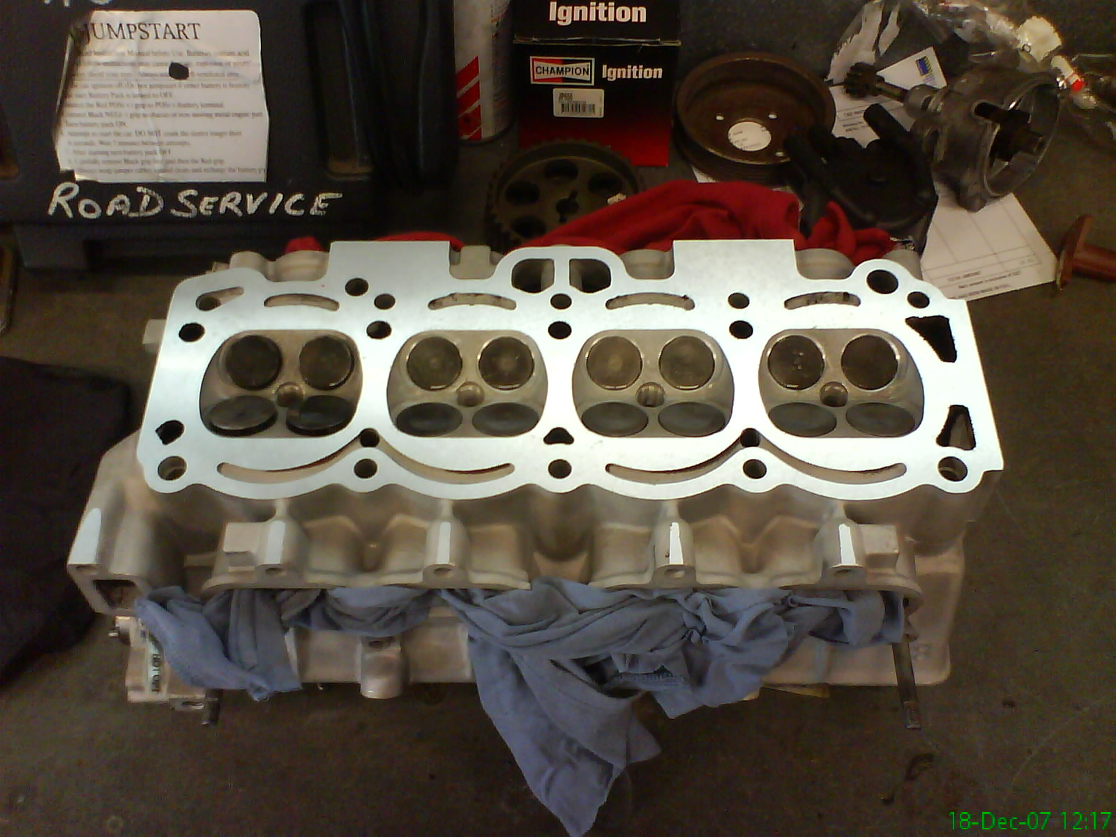

Got the head back from UMR engine's today.
Cost me $640 for the rebuild and i couldn't be happier with their work.
That looks yummy :o
