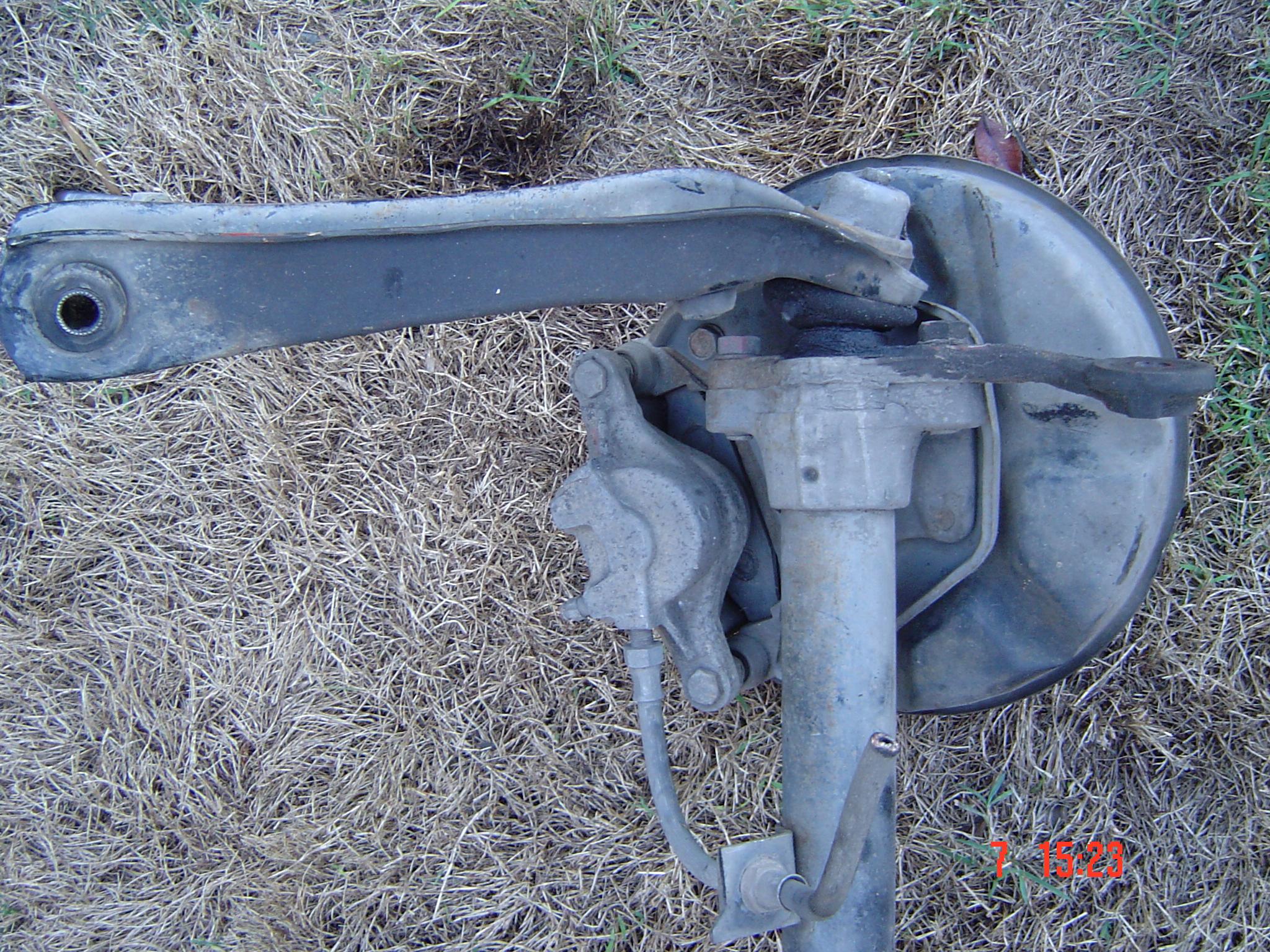

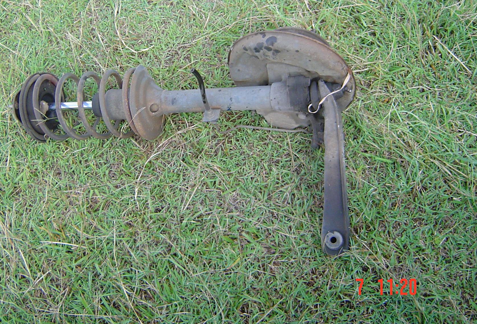

Strut & accessories about to come out. Note to self - Wheres the 7XX size MOFO hammer when you need it...

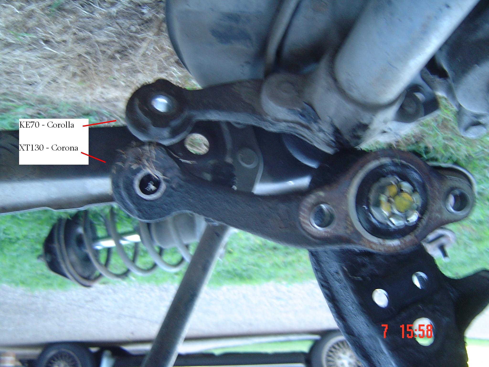

controle arms (crap photo)
Edit - Top arm is Ke70
Bottom arm is XT130
Edited by Teddy
Bottom arm is XT130
they're steering arms. the control arm is the thing attached to the ball joint in the above photo. bigger steering arms makes your steering slower :P
Might chuck the Ae71 steering arms in then

i think you'll find xt130 struts don't fit on ke70 steering arms. they do fit on te71 and ae86 (which have short power steerings arms, you want these) os maybe ae71. let us know :P measure them c-to-c and tell us how long they are. check this page out for options
http://www.toycrazy.net/tech/struts.html
Edited by Super Jamie
