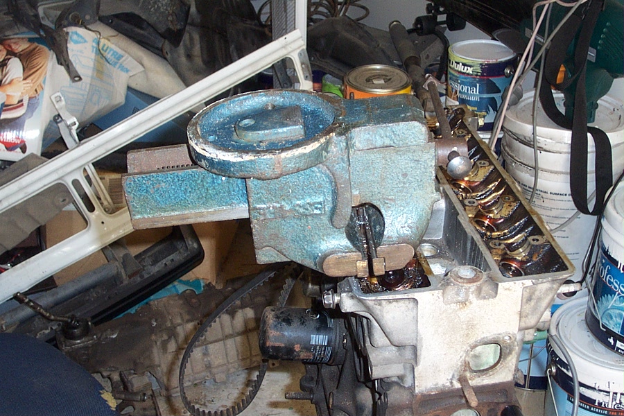

after going through so much to the the gze out, a 10mm cam bearing bolt decided to thread stopping the cam shaft from coming out :D
any body know any ways to get it off?
10mm bolt has descided to thread the head to a round shape. Need to get it out. Gah.
Bolt is well stuck in the thread. Vice grips are our next try..
yup - the bolt isnt a bolt any more, its like a round cube, 40% smaller. Screw driver method doesnt work, shes too stuck atm. Hopefully drenching in RP30 will work its majic :D
drill a hole through the head, like u would if u wanted a split pin, then put some 2-3MM spring wire through it, and twist like a jar of jam.
i suggested that to jason, but he doesnt have anything apporaite to turn the bolt without it breaking / let alone a drill piece that will go through the size of the bolt we are getting out. Great idea in theory tho!
the bolt is less that 5mm across
if you can find a metal around the home that can withstand the force of seized nuts, and less than 2mm in diameter let me here it
got it off :D
Pics from on stand to head off :D
thanks to mr bench vice, and street pole for helping getting bolts off ;)

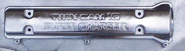

I was bord on my day off from swimming carnival so i painted the rocker covers, something differant.
Edited by Jason
