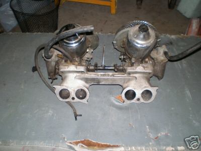

I have just purchased a set of twin inch and a half su's on a manifold of ebay and i would like to know any particular tricks or information about setting them up.
I have messed around with different jet sizes on webers but i have never had and expeience with su's or any twin carbys for that matter.
Any help would be greatly appreciated.
For the moment they will be going on a stocka 3k (i know its overkill but i love the noise) but they will be going on a tuff cammed 4k that I'm in the process of building now.
here is a pick of the pair. i know they look dirty but they will be getting a rebuild before fitment.
Cheers
Mattew

i got them of ebay for a pricely sum of $77.76 on the manifold. I just finished rebuilding them myself today and they have come up sweet. Rebuild kits cost me about 50 each with new oversized throttle shafts. Just have to rework the linkage setup and ill put them on.

Ive been in sydney for a week so havent had time to play. I was wondering how people got the throttle cable to work properly as the linkages were crap and didnt come with that part.
Any ideas?
Photos?
Cheers
matthew
ah the problem with that is the su's work the oposit way to the asian.
