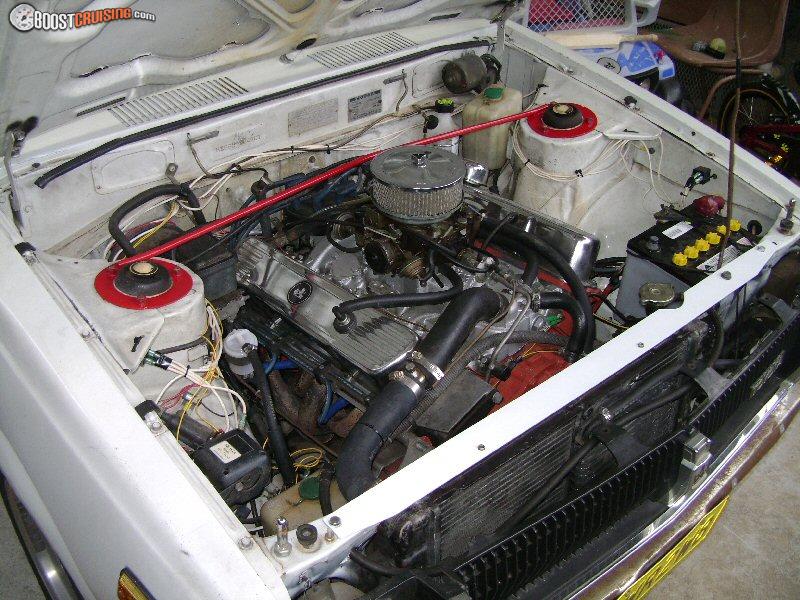

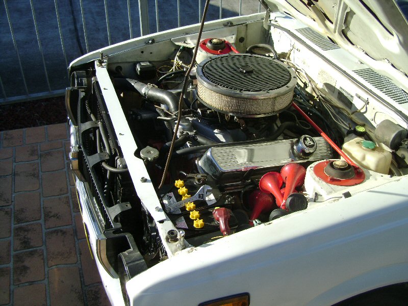

Ke55 V8 Sedan
1980 Toyota Corolla KE55 4 Door Sedan (White)
Cooling System: VN-VR V8 3 core Radiator, 10" electric fan (on relay & switch), short-type kingswood water pump.
Engine: V8 308ci Holden VK Commodore Black Block (stock and recoed).
Exhaust: Genie Extractors (slightly modified to fit in corolla engine bay, 2.25" pipe midway to two GEN III VY Commodore
Mufflers.
Transmission: V8 Commodore Tri-matic and stock converter, Nissan Auto Cooler.
Tailshaft: V8 Kingswood Ute Single-piece tailshaft shortened to fit corolla.
Differential: V8 Commodore Salisbury Limitted Slip Diff 2.6:1 Ratio (Disc-to-Disc) and shortened housing to fit corolla, VZ
Commodore one-tonner axles shortened and resplined (28 spline) to fit custom housing.
Front Brakes: Standard KE55 discs and calipers (for now).
Rear Brakes: VN Commodore discs and calipers.

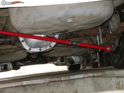

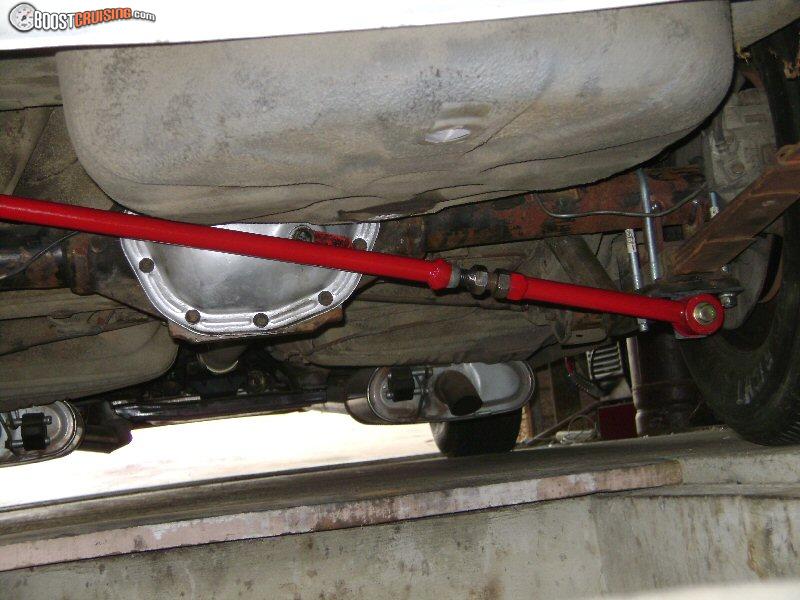

Suspension: Standard KE55 corolla suspension (for now) with adjustable commodore panhard rod fitted to diff.
Fuel System: KE55 Tank and Lines, Rochester 4 barrel carb with fuel reg and return line, V8 mechanical pump.
Ignition: Hei competition leads and brackets, Hei Bosch coil, Hei V8 Dizzy, V8 Kingswood alternator.

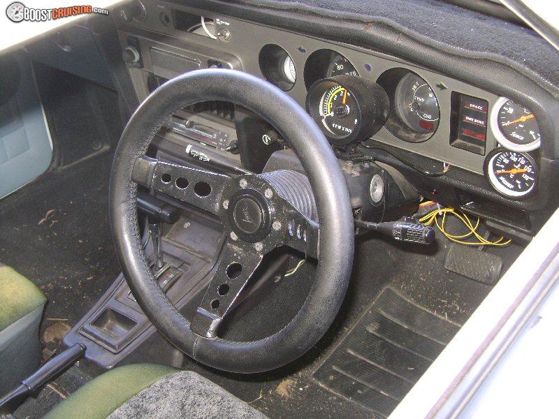

Extras: Bolt-in rollcage with protective foam, sports steering wheel with boss kit, standard 3 speed KE55 corolla shifter
with modified linkage to suit V8 tri-matic, relays for starter motor (button on dash to start engine) and electric fan

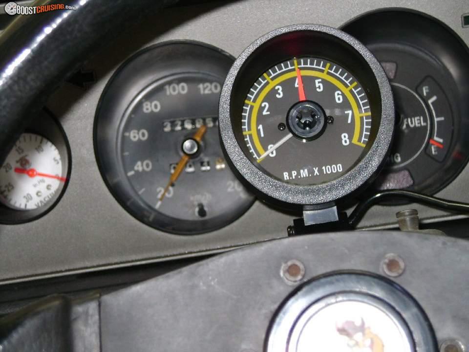

(switchable on dash), Speco engine temp guage and oil pressure (hydraulic) guage, 4" Tacho, VH commodore Spedometer guage in
dash with vh commodore speedo cable and trans cog to suit diff ratio and rear wheel size for calibration, vacuum manifold pressure guage.
Edited by clubgm

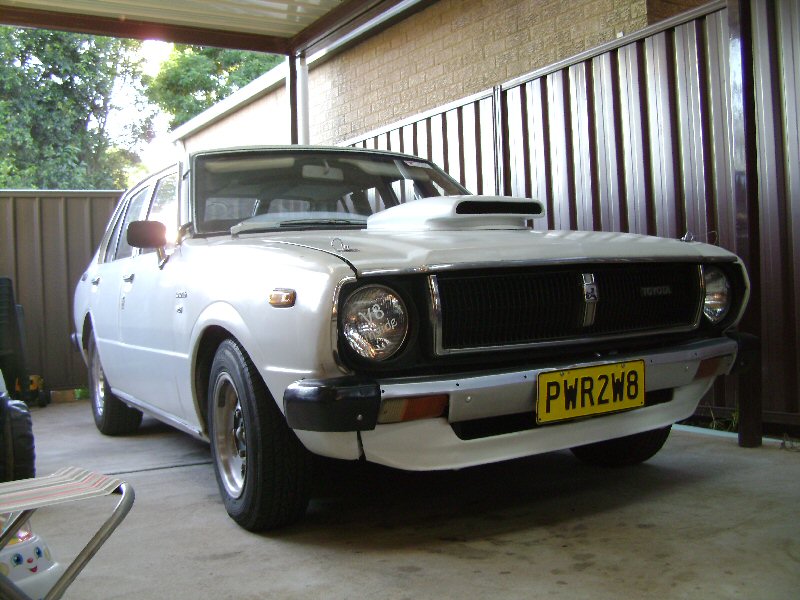

Looks hot. Much work needed to firewall?
Edited by SLO83
I have one of those tacho's for my KE25....how accurate do you find yours?
have not really tested accuracy of the tacho yet, but i did just check the speedo calibration... dead on to my surprise....
did u need to cut the fire wall?
very so slightly for the v8 trimatic bellhousing. we welded a new pice of plate in place once we got the clearance.
very small amount of cutting out in trans tunnel for v8 trimatic bellhousing.
pretty good actually. but i haven't tested it past 4000rpm yet. still waiting for some track time and money.
