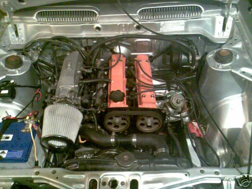

this is a pic i have on my computer. i'll take some pics with more detail of the master cylinder later. you can just see the remote reserviours if you look closely.
basically you can mount the booster anywhere, i just put it where the battery used to be.

engine bay looks a lot tidier these days.

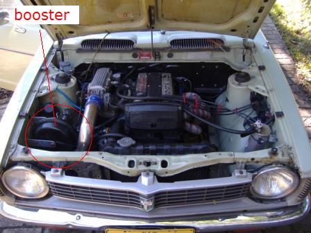

Plus here is a pic of a remote booster setup I found - booster can basically be fitted anywhere there is room.
I am planning to put my remote booster under the front guard if there is no room in the engine bay...
