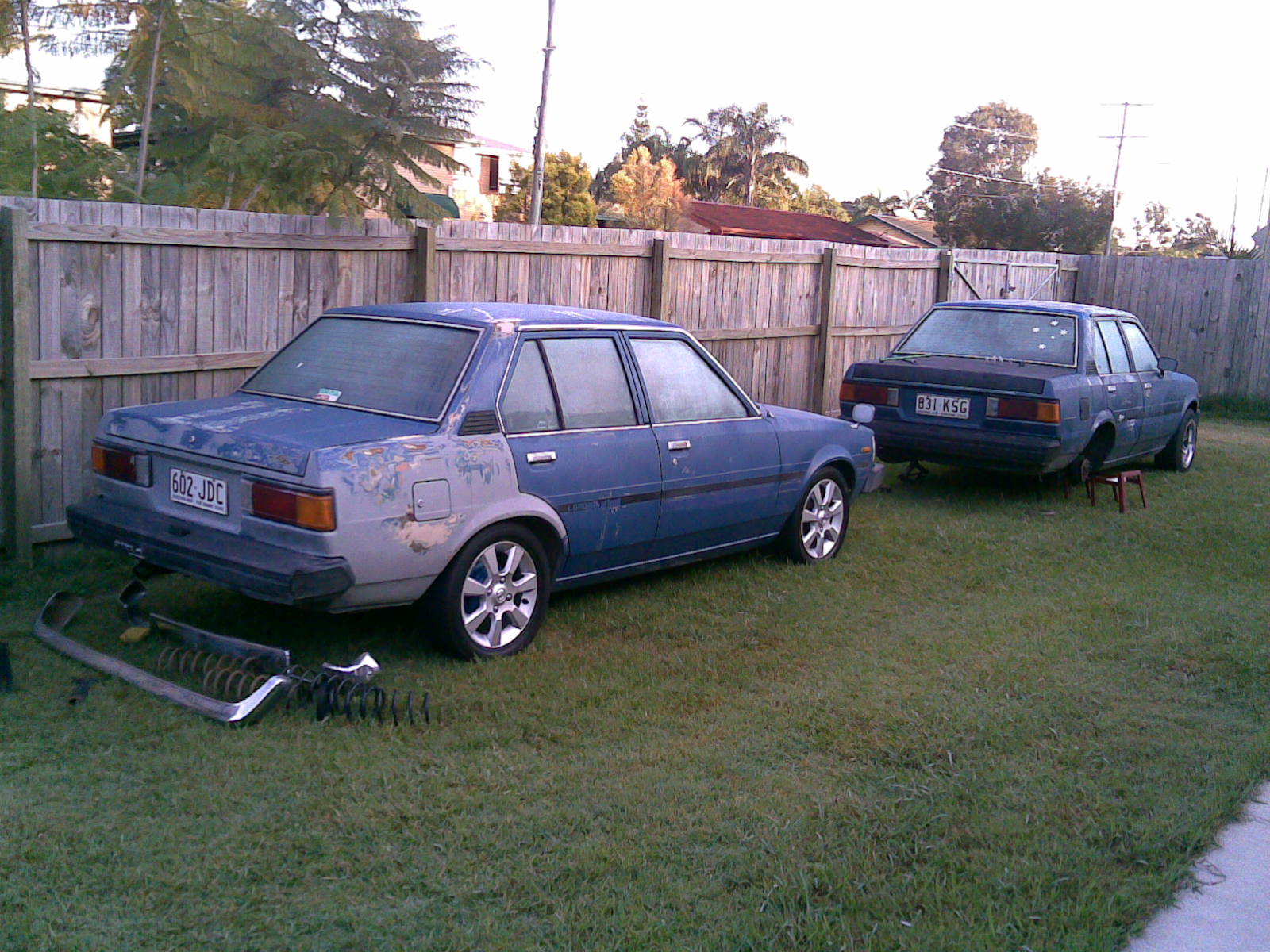

I was just wondering if anyone has had a go at fitting steel wheels from other cars such as a U12 Pintara. They have 14x5.5 P45.
I have had a go at fitting them to my KE70 and it seems like they will work well (a little tight around the strut without the spacer). Just need 195/55 R14 instead of the lager 195/65 R14 Pintara tyres.
The front will need a 5/10mm spacer to clear the Hilux brakes and get it a fraction further away from the struts.
The rear seems to fit perfectly.
I've run out of options for wheels so I figure this might be a good direction. Even some of the Hyundai wheels look as though they might fit.
Its either this or really wait and get a set of the "cheap" $600 alloys from Bob Jane. Another thought was S13 alloys?
