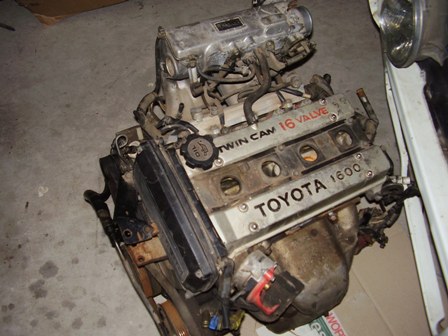

Say hello to my little friend
I picked it up yesterday and stripped the gearbox, a/c and starter off to be able to lift it off my ute
Man those 4age's weigh more than a 3k - one heavy mother f#%ker, me and the old man lifted it down to its current resting place
It needs a good clean up and the usual FWD to RWD mods but she cranks over nice & smooth and i realised that i have the 7 rib block so i'm pretty happy about that one
OMG!! Who would have thought, heavier than a 3K!! lOl
Yeah i kinda figured it would be heavier but last time me and another bloke lifted a 3k & gearbox in one and this time i had to strip all the stuff off it and it was still heavier
I guess i was just surprised by how much difference there was - I wasn't going for the captain obvious award :D
