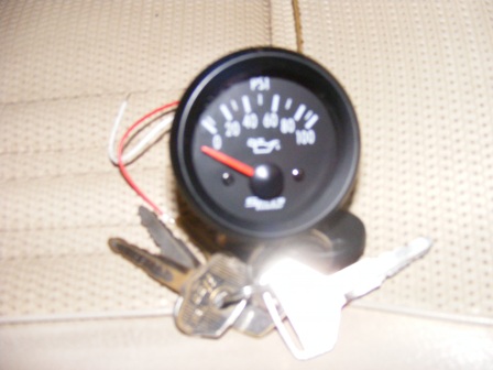

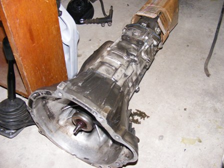

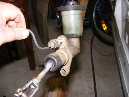

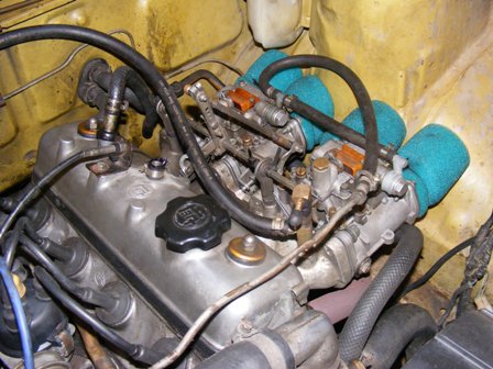

Just thought i would post up a few pics and small update of progress
Pic of my engine bay currently
Got some goodies
T50 gearbox
Slave cylinder setup off ae71

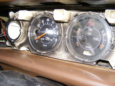

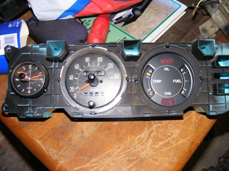

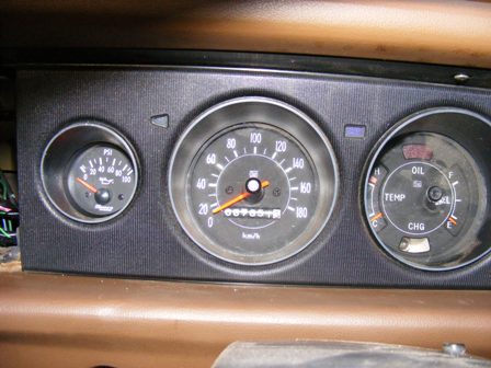

Oil pressure gauge
Now fitted into dash

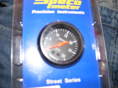

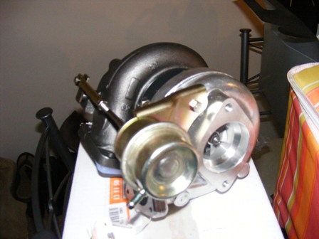

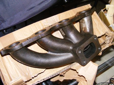

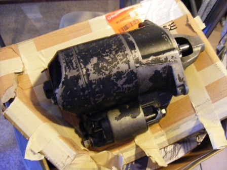

Finally some new goodies arrived after some long waiting
My new (second hand) RWD starter motor
My new Boost gauge
My new cast turbo manifold
And my personal favourite, My new T25/T28 turbocharger ;)
Now all i need to do is get the damn engine in the car and attach all the aftermarket goodness ;)

;) good luck with that one mate! :dance:
Maybe try and get yourself a cheap t25 or 25g as a spare!!!! ;)
What's wrong with the one i got?
