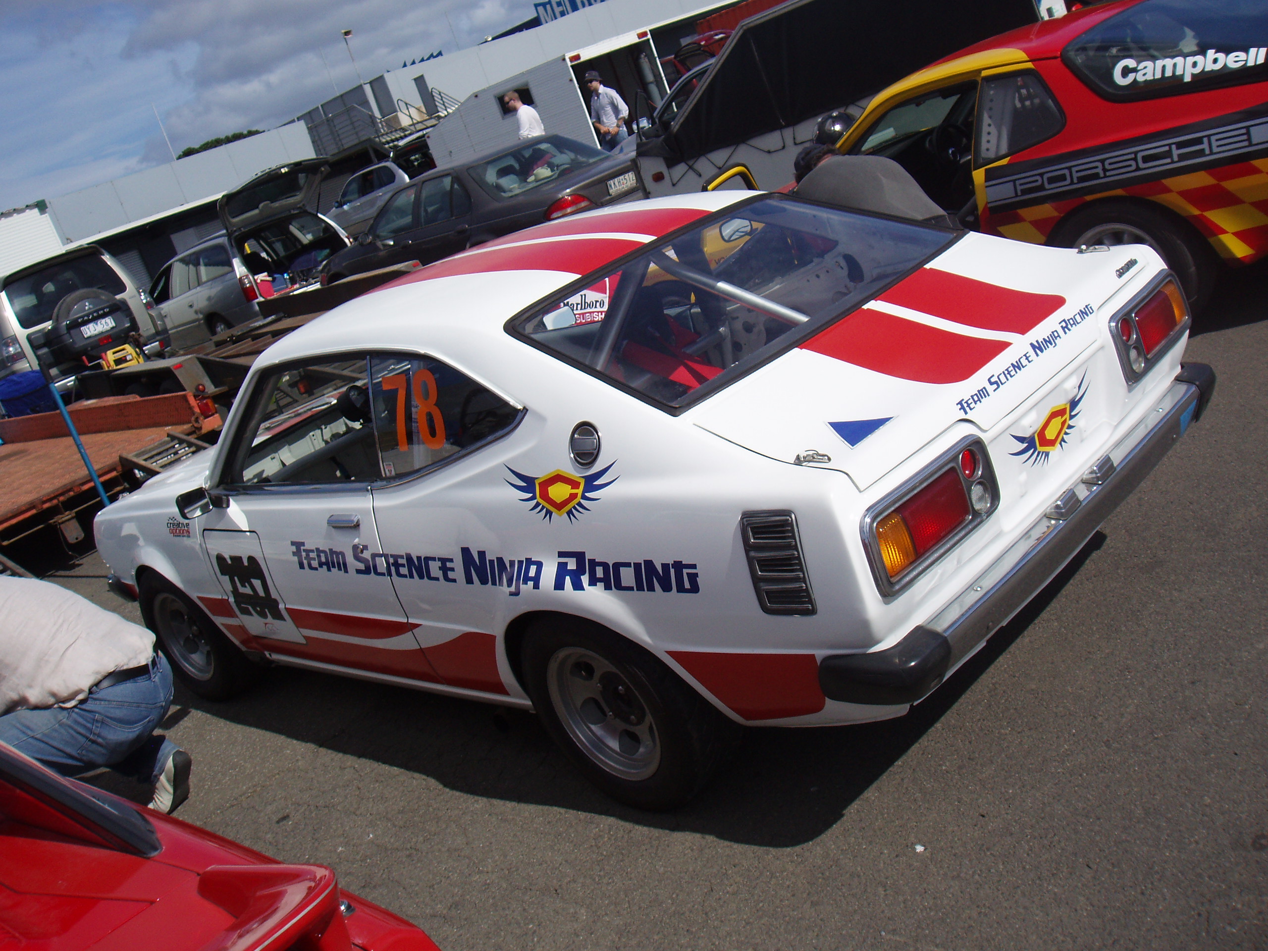

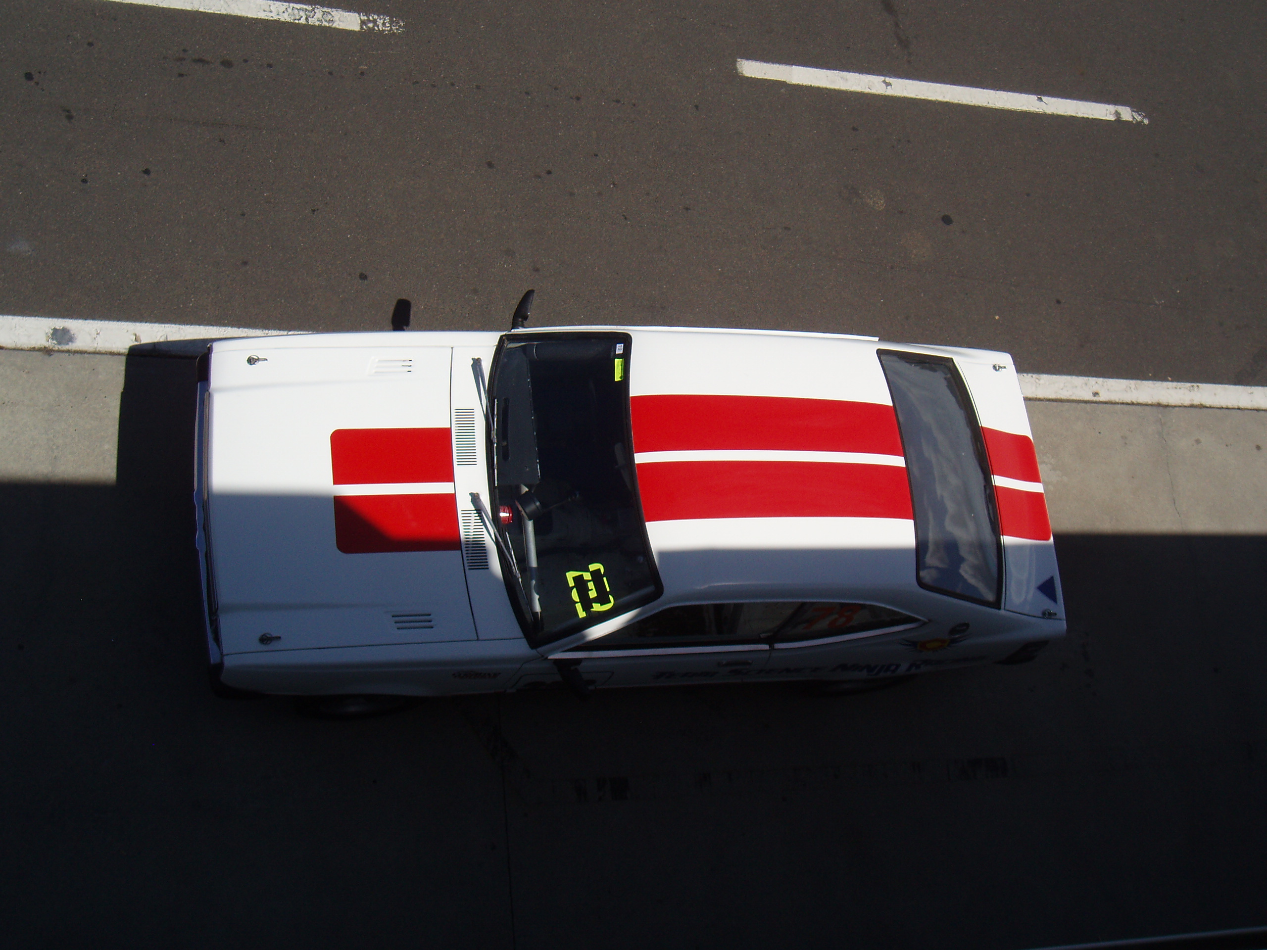

Here are a couple of pics from the day. Need a bigger zoom!
Got faster as the day went on - first session i did a very slow 2.12.4, my fourth session I did a 2.07.6 - still got plenty of time in me still too.
No dramas for me which was great. Can't say the same for a guy in an Evo road car who put it on its lid and wrote it off...poor bugger.
