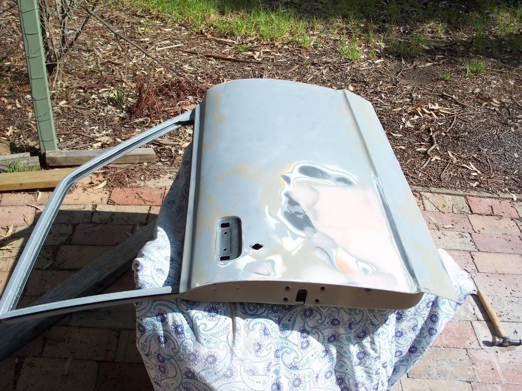

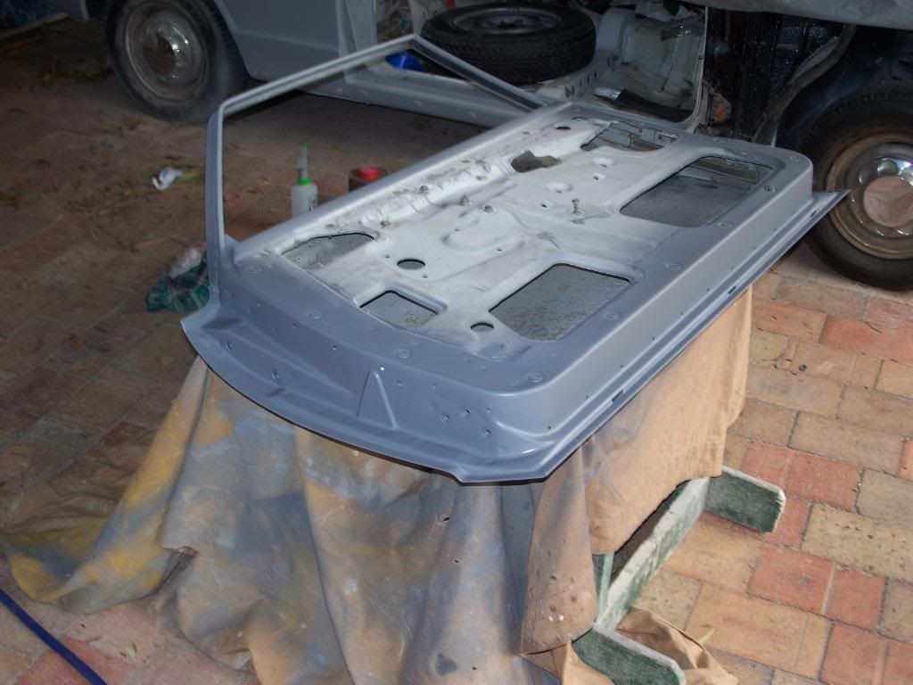

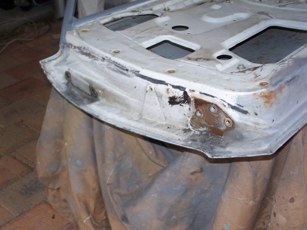

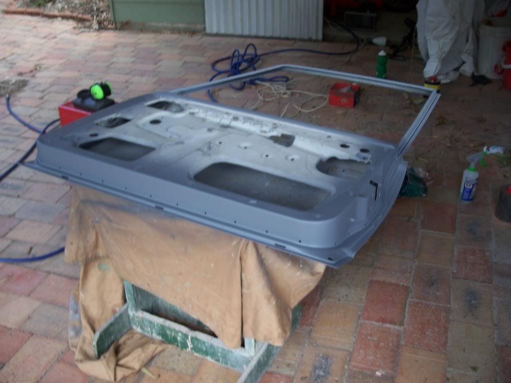

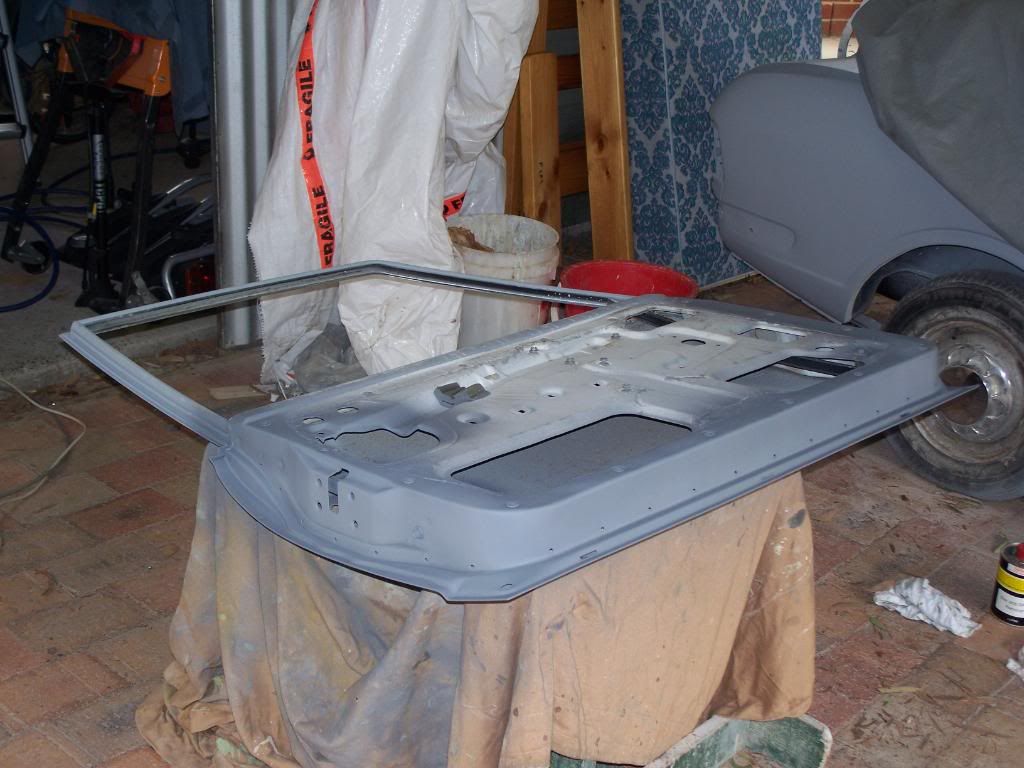

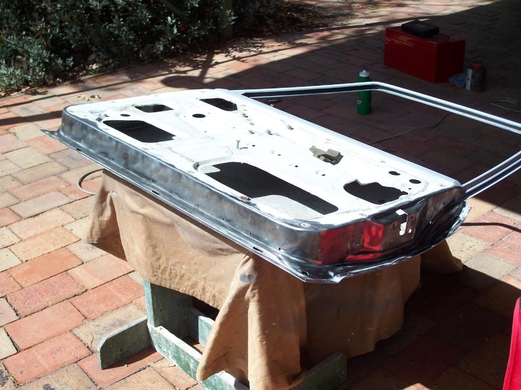

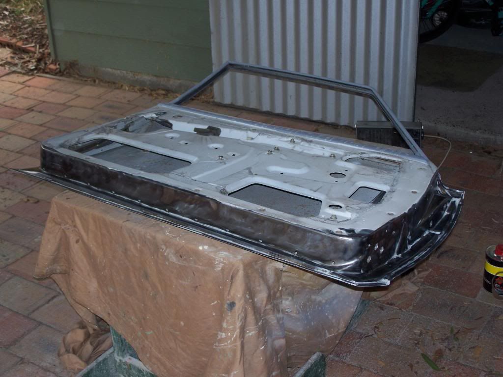

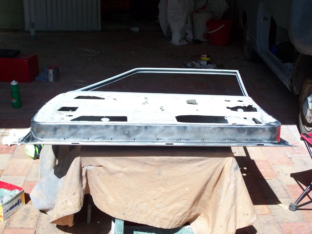

Doogs Posted March 9, 2010 Author Report Posted March 9, 2010 Here are some pics from todays efforts. I finished baremetalling the base and sides of the doors, treated the rust and hit it with a lick of etch primer. Quote

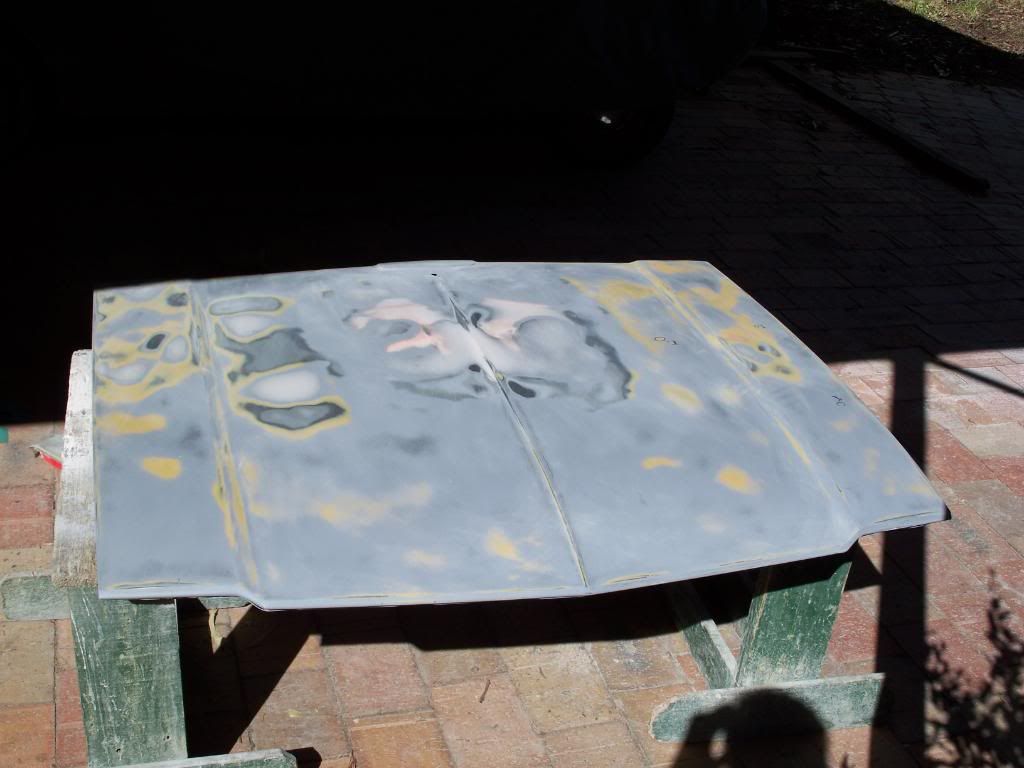

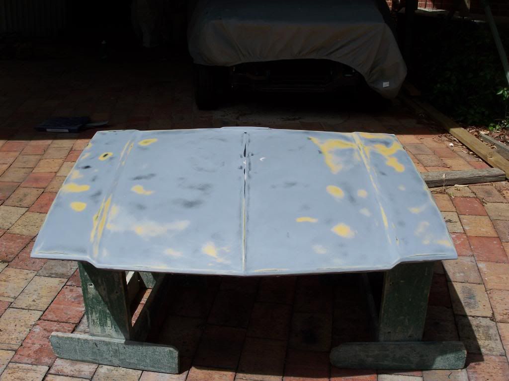

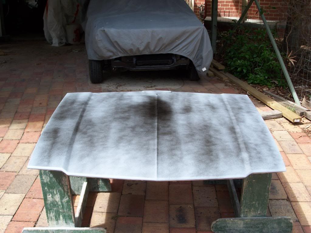

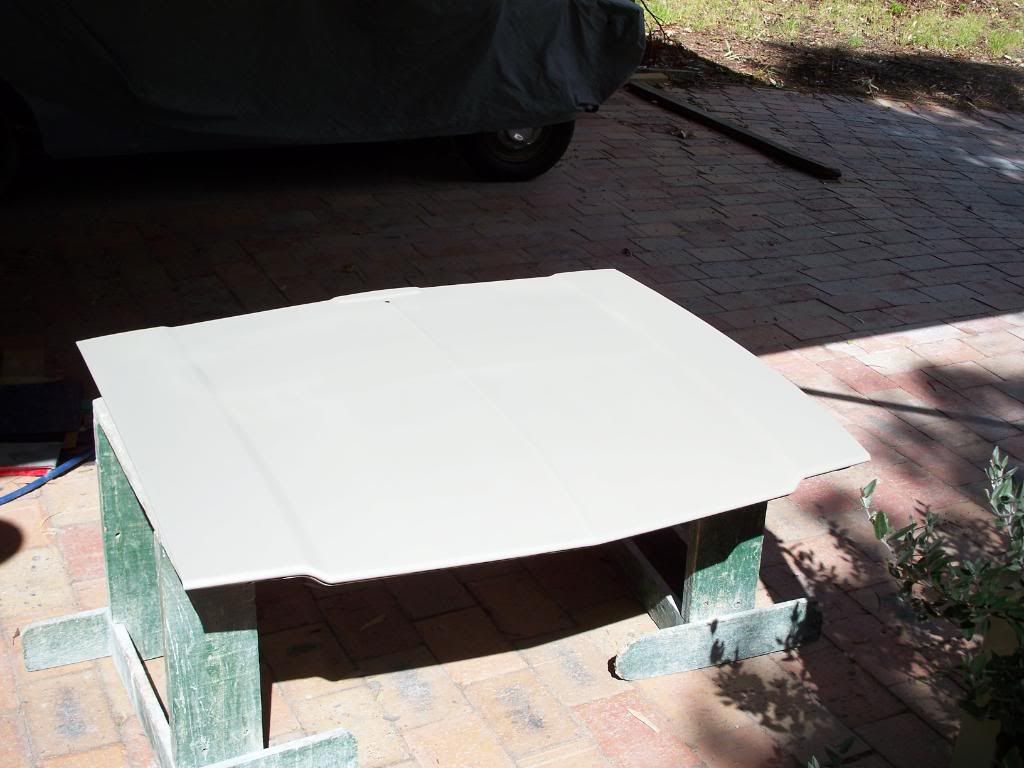

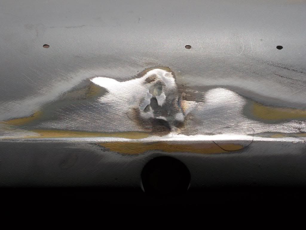

Doogs Posted March 11, 2010 Author Report Posted March 11, 2010 Here are some pics from more work on the bonnet; Guidecoat: Rubbed back: Filled: Highfill: I'm still not happy with the repair on the centreline of the bonnet, this has proved to be quite tricky to repair. I will leave this for a bit and think about what I'm going to do about it. In the mean time, there is plenty more to do ! Quote
78_7kRolla Posted March 11, 2010 Report Posted March 11, 2010 loving your work mate. As for the tricky bit on the bonnet if it is bothering you now then it will increasingly bother you more and more when it's painted. Just from my experiance :no2: great to see you making more and more progress all the time. keep going champ! Quote
Doogs Posted March 11, 2010 Author Report Posted March 11, 2010 loving your work mate. As for the tricky bit on the bonnet if it is bothering you now then it will increasingly bother you more and more when it's painted. Just from my experiance :no2: great to see you making more and more progress all the time. keep going champ! Thanks Matt. Yeah that's why I'm trying to just keep plugging away. There are still a few imperfections in the body that annoy me, and I'm sure it will just get worse with time. I find that when I'm really sick of working on one area and feel like I'm going nowhere, it's good just to give it a break and move onto another panel. Will see what I can acheive next week (got a call today to say the operation will be next Saturday). Quote
Johno Posted March 11, 2010 Report Posted March 11, 2010 Nice work there mate, I had a few problems with the ridge on my bonnet too. I tried filling at about 6 times before giving up and just painting the dam thing. I know it's going to piss me off when the bonnet goes back on and see that dent still there. Just keep trying and you'll be glad you went to the extra effort of doing it properly :no2: Quote

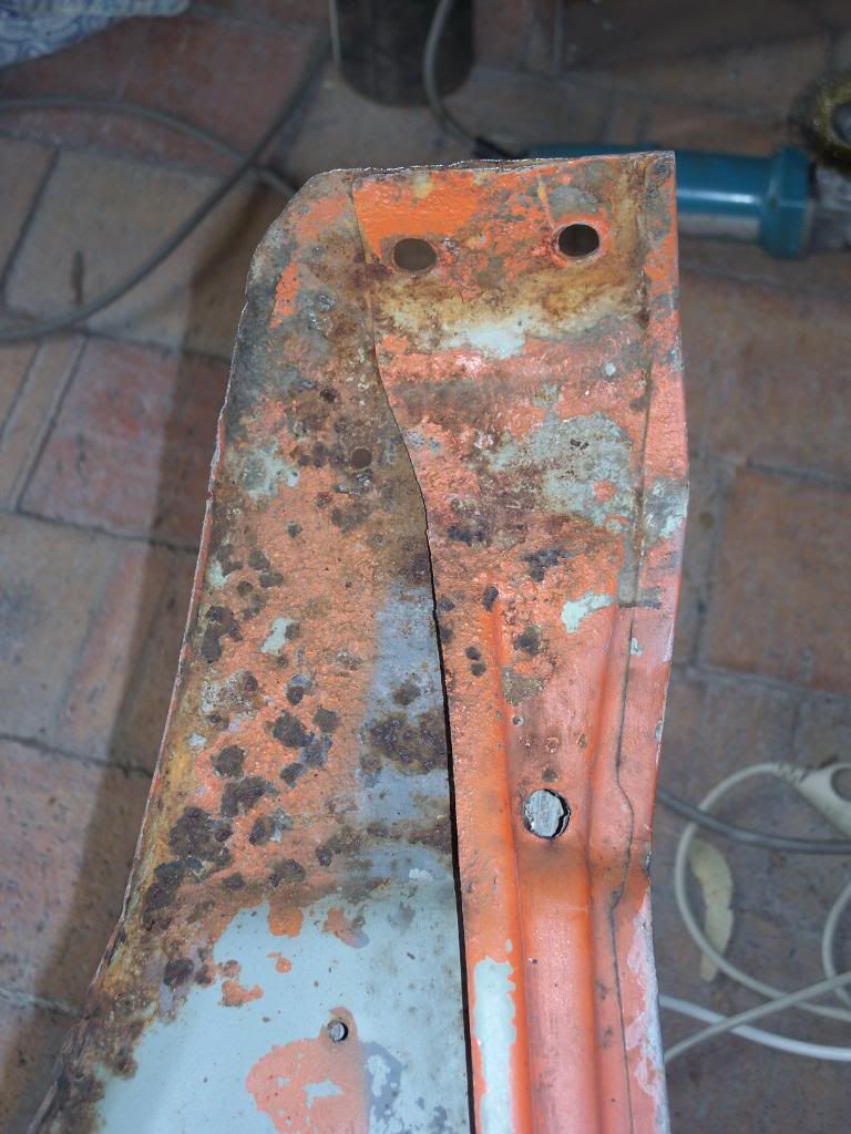

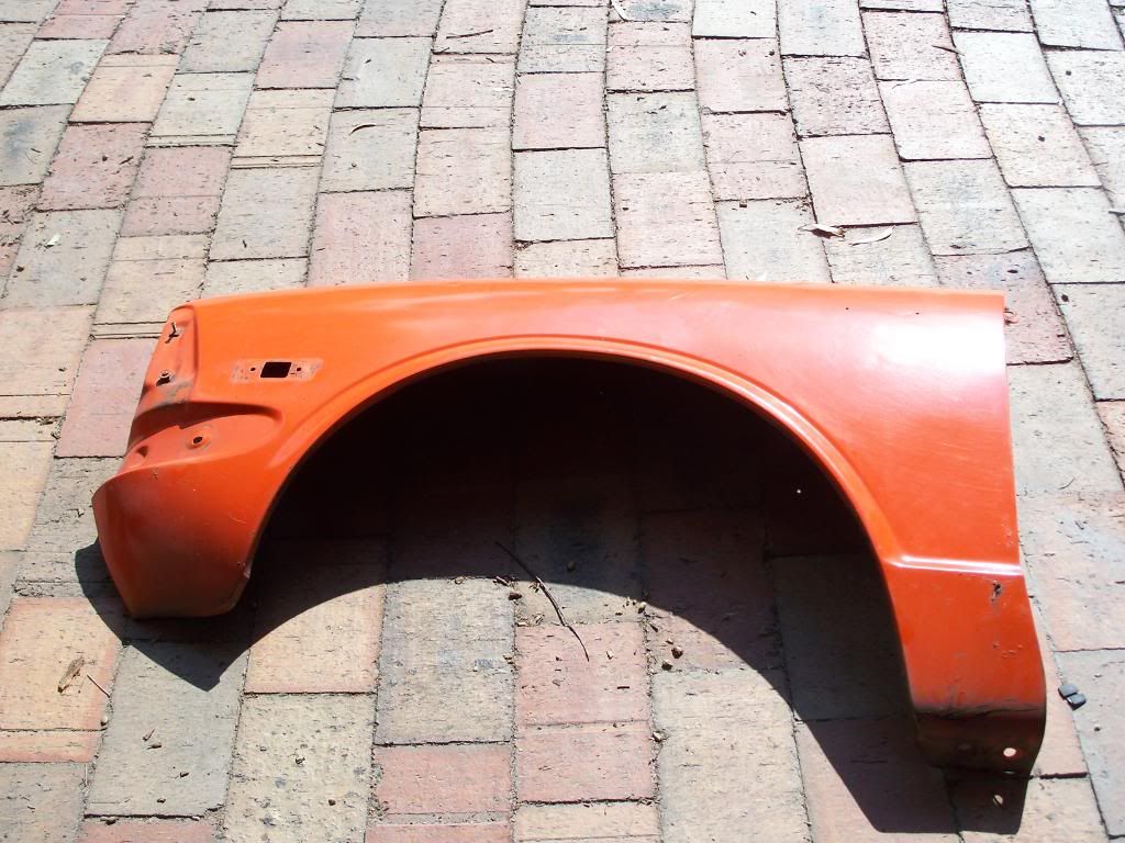

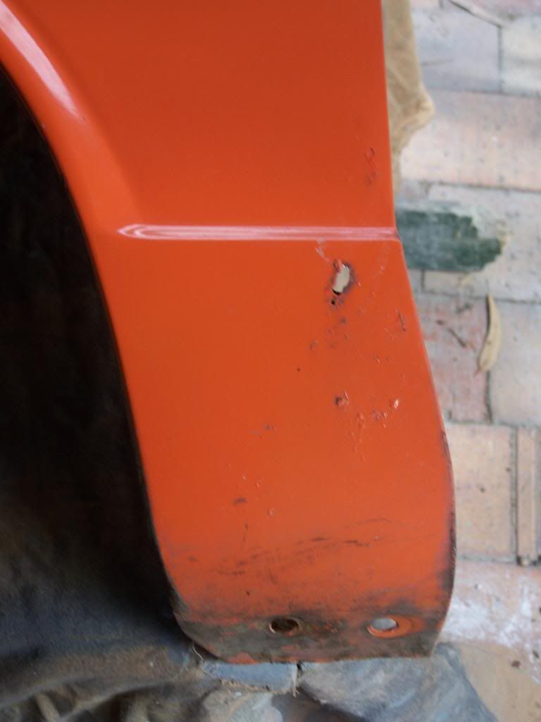

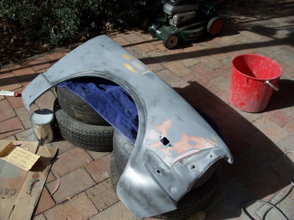

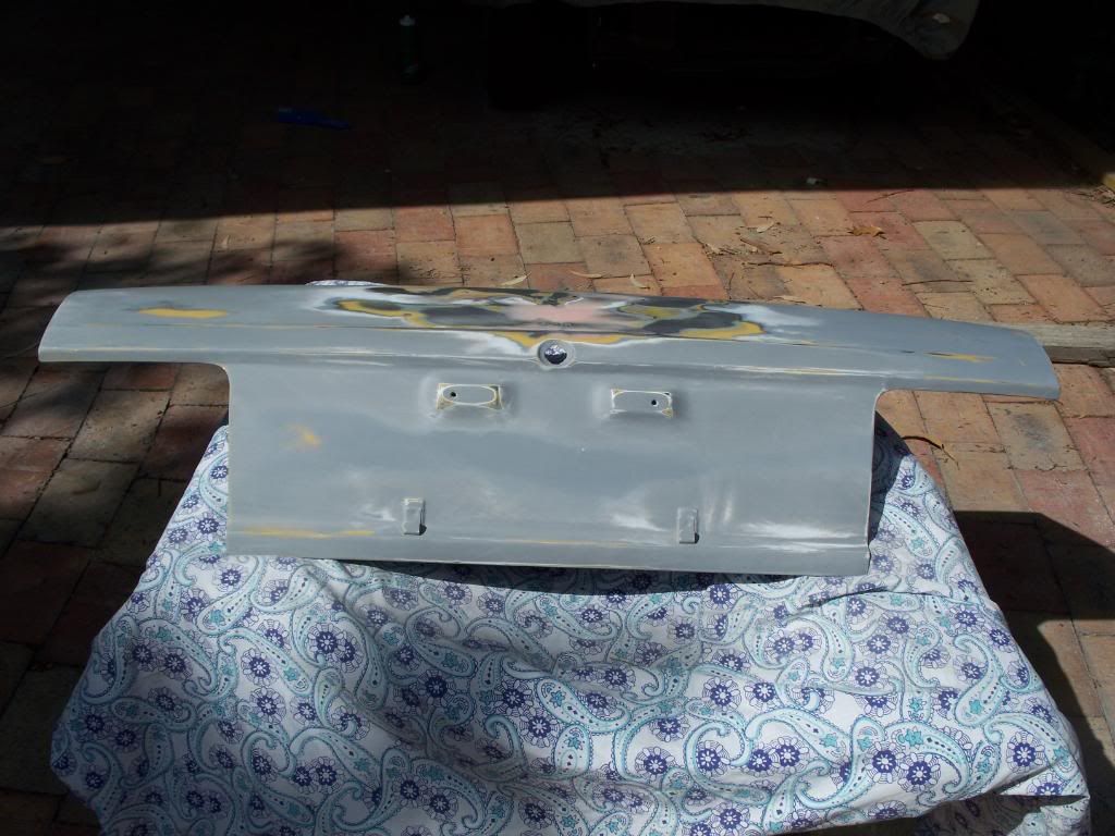

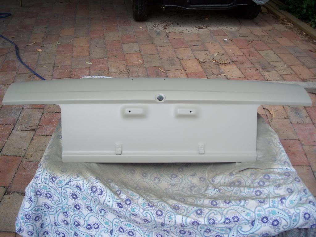

Doogs Posted April 6, 2010 Author Report Posted April 6, 2010 Hey guys, Here are a few pics from recent efforts; I shrunk a few areas round at a mates place and then filled and highfilled the doors, right gaurd and bootlid. They will all need a rub back and another coat (Pics soon). Thanks to the Vic wreckers thread I manged to pickup another left gaurd so I have begun stripping it and will weld it at a mates work tomorrow. Cheers, Dougal Quote
