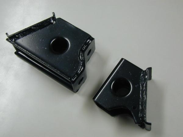

are those mounst fully soild with no rubber dampers at all?

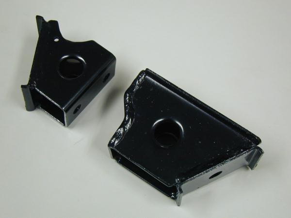

this is really sng do draw atention to you la ay. so tell me a little more about these engine mounts.
are these the ones il need to coppy?
do they use a rubber on it?
why is one differant to the other?
my plan was to make total custom mounts left and right and keep the engine as low as posible but 1/2" gap between the sump and the brace under it so as i don't damage something under reving upand down. my mounts will be simple and adgustable, just a little...
if you look at the original mounts they're different anyway, the drivers side mount has a flat mount to block surface and the passenger side has the bottom mount boss further out than the top mount boss. as Medicine Man said above theres a rubber block thats bloted between the engine mount and the mount on the cross member.
