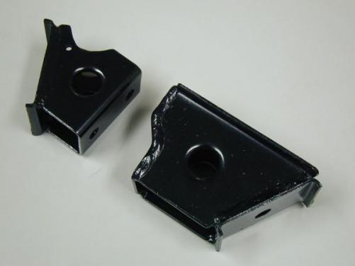

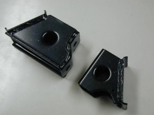

:D If all this does go as planed for me I was thinking of making a bunch of these kits witch would includ the 2 engine mounts that will bolt on to the cross member + rubbers and a full gearbox cross member with a 30 degree slant for the gearbox.
MY DESIGN IS ONLY BASED ON A KE55, K50 STOCK GEARBOX!!!
These parts will be all cleaned up and painted in matt black or gloss black. :P:
Stand up and be counted if you would be interested in these parts just for an idea of interest. :)
A price wont be decided untill i can gather all the info on the cost of steel, rubber, second hand and re-enforced cross member, other materials and the complicity of the build (labor). The price wont be too hi... :)
