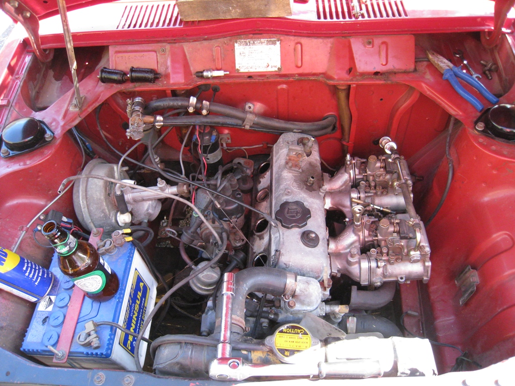

Anyway after measuring up my engine bay, I reckon Ramflos with the offset will be the easiest fit for my twin DHLAs, but I wanted to see what people think?

philby, would you mind posting up pics of how much room you have with the twins sans trumpets/filters.
i'm nearing making a decision on what to buy for my twins. they're on a very short manifold, so i might be able to get away with trumpets and socks (if i'm lucky)

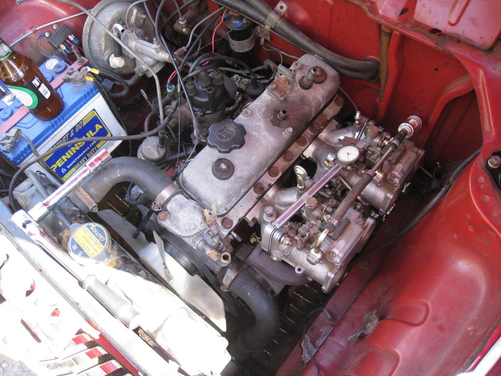

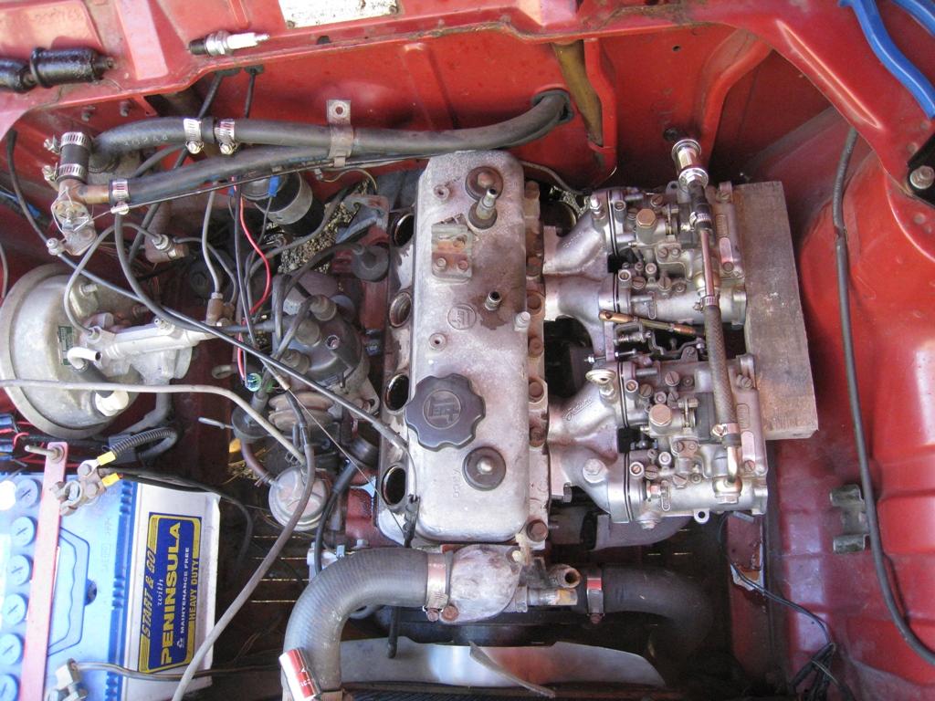

Yeh for sure. I took pics cos I knew people would want to see them!
What sort of twins have you got - Webers or dellortos, and what manifold?
These are 40mm DHLAs with a Redline manifold. In one Pic, you can see a 50mm block between the carbs and the strut tower. The closest point is at number 3 throat. You could belt the strut tower in of course, but thats dodgy!

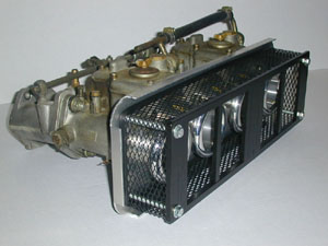

These are the Uniflow fliter setups. 160 bucks off their site, 50mm tall.
I'm going to call them to see if they will do a 40mm one, which will fit nicely, and probably be a similar cost to the Ramflo setup.

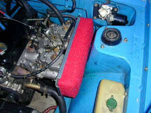

Personally, I reckon the Ramflo's look shit hot on an old school engine as well, especially round ones on SUs.

well, i didn't end up taking pics, but nobbler did. so maybe i'll get him to put them up.
at any rate, i have SFA room in there also. my twin 40's are on a lynx manifold.
atm i'll be putting some ramflo's on it purely for spacial reasons.
