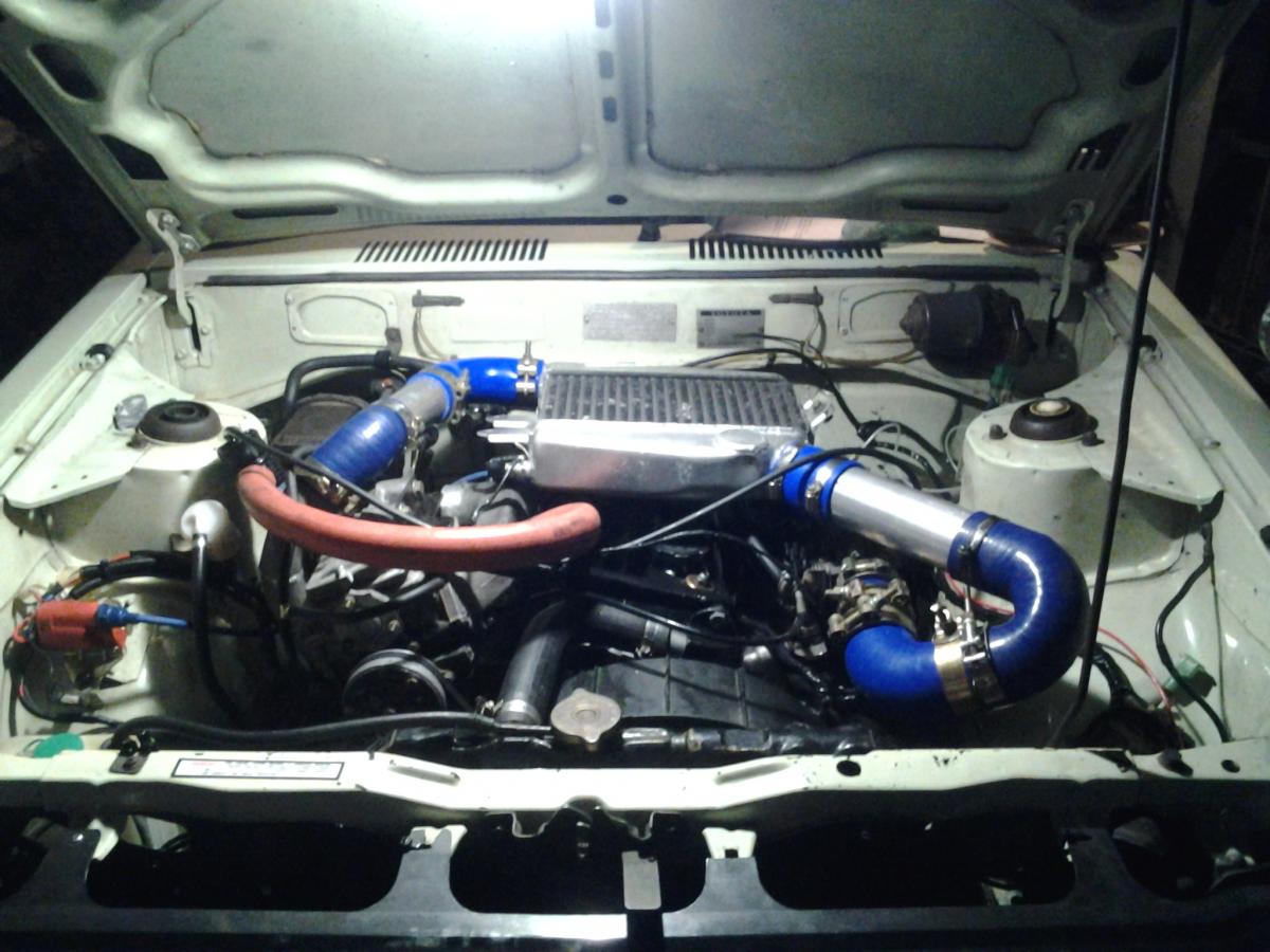

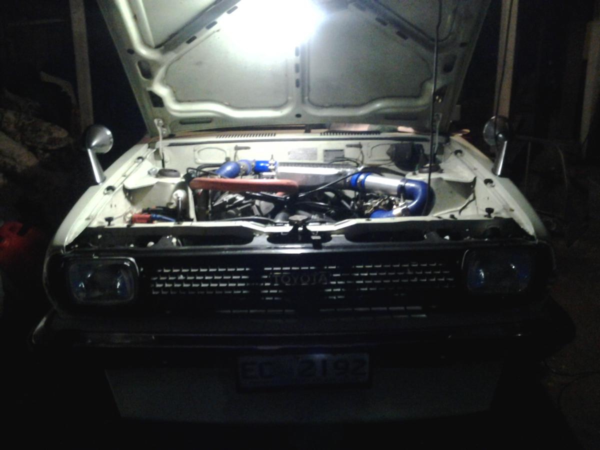

leigh Posted June 12, 2014 Author Report Posted June 12, 2014 Didn't get the chance to try and start it today. Intercooler didn't really line up with the pipes Supplied as I don't have the custom SC mount the kit was meant to come with :( So any way After 3 trips to town and back I finally got all the bits I needed etc Fabbed up a intercooler bracket aswell. Plenty of clearance when the bonnet is shut now Quote

leigh Posted June 13, 2014 Author Report Posted June 13, 2014 Dude call me over the weekend and I'll talk you through how to deal with that abacus. Haha Do you still have my number? Will need a bit of a play, I really only spent time tuning wide open throttle. That and the huge differences in camshafts. Yeah I think I still have it Stu, I found an old manual for it aswell So i have been reading up a little on it. ;) Â You going to cut a hole in your bonnet for a scoop now Leigh? I'm back in Launy for at least a week on Sunday so if you need a hand with anything just sing out. ;) Â Top mount is only temporary Si, Only want to cut holes once if the front of the car. so just smashed it up the top for the time being. Cheers mate I might get you over one night then :) Quote

leigh Posted June 17, 2014 Author Report Posted June 17, 2014 Normally get home about 5, just shoot me a message if you want mate! ;) Â Made up a new battery bracket tonight aswell so the cooler piping doesn't touch it! Quote
