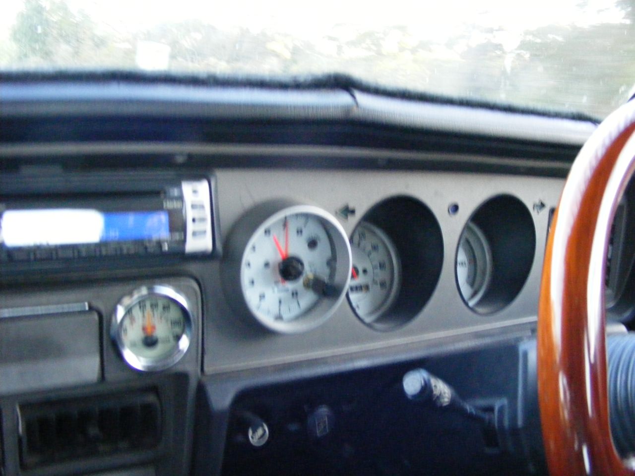

Thats my 5k....specs are in my sig. The actual needle is the top one, Teddy will vouch for seeing the tacho needle hit the shift light.
