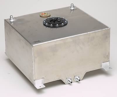

13BT_KE20 Posted March 11, 2010 Author Report Posted March 11, 2010 Your Speco one didnt work most of the time......I know you found out the hard way :jamie: yeh thats was when i just chuck it in the car, after that day i spent a couple of hrs making sure it was more accurate. Plus that day the car didnt actually run out of fuel..... lift pump power cable came off :jamie: It should be safe to say i wont have anymore fuel issues with the car after i finish the new set-up :no2: This is the fuel cell ive ordered Quote

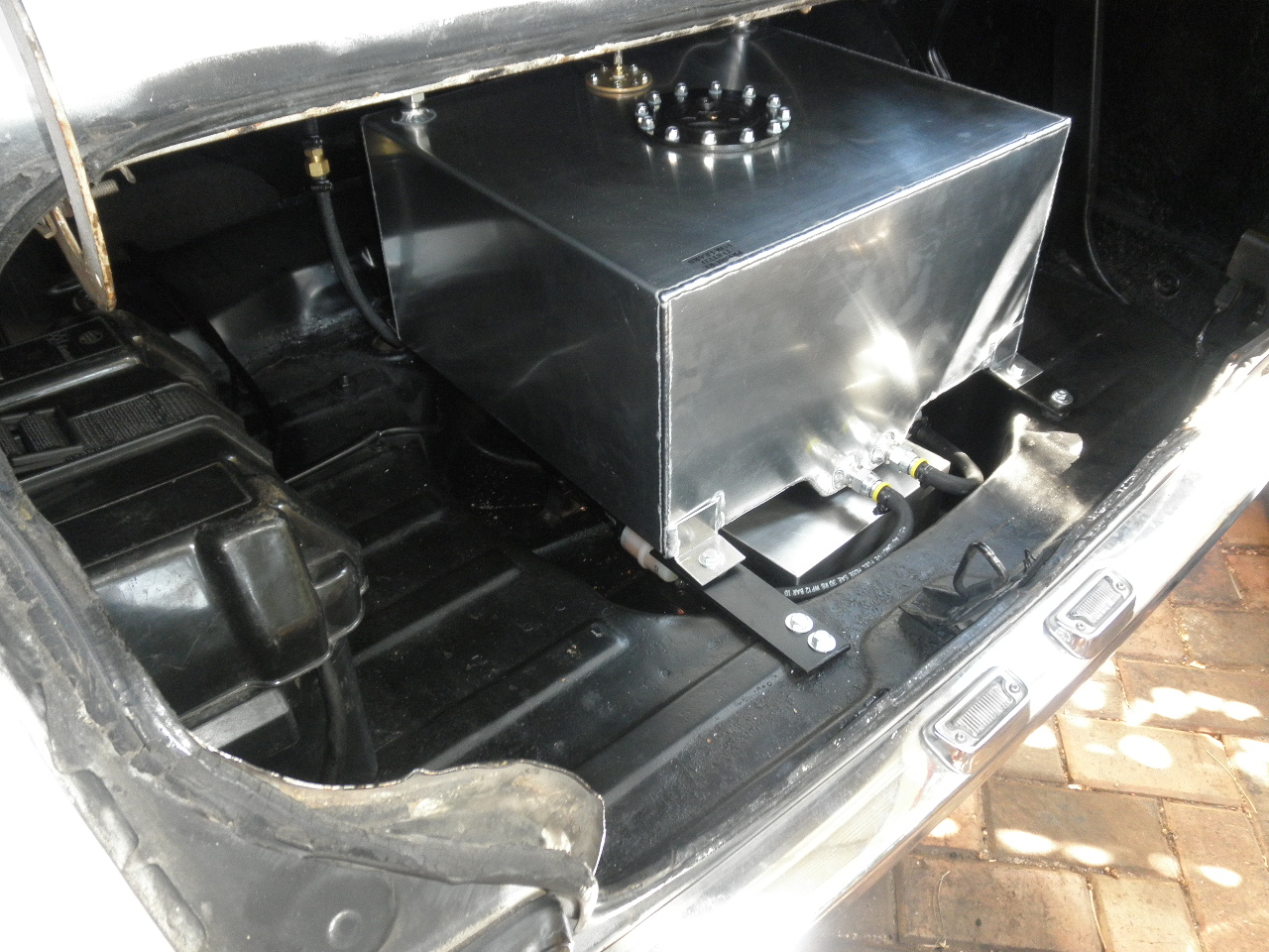

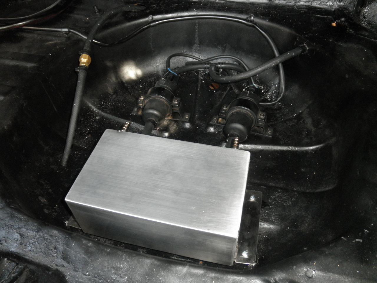

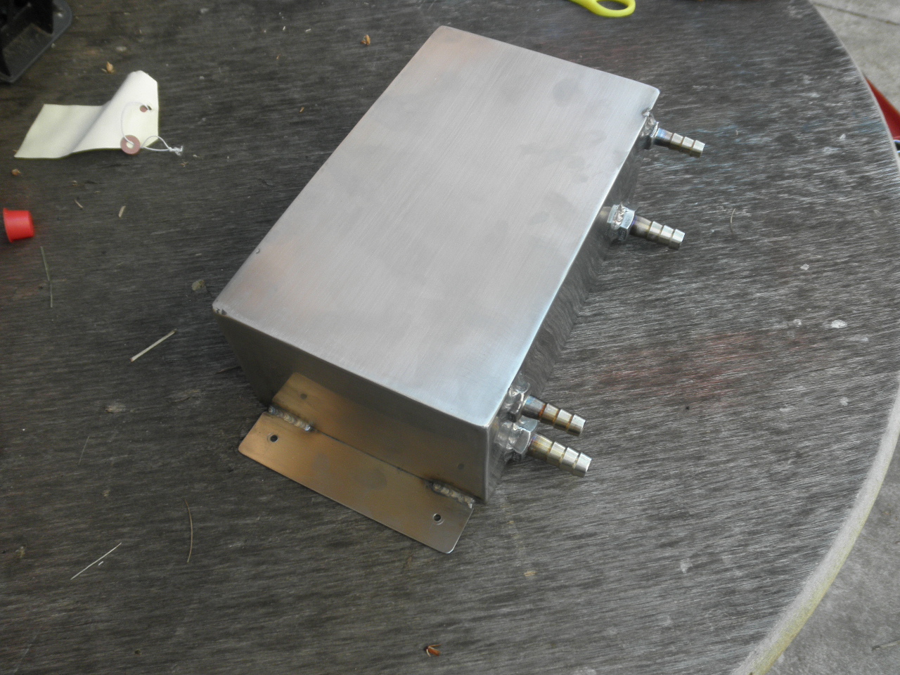

13BT_KE20 Posted March 16, 2010 Author Report Posted March 16, 2010 fuel cell arrived today >| diagrams have bee sent off to get my surge tank made Got my fitler and ordered my fitting for the tank so hopefully the car isnt in pieces for too much longer. Just waiting for parts basically. After paying extra for the foam filled tank i found out that i can't run it due to the fact i run pre-mix (it breaks it down) so pulled it out :lolcry: Surge tank is going to be roughly 3.75ltrs so wont ever have any fuel starvation problems Quote

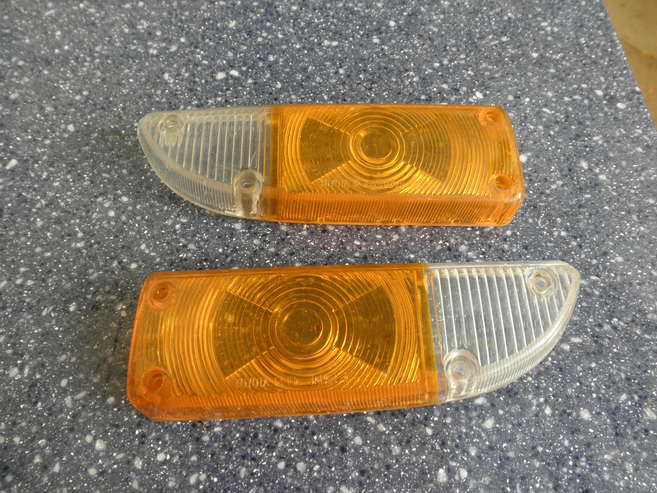

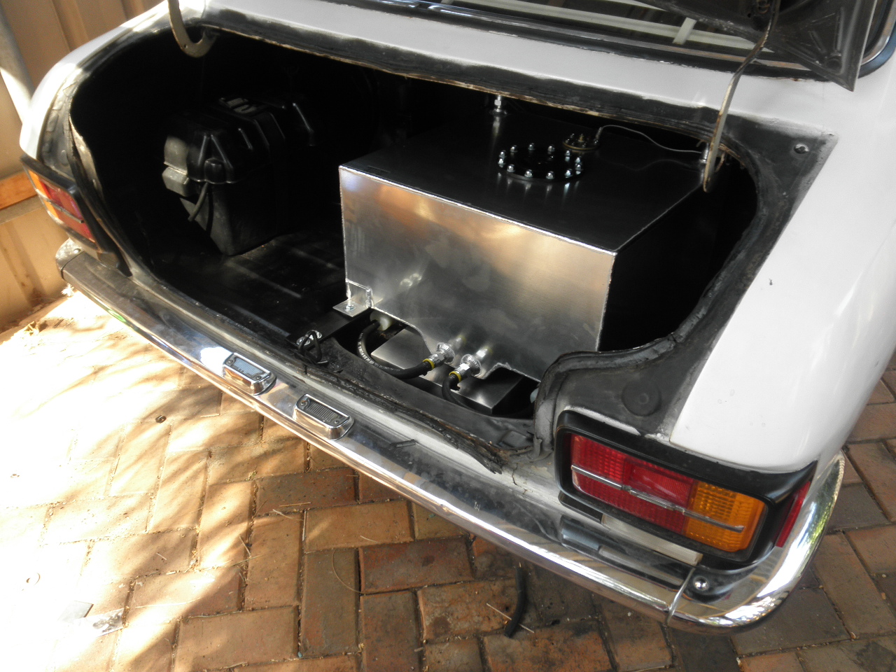

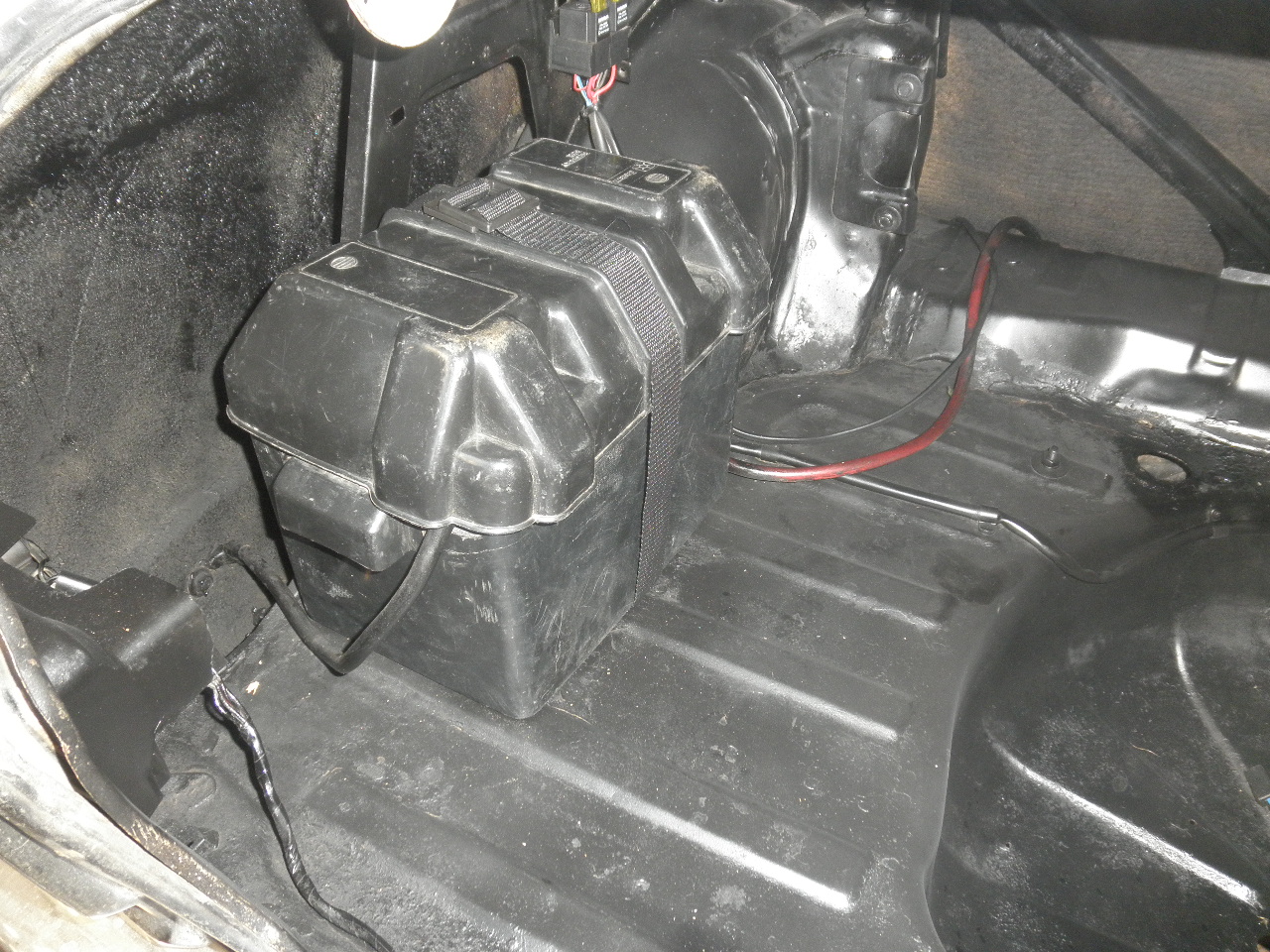

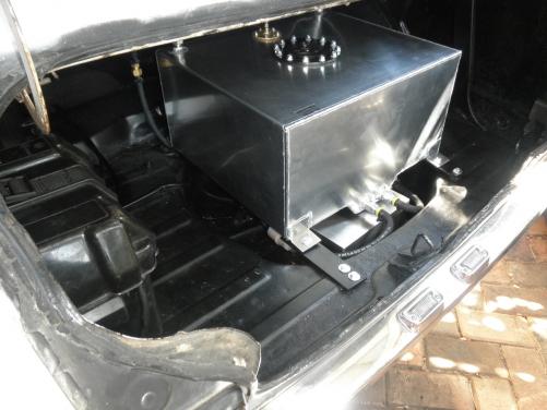

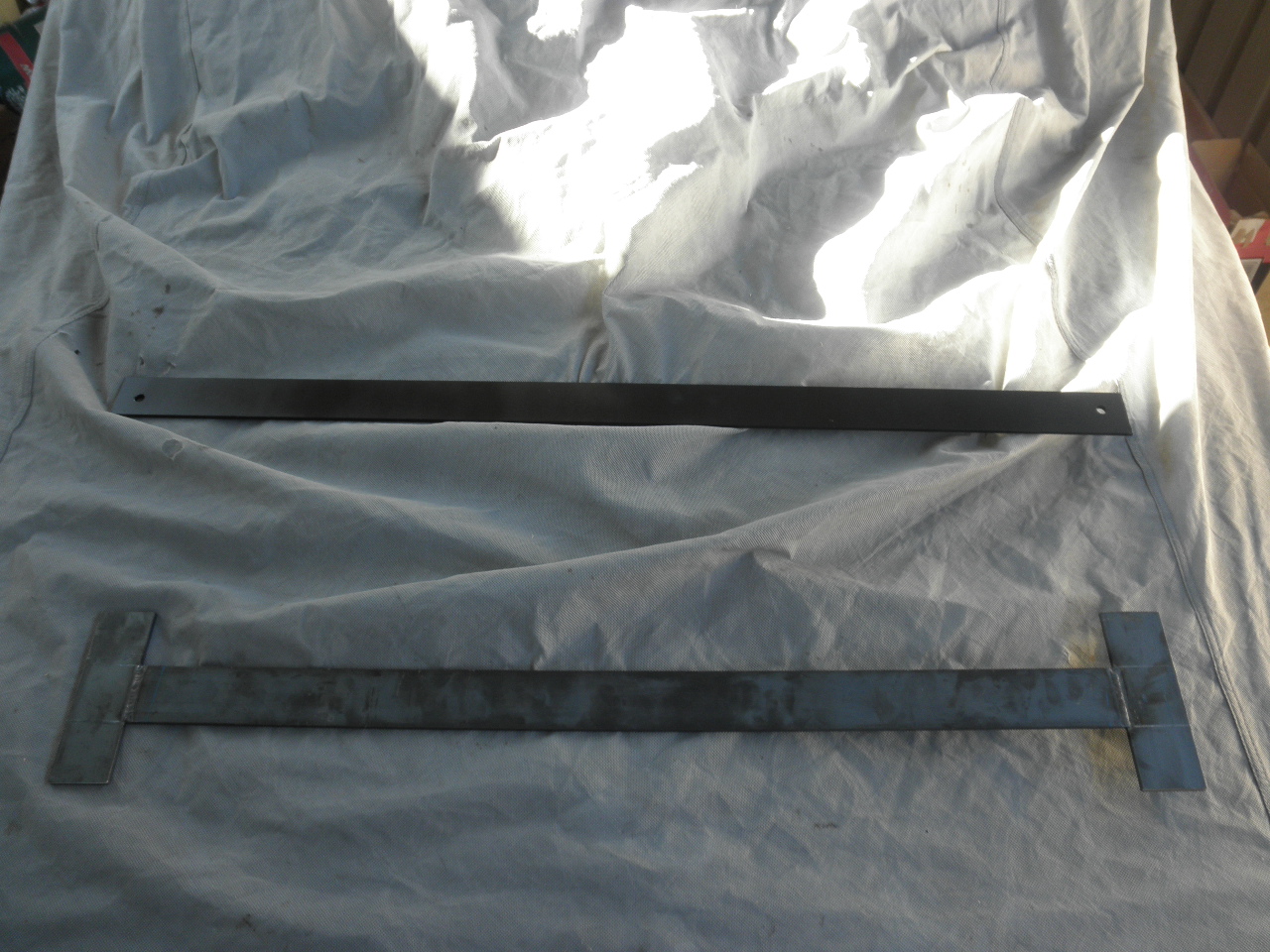

13BT_KE20 Posted March 21, 2010 Author Report Posted March 21, 2010 rear strut brace and rear cage mount brace custom surge tank big thanks for Jason! Battery and box neatly mounted in boot surge tank and pumps mounted in wheel well and all wired up. fuel return line to the cell too ALL FINISHED :) new front lenses Quote
1JZKe55 Posted March 21, 2010 Report Posted March 21, 2010 hey mate I like it looks very neat :jamie: Quote
13BT_KE20 Posted March 21, 2010 Author Report Posted March 21, 2010 hey mate I like it looks very neat :P Cheers Jason, I'm real happy with how it turned out. Did take alot of time to get it in there properly, worked out it took about 9hrs. I get so much satisfation from being able to say i built it (with a little help :jamie: ) myself. BUILT NOT BOUGHT and GO B4 SHOW aredefinitely the best way to describe the car Quote
Raven Posted March 21, 2010 Report Posted March 21, 2010 Lookin' good! Now, when do I get my first ride in this thing? :jamie: Can you get fuel cells that would be the same width and height as the factory tank, yet deeper, so you can retain some form of boot space? Quote
