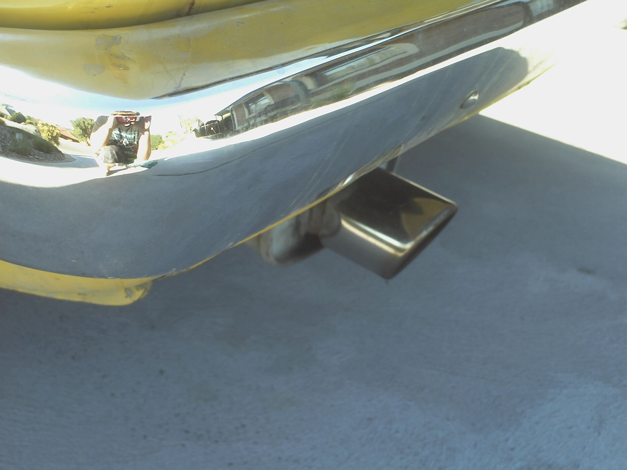

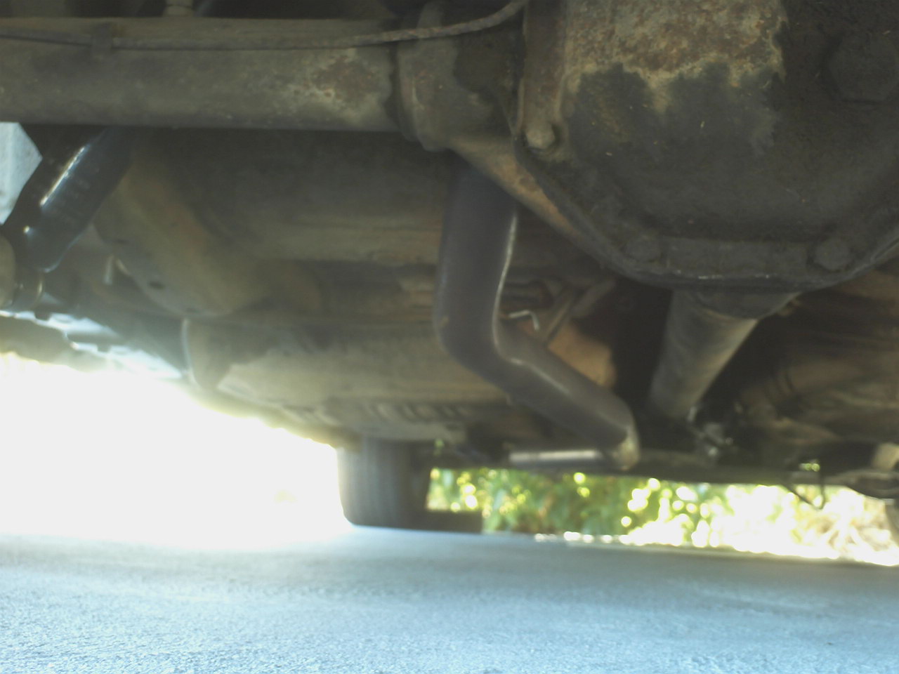

Nex Exhaust
2" system

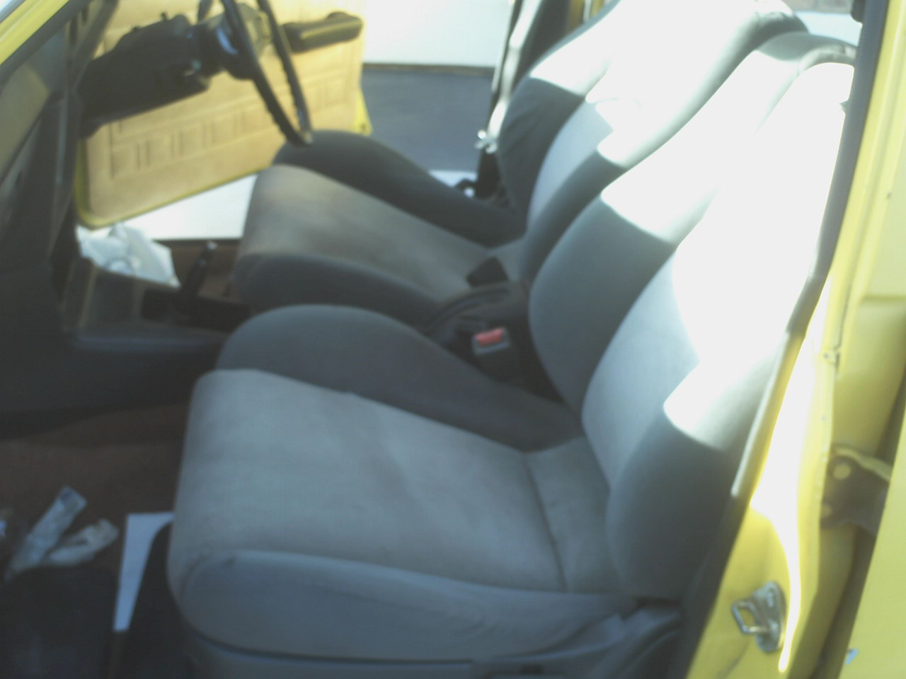

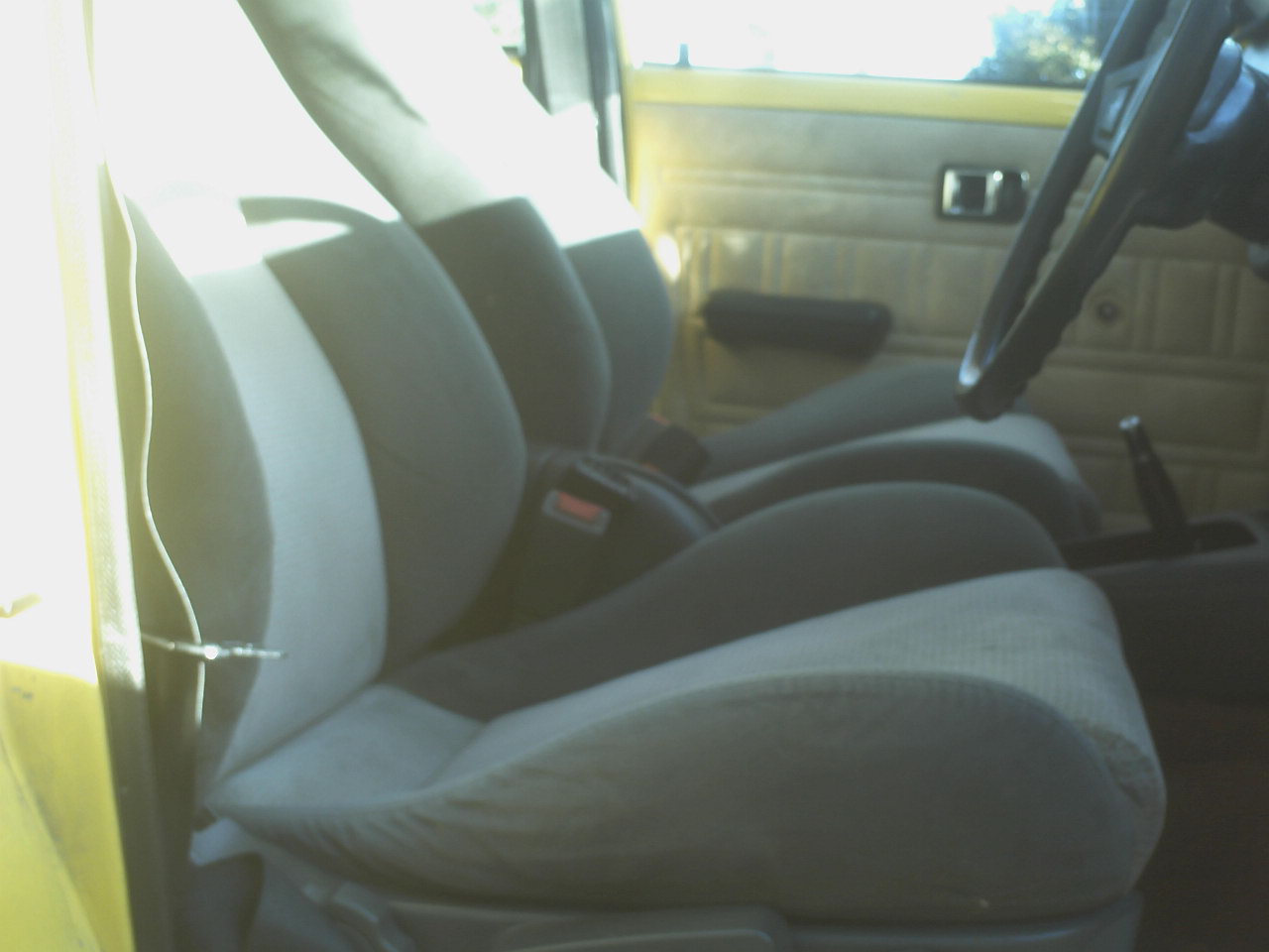

Seats....Finally

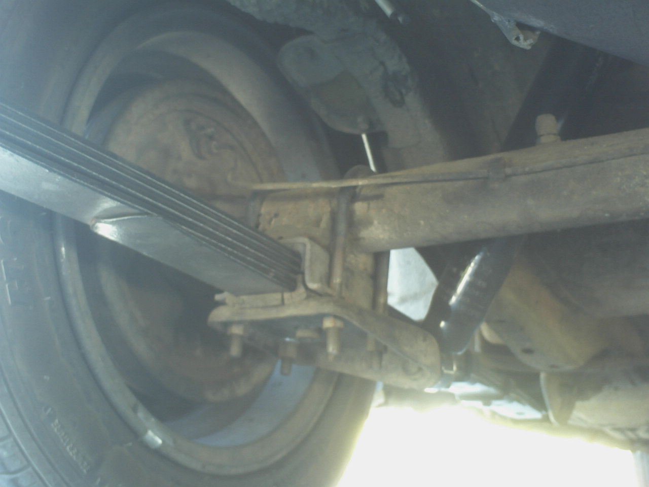

New shocks and springs...thanks Luc

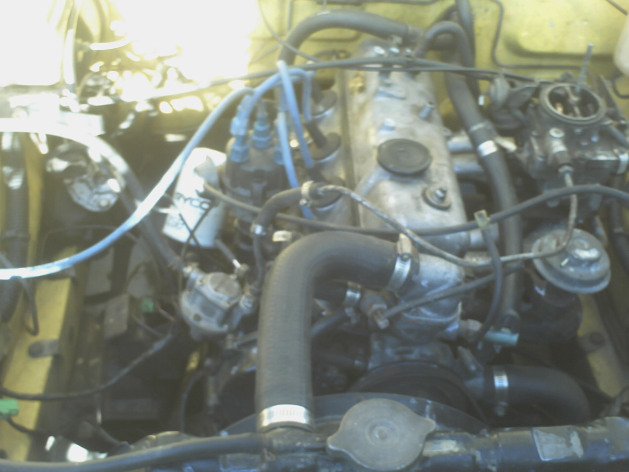

New 3K headed 4K

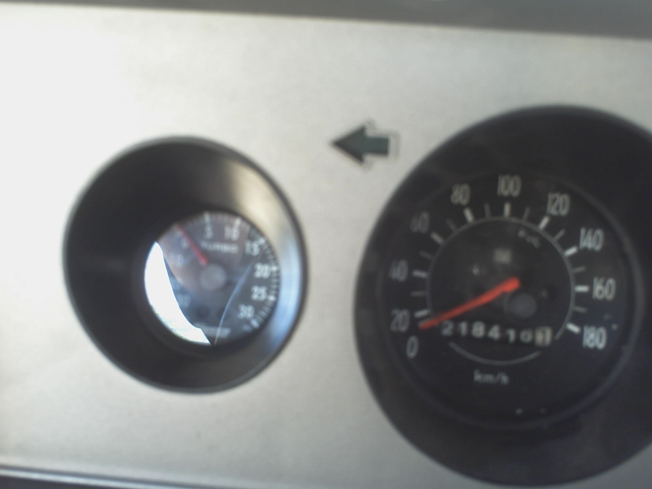

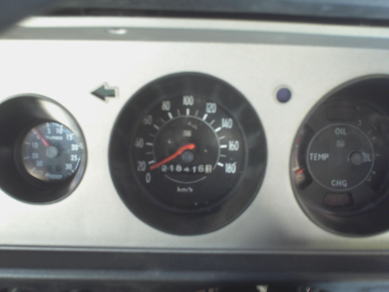

Boost Gauge :) Looks stockish ay?

Seats....Finally
what seats are they :dance: and that boost gauge looks sick it blends in so well with the dash if you looked at it you wouldnt know it wasnt supposed to be there :y:
