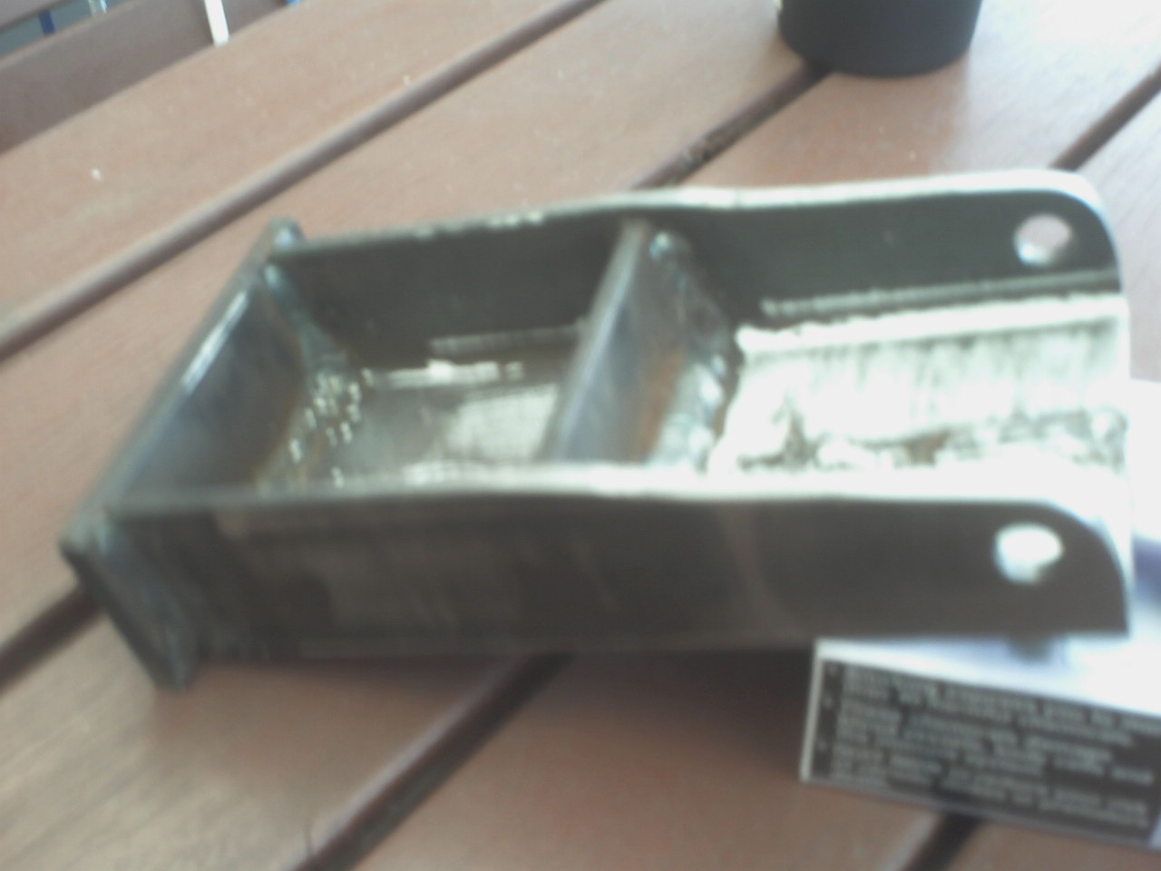

Supercharger Lower mount, gets welded to the blovk plate which will be bolted to the block.

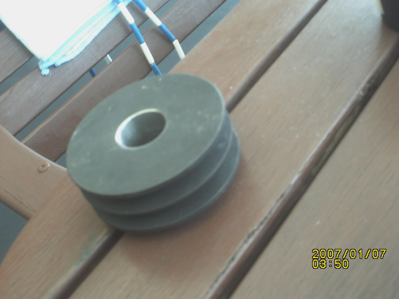

100mm Double A section Pulley, need to finish machining it to mount to stock balancer

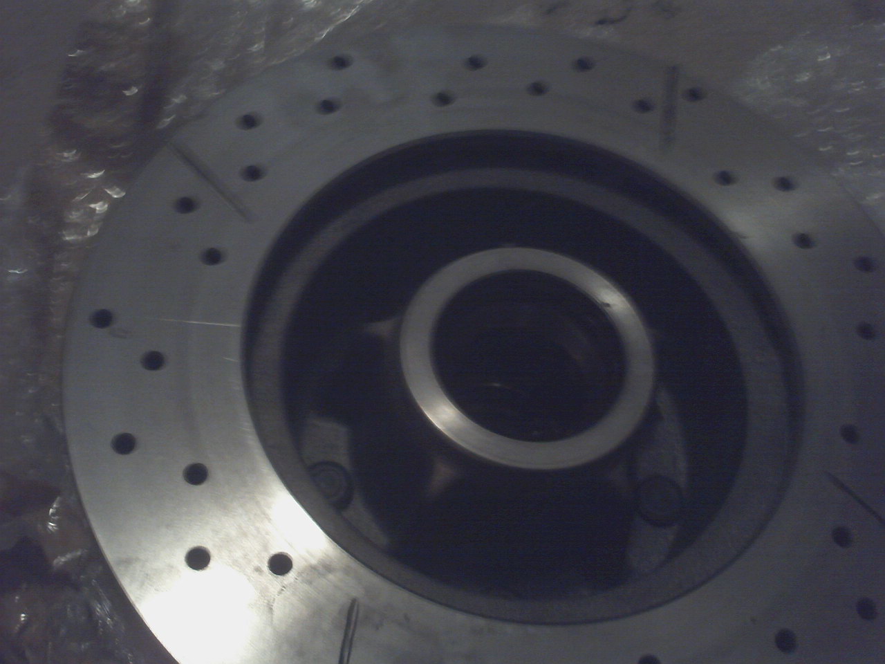

Drilled and Slotted Rolla brake upgrade anyone? 270mm :y:
Edited by SLO-030
270mm rotors? compensating for something else thats lacking :y: oh and i predict that the rotors will either warp or crack if not both :yes:
everything else is looking good though, wont be long before you will be needing the reco'ed head and be strapping the blower on side of the block
These wont be goin on the 30. Will be getting bolted to 'Rona struts with Mazda 4 pot calipers for the 38.
And yes, it is compensation, for the lack fo stock braking power :y:.
