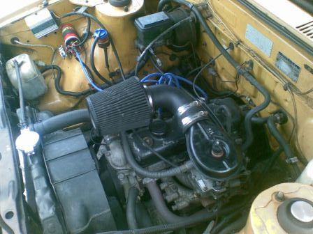

shauns ke30 Posted December 12, 2008 Report Share Posted December 12, 2008 Hay guy's i was just wondering if any one has a cold air intake on a k motor??? And if thay can show us some pic's?? I have one on it cost me $20 from the wreakers its abit short but. i need some more pipes to finish it off and this is what it looks like sofar. (pic's) If you have done somethink like this and if you can show us some pic's for some ideas that would be cool cheers shaun Quote Link to comment Share on other sites More sharing options...

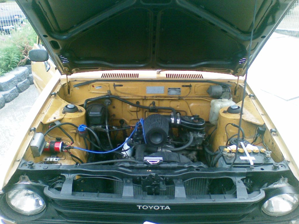

trav_555 Posted December 12, 2008 Report Share Posted December 12, 2008 i have a 5k liteace induction setup on my worked 4k, to a pod filter hanging in between battery and radiator, makes mad noise, its in a box too, custom by myself, so its legal enough ill get some photos later as its raining cost 25 from wreckers and pod 40, including pipe off lite ace from wreckers Quote Link to comment Share on other sites More sharing options...
philbey Posted December 12, 2008 Report Share Posted December 12, 2008 Hey shaun, just an observation, that pod sitting right on top of your motor is probably worse off than a standar Air Cleaner intake! Might want to run a couple of feet more pipe. Quote Link to comment Share on other sites More sharing options...
ke30Rolla myles Posted December 12, 2008 Report Share Posted December 12, 2008 (edited) heat rises you got up pod above a very hot place :) Edited December 12, 2008 by ke30Rolla myles Quote Link to comment Share on other sites More sharing options...

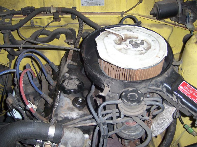

DearmanKE Posted December 12, 2008 Report Share Posted December 12, 2008 (edited) don't add mroe pipe just swivel it so its not over the motor, this cost me 30 cents of cutting disc, lol Edited December 12, 2008 by DearmanKE Quote Link to comment Share on other sites More sharing options...
trav_555 Posted December 12, 2008 Report Share Posted December 12, 2008 that is one messy and dirty engine lol :) Quote Link to comment Share on other sites More sharing options...
DearmanKE Posted December 13, 2008 Report Share Posted December 13, 2008 (edited) yeah but it went damn hard, miss that thing second gear snakeys in the dry any day and it was just a stock 4k that didnt idle properly lol Edited December 13, 2008 by DearmanKE Quote Link to comment Share on other sites More sharing options...
tas_ae71 Posted December 13, 2008 Report Share Posted December 13, 2008 not only is the filter above the motor but its directly behind the raidator and fan.... Quote Link to comment Share on other sites More sharing options...
