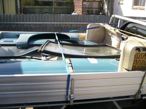

take the plastic chrome lock strip out of the center of the rubber all the way around the window. gently push the window out evenly, don't force one part or it will break. it should come out with the rubber intact as per the picture.
