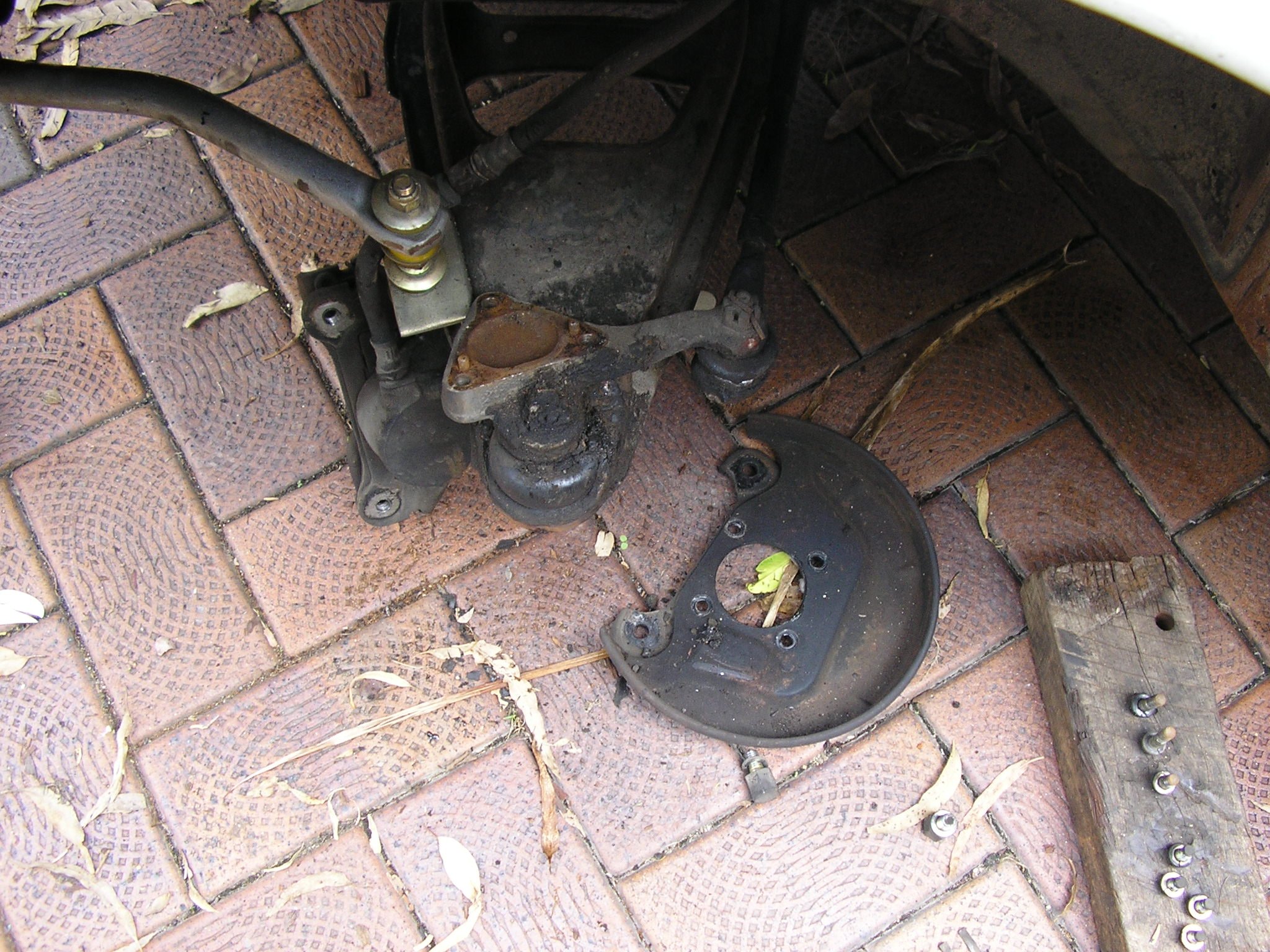

As for putting the calipers to the rear to avoid contact with the whiteline bar, from memory it wont work as the tie rod end is in the road of where you would want the caliper to go.
I have a ke15 and ke16, both with whiteline front bars, the ke15 having ke30 discs (square pads), and the a ke16 with ke20 discs (long thin pads). I've found that the ke20 discs are a lot worse for rubbing on the swaybar end at full lock and pushing the caliper piston back in, causing a momentary loss of brakes until you pump the pedal a few times. Changing brake pads more often reduces the rubbing effect. Also winding your steering lock stops out helps, at the cost of less steering lock.

As for the brakes, once a caliper is mounted securely it moves with the stub axle and tie rod end together.

Huh? I don't think the caliper will mount at the rear, look at the following pic... The caliper will most likely foul on the steering arm if they are run at the rear.
