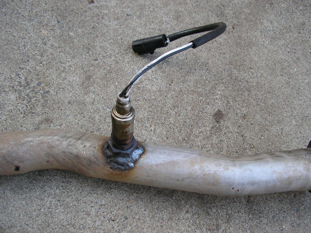

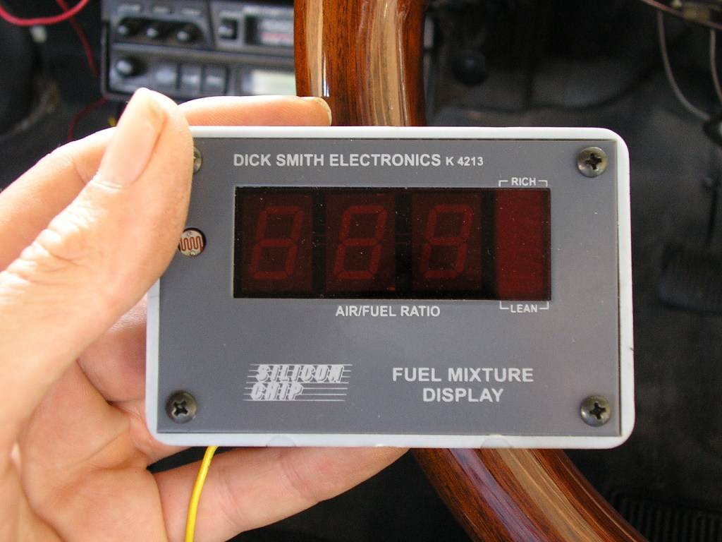

A heated 4 wire narrowband o2 sensor with a silicon chip fuel mixture display unit is an awesome tool for tuning carbed motors. The setup in the pics below cost me about $100 4-5 years ago. That included second hand o2 sensor, big nut (o2 sensor screws into) I ground to fit the pipe nicely, the FMD kit, and for some guy to drill the exhaust and weld the nut on.
I was going to buy myself a wideband setup from Innovate before I started the build but never got round to it.
I mentioned a basic narrowband setup to my mate a while ago, just for a crude indicator, but he shut down that "nah narrowband is shit, wont tell you anything". In hindsight I should have got a fitting welded to the headers while they were sitting collecting dust!
