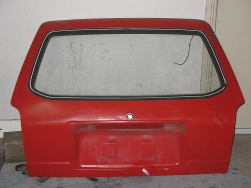

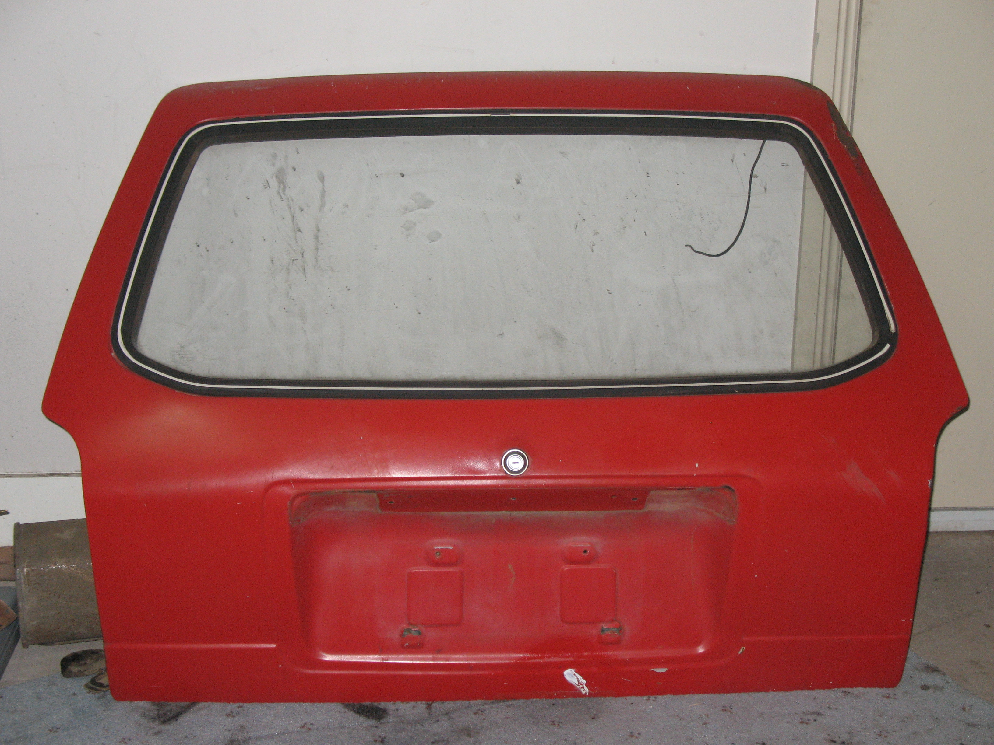

Dad suggested to me that while the Tailgate's still in the Garage, we might as well throw up a pic for ya's to see.
Here's the Tailgate:

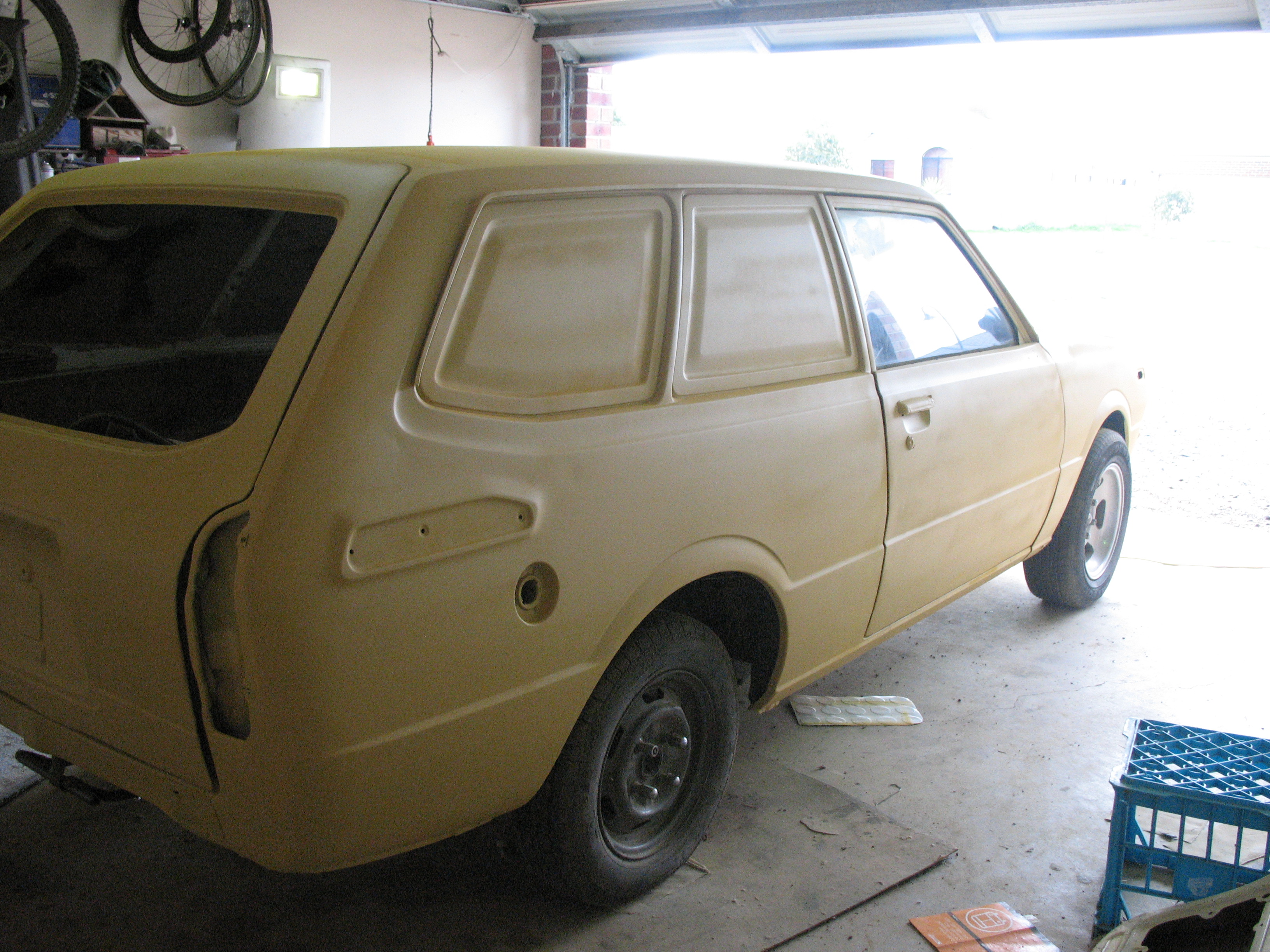

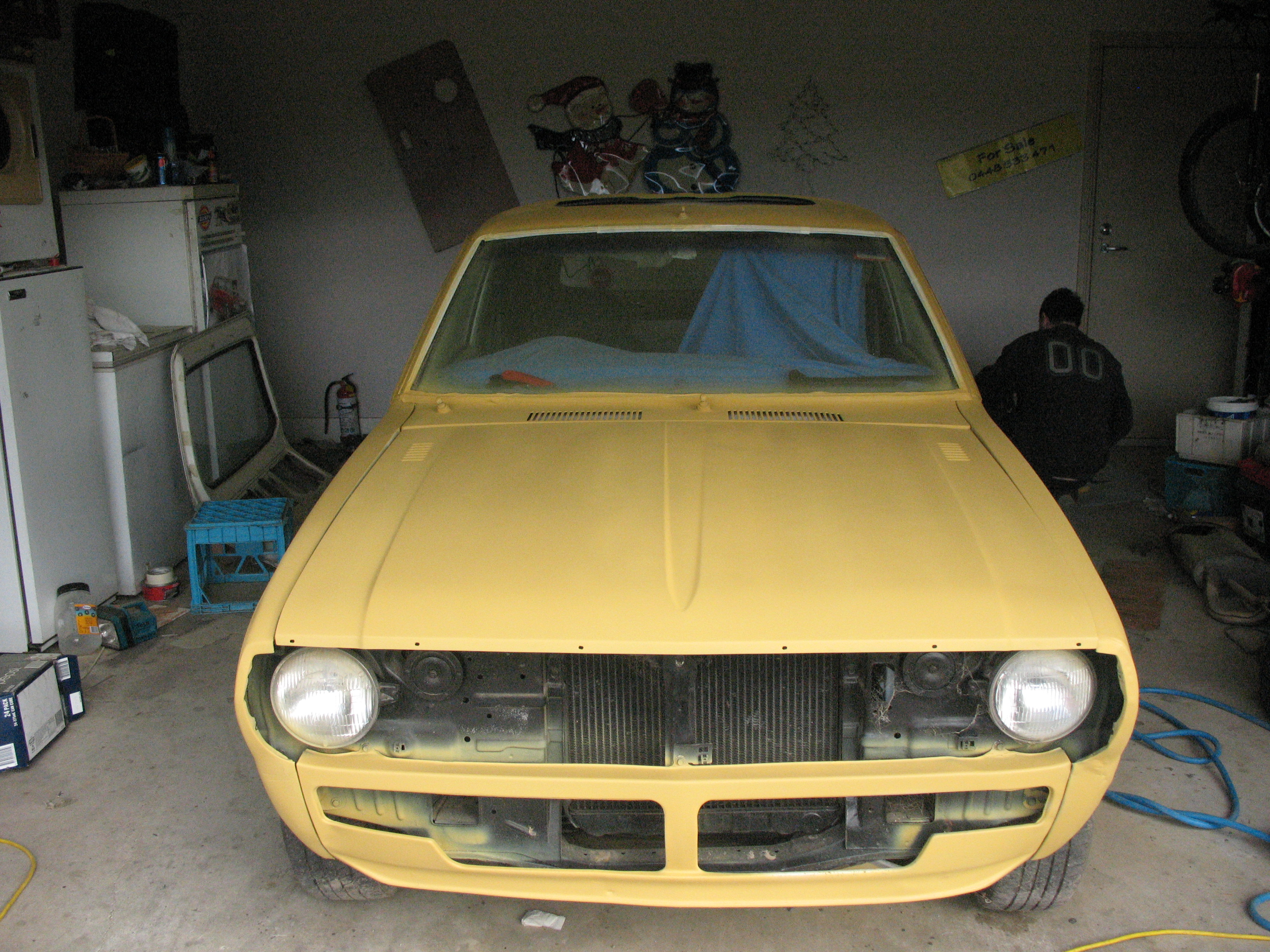

At 1.00pm, Dad said to me, "Josh, Here's the Sandpaper, I want you to Lightly Sand every Panel on the Car except for the Roof. And here's the Masking Tape, I want you to Tape up the Windscreen Rubber, the Door Handles and Locks, and the Windows so I can Paint your Car in Primer."
Before all that, We Chucked on the Tailgate we scored yesterday, and ripped out the Sunroof (which was an absolute pain in the arse). We also went down to Autobarns and got ourselves a Gravity Feed Spray Putty Gun, and 6 Sheets of P100 Sandpaper.
Apparently, with Ke36 and Ke38 Tailgates, the Latches Down where the Tailgate catches to close, are different to each other. So Dad and I unbolted the Latch on the Original Tailgate and did a swap.

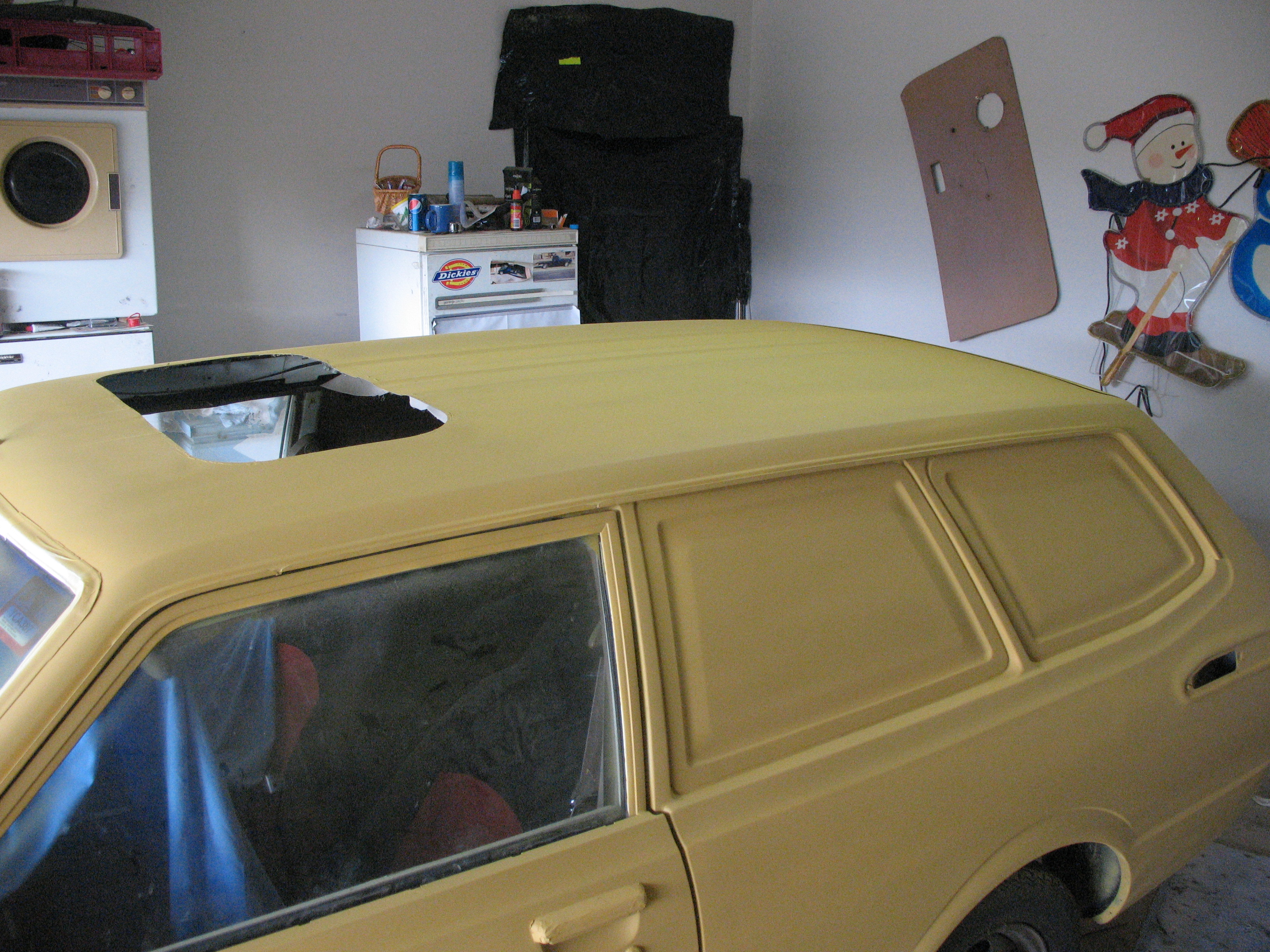

The Sunroof was a fun one to get out. We had to Rip apart the Roof Lining (which we have plans for, but keeping secret) to get to the Screws for the Sunroof Support Panel. Dad unbolted all the Screws hassle free except for one, which was Screwed in so hard, it wasn't funny. He got it out after a while and we then had to Pull it off the Silicone that stuck it down. We did that, then we used a Stanley Knife to take off the Bulk Silicone that was left over so we can then Re-Silicone the Sunroof back on.
When Dad finished the 1st of out 4 Coats of Primer, he suggested to me that we just paint Ollie a Simple White with a Clear Coat over it. I agreed with him so that's our new plan. Later down the track (when I get my full license), we'll then Paint Ollie in Poison Ivy, but for now, we'll just focus on getting the Project complete.

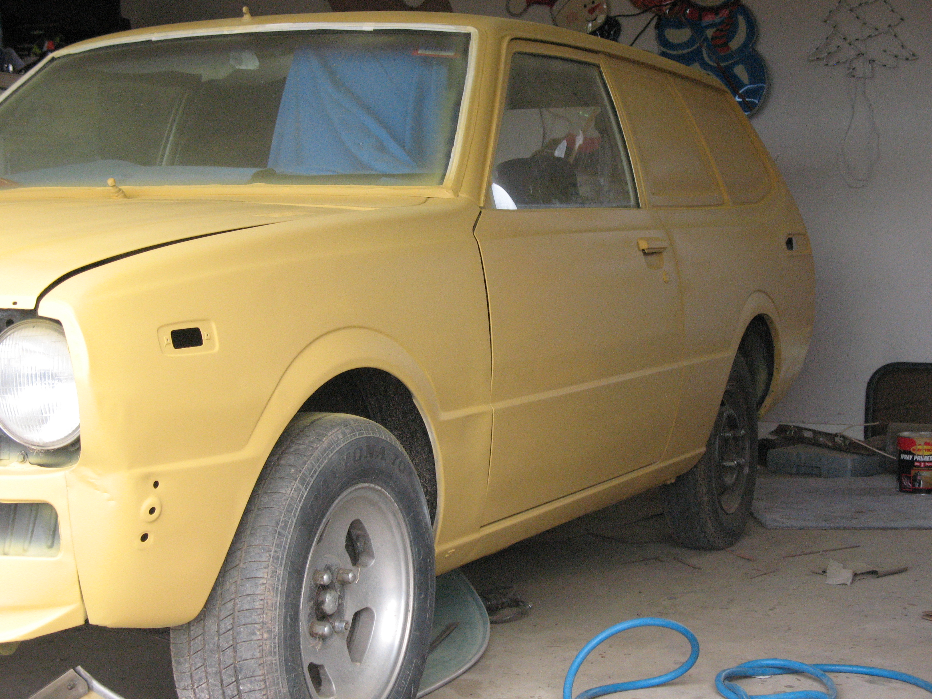

Ollie is now 1 Colour again!! We've come a long way since Page 1, which was 15 months ago.
We still have one more coat to go. The Pics were taken while the Paint was still wet. :)
