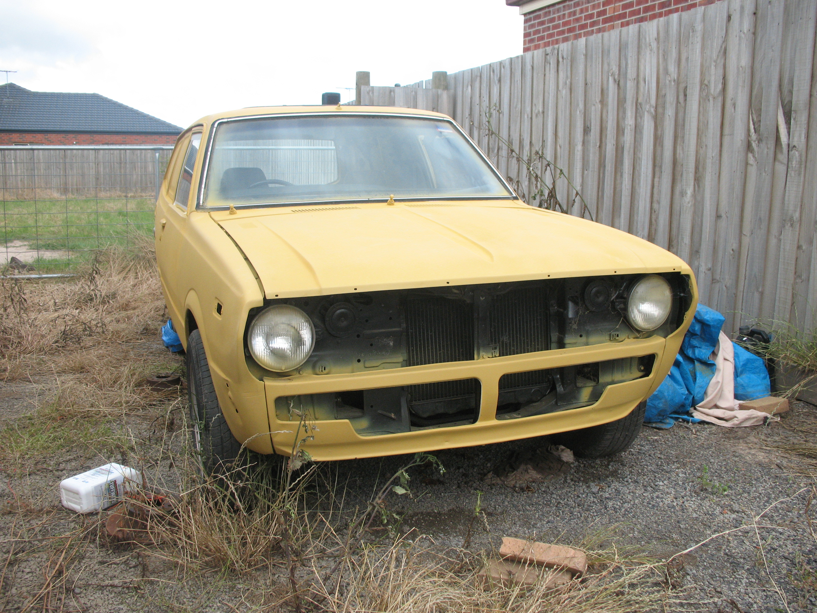

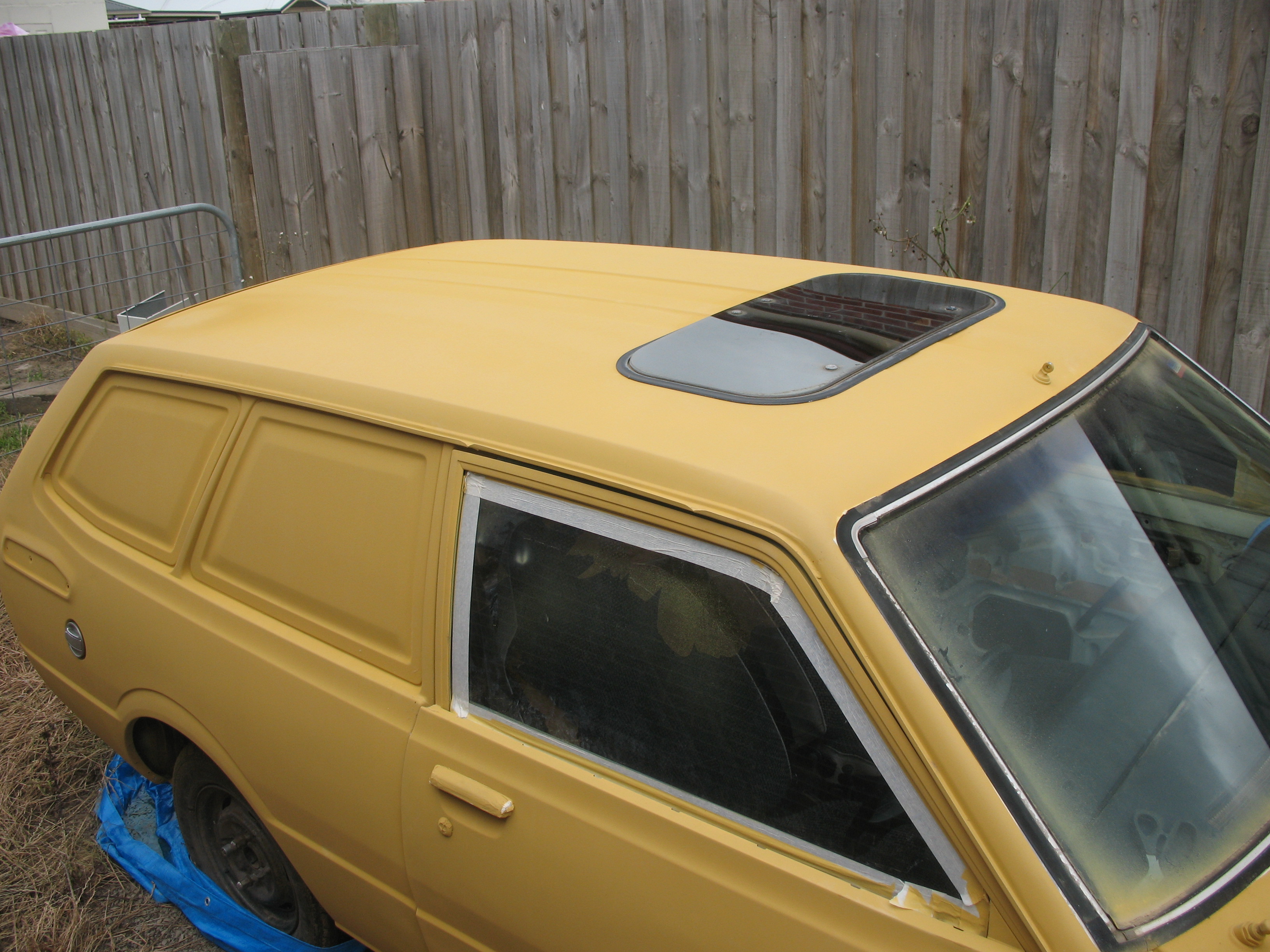

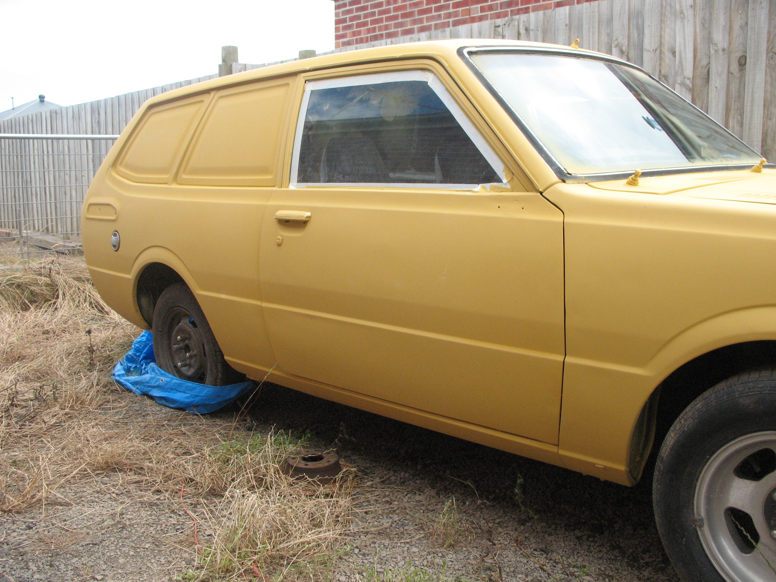

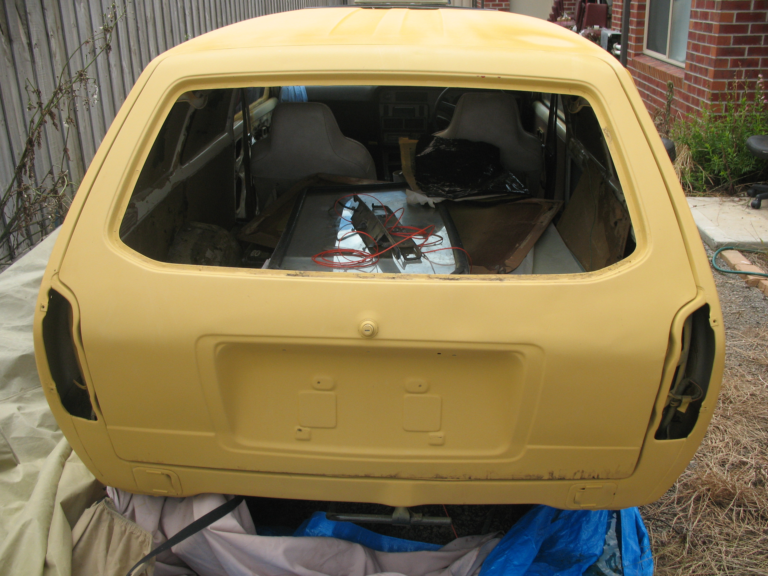

Well today we decided to let Ollie air out and check out how well the Paint has settled.
Josh went stupid happy snappin' and got a whole heap of pics. :lolcry:
Woz & Josh :cool:

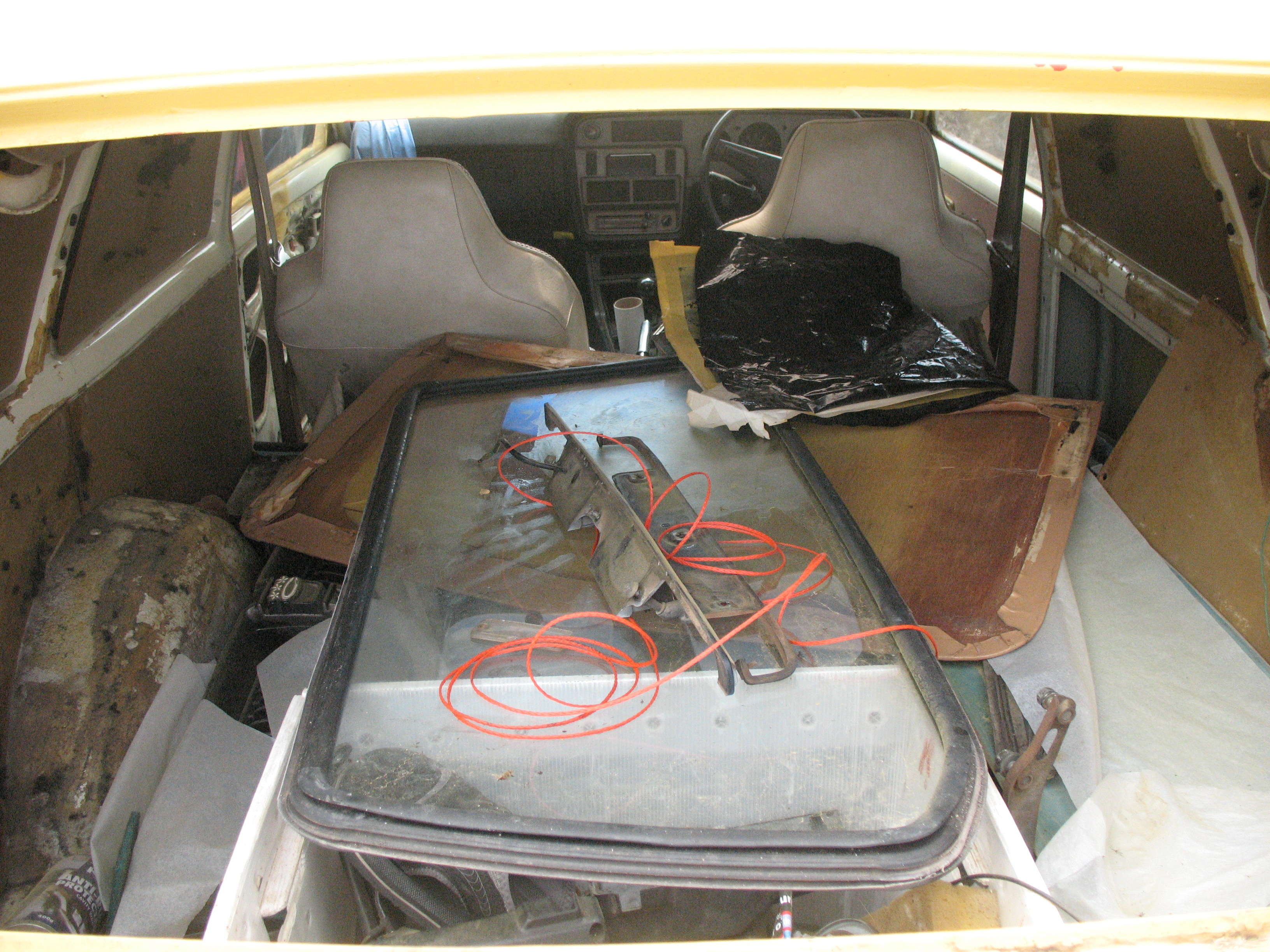

Things to put Ollie back together.

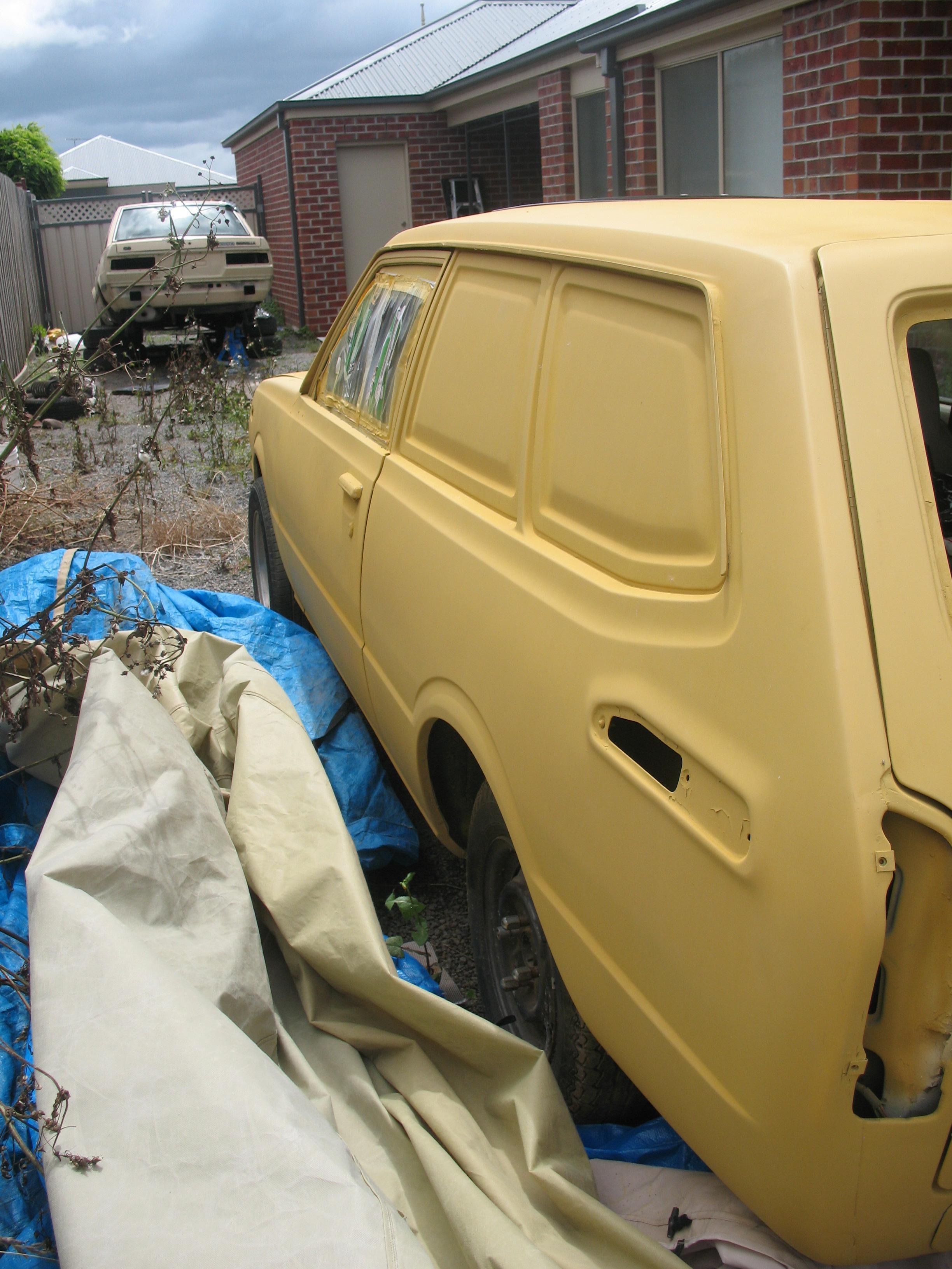

Under Tarp again.

Hi guys,just a little note of caution about having your freshly painted body stored under a tarp! I recently had an experience of having a body stored for a period of time under a tarp outside and although it was waterproof and did not get wet in any way,the humidity underneath the tarp buggered up the paintwork something terrible.Fortunately it was only a quick coat for protection while it was stored but I basically had to start from scratch again due to the damage etc.The paint really needs to be able to breath and allow the thinnerts etc to evaporate naturally.Maybe I'm wrong and maybe it was somehow my fault but this is the explanation I was given by an experienced painter..
Thanks Jimmy.
We let the paint dry in the Garage for a week, and then put the Car up the Sideway under the Tarp, and so far (since July), there's been No Scratches, Paint Bludge, or any sort of Damage done to the Car. :)
The Tarp does breathe Fresh Air to the Car, but we just wanted to Air out the Interior and the Roof.
