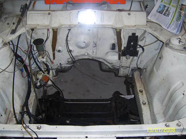

OBSCENE Posted April 13, 2009 Report Share Posted April 13, 2009 I've finally started on my partners KE10. Previsously was running a worked 5K big cam, twin webbers, lots of head work etc. Now shes wants more power so its time for a ground up restoration. I'm starting by doing a full mock up first. Any way heres some pics let me know what you all think. :D Quote Link to comment Share on other sites More sharing options...

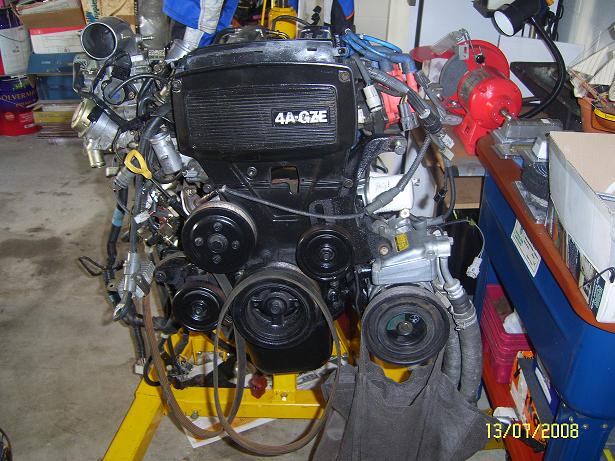

OBSCENE Posted January 18, 2011 Author Report Share Posted January 18, 2011 Hey everyone I know its been a while since i've actually done anything but now I'm back into it. I now have the engine and box sitting in there and I am about to start the engine mounts. I am going to manufacture an L shaped mount with a brace and run the Land Rover round type rubber mounts for a nice rigid feel. Let me know what you all think! Quote Link to comment Share on other sites More sharing options...

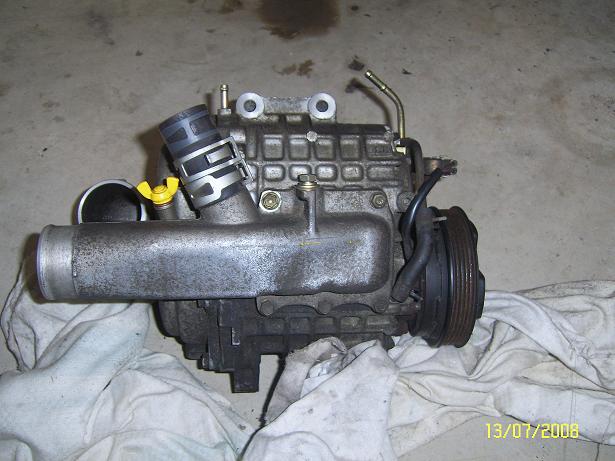

OBSCENE Posted January 24, 2011 Author Report Share Posted January 24, 2011 Here is the start of my prototype engine mounts. I am trying to fit the engine so I can run the 4agze factory air conditioning compressor. Quote Link to comment Share on other sites More sharing options...
OBSCENE Posted August 3, 2011 Author Report Share Posted August 3, 2011 A/C compressor fits pretty good. Engine mount one. Quote Link to comment Share on other sites More sharing options...

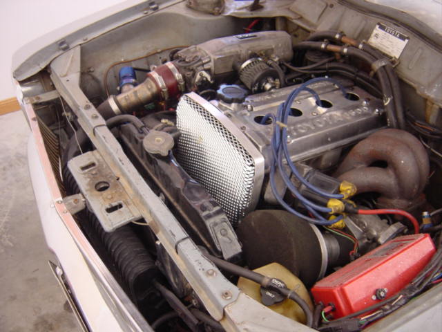

OBSCENE Posted March 15, 2015 Author Report Share Posted March 15, 2015 Here's the engine bay with new radiator and intercooler in place. Quote Link to comment Share on other sites More sharing options...
Clapped out Posted March 15, 2015 Report Share Posted March 15, 2015 That is sssssssoooooooooo tight, I love it! Quote Link to comment Share on other sites More sharing options...
