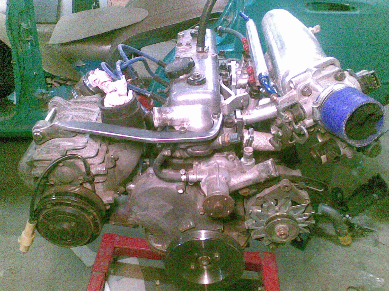

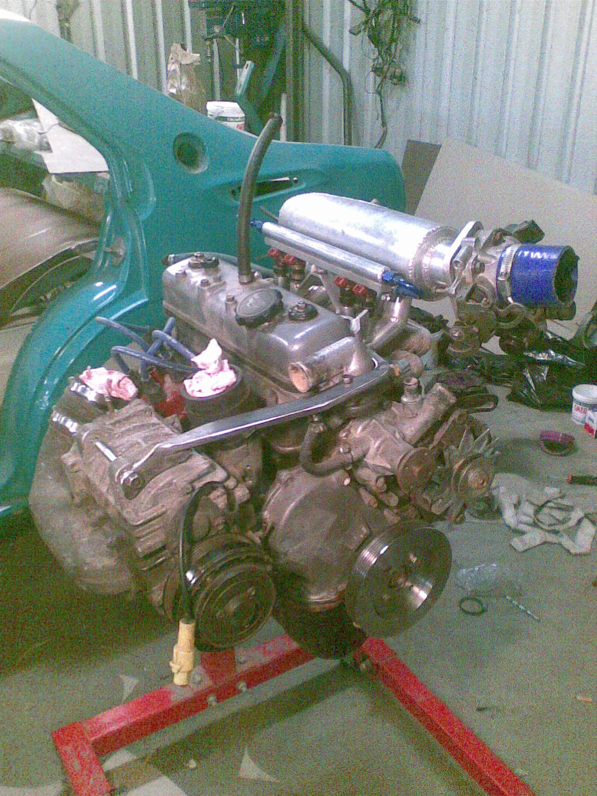

1JZKe55 Posted September 16, 2009 Author Report Posted September 16, 2009 hey guys just a little something that neil and i knocked up this week should be a killer little set up :lolcry: Quote
Taz_Rx Posted September 16, 2009 Report Posted September 16, 2009 (edited) Nice setup! :lolcry: Did you make the EFI manifold? Get yourself a external ignitor type electronic dizzy (if you haven't already) and you can easilly get it running with a single pulse trigger for the ECU (if fuel and ignition ECU) instead of running it coil negative trigger so you have ECU controlled advance/retard. Oh and what size injector you got? Need at least 300cc. Here's some cheap suitable ones if you need some and have paypal... http://www.club-k.co.nz/Forums/viewthread.php?tid=15940 Edited September 16, 2009 by Taz_Rx Quote

Taz_Rx Posted September 16, 2009 Report Posted September 16, 2009 After looking at the pics again, I don't know if your brace to the s/c is the best idea. The thermostat housing is only held onto the head by 2x small 12mm bolts and it would really suck if you ripped it off the head more than 50m from home!!!! Maybe you could attache a brace from the back side of the s/c up to both rocker cover bolts!? Oh and how are you tensioning the s/c belt? or are you converting the other pulley to rib and using the alternator? Quote
Evan G Posted September 16, 2009 Report Posted September 16, 2009 After looking at the pics again, I don't know if your brace to the s/c is the best idea. The thermostat housing is only held onto the head by 2x small 12mm bolts and it would really suck if you ripped it off the head more than 50m from home!!!! Maybe you could attache a brace from the back side of the s/c up to both rocker cover bolts!?Oh and how are you tensioning the s/c belt? or are you converting the other pulley to rib and using the alternator? i saw that striaght away and said "wtf"? i think its a alloy housing aswell? :lolcry: Quote

1JZKe55 Posted September 16, 2009 Author Report Posted September 16, 2009 After looking at the pics again, I don't know if your brace to the s/c is the best idea. The thermostat housing is only held onto the head by 2x small 12mm bolts and it would really suck if you ripped it off the head more than 50m from home!!!! Maybe you could attache a brace from the back side of the s/c up to both rocker cover bolts!? Oh and how are you tensioning the s/c belt? or are you converting the other pulley to rib and using the alternator? hey yeah the top brace looks a bit weird but its more than well and truly strong enough to take the load from the s/c plus there's still one more bit to be added in which bolts from the top of the timing cover and welded to the top brace (which still needs to be welded into place) which also holds the top of the tensioner in place and bottom of that is bolted to the lower s/c bracket and it still runs the V belt inlet is left over parts from a old set up. injectors are 550 and everything is controlled by a wolf3D the motor is 5k balanced, billet pulley, forged pistons, gapless rings, O'Ringed, headwork, cam the motor is built for boost. Should make about 110kw and over 400nm of torque at the wheels going by the old set up ..! had to make all brackets pulley again as all the old set up was sold off :lolcry: Quote
Taz_Rx Posted September 16, 2009 Report Posted September 16, 2009 (edited) 550cc is really a bit too big for a 5k!! Keen to see this thing running though. :lolcry: Edit: Oh and what sort of wolf have you got a? a V4? If so I can give you fuel and ignition maps for a boosted 5k!! If you want it easiest way would be to send me your little cartridge. Edited September 16, 2009 by Taz_Rx Quote
