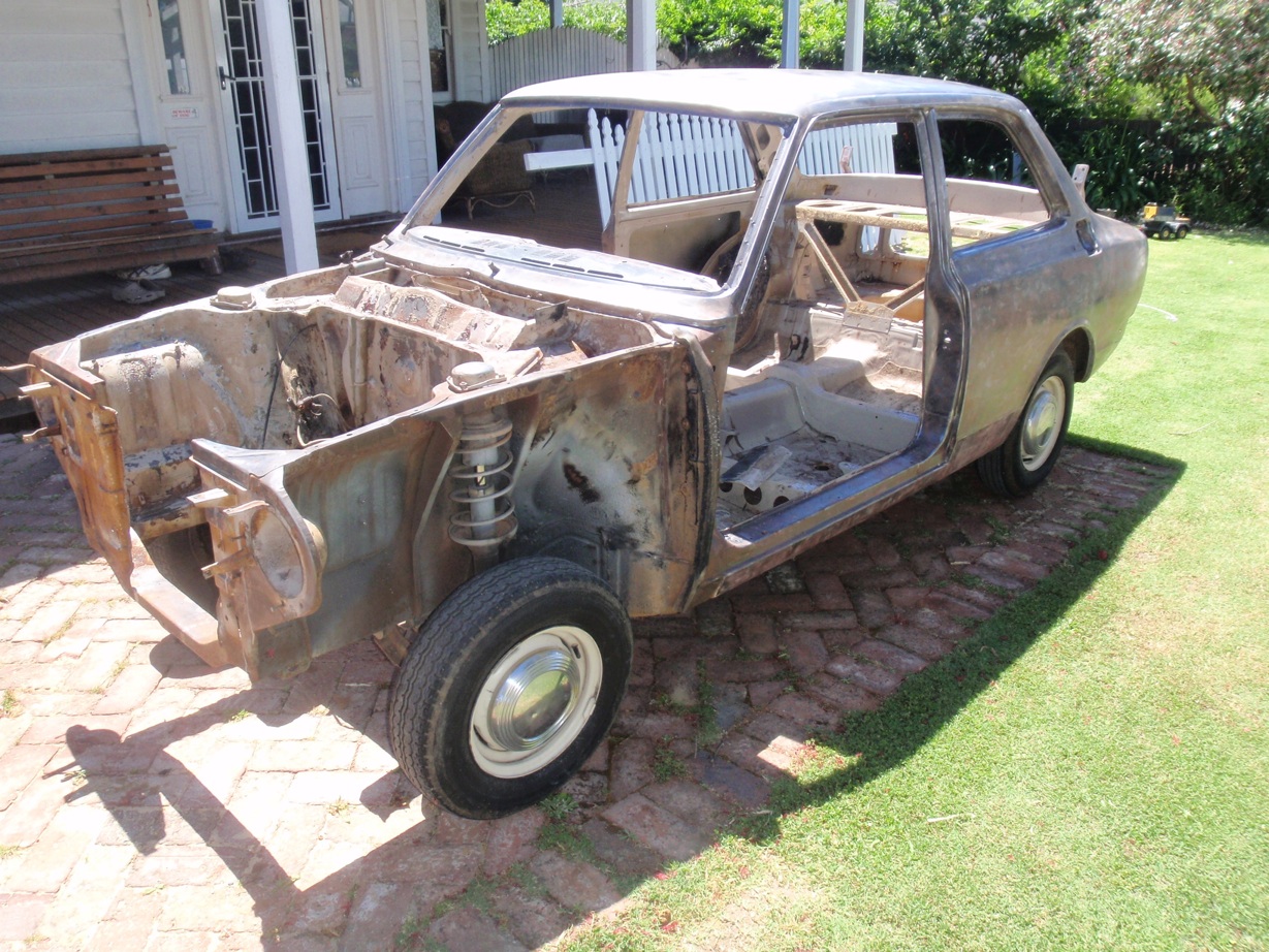

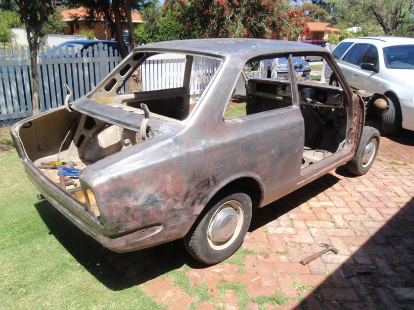

To get the shell bare i just bombed a heap of paintstripper everywhere and hit it with a wire brush after to get everything... it worked well for me even though i was getting covered in the stripper.. next week i will be goin over my neighbours house who happens to have a huge compressor for a sand blaster which i can hit the engine bay with. so hope fully next week the car will be sitting in primer next week..

Cheers boys, its good to share the passion... well there hasnt been a huge amount of progress in the past few days besides more paint stripping and thank god I'm at the last stages of that.
The next big part is going to happen next friday when the bloke across the road will be firing up his sandblaster to clean up the firewall and little spots of rust and hopefully if there is enoughlight left in the day to have everything sprayed in primer! But there are a few things i need to have done like Make sure all the paint is off and Undercoat the car in that black shit.
Oh and as you can see in the picture that is why i need a new fender haha!!
the amount of bog on that gaurd makes it look like someone was going for a 'wide bodied' ke10 look.
