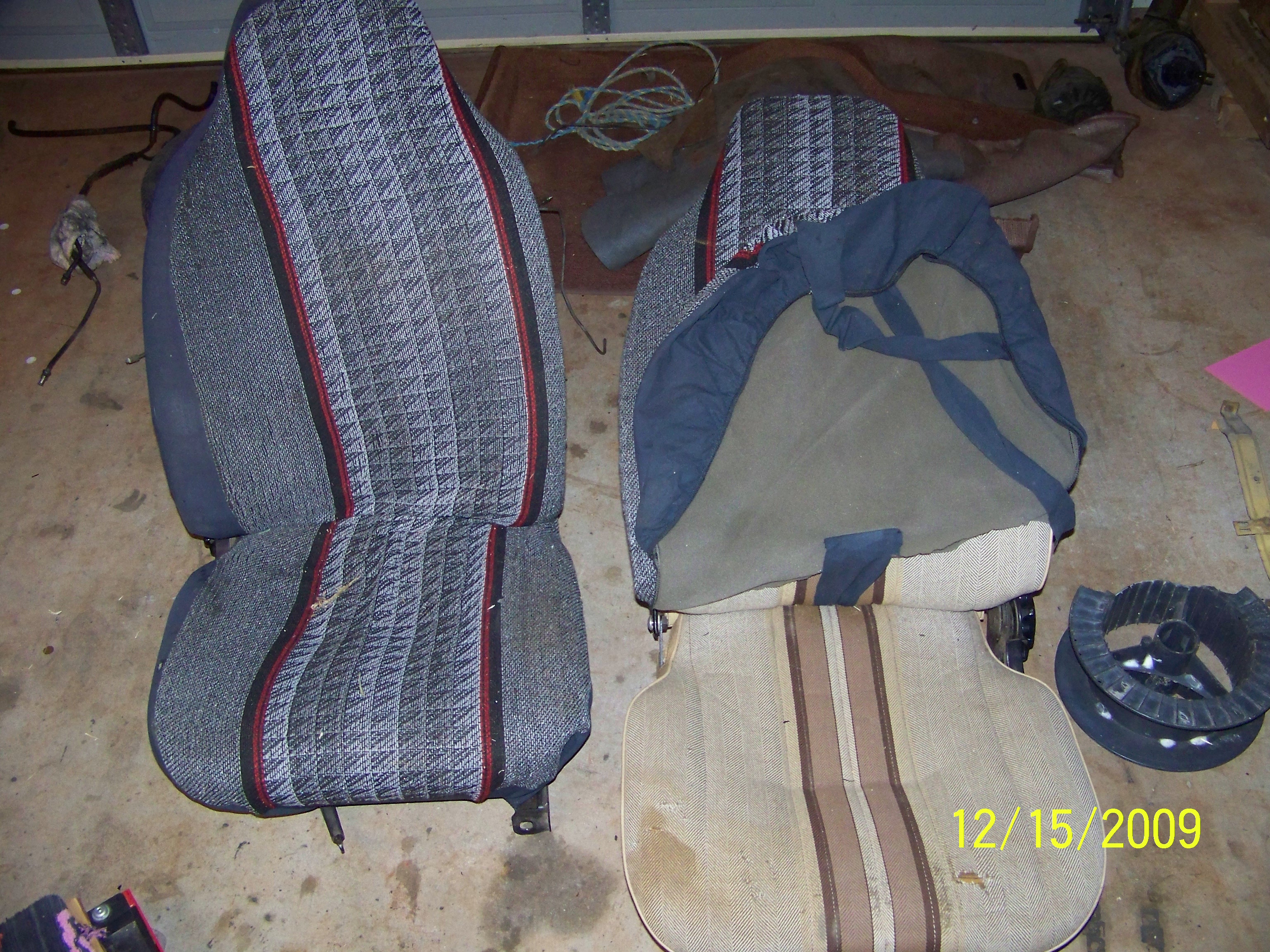

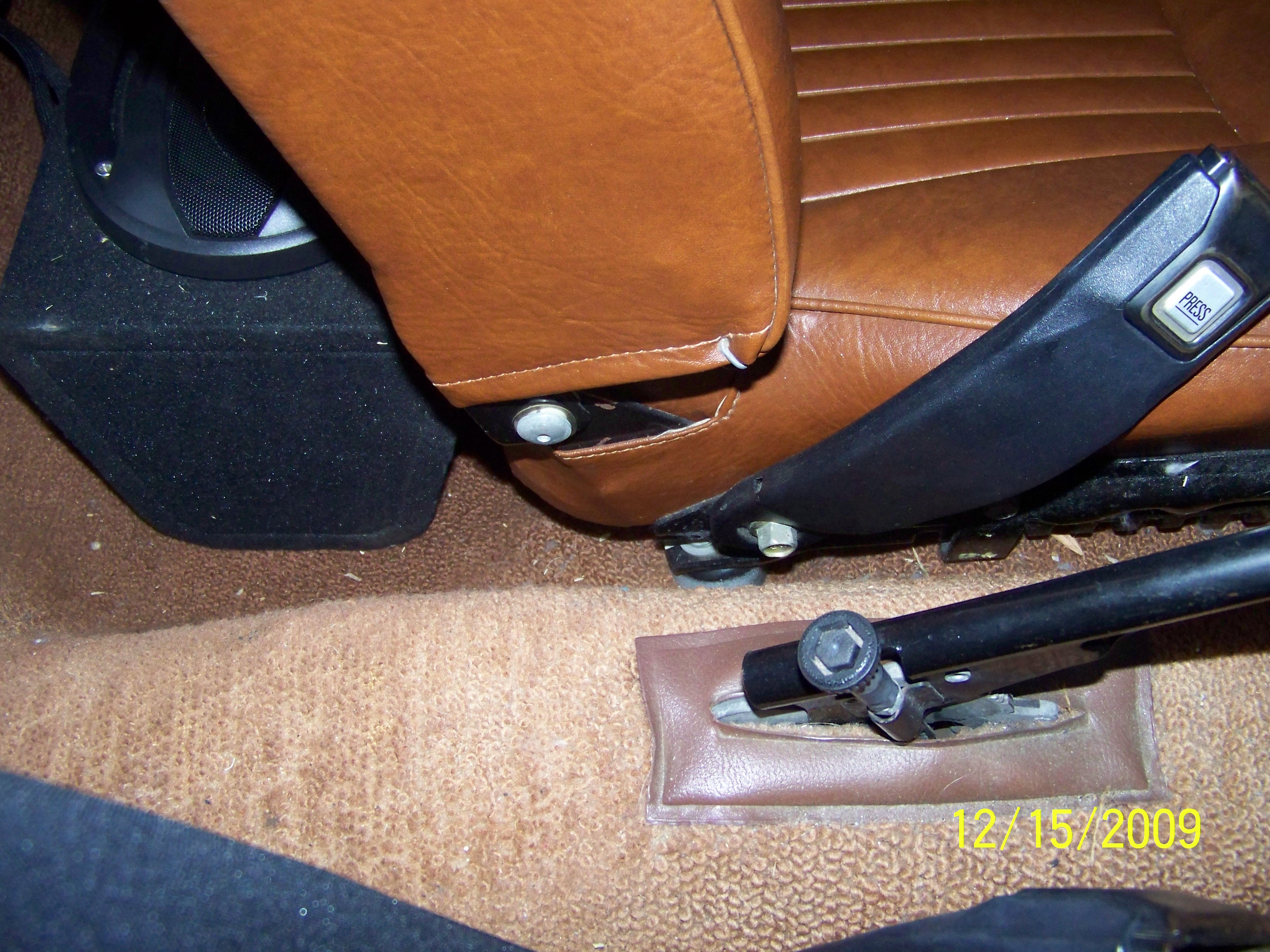

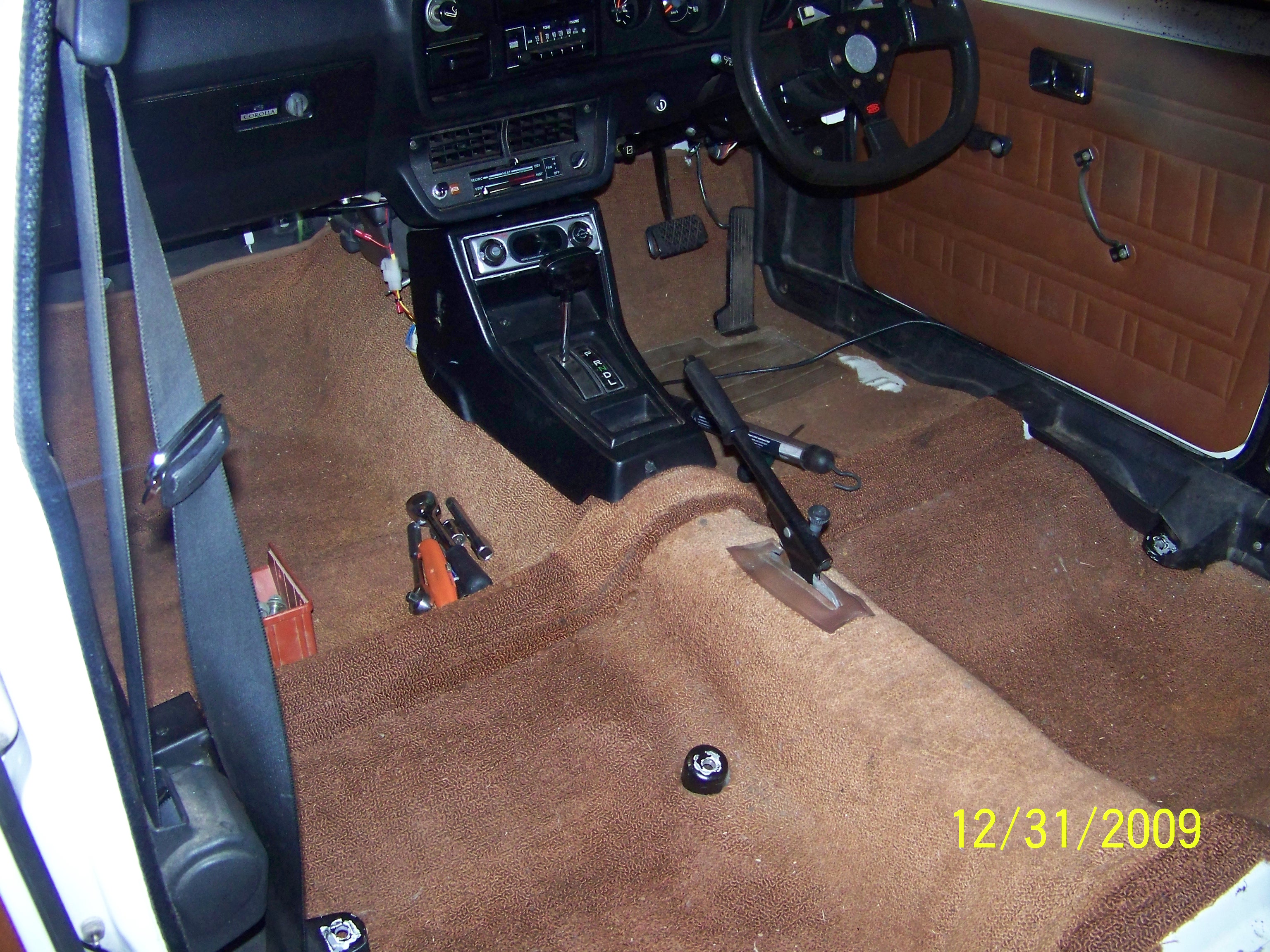

towe001 Posted December 15, 2009 Author Report Posted December 15, 2009 Well the plan for tonight was swapping the ke55 cloth front seats over to the ke30 Couldn't be arsed in taking the cover off the drivers seat but its only got a small tear as well Till i found this with the seat belts. Bloody things are bolted to the seat frames :y: You could always "Trick Out" the Auto and the Diff so it goes faster and so that it gains more speed in both gears. But also at the same token, if you are going to go with this idea, you would need a pretty quick motor in front of them for support. Yeah i've been thinking of that but with manualising the trimatic instead of the two speed auto Quote

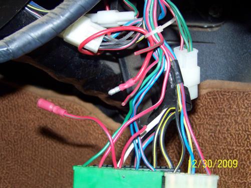

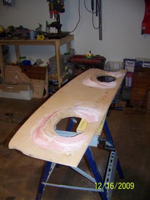

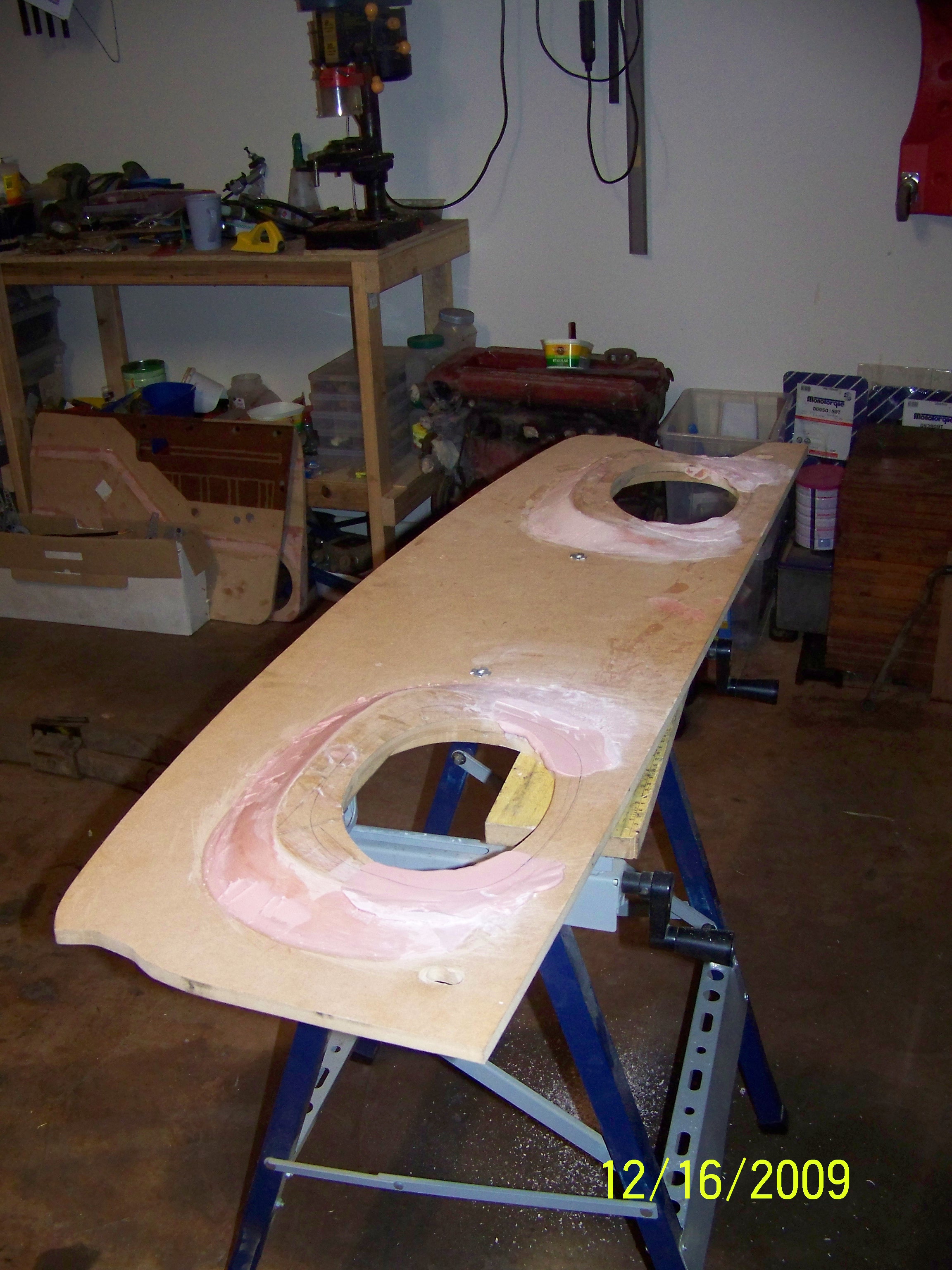

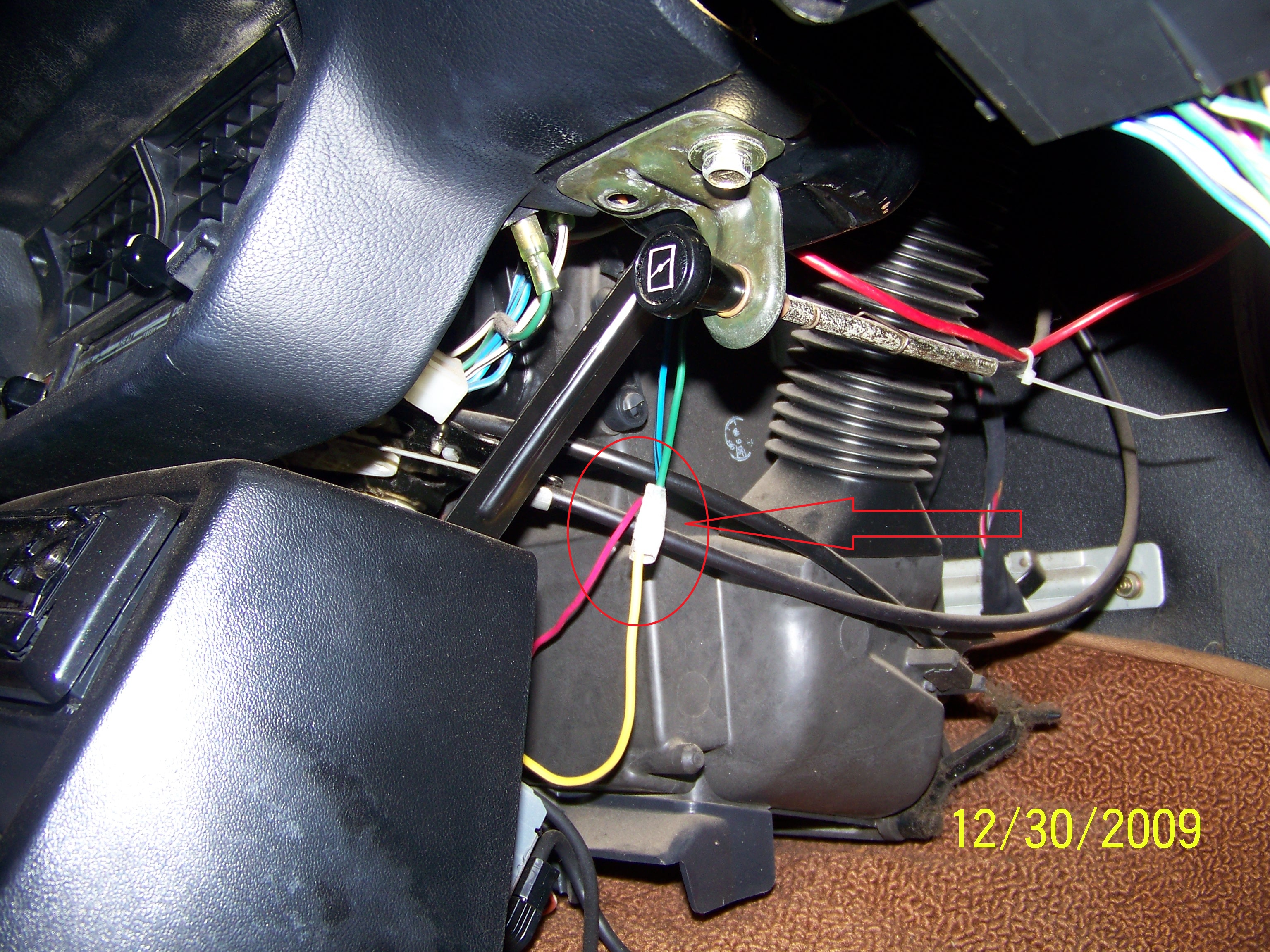

towe001 Posted December 16, 2009 Author Report Posted December 16, 2009 Turtle sitting in the driveway....." do me do me" So i did I did start the shelf when i got my old '55 but wound up cracking into other parts of the wreck along with what can be seen in the background. Anywhat, making up a bit of a list on things i want done after our trip south. Like the stereo - i've a feeling its been hooked up wrong, there's no memory (which i'd say there's no constant 12v) and every time the key gets flipped on the dash lights come on.... Also want to see if its got a thermostat. Takes a good while for it to heat up some days. Electronic ignition - be gone the points gap system Been scooting to work and back driving the turtle like a two speed manual at the moment. The shifter needs to be re-aligned but i'm not too worried at the moment. Thanks JiP, you've given me a sigh of relieve with the x-member. Went out and measured the lengths of the x-member to the end of bellhousing on both the fve speed and the auto and their both about the same - given i was looking at the measurement for the auto at an angle Quote
Taz_Rx Posted December 17, 2009 Report Posted December 17, 2009 Have you accounted for the slight curve in the parcel sheft? A flat piece of MDF is going to give you nightmares trying to fit it back in!! As for the stereo - Yes you'd be right in assuming there's no permamnent power. The yellow and red wires must both be hooking into a accessories power source. Quote
towe001 Posted December 17, 2009 Author Report Posted December 17, 2009 Have you accounted for the slight curve in the parcel sheft? A flat piece of MDF is going to give you nightmares trying to fit it back in!! Urm, depends on which area your talking about with the curve. Before i did the speaker mounts i was test fitting the shelf into a ke55 that i had As for the stereo - Yes you'd be right in assuming there's no permamnent power. The yellow and red wires must both be hooking into a accessories power source. Its what i'm figuring on i'm also thinking that the ground wire has also been connected to a wire for the dash lights, they don't dim down at all. Quote
Taz_Rx Posted December 18, 2009 Report Posted December 18, 2009 Yeah you're probably right on the ground wire. When you're fixing the permanent power put a ring terminal on the earth and ground it to the dash somewhere. The sheft curves up a bit at the back. Quote

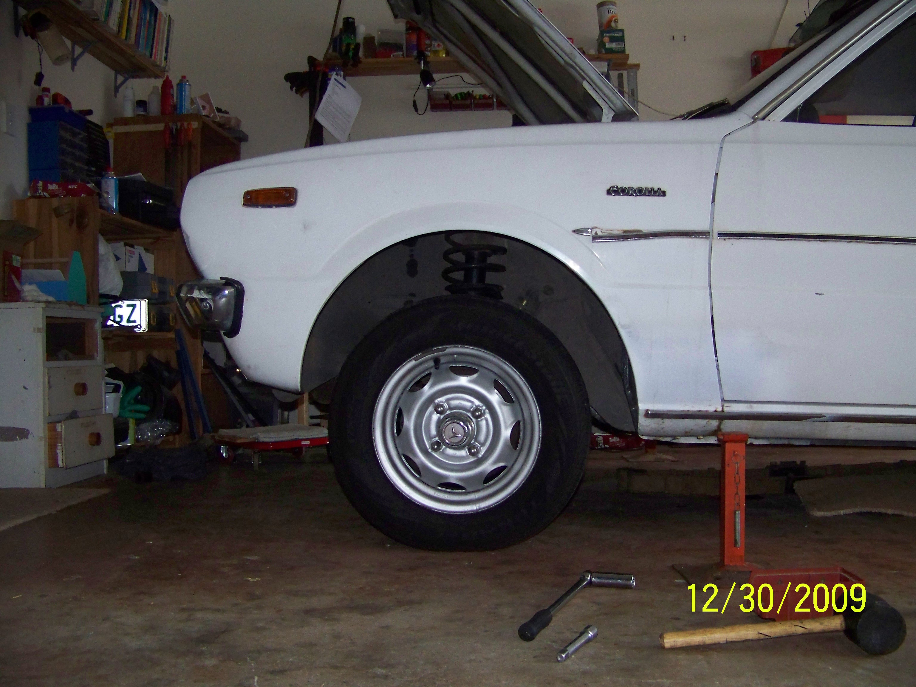

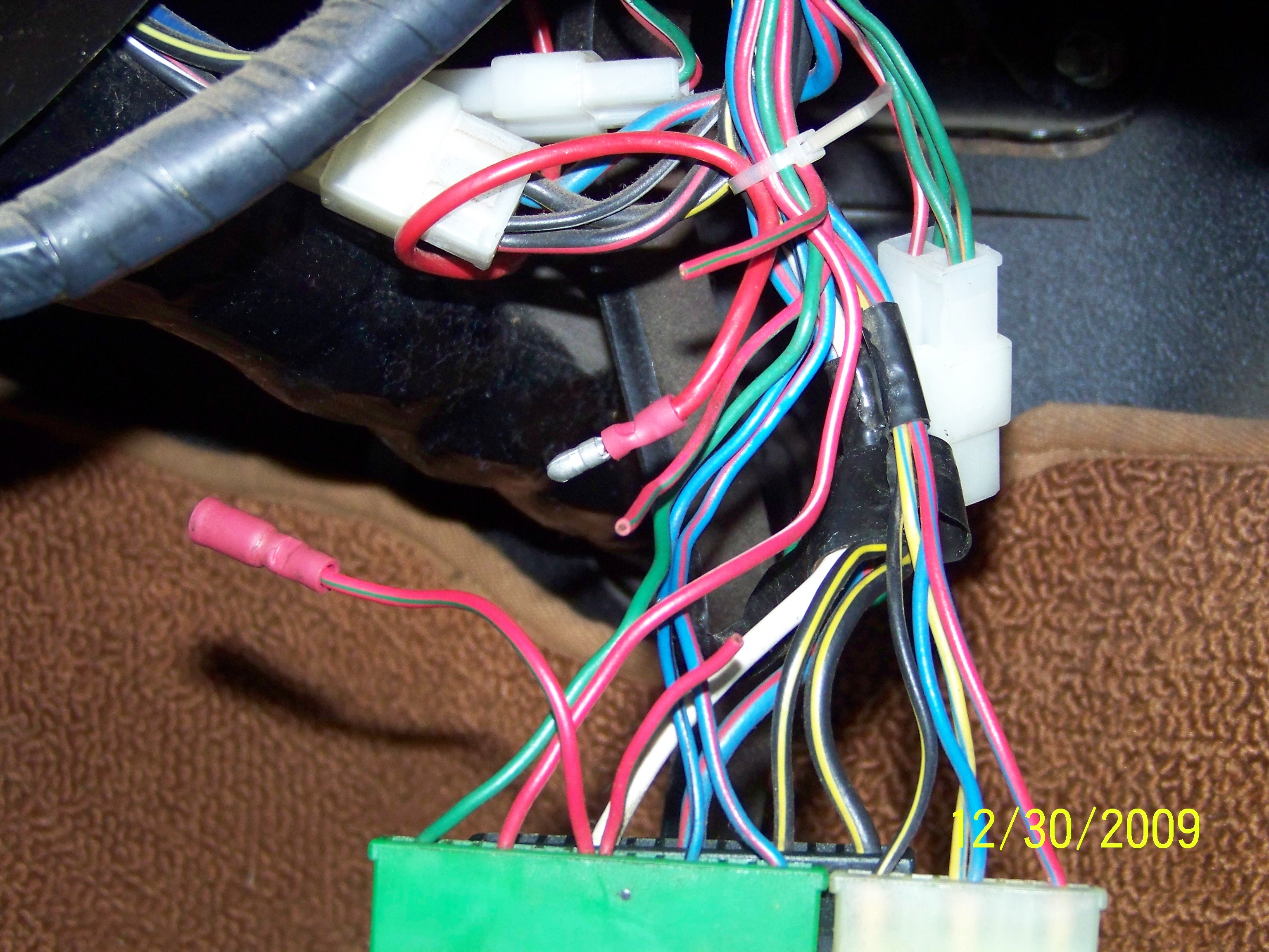

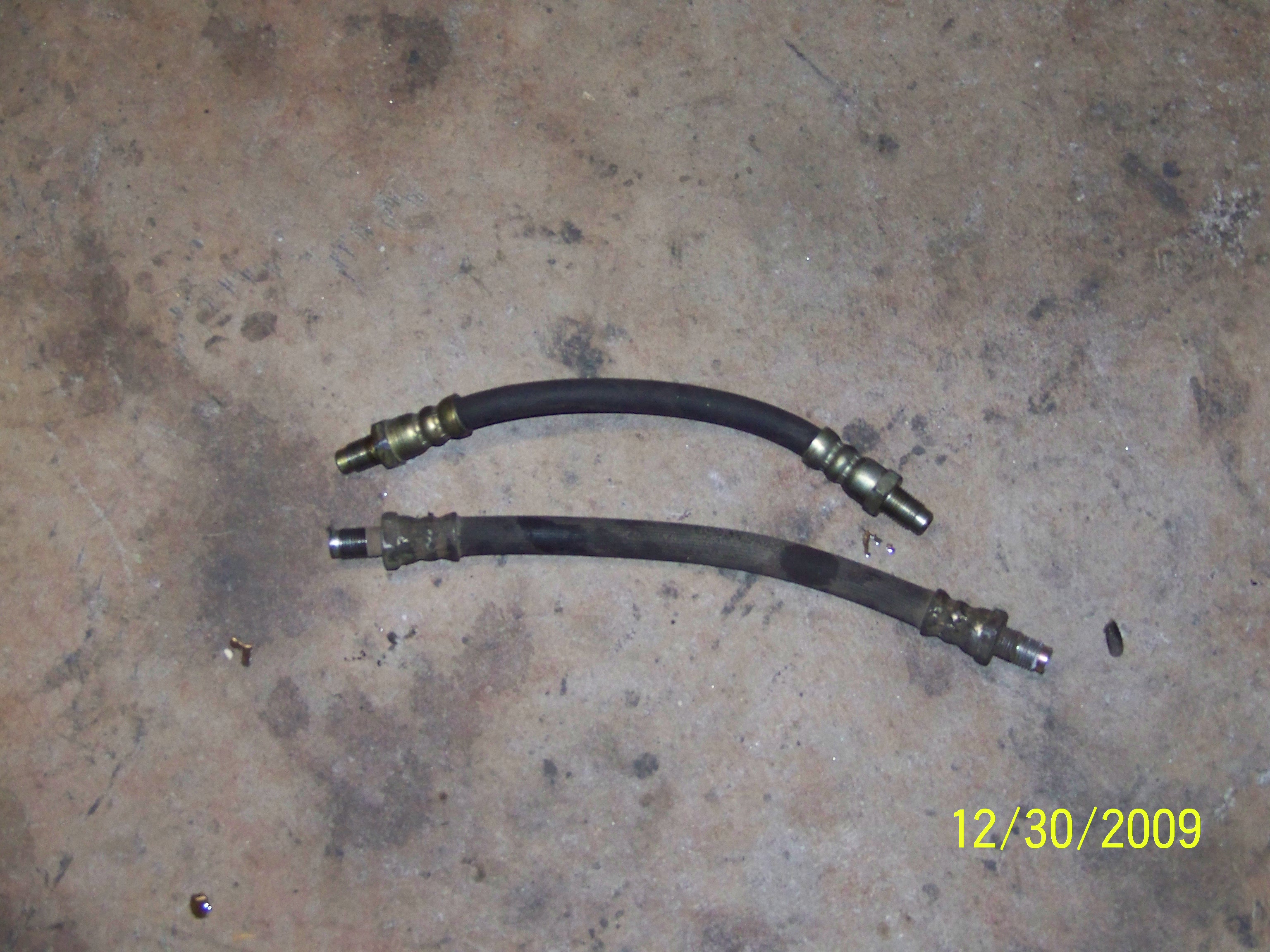

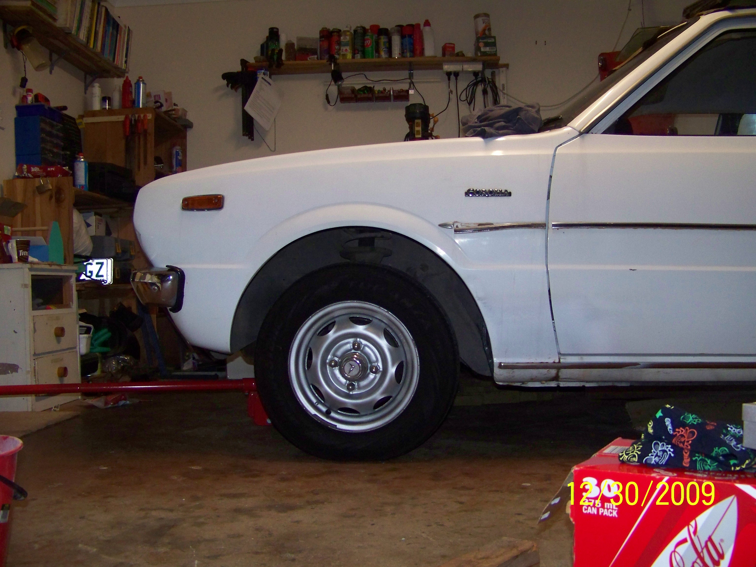

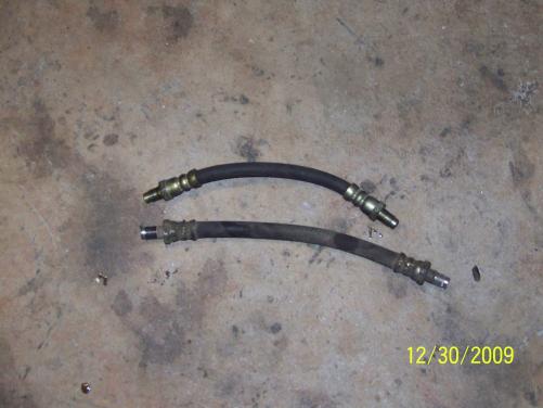

towe001 Posted January 1, 2010 Author Report Posted January 1, 2010 Updates, updates, updates Got back from Wagga on tuesday arvo and started cracking into the turtle. The first port of call was the front suspension - T-18 struts Before After Had a bit of fun fitting the calipers up. The hose that runs from the strut to the calipers was a bit short so had to swap over to the T-18 hoses Now, just have to fix the tail dragger look. Next on the list - Nolathane for the front swaybar. Done Next port of call - the stereo. And what an interesting bit fun that was Don't know why these wires had been cut for, but its the ciggie lighter fuse (constant 12v). one wire goes to the interior light and the other one is for the ciggie lighter. I was a little puzzled as to why the red wire was used to go to the lighter when there was already one there for it.... Anywhat fixed that and i now have a working interior light. Then i found this A new use for surgical tape :) whats not in the picture was the styro foam behind the stereo holding it in and up Oh and figured out the problem with the dash lights and the no memory stereo. The blue/black wire is for the radio (accessory 12v) and the green wire is the dash lights. And with a bit of cutting Front carpet from the old '55 thats in better condition then the old stuff. Just had the cut it a little to fit nicely Next to go on the list is - Finish parcel shelf and stereo Re-fit seats Add a leaf to the rear suspension New rear shocks Fit the gauges i've got sitting here - oil pressure, temp, volt and a tacho (one of those massive mother humping monster tacho's with, oh, 4 shift lights) :y: :( the five speed man box rear tow bar and possibly the pair of Hella Rally 4000's sitting in the wardrobe Oh yeah and an oil and filter change. Peace of mind in that i know its been done and when it was done Quote
