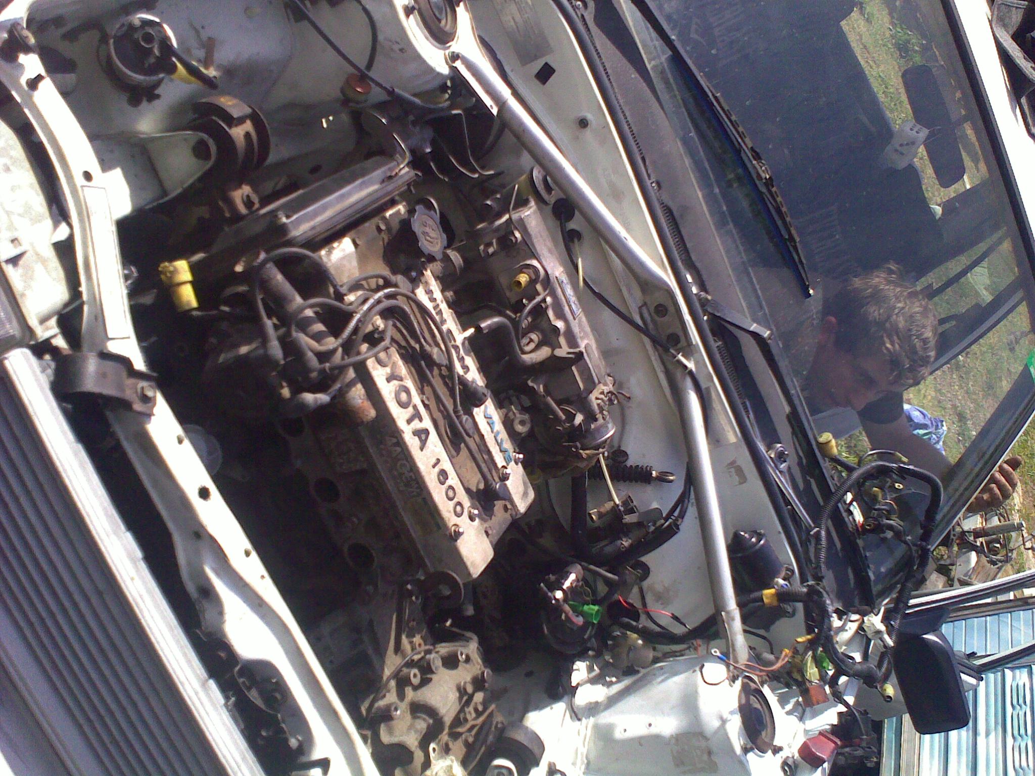

Need Help Identifying My 4age + Box

Does anyone know good jap wreckers around Sydney for parts for it?
Chasing
-Dizzy (Do i need a certain type?)
-Exhaust manifold (Might get a china ebay one and fix it up)
-Altenator
-Starter motor
-AFM probably
-Stock ECU for now (Any type or should there be a special one i need to get?)
-1 x Cam cover bolt, the little silver ones
-1 x flywheel

1988 corolla wtf?? why go into all that detail with dizzy coils... what 4age has a coil in the dizzy anyway? none. get the right one to start with, no problems.
beauc that version came in ae86, aa63 or at141. ie the rwd bigport tvis bluetop 3rib engine. the fwd version come in ae82 and at16# celica etc. the head/block/sump on fwd are same as rwd version.. it's just the bolt on stuff that varies. the jdm map version is rated at 130PS which converts to about 95kw.
you have a T50 there with 4a bell.. it looks like clutch fork and slave cylinder is on exhaust side.. which suggests its from an aussie ae71 or ae86?
"Chasing
-Dizzy (Do i need a certain type?) - a bluetop one.
-Exhaust manifold (Might get a china ebay one and fix it up) - a std ae86, aa63, at141 4age manifold will work
-Altenator- the ae82 fwd 4age alternator also fits and works. double check plug is same.
-Starter motor - any 16v 4age with starter on exhaust side should bolt in. some may have different position for the wiring.
-AFM probably - use a map sensor and map type ecu = better
-Stock ECU for now (Any type or should there be a special one i need to get?) - a bluetop one that matches the engine loom.
-1 x Cam cover bolt, the little silver ones - they use studs and chrome nuts don't they?
-1 x flywheel - any 8bolt 4age flywheel will bolt on the crank.. but later versions have a larger clutch so you'll need a matching clutch and clutch plate spline to suit the gearbox used. 4agze clutch assy won't fit in a t50.
late k50 shifter (ke70) and shifter housing fit the late t50 (te71/ae86/tt141).
Also the lo/hi shifter from some 4wd hilux box fits in a t50, but can't remember if its the W56, G52 or R151. it is shorter too but you'll need to bend the shaft backwards to make it feel right otherwise it sits too far forward.

AE25 - Your a legend mate, obviously you know a lot about the various 4age!
Thanks heaps for giving me all that information!!!
I will start the hunt this week for all the random bits, car was going to be pulled apart today but stuff keeps coming
up, taking it for one last drive to Sydney today it will be the last time it gets driven till it's completed!!
"Chasing
