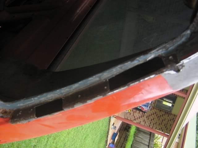

the rest of it done
roof and windscreen
rear wagon window PS, thought the bit in the middle was ok, but tuned out to be real thin, so i cut the whole piece out.
