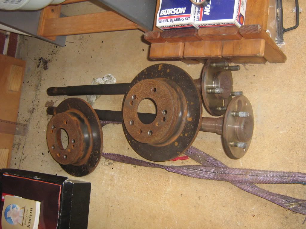

Dropped r31 axels off to get restud. Bought new wheel bearings.

Picked up newly 5 studed axels, still $80 per side, same as last time i got it done.

Got axels and disks back, looking good.
