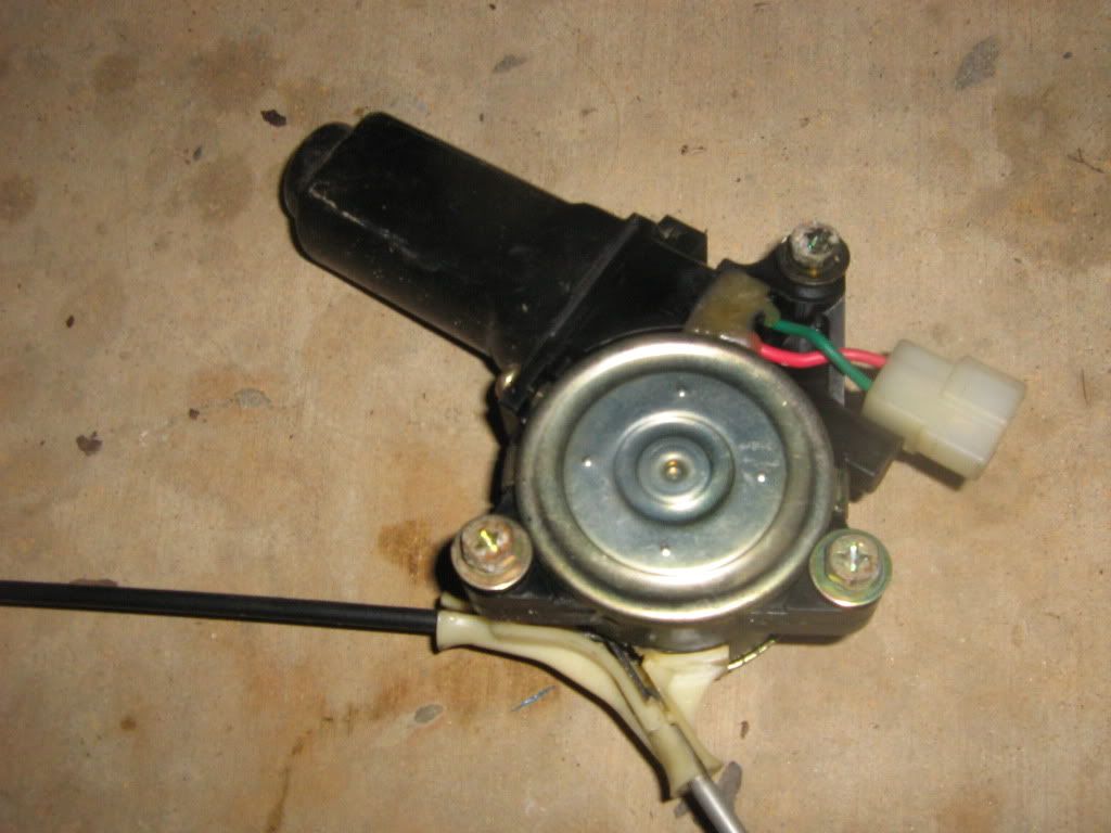

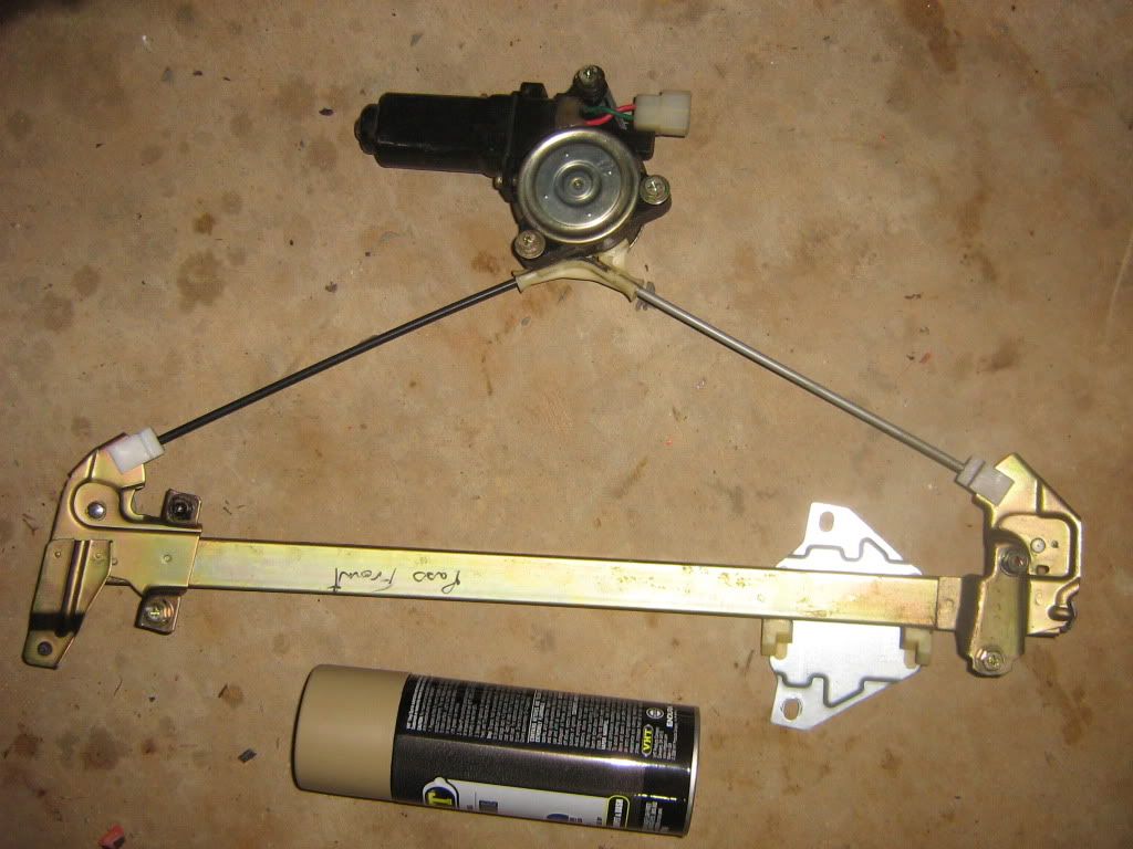

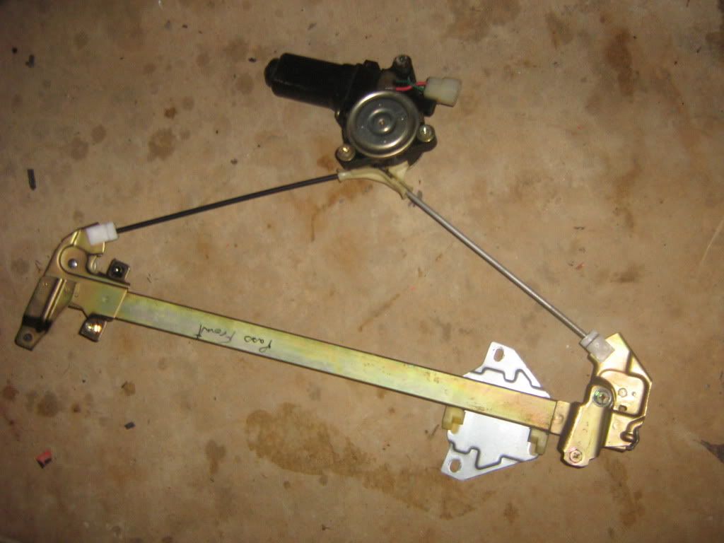

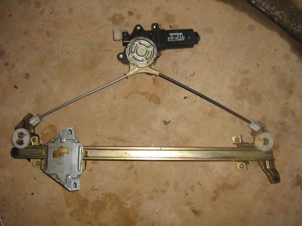

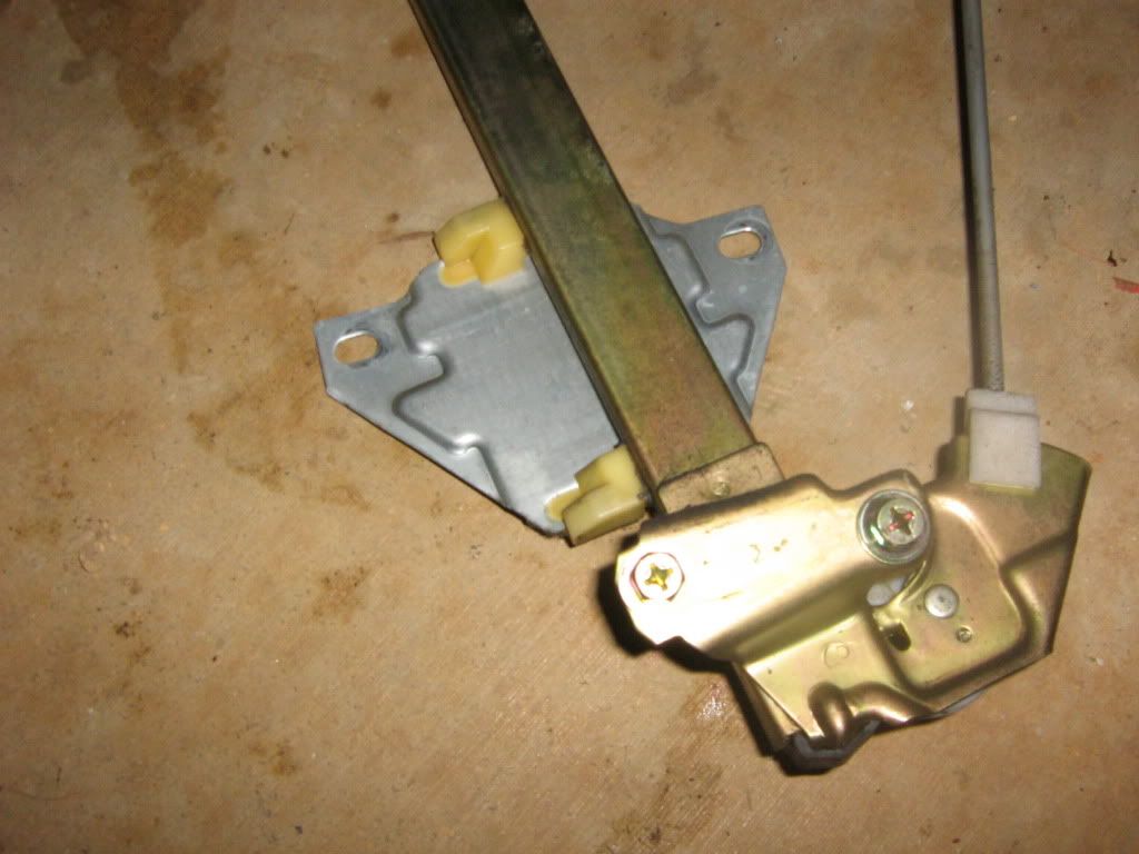

ok so you'd actually need to make a custom bracket for the glass as well.. hmmm interesting i imagine lining it all up will be difficult but not
impossible. i have some glass laying around i may see what i can come up with.
if i come up with something good i'll do a guide.
hoorah for u pull it being open very soon.
yes but your left with a whole in the door trim and that pin for the winder sticking out..
they provide caps but still.
i'd prefer to try and mount this type of unit.
