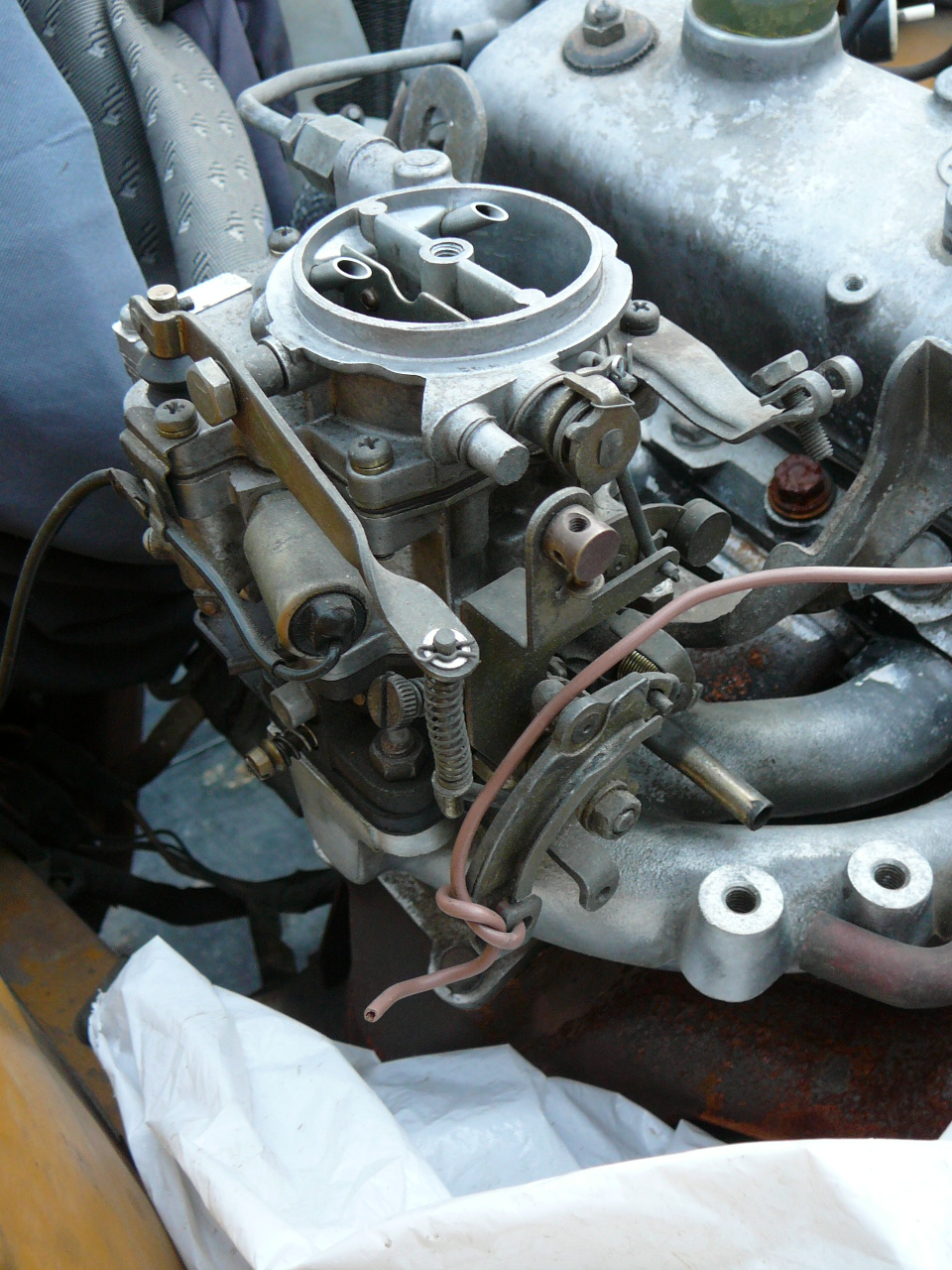

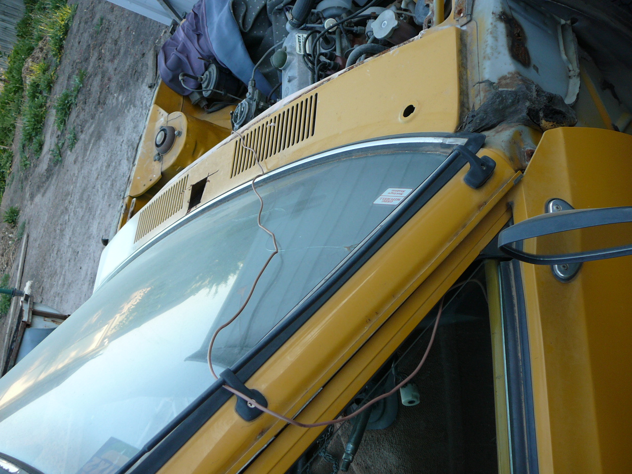

And how would you have fixed it??
I don't see that as dodgy AT ALL. I see that as the mark of a true thinker. Nice work Altezzaclub :)
thats how i fixed the "f@$k now how am i gonna move it" problem :(
