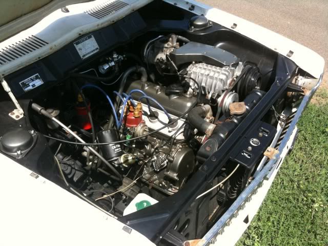

kickn5k Posted December 25, 2010 Report Posted December 25, 2010 I still think the tune issue is in the FPR. Are you going to use that return line setup? I think you must have been looking at my car too much. White with black sill and powered by a blown 5k.haha Are you going to chase 100rwkw? It'd get close with a big stick and some boost. Stu. Quote
TheNOBBLER[RL] Posted December 25, 2010 Author Report Posted December 25, 2010 I think your right Stu, seems I have to much fuel pressure and the reg can't get it down to where I want. I have a really nice aeromotive carbie spec fpr that I might use if I crack the shuts! It's a return style reg so I will need to run my surge tank and second pump along with a second fuel line. More mucking around but I will NEVER have fuel pressure issues again! Don't worry, I'm painting my 10 next year! Getting rid of the black sills for good! 100kw at the Tyres may as well be my goal, it's only a carbie setup but with the right cam, more boost and a decent programable ignition I should comfortably get there. Will be plenty of box n diff breaking power! Will be back home Thursday so I will be getting back to working on it but then I'm off again on the second. Still have plenty to do! JP Quote

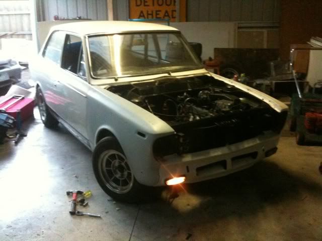

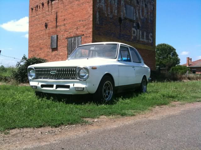

TheNOBBLER[RL] Posted January 16, 2011 Author Report Posted January 16, 2011 (edited) Well after getting all excited about the first trip up and down the street I got stuck into getting it closer to club reg. I have rebuilt most of the front end including converting to ke26 top spring seats and shortened ke70 front springs with adjustable Koni reds doing the dampening. It's stiff but not to bad at all. I still have a pedders sway bar kit to fit (thanks Stu!) as well. Rear shocks are just munroe gas for now, it's too soft so i need to add a leaf to the pack and have them reset a little lower, just about to lip my rear guards now as they are hungry buggers eating my tyres up :) I have plenty of bigs to iron out as yet but I am working through them, the big jobs are done though so I'm feeling pretty good although I only have two weeks left until the great ocean road trip so it needs to be driven to iron out the rest of the bugs and continue tuning to get it right. I have been working on it from 7am til 2-3am most days as I had alot to do, I'm back at work tomorrow so that's the end of that! Not to mention I'm shagged! I still have some rust to touch up, the whole far will be getting painted later in the year so it's just a neaten up for now, re paint the bottom of the car black, it will all be white after the Respray and I need to paint the primered guard and boot and re assemble. Just a little bit to do! Still needs a wheel alignment and I need to figure out my peddle travel issue, might have to swap masters to another one I have that I know works well. Enough dribble, here are some pics. JP Edited January 16, 2011 by TheNOBBLER Quote
kickn5k Posted January 18, 2011 Report Posted January 18, 2011 Oh s$@t I forgot to mms those pics of how my sway bar fitted. Looking good were those shots(other than the shed shot) taken on the same day as Tate's car? I'm keen to see how this goes with some more fuel in the main jets. F'me she's punchy down low, and the sc14 over my sc12 seems to give instant boost. But I do have a fair camshaft in my 5k. Is your car blown though? Just cause I couldn't here it. Lol stu Quote
