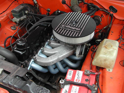

so on the weekend me and my oldman are goin to pick up a 265 and a 3speed g/box from one of his mates houses free of charge ;)
asoon as he said about it i went into a frenzy and decided i want to turbo it and chuck it in a corolla for a burnout/fun car
what are your thoughts on this?
and from my experiaence of my dads chysler addiction i kno they go very very well for a straight six!
anyone kno what the hardest part of doing this would be? I'm guessing it will be modding the trans tunnel?

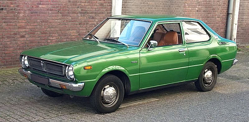

i hope its not going in that green corolla that thing is sick stock leave that one and find another one
p.s I'm a huge hemi fan but
chappo haha nah man just a google image to give people an idea i wish i had a minta like that

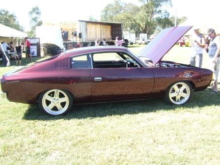

just look at the E49 RT Chargers they ran the same 1/4 mile time as the much overrated XY GT HO
which had a 351 and 4 speed vs the Charger with a 265 and 3 speed

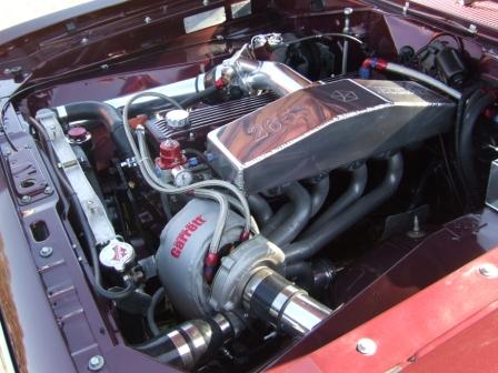

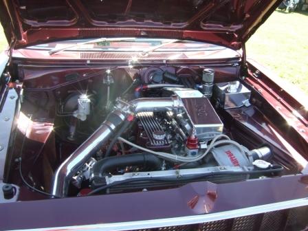

I was up in Albury for the Chryslers on the Murray car show the other week and saw a 265 hemi with a pretty serious turbo the guy is from Melbourne and has done an awesome job.
I first saw this car on the Eastern fwy and nearly crashed trying to get a better look!
It still needs bigger injectors so he hasn't really seen what it's capable of but should fly!
Good luck I would love to see a turbo 265 in a corolla.

daggers thats once sexy charger :lol:
