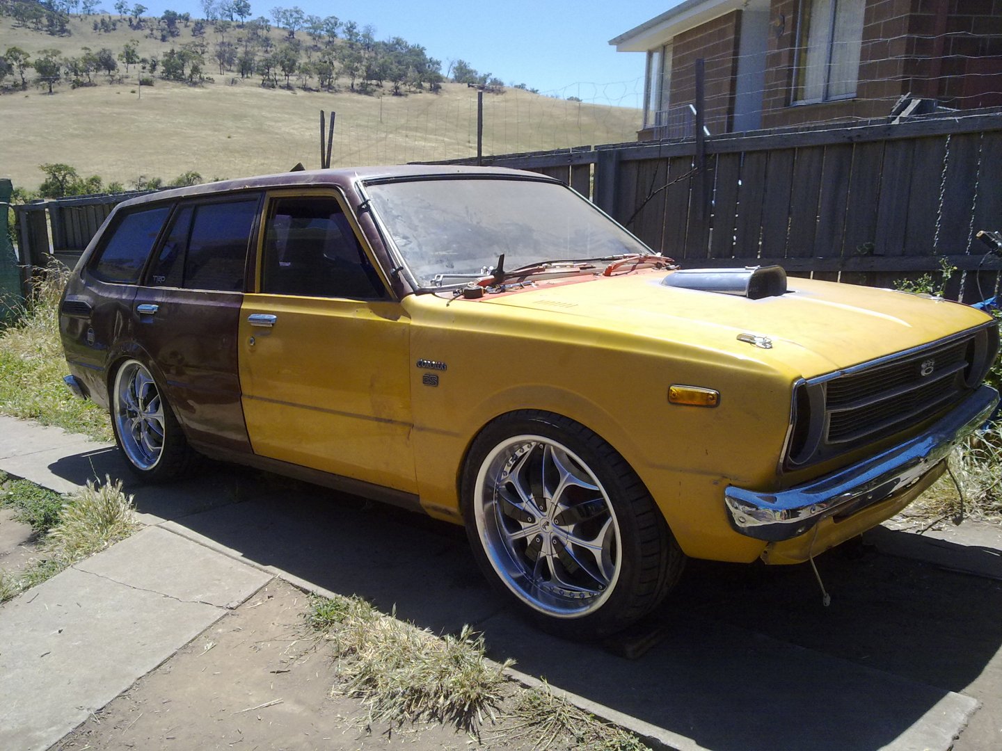

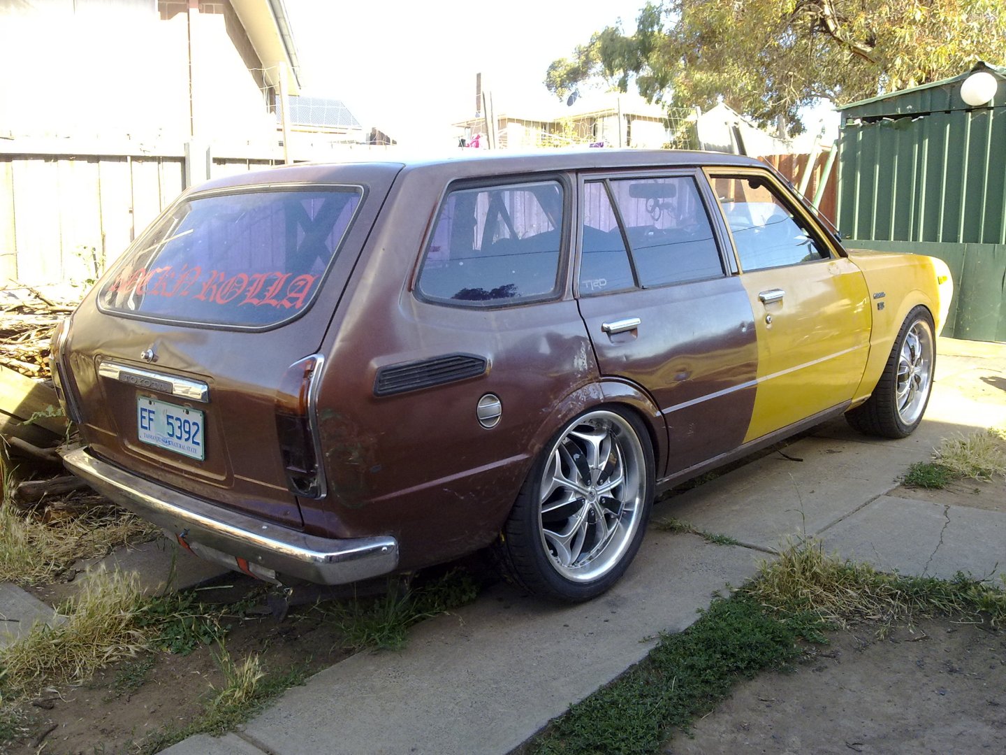

Hi I'm new to this site so i thought i would put abit up about my 77 rolla wagon I'm currently doing.
I've put a worked 253 holden v8 in with a shortened 336 commodore diff and commodore struts with kinga discs and running 18x8 custom wheels.
So far it has been a pretty easy build I'm just at the stage of body work so it can get painted.

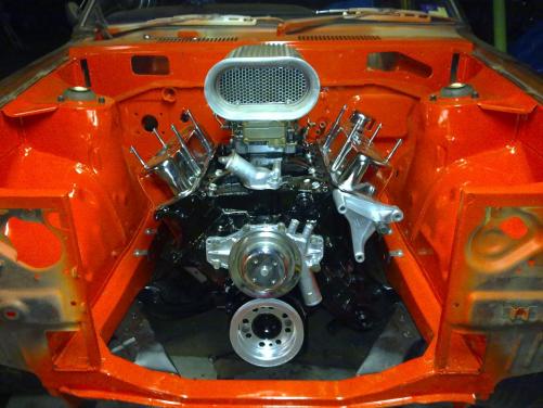

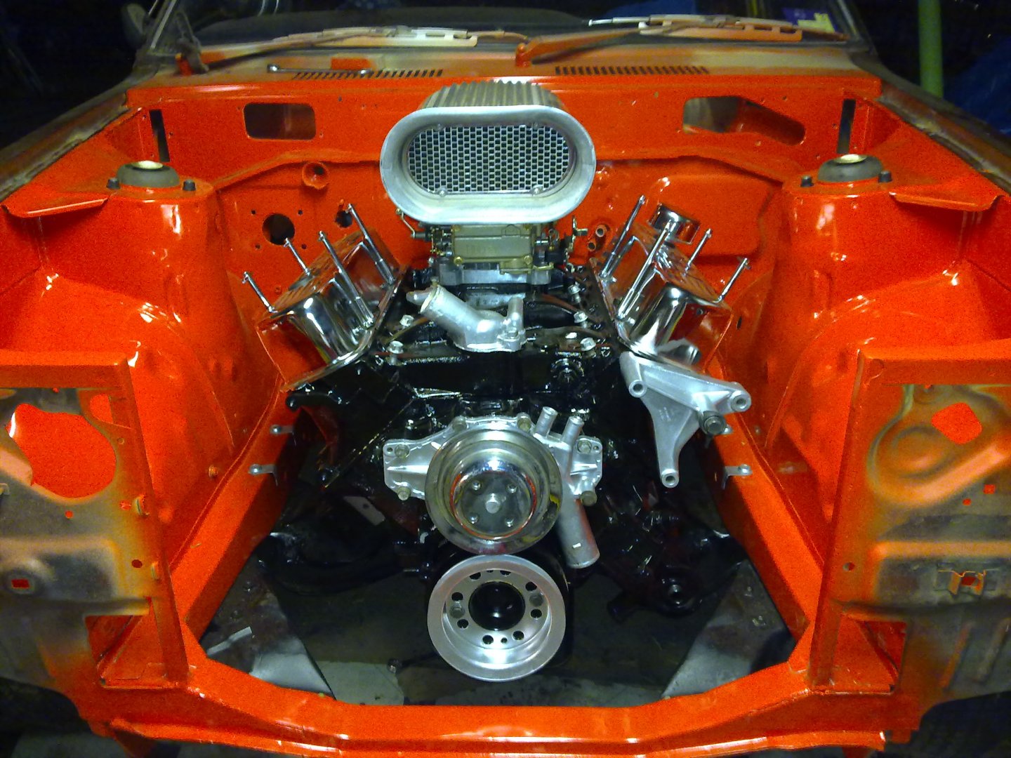

The car is being sprayed the color the engine bay is.
Sweet man, I have never actually seen how much room there is around the 8's in these things, Looks good.
Sweet mate, bay looks good.
The rims aren't for me, but otherwise good on you. :yes:
