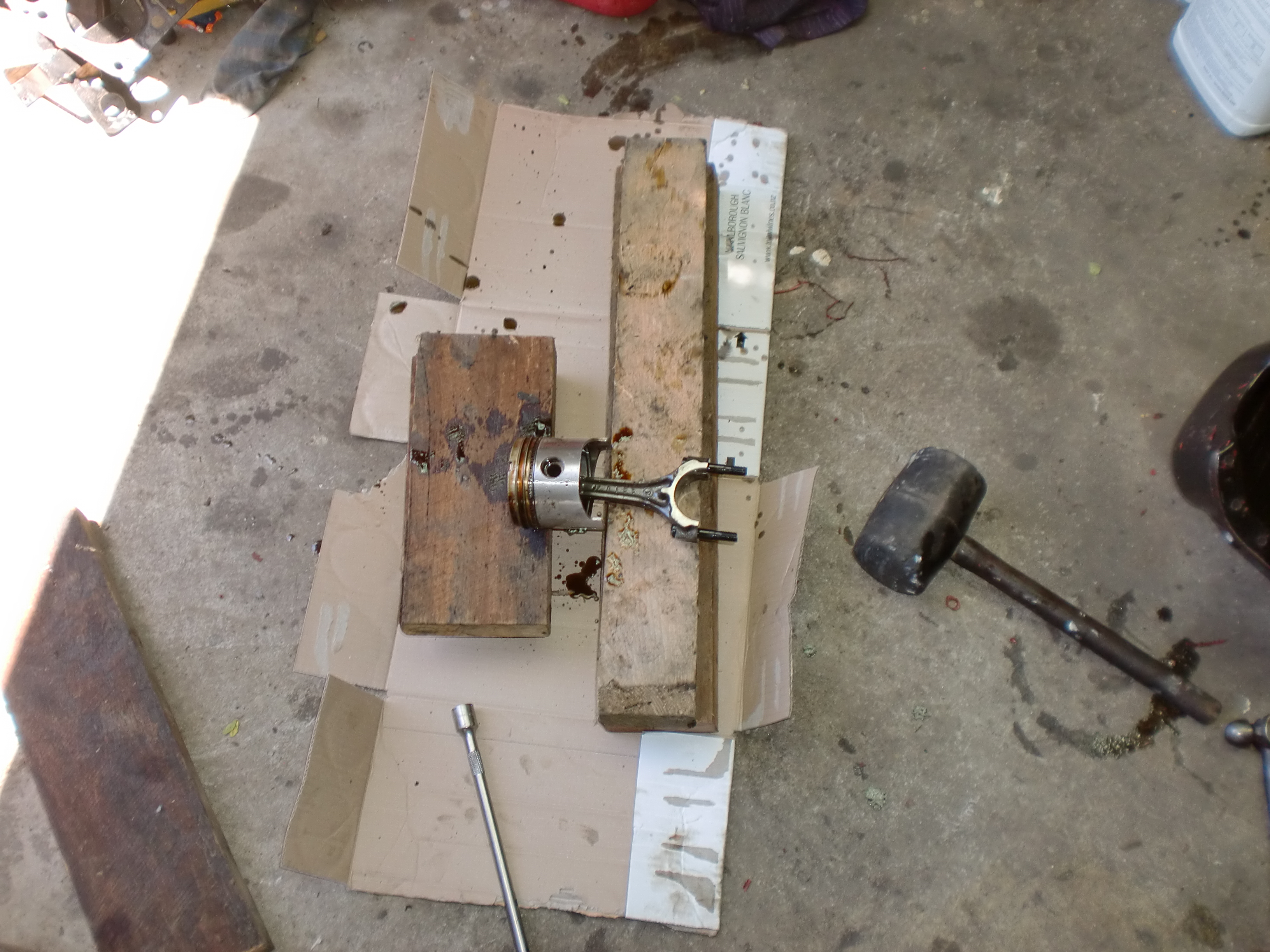

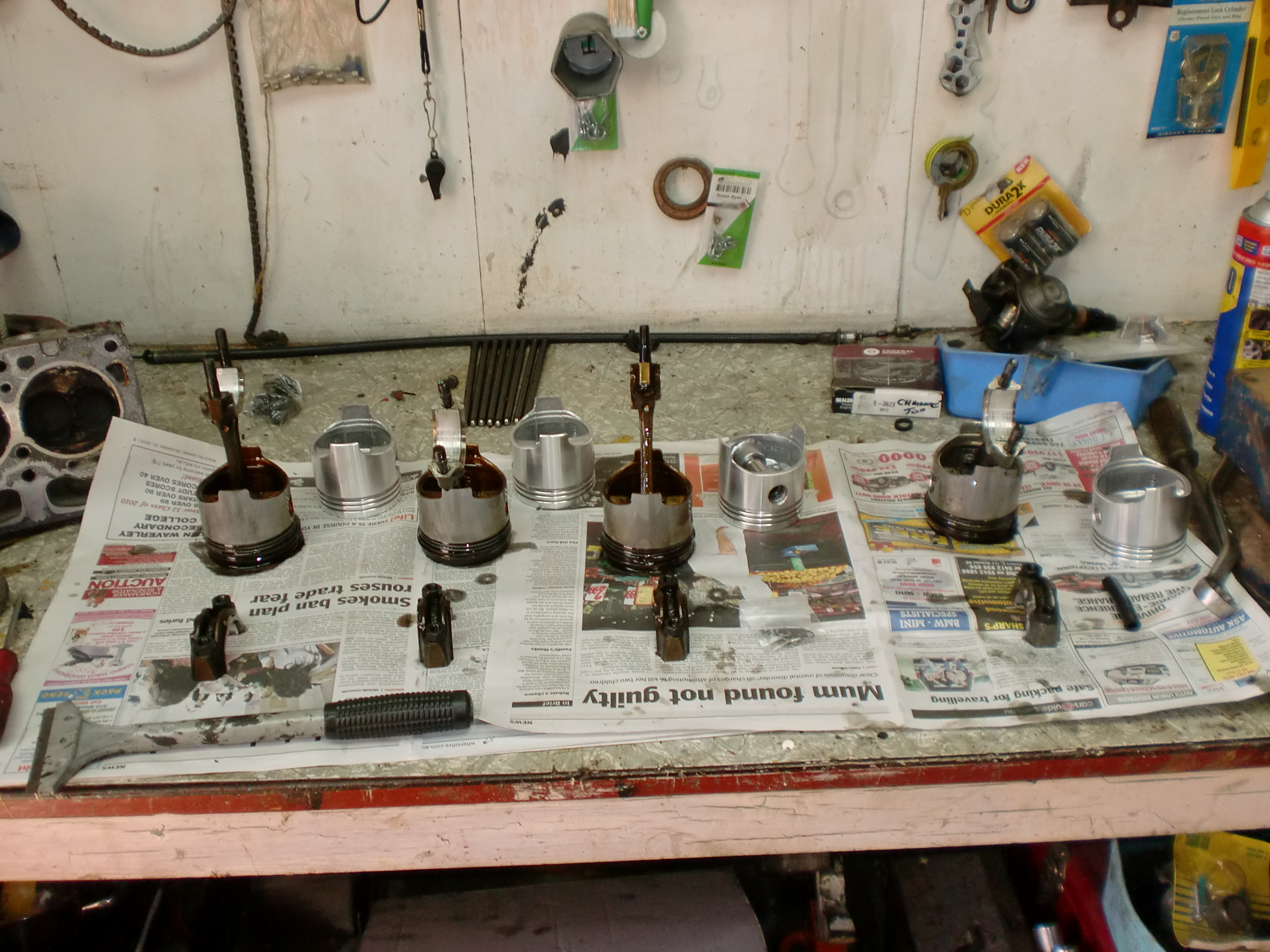

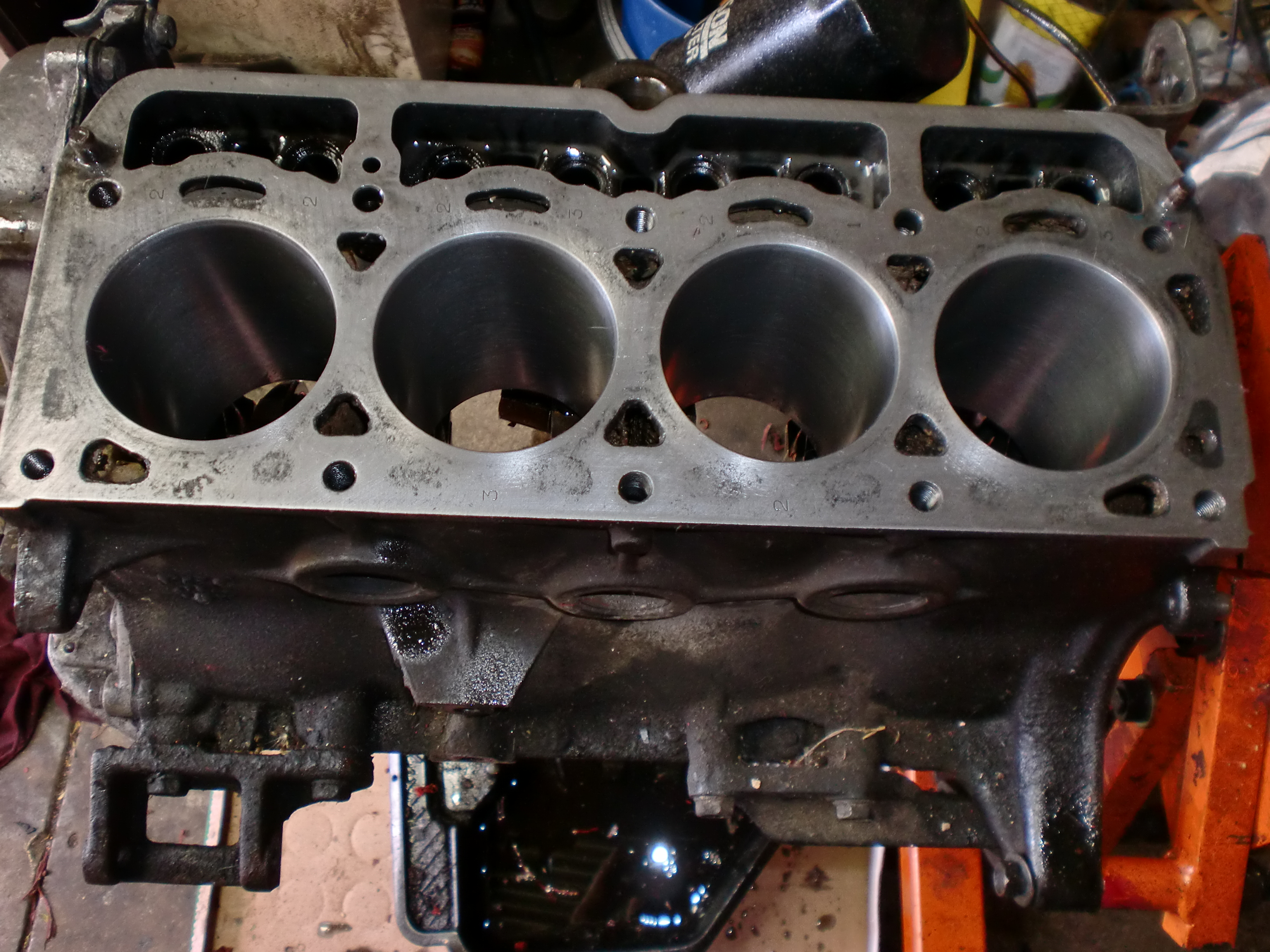

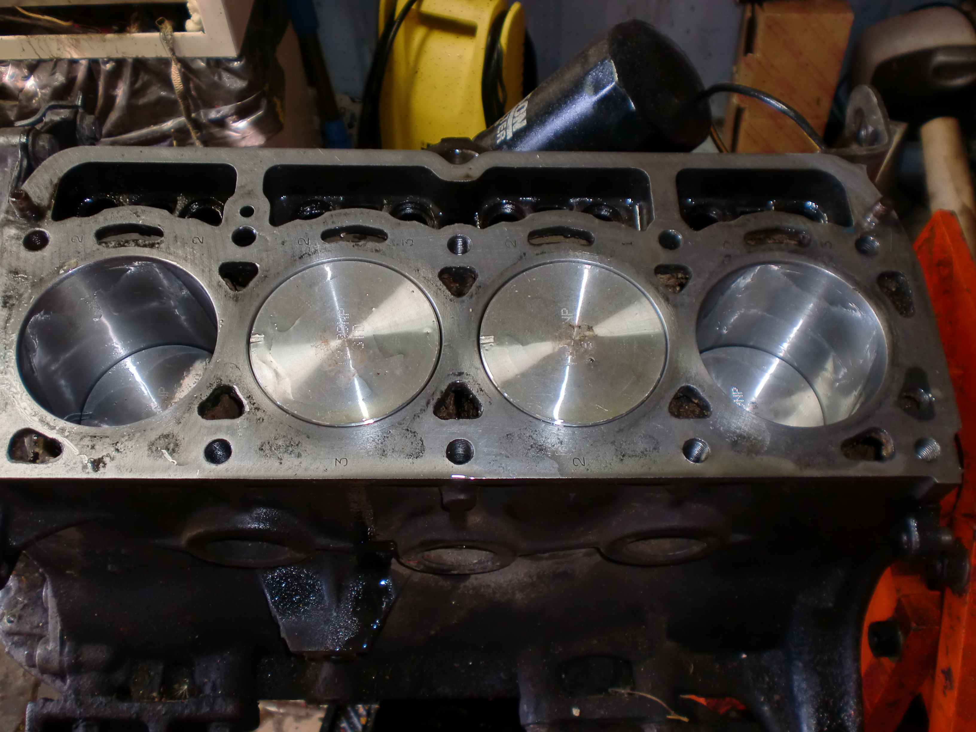

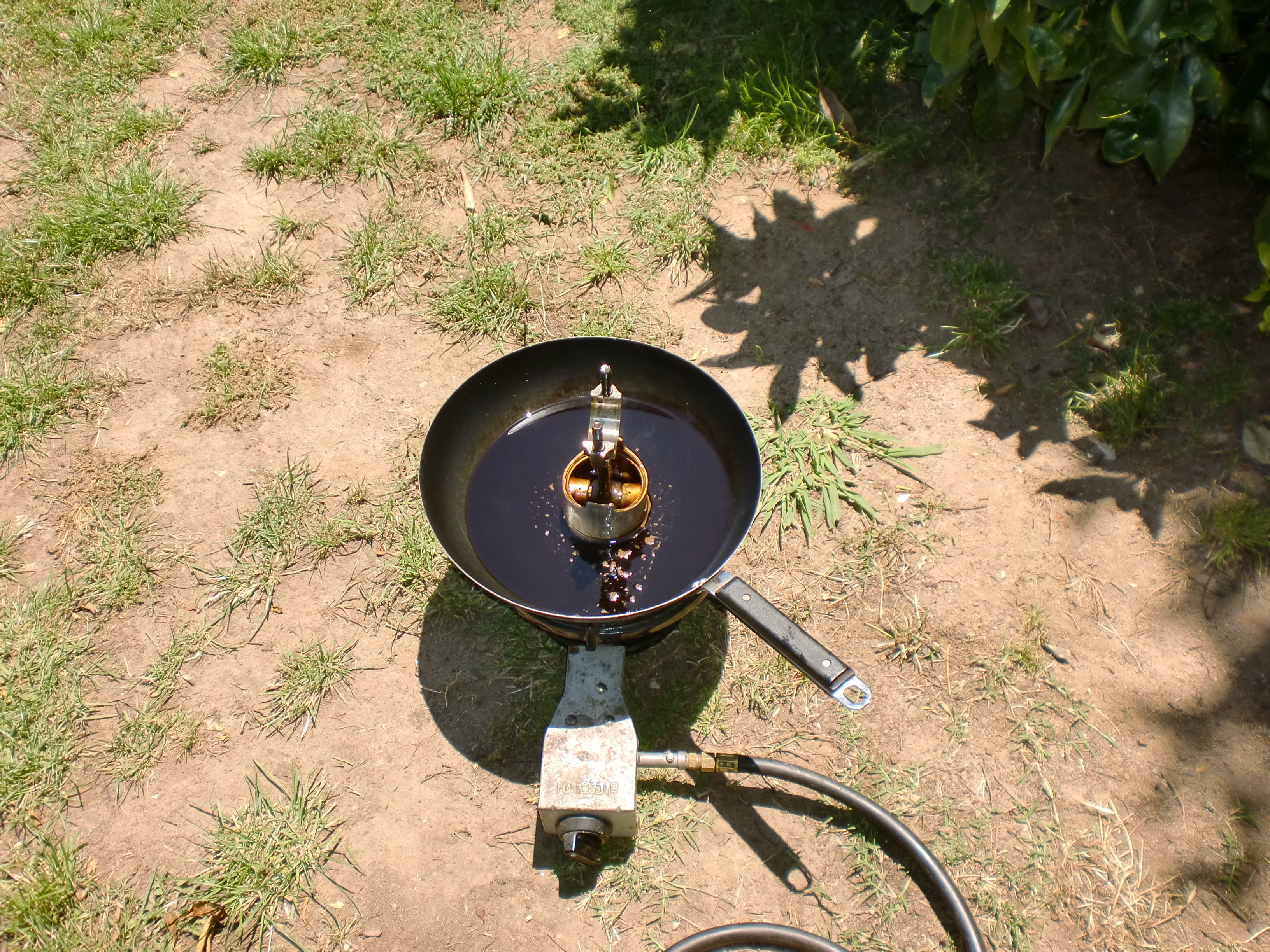

Today I heated up the old pistons in sump oil, (using a wok burner) pushed out the gudgeon pins, honed, cleaned, refitted and replaced.
On the head, I'm going to put in some new valve stem oil seals, lap the valves and get it skimmed.
Then reassemble and should have a nice, tight, slow and reliable POS.

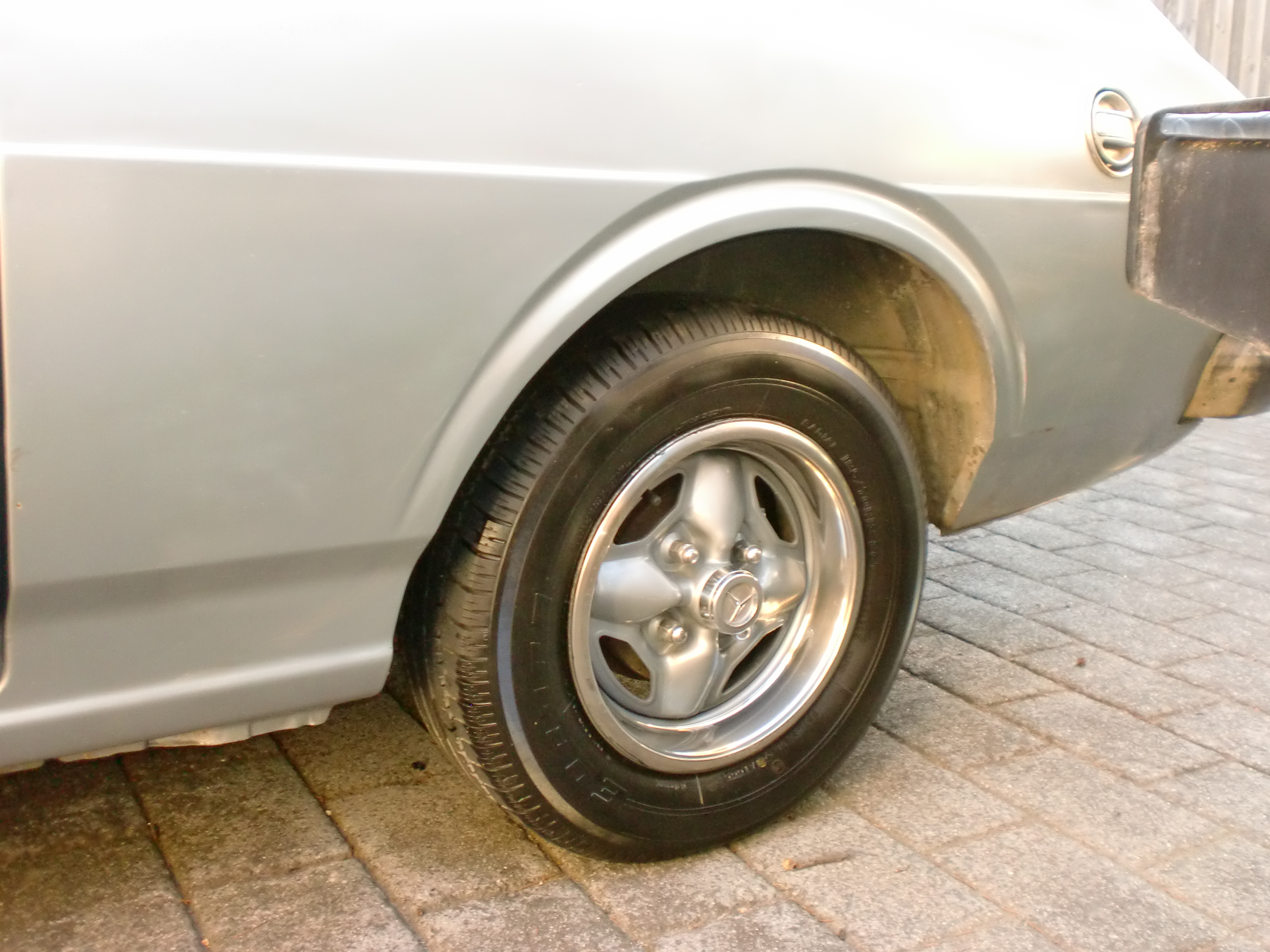

When I cleaned up the T18 rims i realised they were a dark silver colour
I ended up painting the rims body colour, a lighter shade of silver 'cause I had the paint laying around...and I'm a tight arse. :rolls:
Got the tyres fitted and put them on today. When bolting up the fronts, I found they hit the calliper, just. I had to do something I didn't like doing. I ground off the lip on the calliper. Was only a couple of mills and should't affect the calliper.
