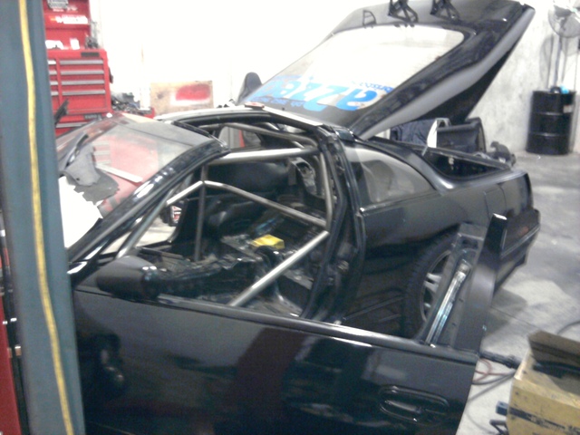

Trev Posted September 9, 2010 Report Share Posted September 9, 2010 But you're not a REAL spraypainter's apprentice, how could you possibly know? Used to work at a panel beaters one day a week, brother still works at one. FWIW, this car was painted in 2k in the workshop with no baking at all, paint hardened fine: Yes it still needs a colour sand. Quote Link to comment Share on other sites More sharing options...

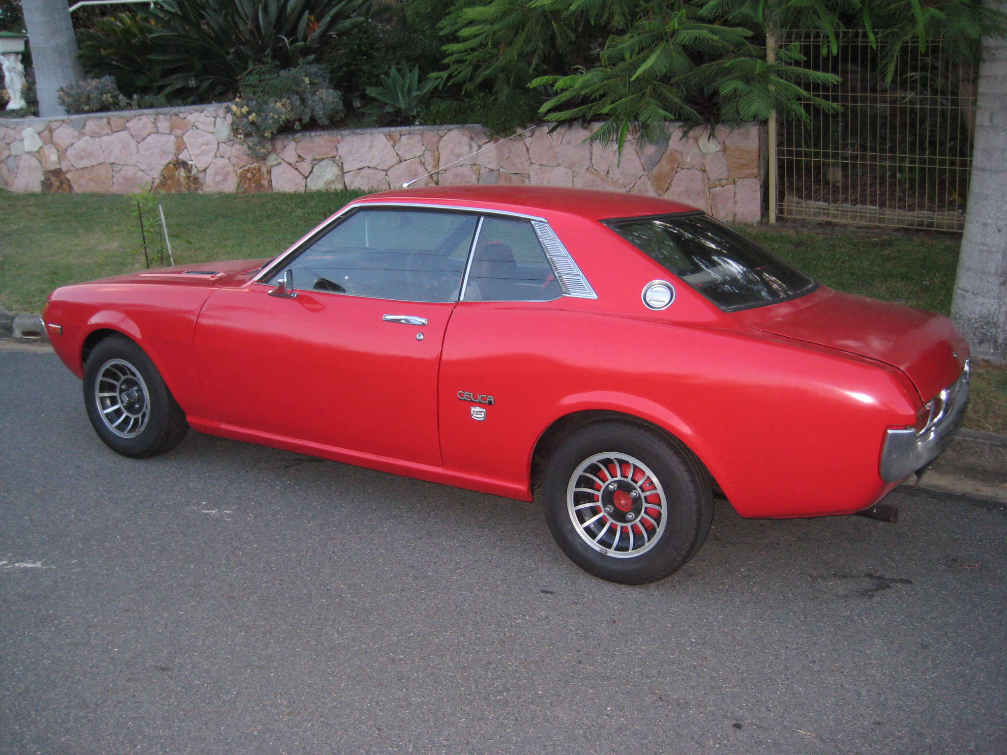

TBR Posted September 9, 2010 Author Report Share Posted September 9, 2010 (edited) This is project TA22 no 1 in 2003 ;) Not too bad for an under house job ! Who said Acrylic sucks ? :jamie: Edited September 9, 2010 by TBR Quote Link to comment Share on other sites More sharing options...

Redwarf Posted September 9, 2010 Report Share Posted September 9, 2010 Hey Trev, who built the cage in the black thing? It looks familiar.... Quote Link to comment Share on other sites More sharing options...
Trev Posted September 9, 2010 Report Share Posted September 9, 2010 Hey Trev, who built the cage in the black thing? It looks familiar.... Ummm, can't really remember, might of been racetech. Quote Link to comment Share on other sites More sharing options...

TBR Posted September 9, 2010 Author Report Share Posted September 9, 2010 (edited) Woaaaaaaaaaaaaaa there guys.... This was supposed to be about how to "cheaply" paint a car ! If you want a tech paint thread, create one ;) And BTW, the 03 paint jobs still going good 7 years later :jamie: Edited September 9, 2010 by TBR Quote Link to comment Share on other sites More sharing options...
