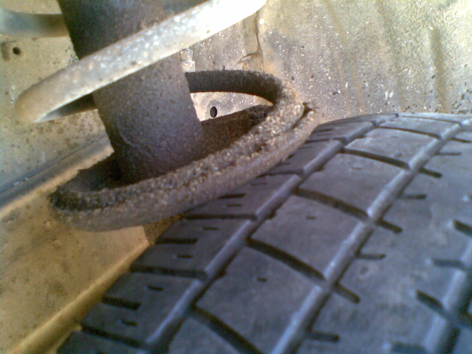

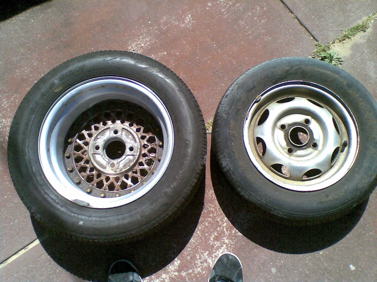

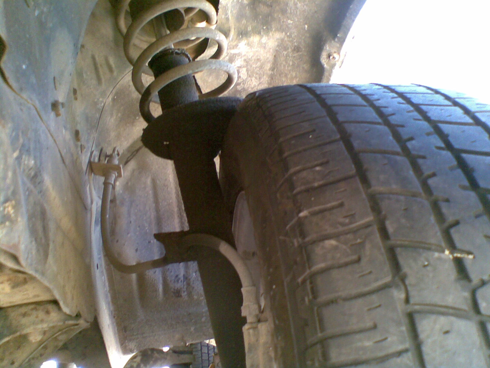

October 16, 201016 yr Author comment_476039 soooo today was fitting my new wheels and bam! the front wheels touch the struts!! I had a feeling the would happen Can you please help me with a solution. If already come up with a couple of solutions and would like your opinions Wheels size : 205/60/R15 didnt have offset stamp so measured it 120mm 1)Spacers - But illegal in Wa :( 2)Flipping the rims - Not to sure if it would work,if I do I'm going to have to chop the wheel archers.But I don't mind i got arch flares 3)Changing the Camber - Would need someone to walk me through the process. 4)Changing the Tyres - NOOO , to much of $$$$ 5)Strut coversion - Need more info Cheers Edited October 16, 201016 yr by Spencer Report

October 16, 201016 yr Author comment_476059 Really don't want to throw cash into new tyres, Whats stopping me from flipping the wheels and having some MEGA DISH!! like this http://www.rollaclub.com/board/index.php?showtopic=45834 Report
October 16, 201016 yr comment_476090 Isn't it under $200 for the adjusting kit, where you cut the spring seat off and weld on a threaded tube with a wind-up seat?? They're smaller diameter than the stock one, and take the newer small diameter springs. ..and camber is not on the list- you would need lots of +ve camber and it would handle worse than stock. Can you flip the rims? If they are designed for it then you'll need to see if the stub axles will take the new loading from that offset, and it they are still legal with the outside widened so much. Ah- here you go http://www.rollaclub.com/board/index.php?showtopic=25858&st=0&p=296005&hl="cheap%20coilovers"&fromsearch=1entry296005 Edited October 16, 201016 yr by altezzaclub Report
October 17, 201016 yr comment_476110 Really don't want to throw cash into new tyres, Whats stopping me from flipping the wheels and having some MEGA DISH!! like this http://www.rollaclub...showtopic=45834 If you do that it puts stress on your bearings, but its up to you. Report

October 17, 201016 yr comment_476188 problem is 15 inch tyre in a 205/60/15 ... change to a 195/50/15 ..problem solved i run 15 x 8.5 -17 with 205/50/15 on the front of my car under hand flared stock guards , profile of tyre is the problem Report
October 17, 201016 yr comment_476206 Ive got 15x8 +-0 all round with 195/50R15 tyres on and hand flared the guards this way http://www.rollaclub.com/board/index.php?showtopic=29887&st=0&p=473536&hl=+guard%20+flaring&fromsearch=1entry473536 Report
