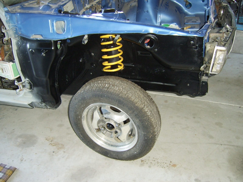

This week, Ordered the correct (lol..) bonnet, and started to finish off front wheel bearings. Missing a washer in the wheel bearings, so off to wreckers this week, put it all back together next week.
I did however manage to purchase silver and red high temp paint. Brake backing plates are going silver, and calipers are going hot red. Sway bar is going red as well
Justin may have a pic of the silver backing plates, not sure how they turned out, as weather was trashy yesterday.
In years to come.. ill regret not just doing everything in factory Black !

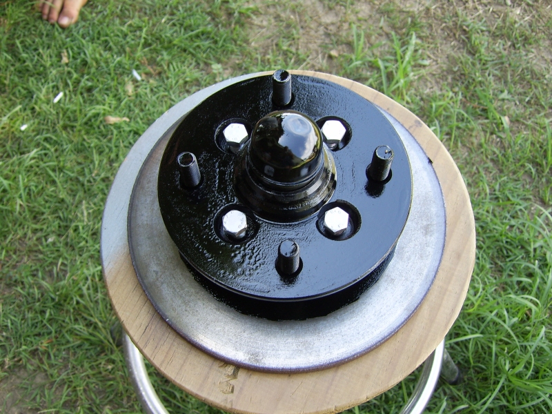

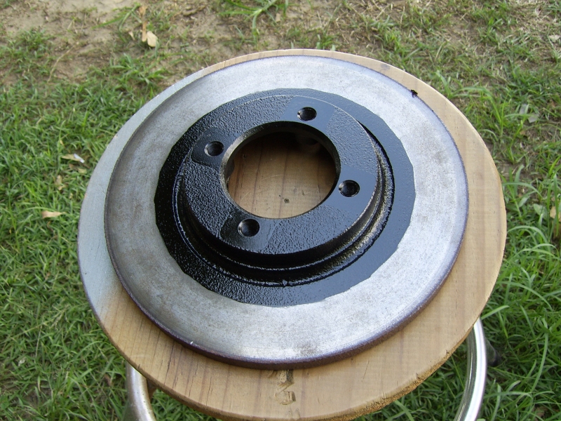

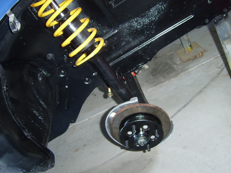

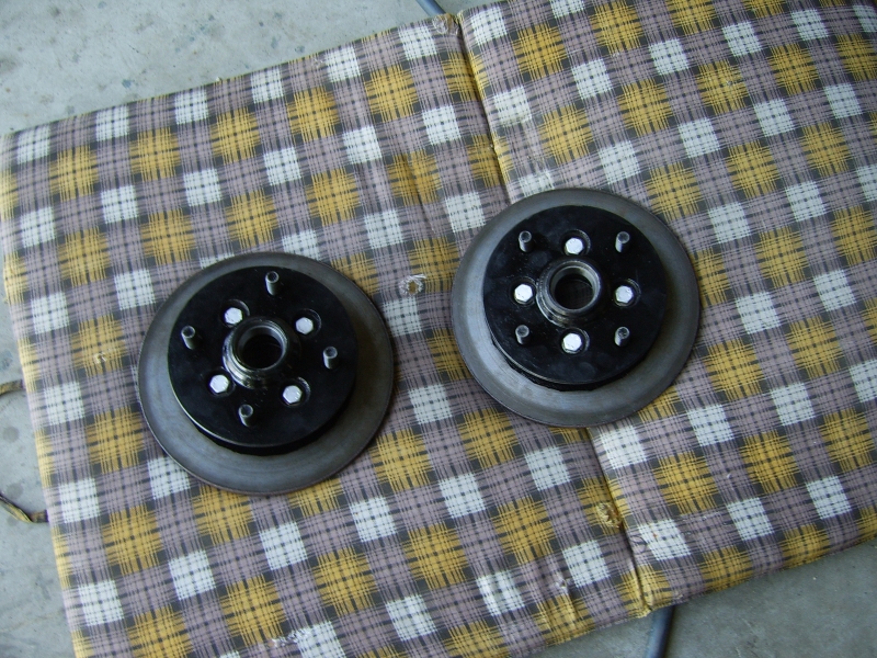

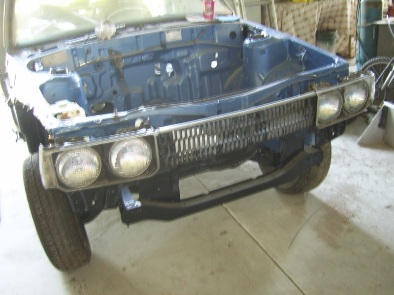

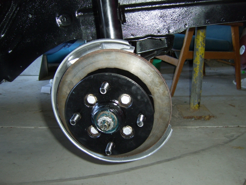

Well, scince Matt hasn't got round to uploading the latest photos, I've decided I'd do it for him. Firstly We ripped the rotors off the hubs, cleaned the rusty bits up with a drill and wire wheel, then treated it to a coat of high temperature black. Once the paint had dried the rotors were bolted back onto the hubs.
Edited by Medicine_Man

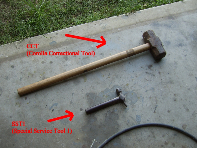

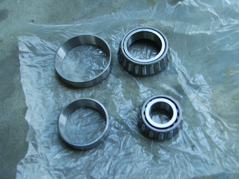

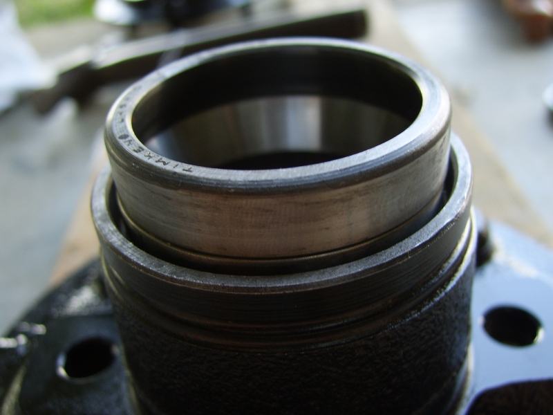

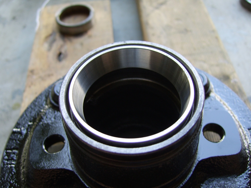

While the paint was drying, we decided to head out and grab some new front wheel bearings (Had to go to Repco, gah, that story can wait till another day). Finally got the bastards (complete set, hub seal/inner/outer bearings) and punched out the old suckers and pressed the new ones in. (Not before smashing my finger a beauty with SST1). The secret to getting them started is to lay the new bearing in place and put the old one on top upside down and tap them in (see pictures 2 and 3).

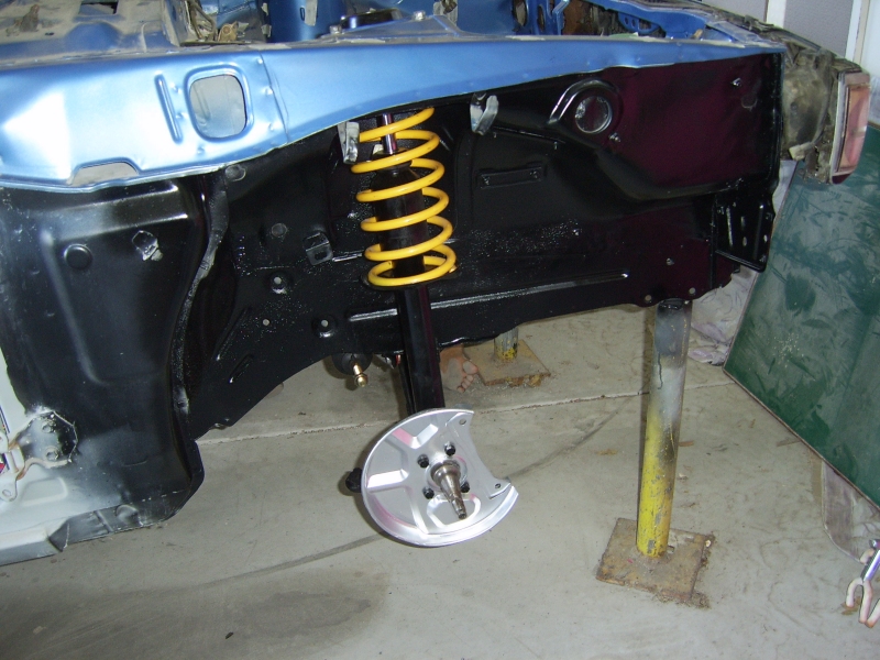

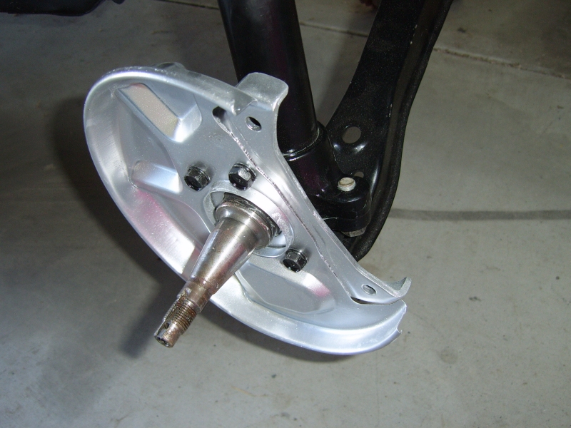

When working on a Corolla, it is important to have the right tools, SST1 and CCT are a must have item! Next I let Matt get down and greasy with his hubs, did I mention how much I hate grease? While Matt was busy doing that I put the heat shields / caliper mounting plates back on.

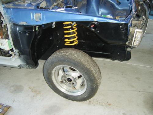

After the hubs / bearings were greased and the hub seals were put on it was time for the bastards to go back on! Finally, after many months the Rolla was back on its feet!!! We even managed to roll it back to try get a better shot of the twinlight setup, but it was getting a bit too dark by then, next weekend we will roll it out of the shed for a better shot..
