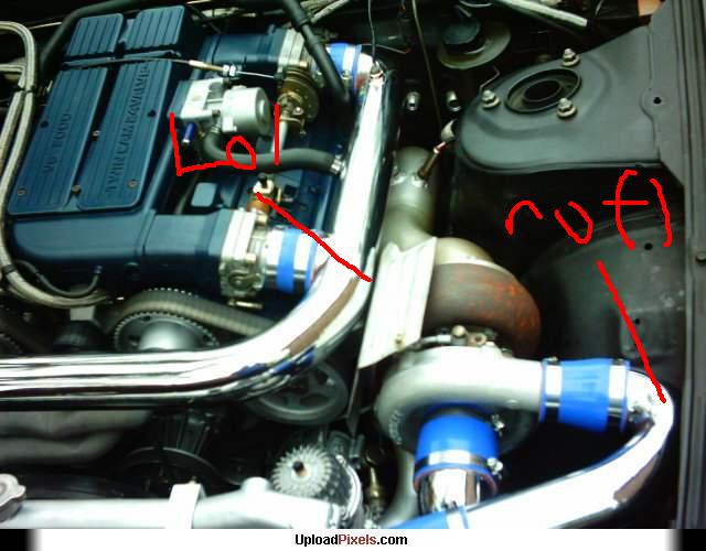

demuire Posted September 22, 2005 Report Posted September 22, 2005 Can anyone else see anything wrong with this picture?
crazy_bunny Posted September 22, 2005 Report Posted September 22, 2005 god that is awfull... could of atleast gone and brought a 90degree bend or two
demuire Posted September 22, 2005 Author Report Posted September 22, 2005 But HEY it's got a heat shield :down:
Tiger Posted September 22, 2005 Report Posted September 22, 2005 Whats the VIN plate (whatsimucallit thingamubub stuffs) doing as a bloody heatshield for a turbo!?!?!
irokin Posted September 22, 2005 Report Posted September 22, 2005 have they never heard of clocking the turbo housings? don't like the way its piped into throttle bodys either....
ancullen Posted September 22, 2005 Report Posted September 22, 2005 Yeah, wouldn't the first throttle body suck down most of the boosted air leaving little for the second throttle??? Wouldn't you need a big plenum chamber for the charged air to build up in and then be sucked down equally by each throttle?
irokin Posted September 22, 2005 Report Posted September 22, 2005 no no...twin throttle bodys is no problem at all. I don't like the way theyve just welded on a flange...right after a 45 degree bend too. I can just see lots of turbulance where you really don't need it. Looks like a VG30DET...in some kind of Z car? Dunno why they didnt change to one of the 3 or 4 other plenum designs...
Tiger Posted September 22, 2005 Report Posted September 22, 2005 Duzi mattaa! Da car's got a turbo, re.... My cousin's a plumer... sed he'll do it for nuffin! Translate: throw in job.... but they took time out to tidy it up... well...sorta!
Medicine_Man Posted September 22, 2005 Report Posted September 22, 2005 Mabey the chrome makes it go fast enough anyway? :down:
Tiger Posted September 22, 2005 Report Posted September 22, 2005 I can't get over that bend coming off the turbo!!! That's ridiculous.... if he had planned to bend it like beckham under the bonnet.. then why not do the whole piping 100mm diameter???? BLOODY HELL!
Xany Posted September 22, 2005 Report Posted September 22, 2005 bwahahahahahaha.....great flowage there....he would have been better off going through the friggen guard....:D
