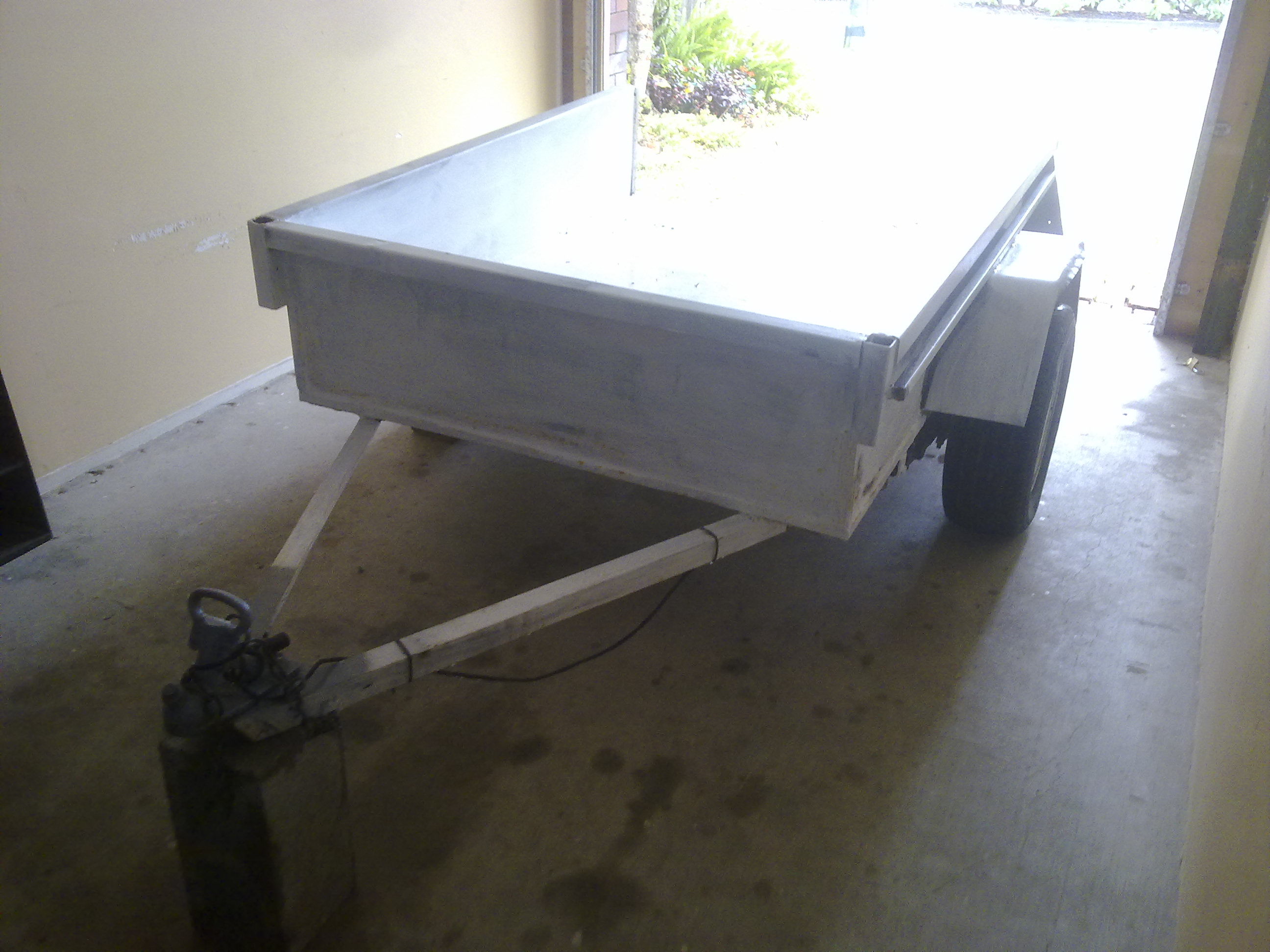

Well in my absences I have bought myself a trailer. Bought off a man who buys trailers, does his thing and sells them. This guy is a knob! He cut out the rusted floor, the rusted sub frame, welded in a new sub frame (SHITE) and replaced the floor with plywood (:S) (filled in holes with bog, cement etc :S)
Here is the trailer as I bought it...

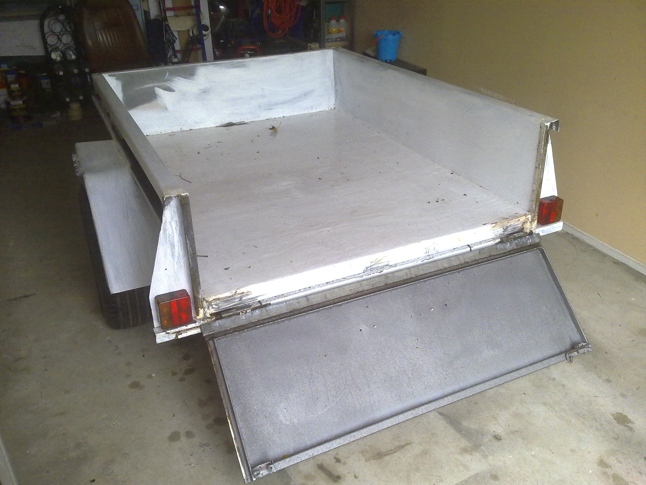

How it was this morning...

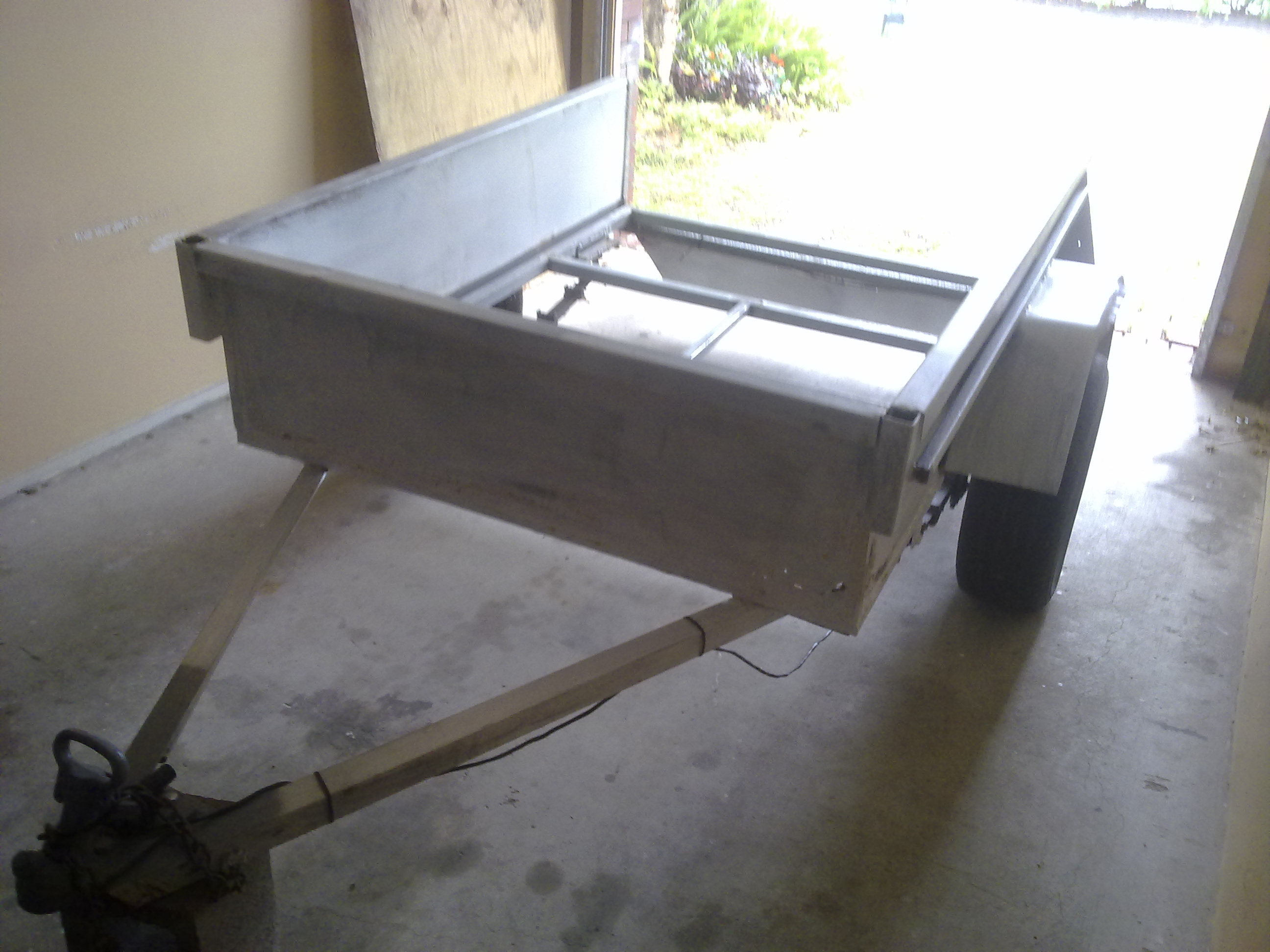

Removed plywood floor...

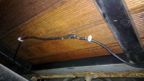

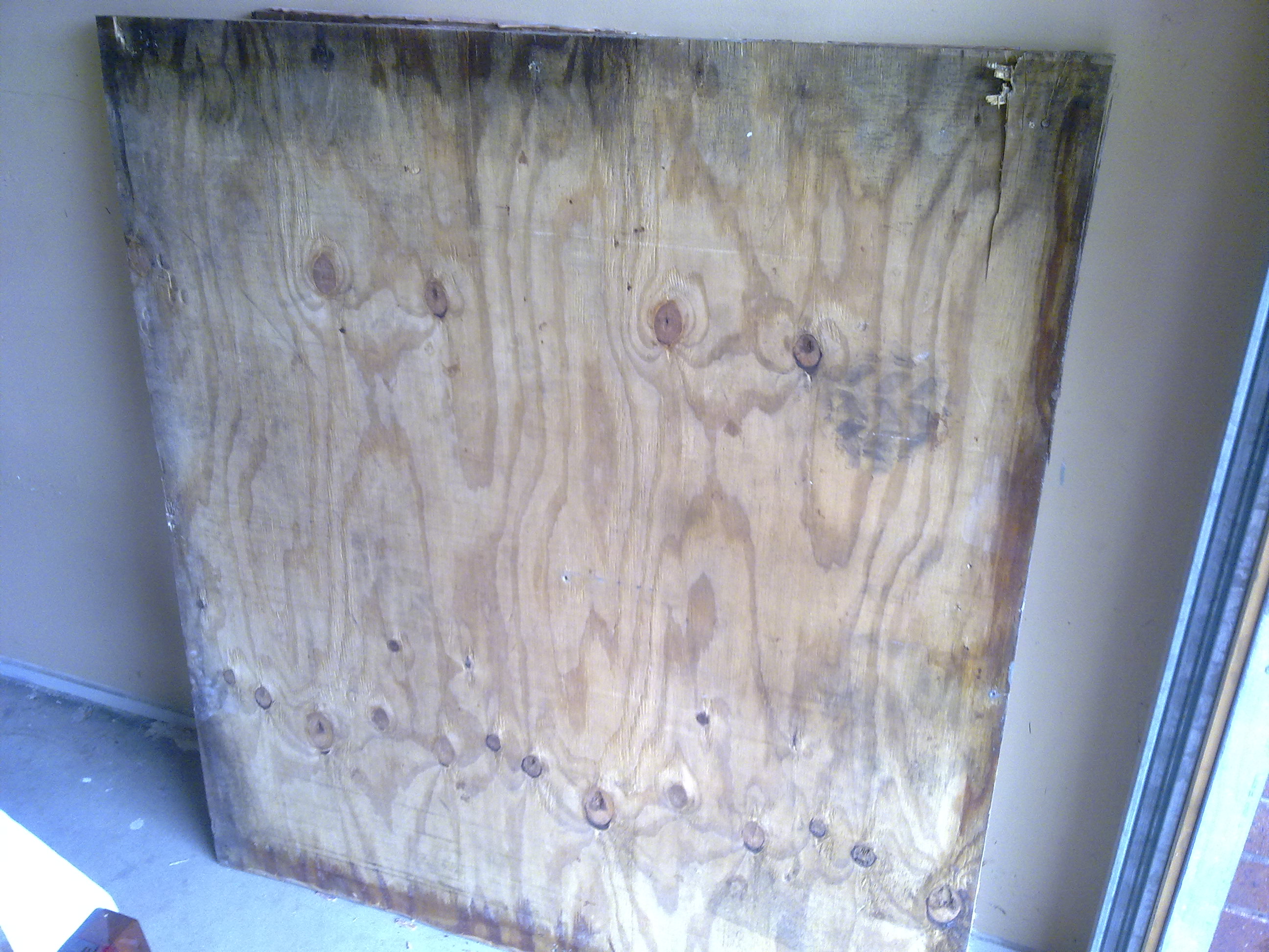

Plywood floor. Evidence that the water was soaking into the timber. Glad I ripped it out.

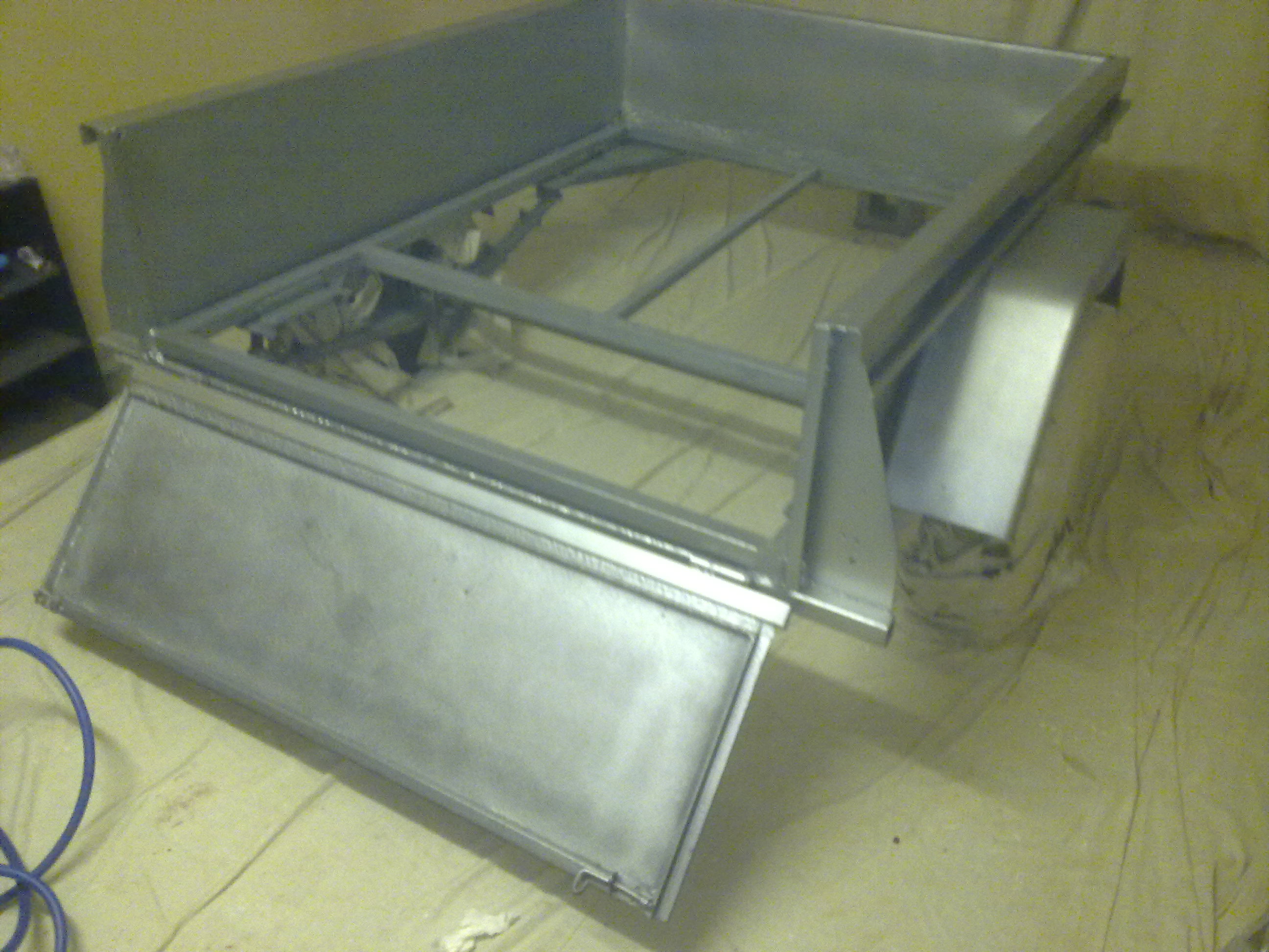

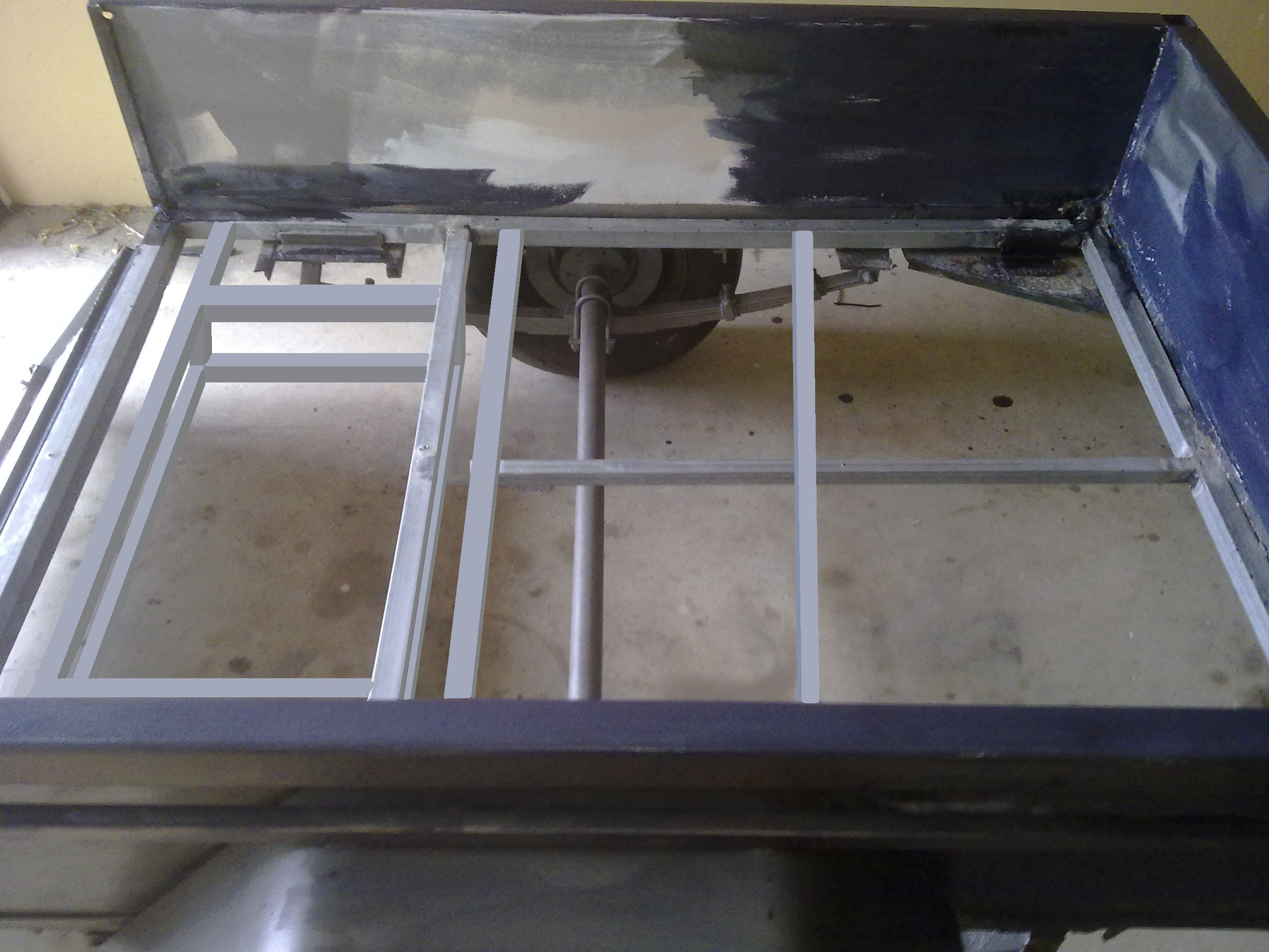

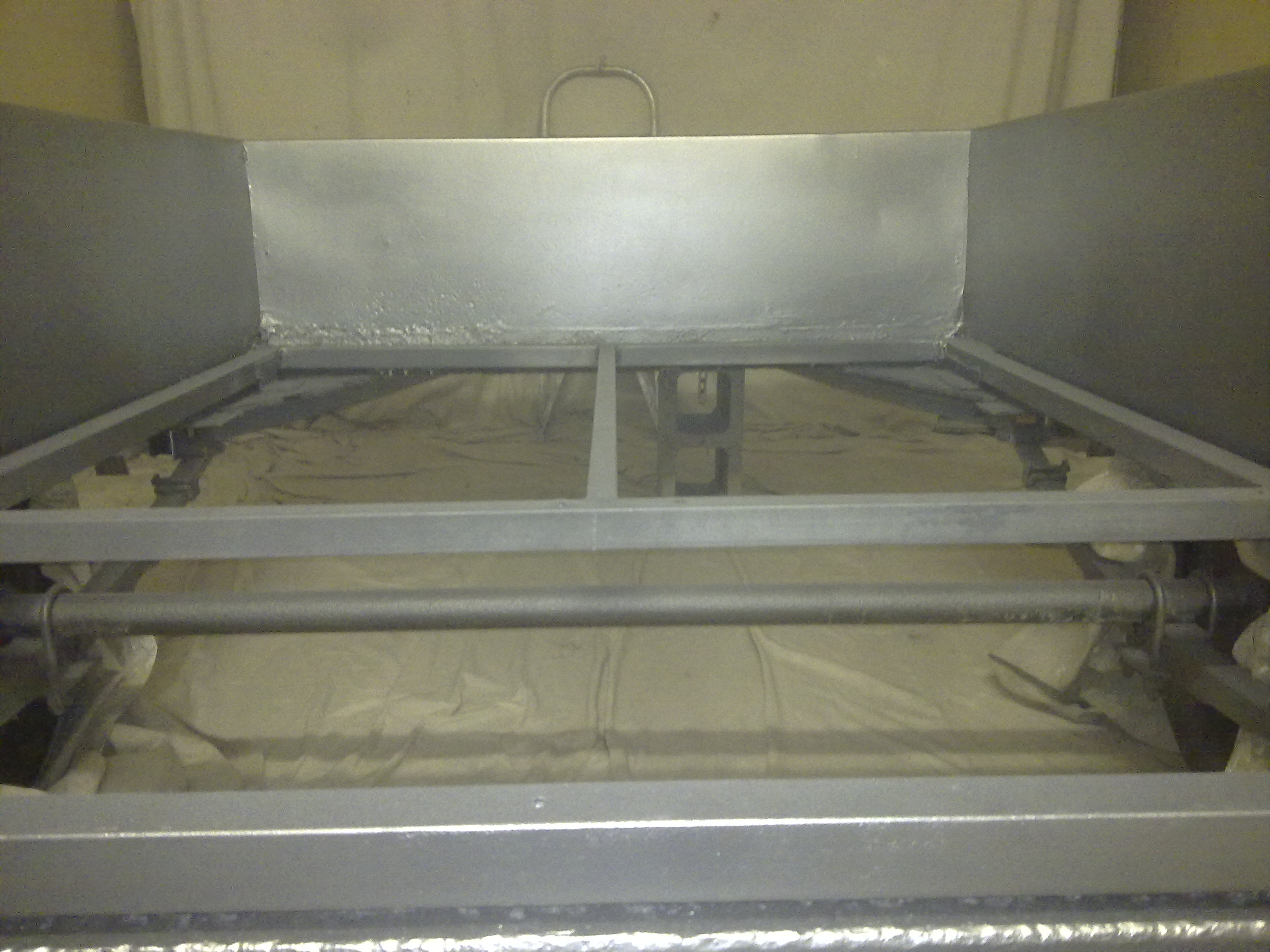

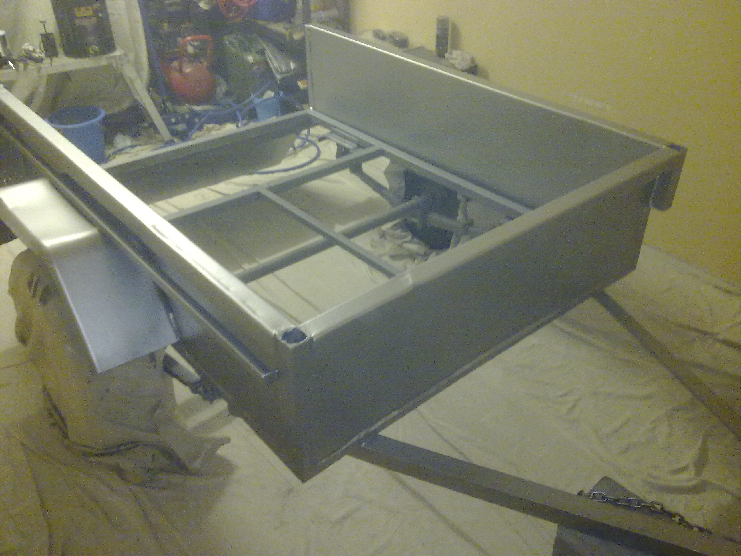

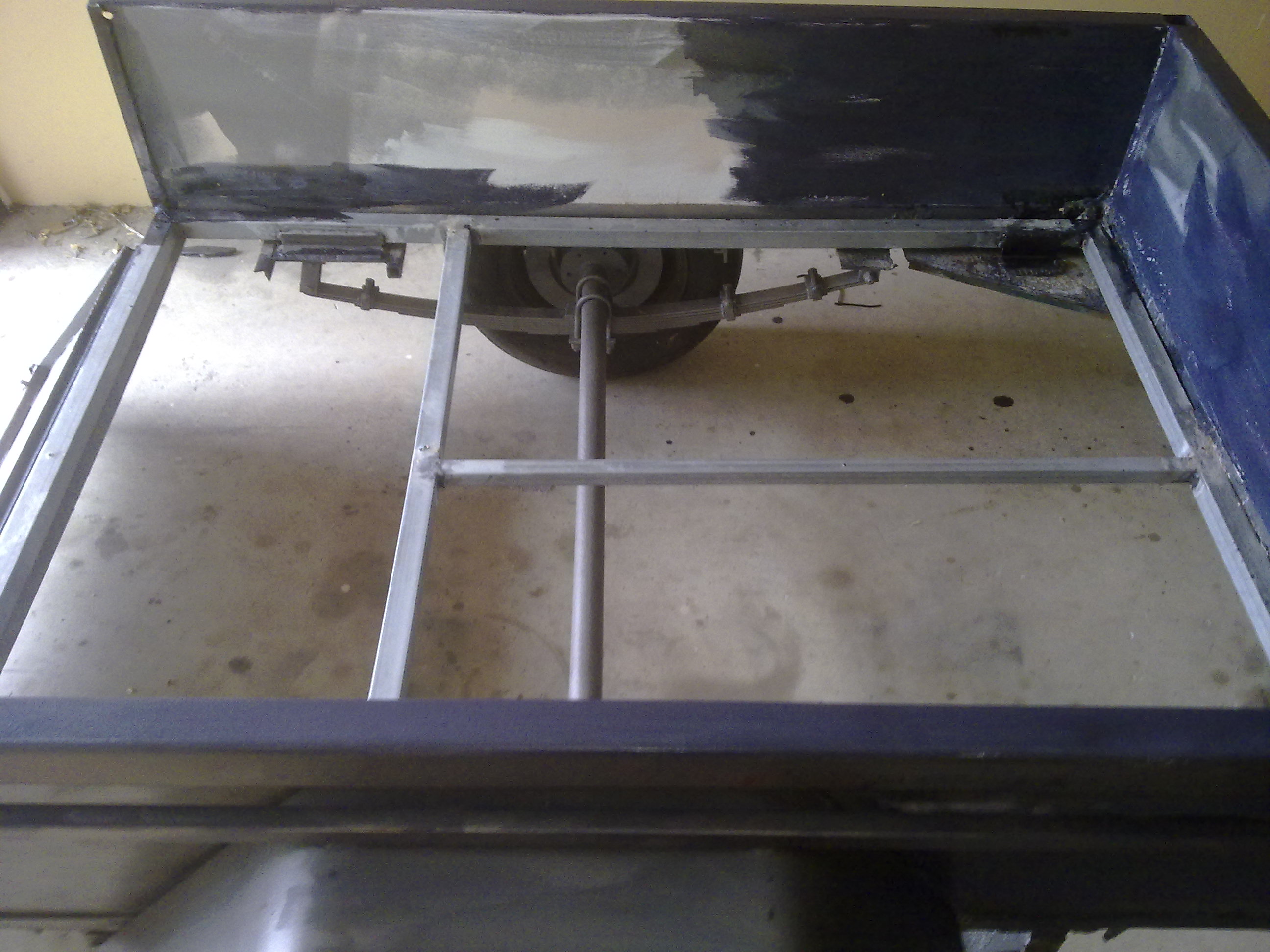

Frame treated with Killrust™
Now needing my godfather to come over tomorrow to weld in a couple of supports in the front half. I don't thing any floor would be able to do this span!! Can't see why that span to the left isn't put in the centre at 900mm instead of 1200!!
The plan is to put in a timber deck floor (Like the Kingswood Utes), but leaving a couple mmm in gaps to ensure water drains and doesn't pool causing water to sit thus causing rust like before. Might go that semi timber/semi plastic decking that will be good in all weather.
Also maybe tempted to get him to weld a 'H' frame on the rear and maybe a sub-box beneath the floor in the rear with the timber decking as the lid. Also in the event I plan on covering the trailer into a camper (Very possible), I'll use black silicone between the gaps and make it look like ship decking.

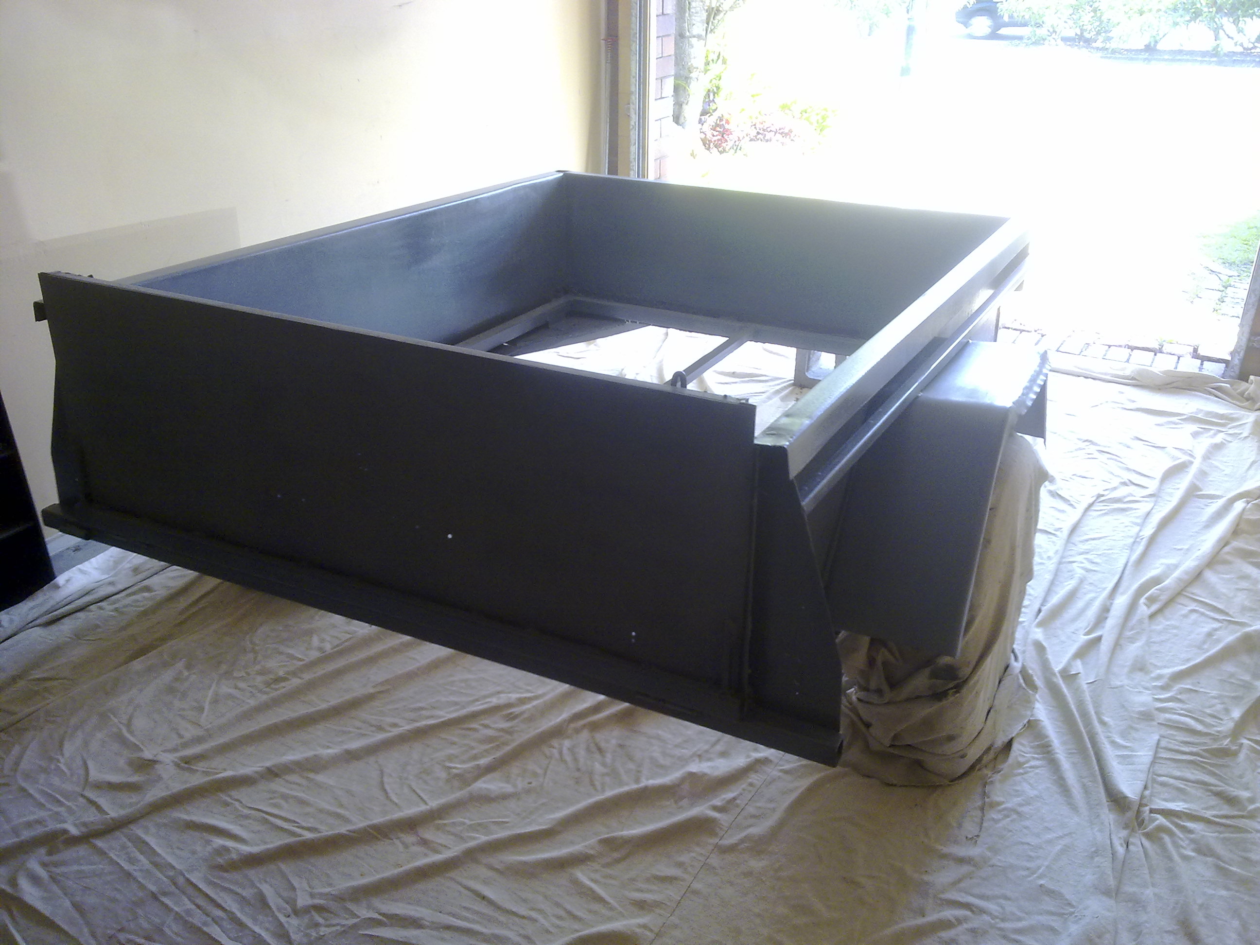

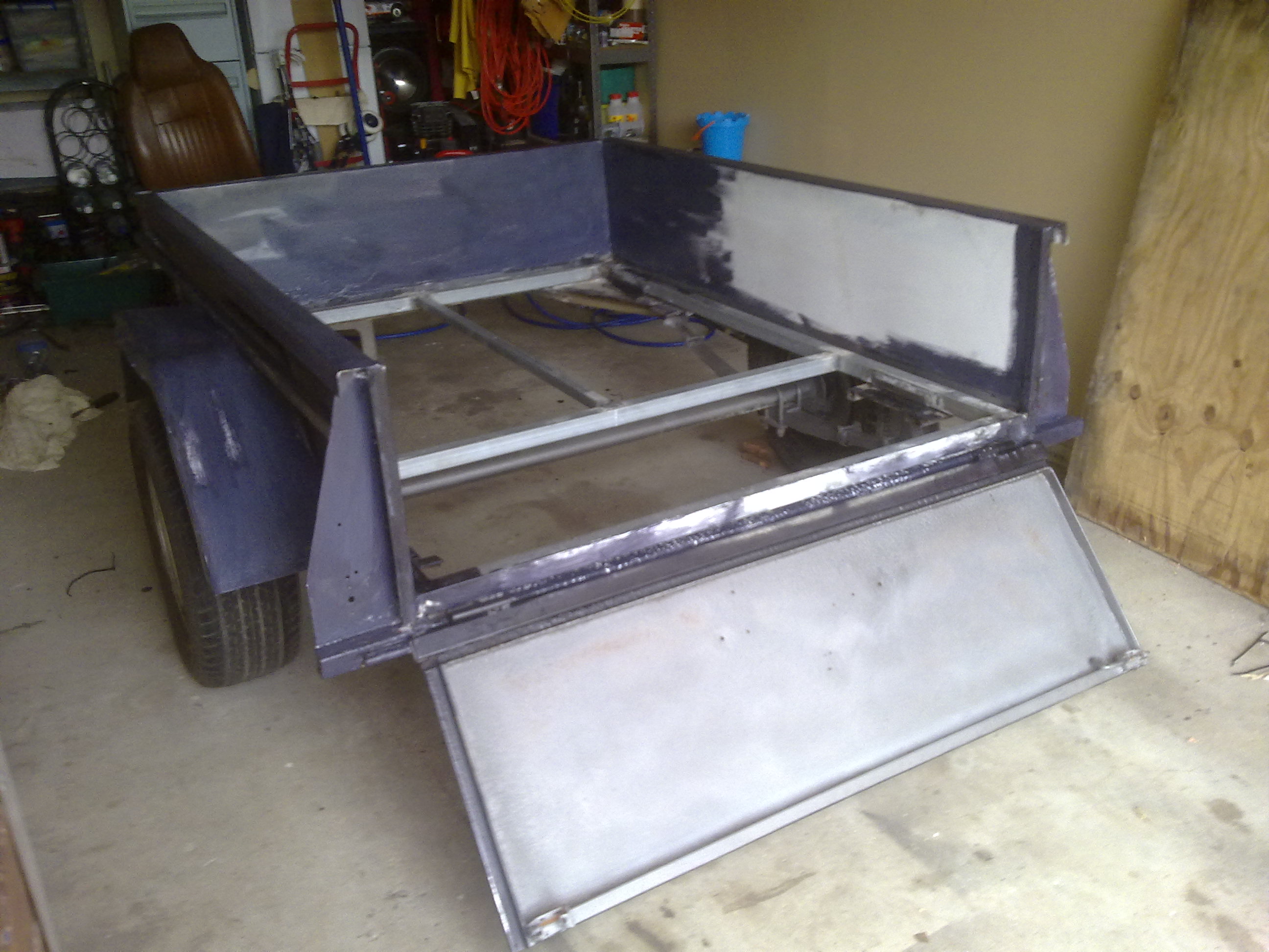

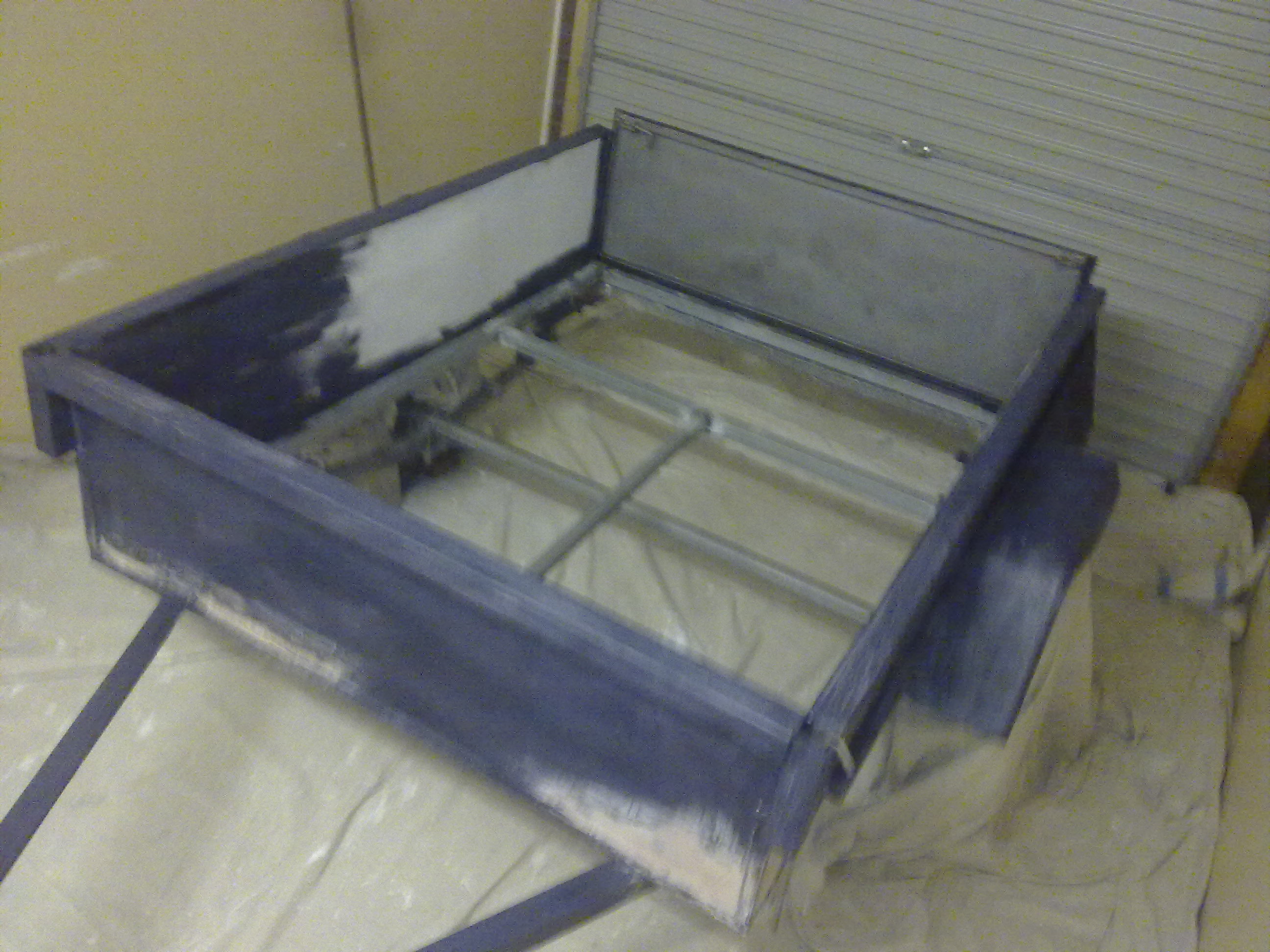

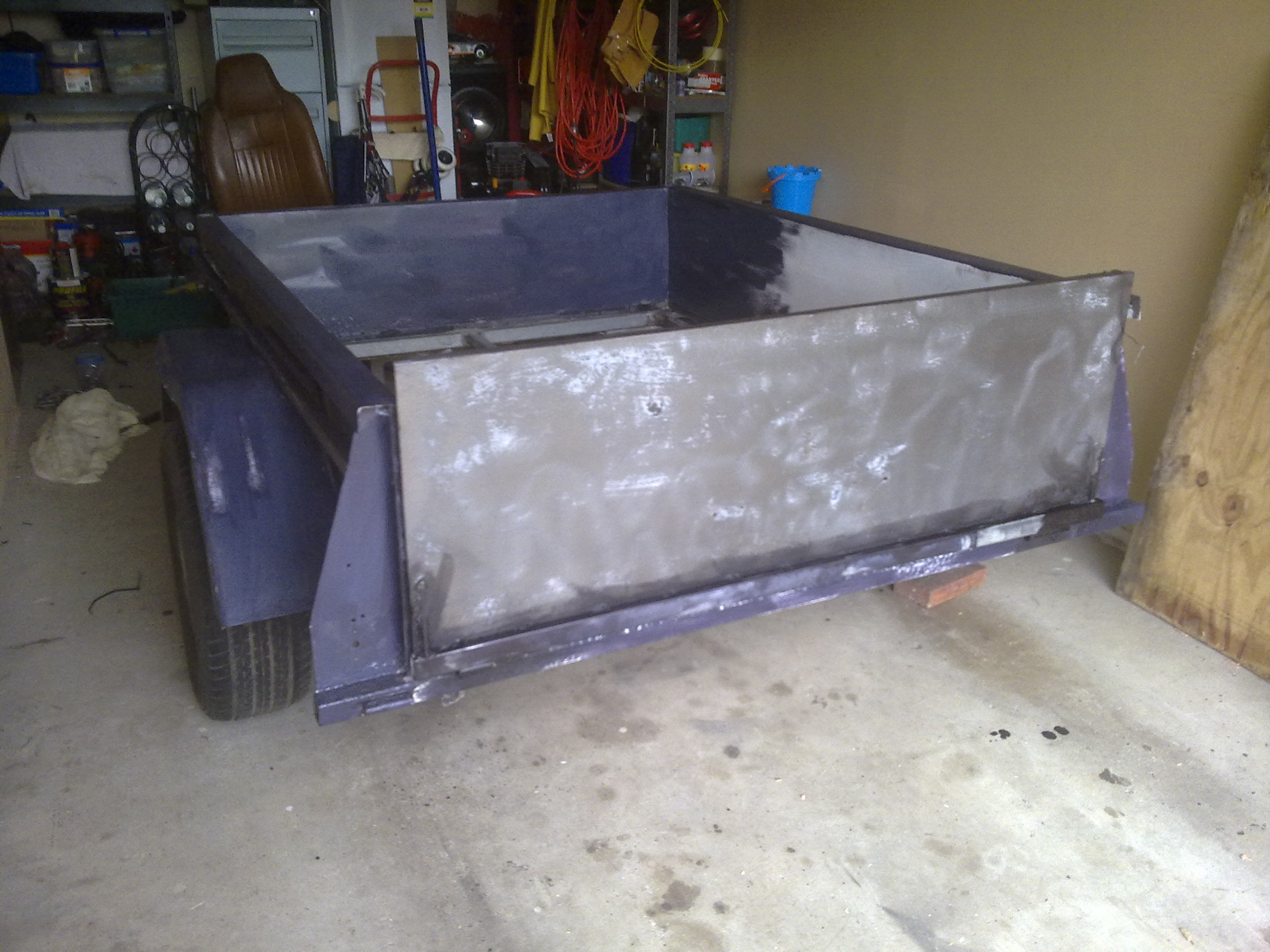

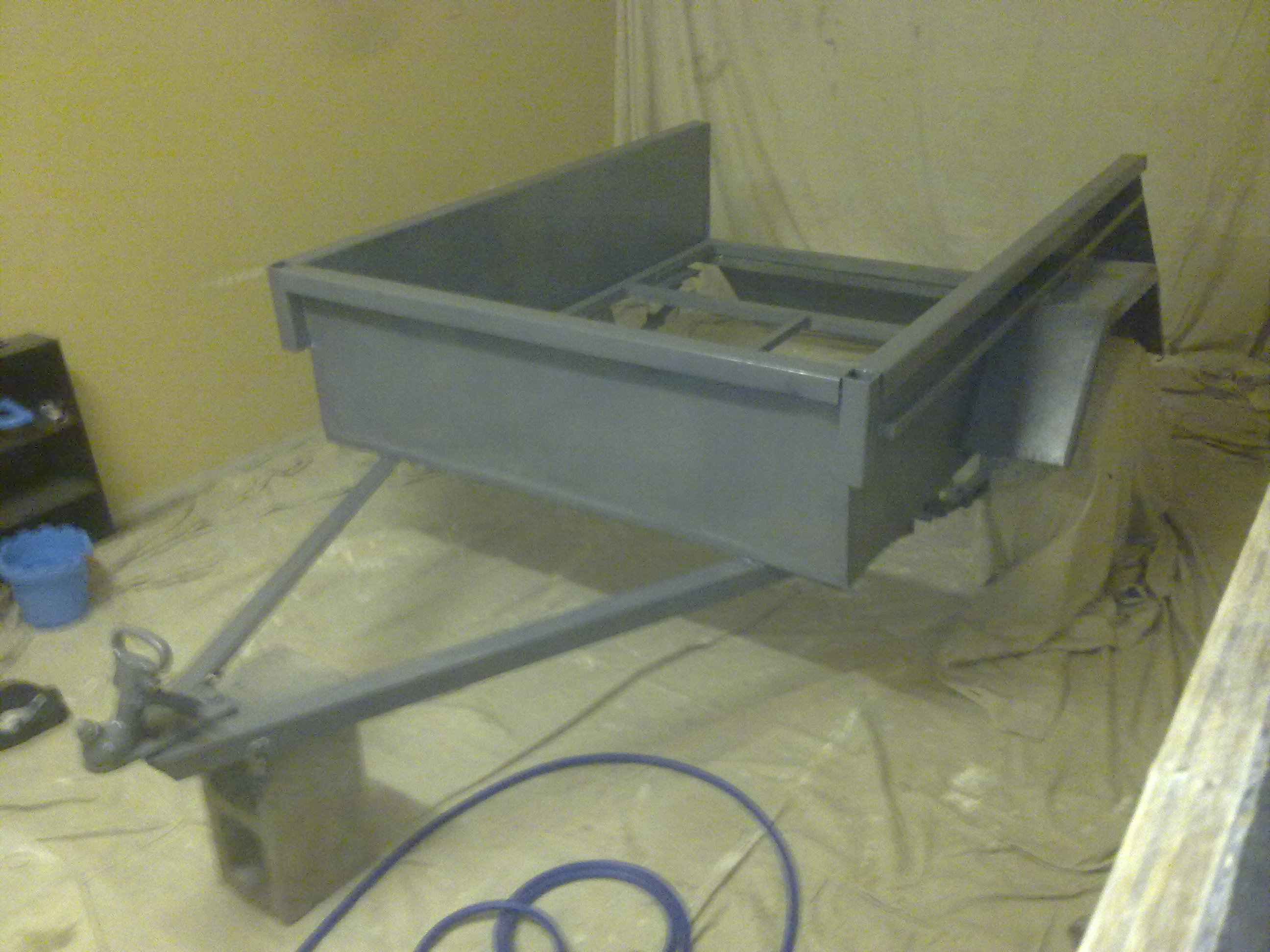

Okay, well the weekend has come around so I've begin work on painting the box. So yesterday I pushed it back into the garage after a weeks worth of rain. I had a tarp over it but it kept filling up. Dad put bricks on it, the tarp filled up with water, and when the bricks fell off they scratched the primer :bash: So I touched it up yesterday.

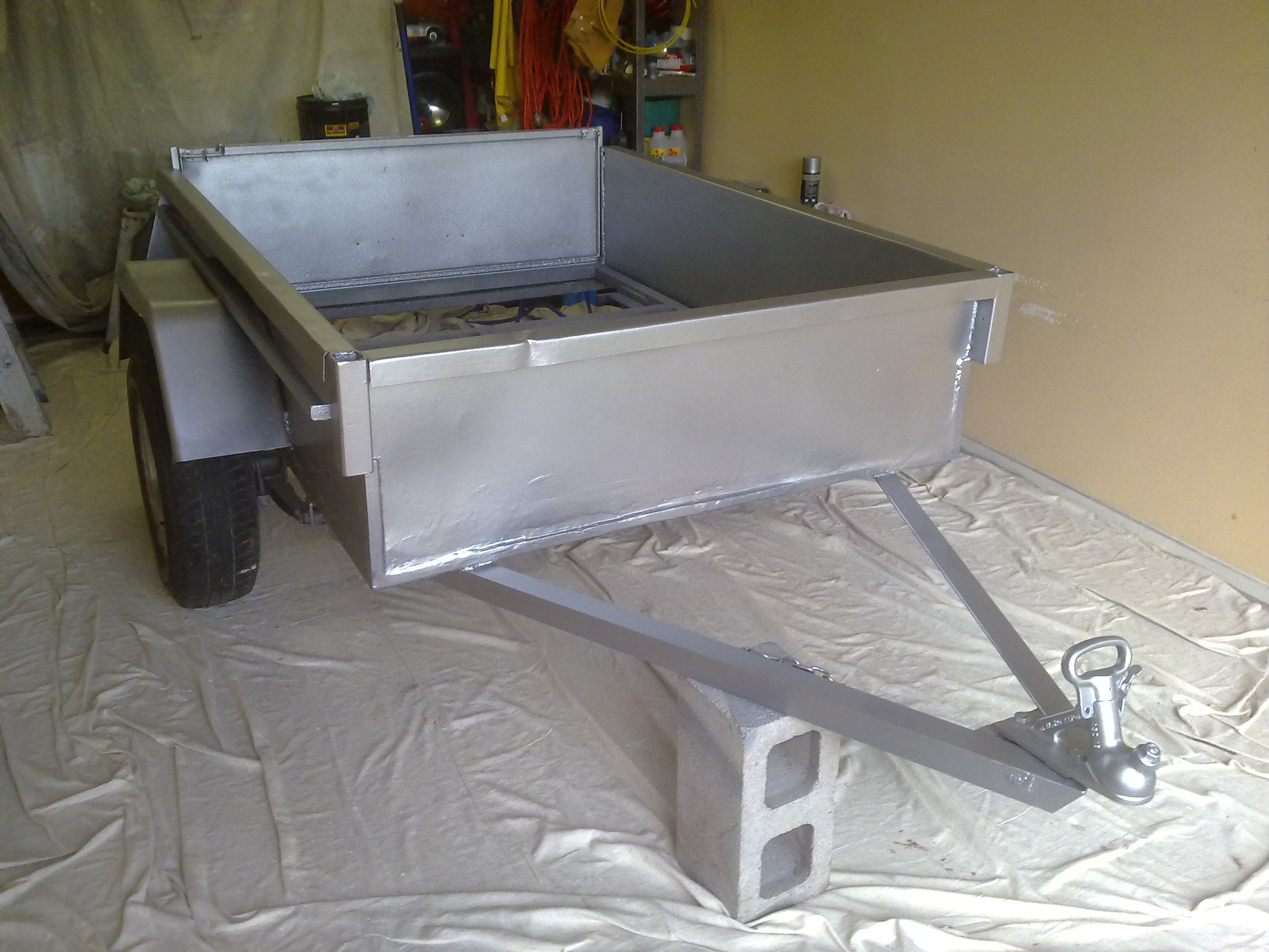

I bought the paint. Subaru Silver!! Who would have thought 2 litres would cost so much!
Now if the paint looks shit in the large sections like the gate, back and sides, it probably is. I'm still learning my technique with the spraygun. I hope to recoat in the morning and hope the next coats come up a bit better :)

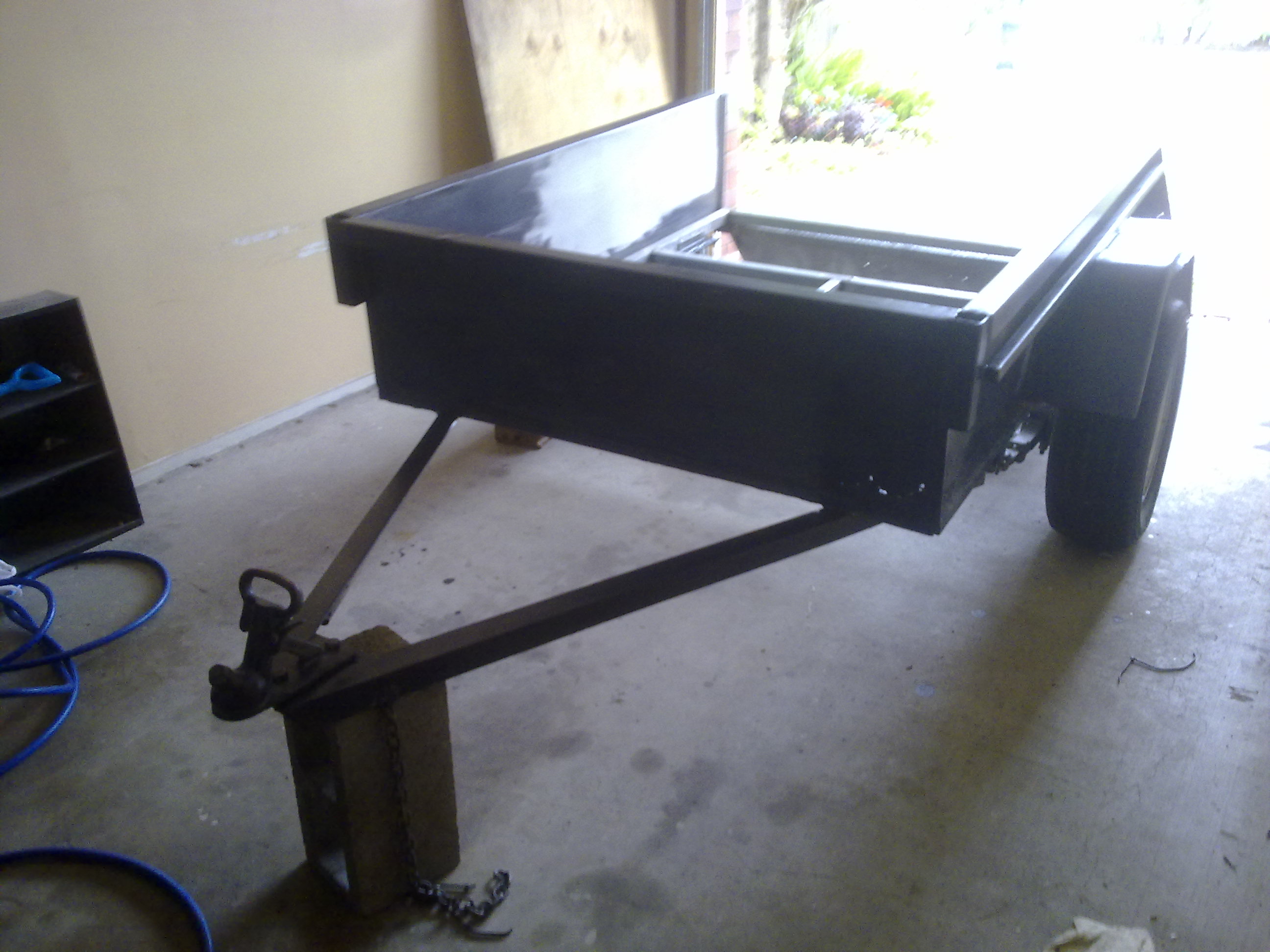

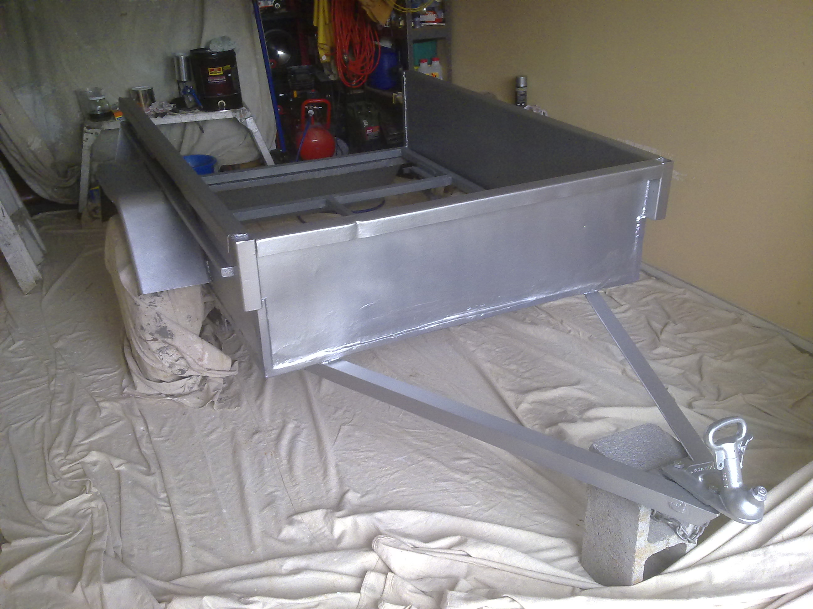

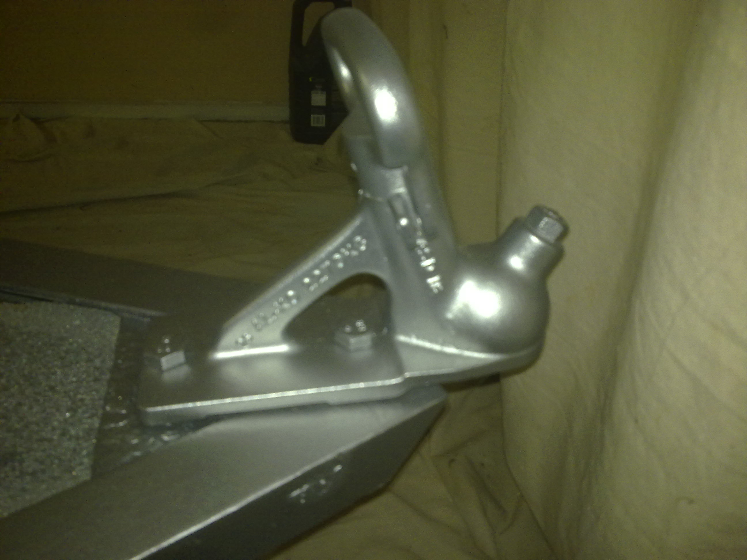

And a shot of the hitch :)

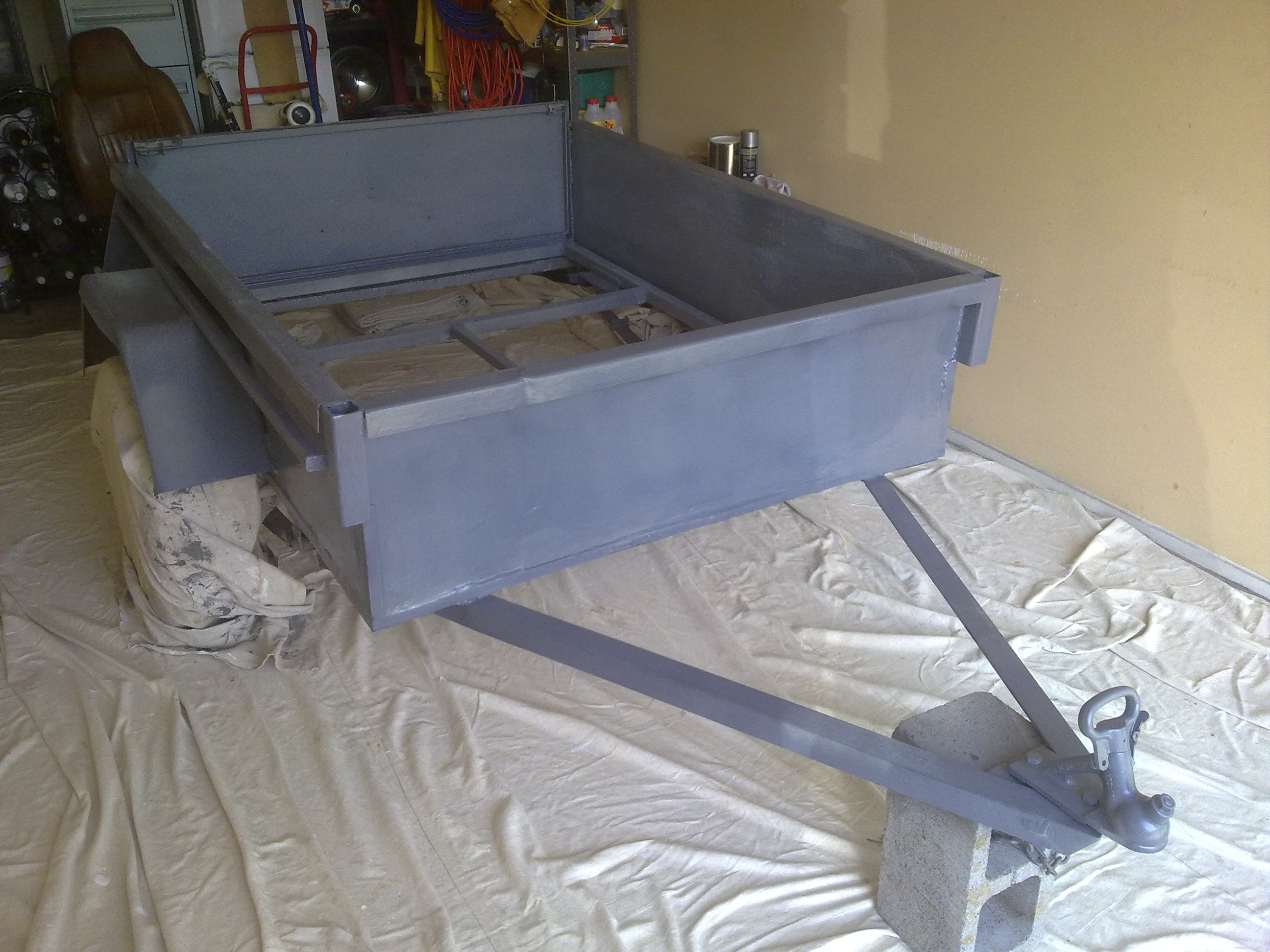

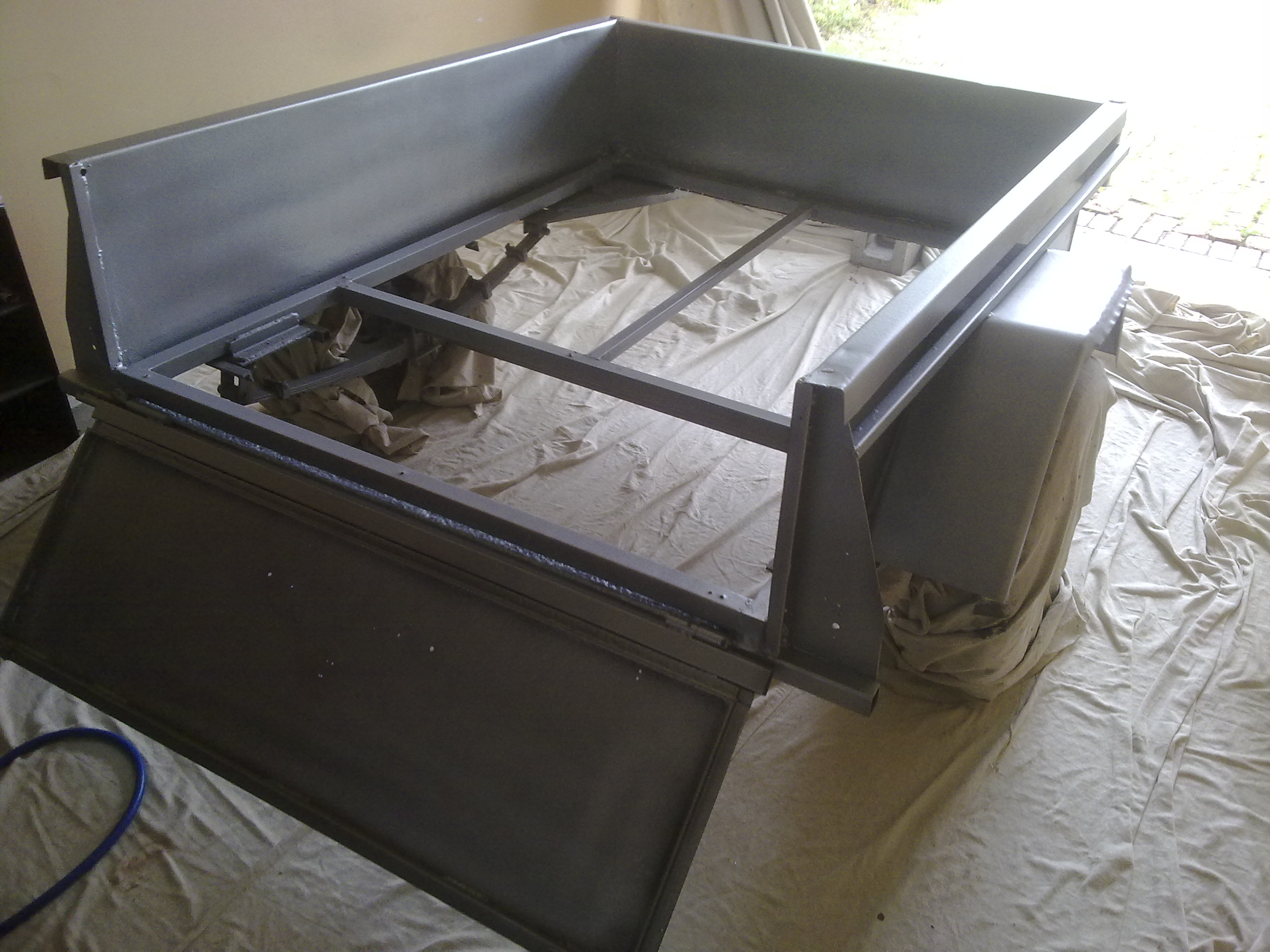

Todays update...
I took a couple pics in day light of how the first coats came out...

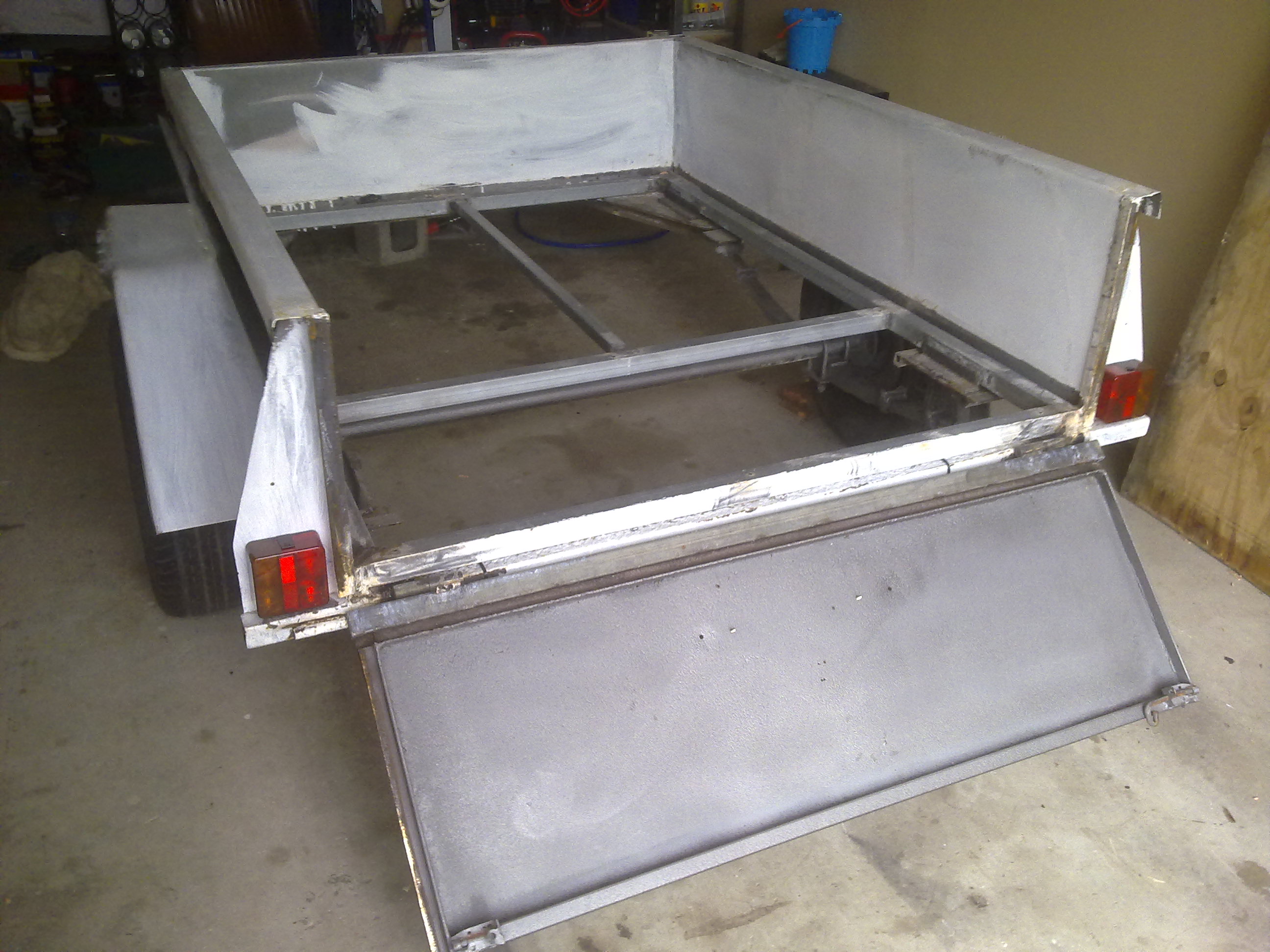

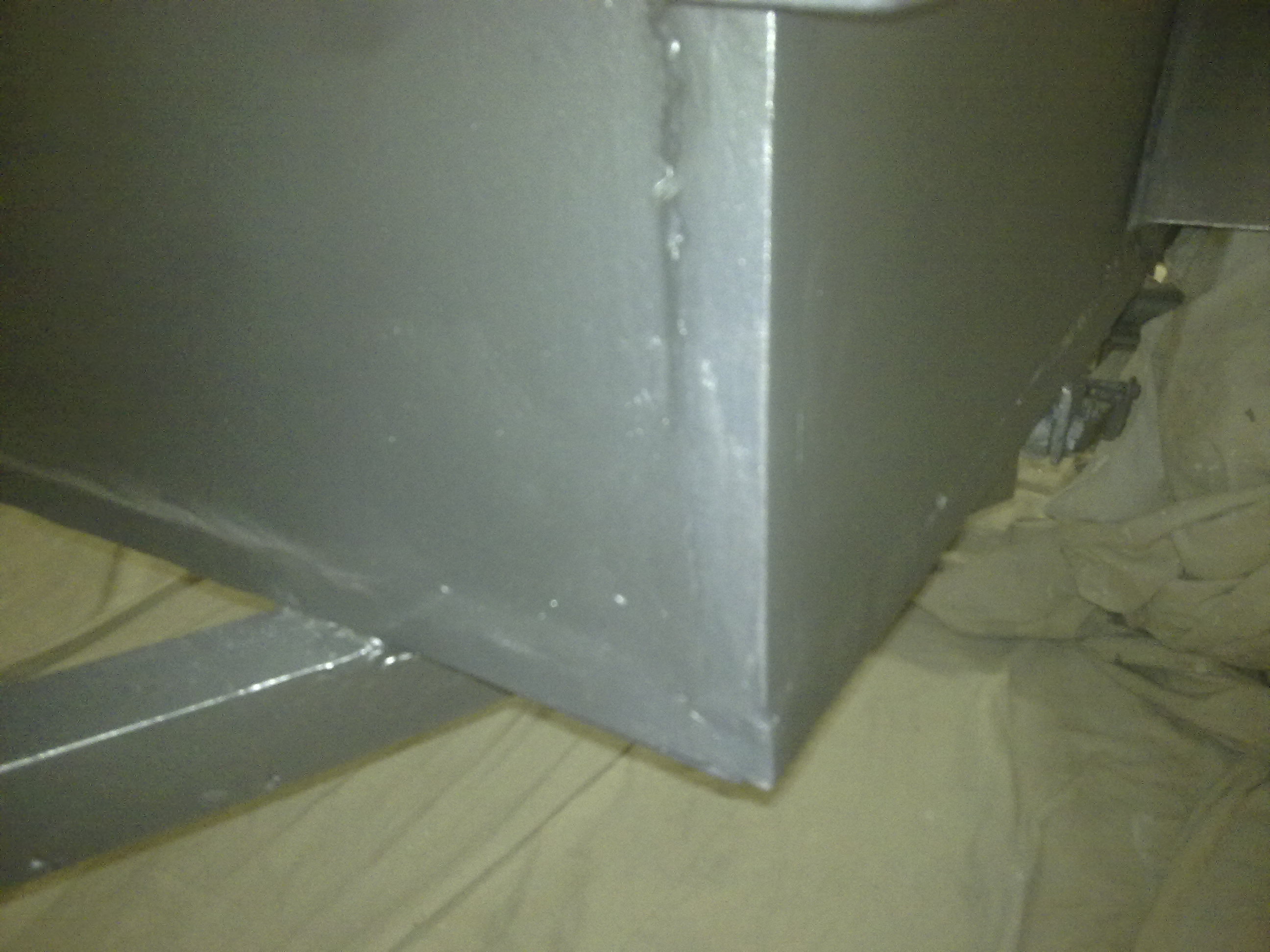

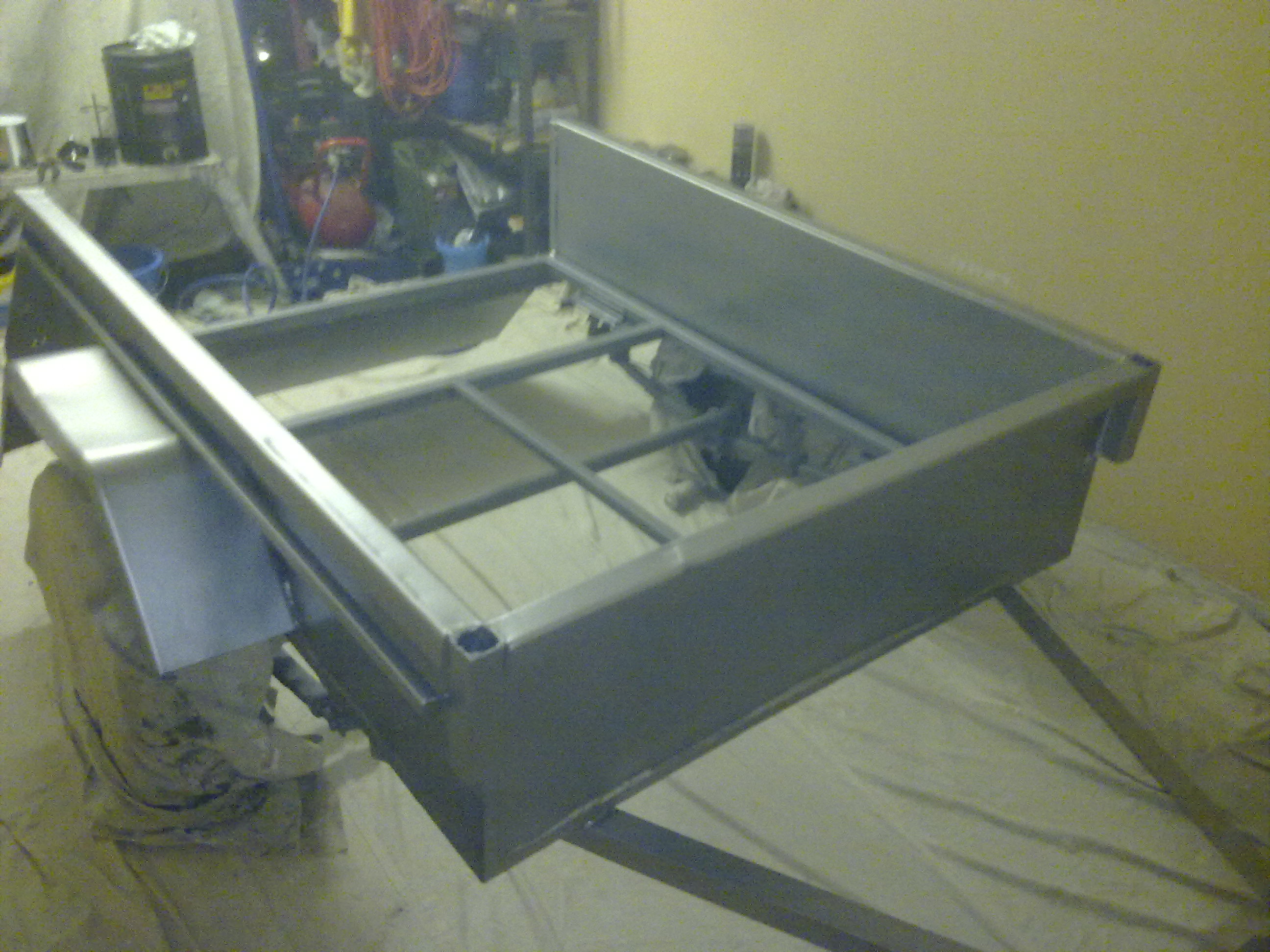

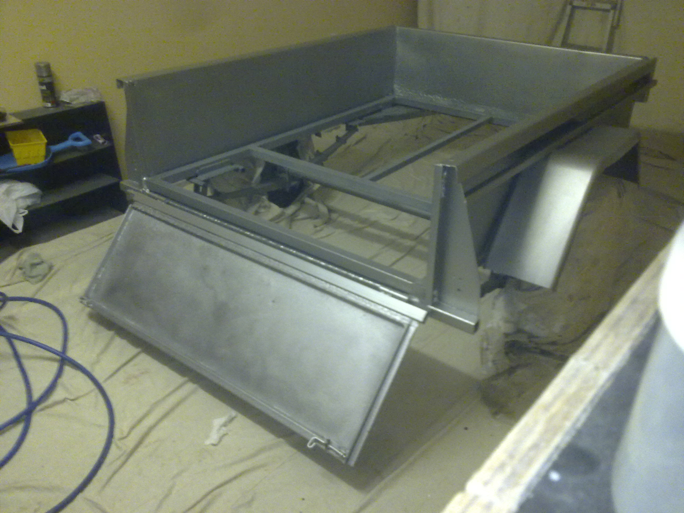

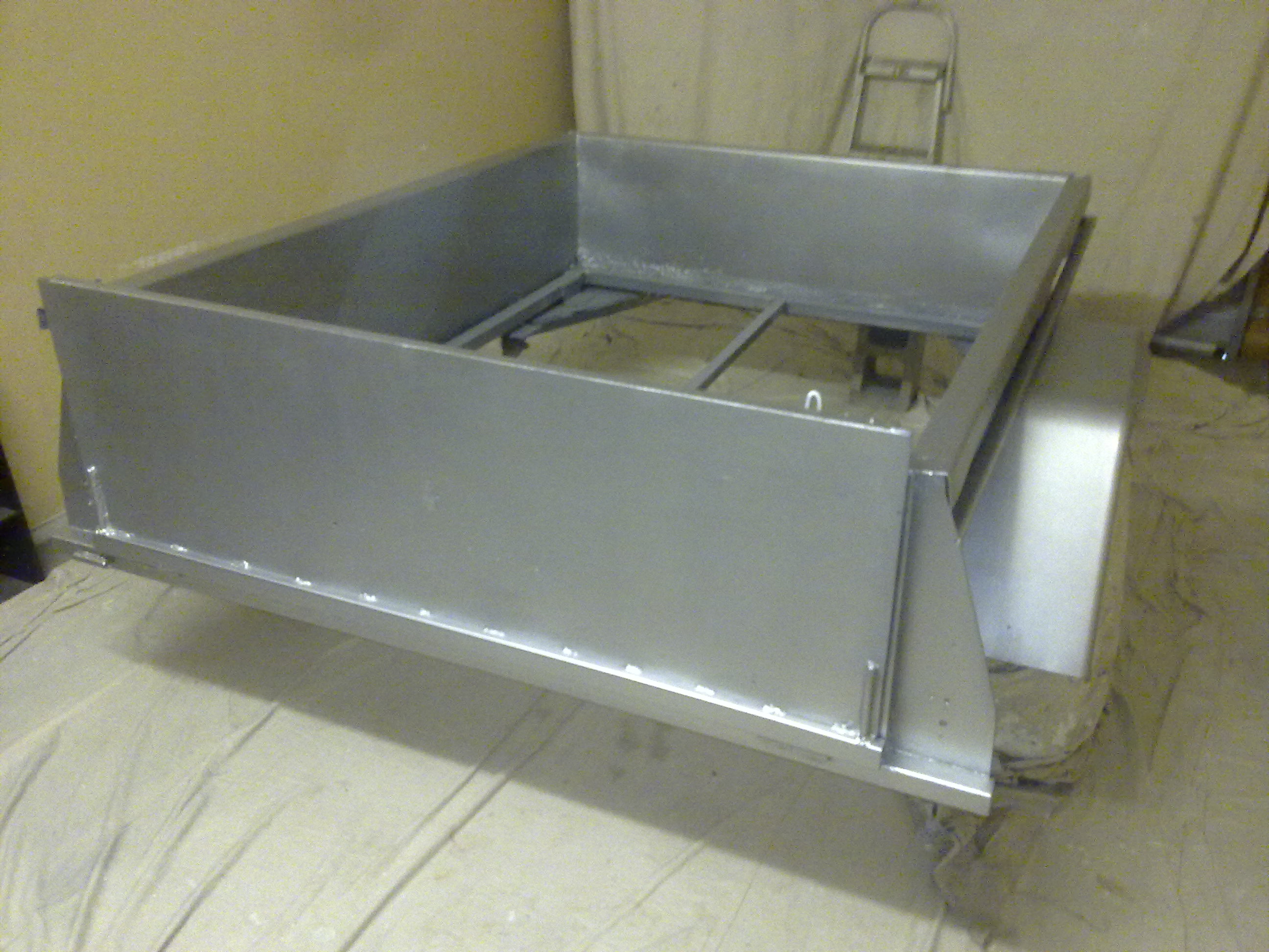

My godfather then came over as he'll be doing the metal fabrication for the extra support in the floor, and 'H' bar. He has talked me out of doing the sub floor box :( Apparently he believes it will get ripped off which I understand but still, would have been nice. I might just buy a tool box for the drawbar.
Anyway she is starting to look really good after the second coat...

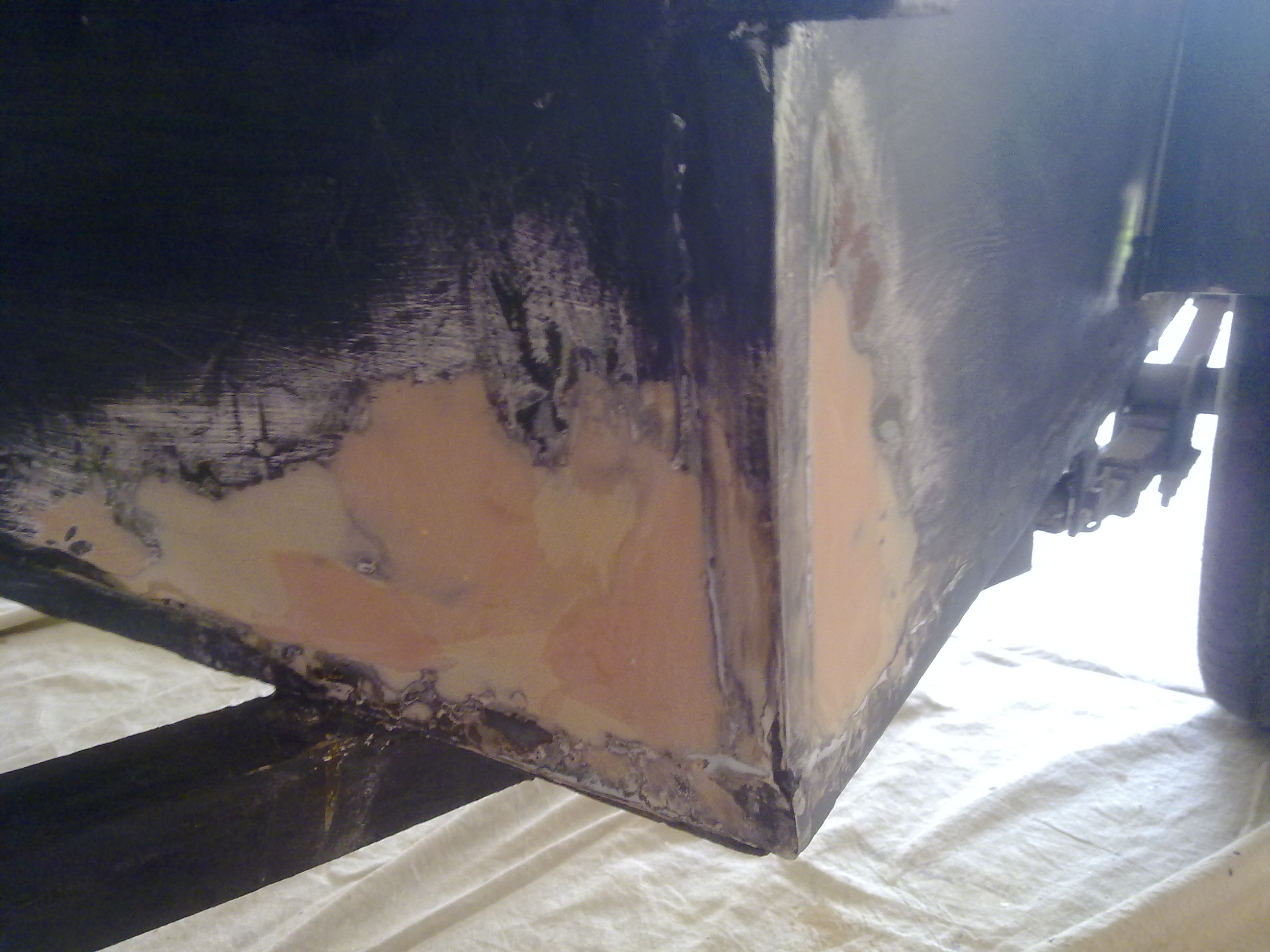

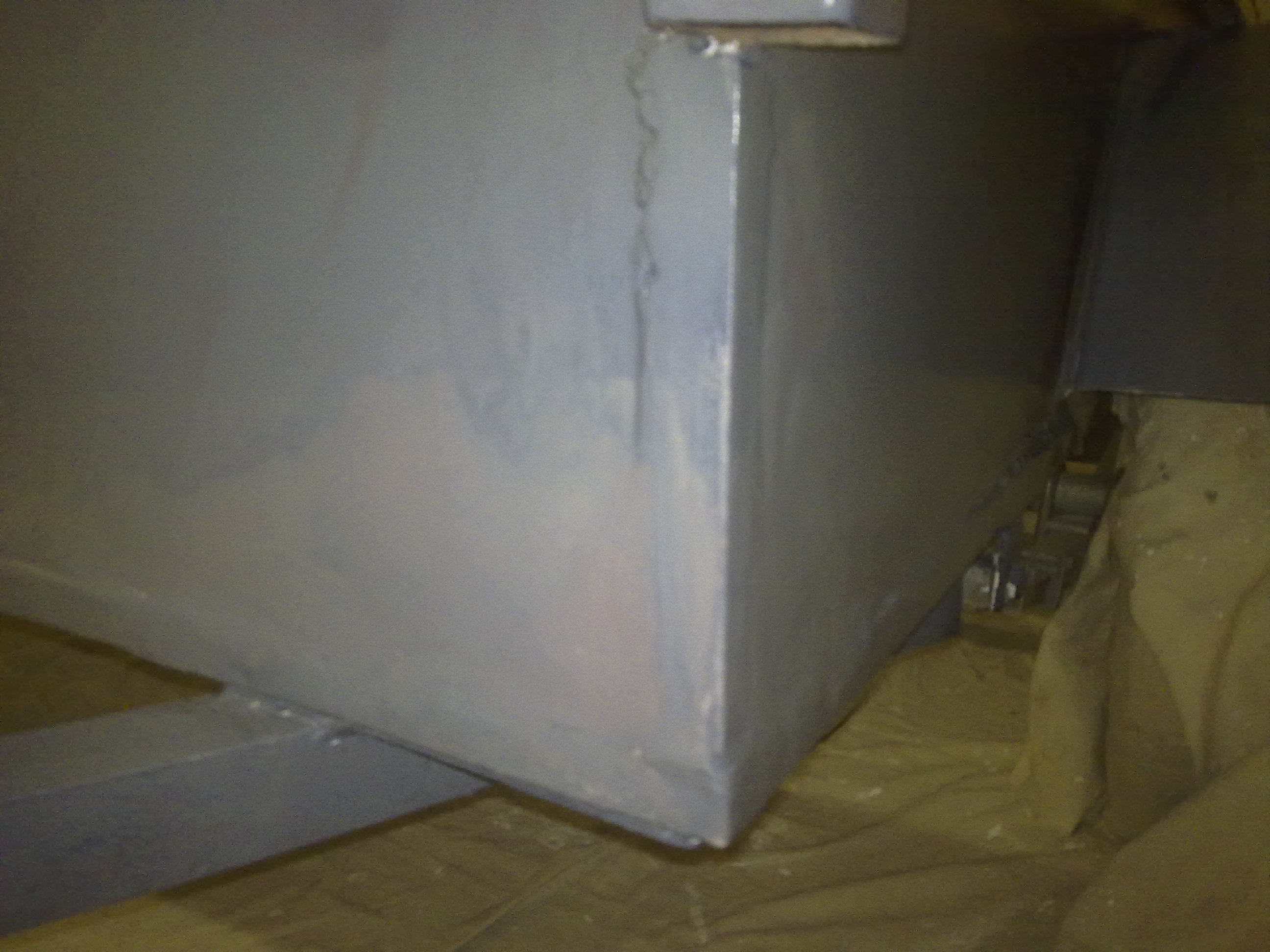

And lastly how that bogging looks. Its not the neatest bog but it does the job...
Next need to paint the frame and everything under it black, then the clears next weekend! :D

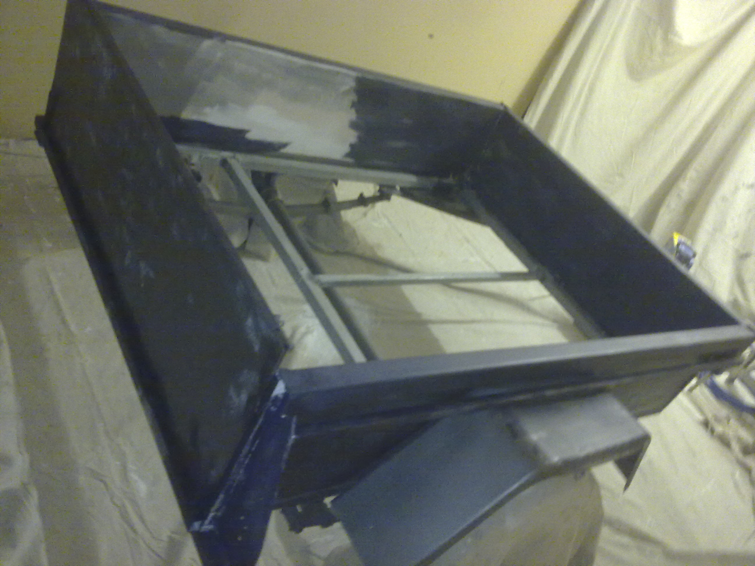

I took some pics in the daylight just before I went to work last night.
So this is how its like after 2 coats, do I bother with a third? Was just thinking of trying to do an many coats of clear that I can, but that'll have to wait till next weekend...
