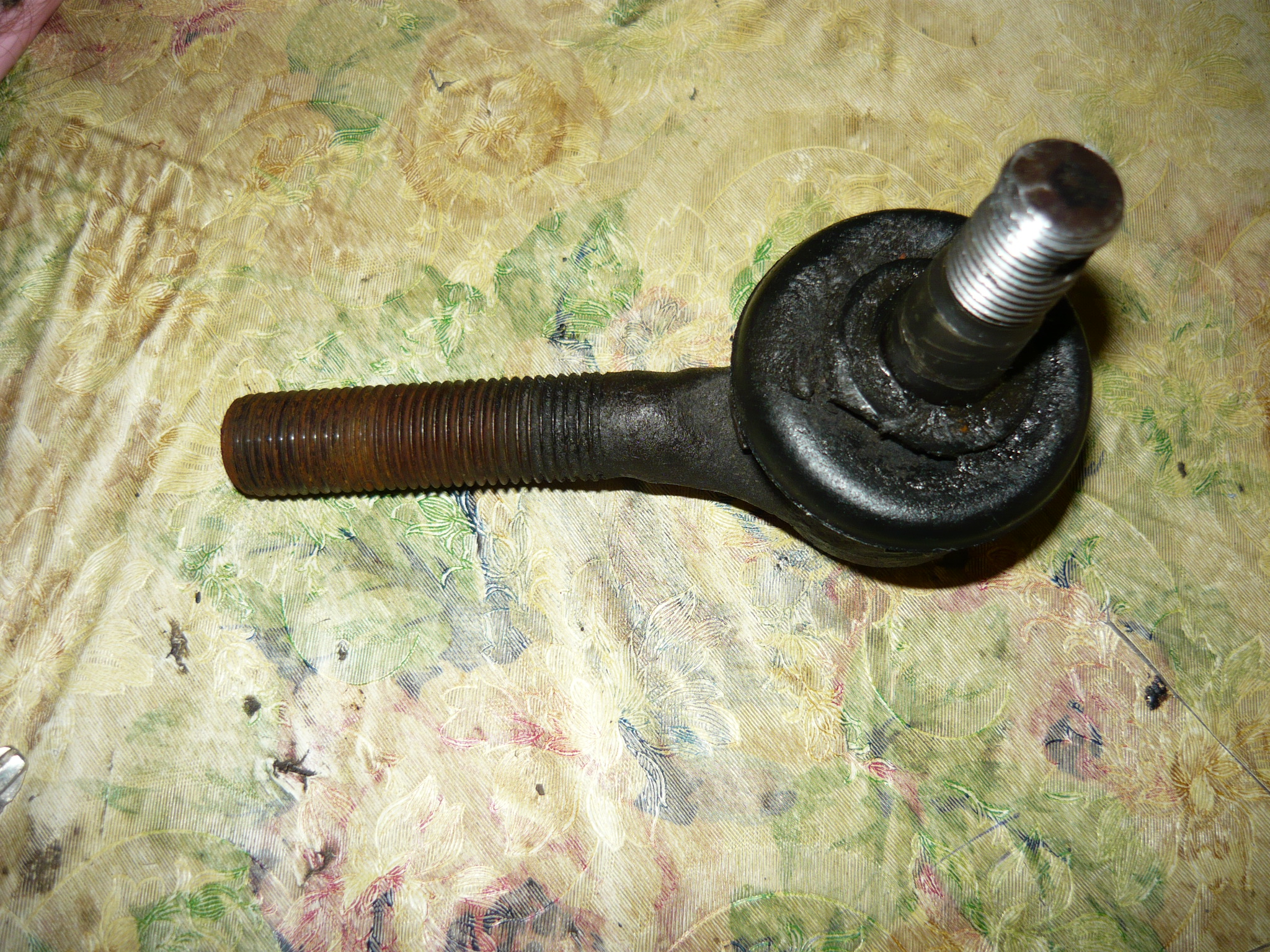

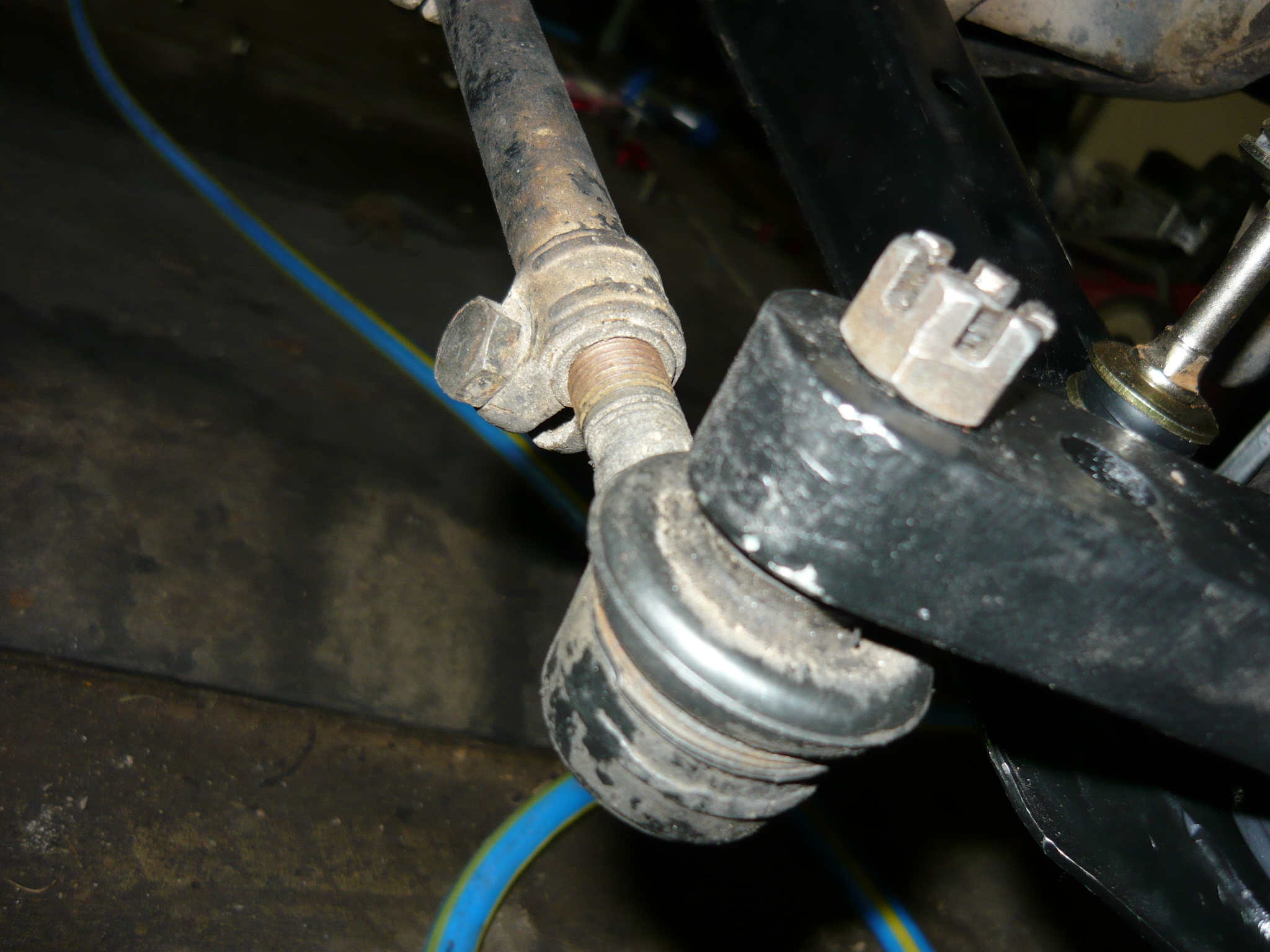

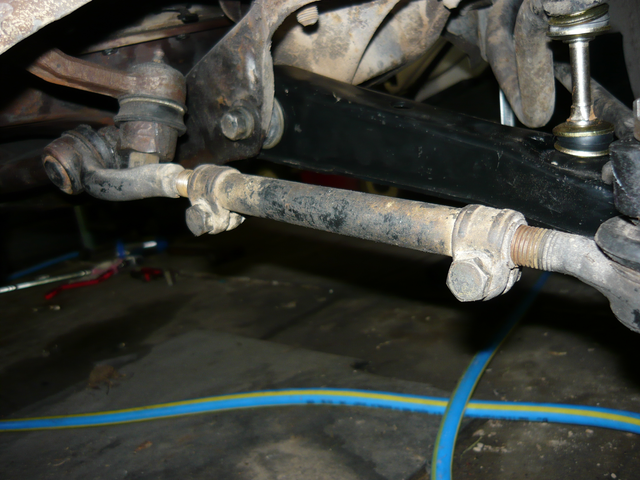

19914afc Posted February 18, 2011 Report Share Posted February 18, 2011 (edited) T18 tie rod ends?, here is a picture of the box setup looks like it can be extended much longer, I just put corona lcas in and still can wind them out a fair bit. Edited February 18, 2011 by 19914afc Quote Link to comment Share on other sites More sharing options...

19914afc Posted February 18, 2011 Report Share Posted February 18, 2011 The T18 ones seem to be pretty long to, or are ra40 even longer? they have that amount of adjustment and then the same in the rest of the tube. Quote Link to comment Share on other sites More sharing options...
mungi mods Posted February 18, 2011 Report Share Posted February 18, 2011 crosmember different ? ra40 rack end tubes are longer Quote Link to comment Share on other sites More sharing options...
