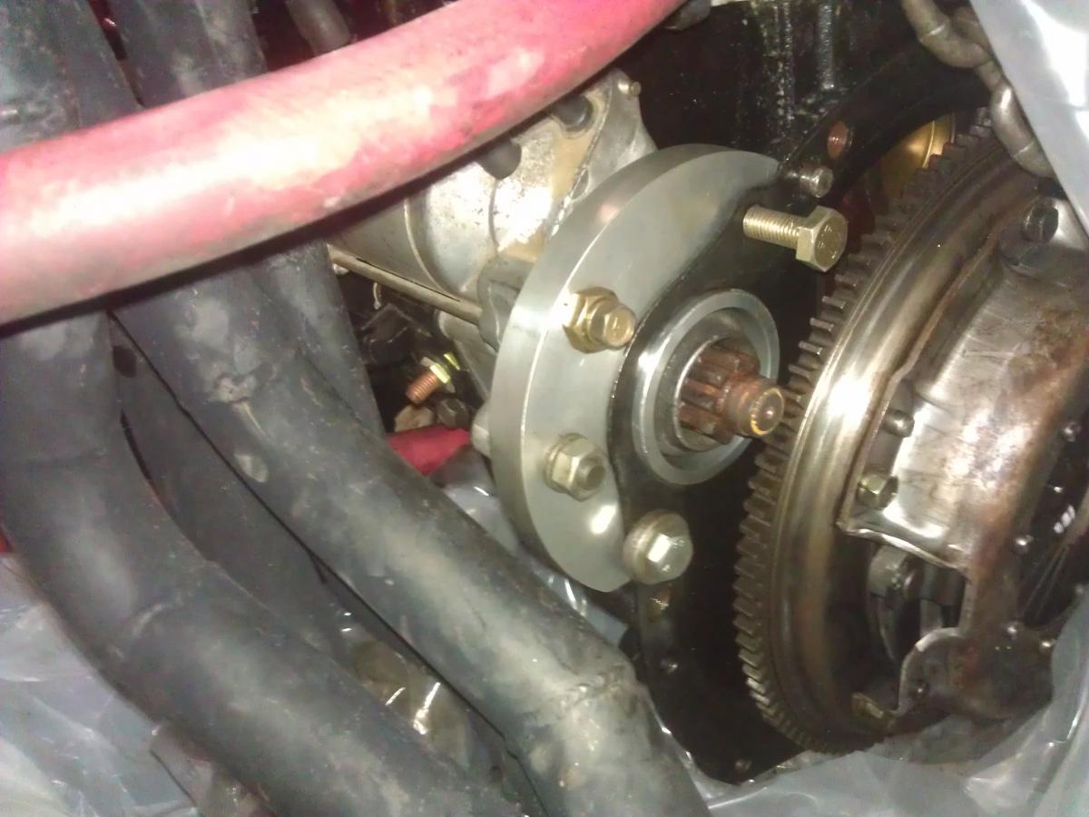

I had a lot of trouble with starter motors not being up to the task of turning this puppy over I tried rebuilding a stock one and it would not even crank, so I went out and bought a brand new 1.2 KW replacement starter and it was ok, but still cranked very slowly and I somehow snapped the nose cone clean off.
So I now use a starter from a V8 landcruiser and it is amazing! Cranks so fast, and not too difficult to make it fit, I just had to machine up an adaptor plate
