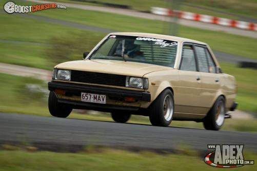

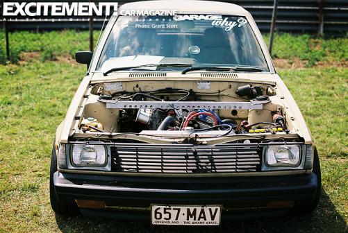

I'm glad wou all like it, i just took it for her maiden voyage! it went really well, considering it still needs a lot of tuning, already HEAPS faster than the 4k.
it is an a ke70 and i live in brissy.

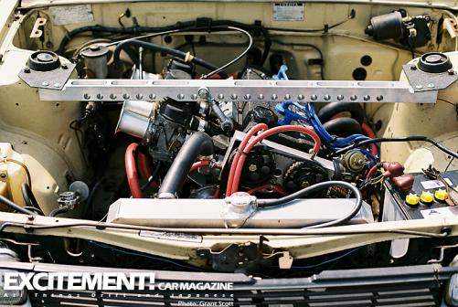

  • This is one sweet engine mate :dance: wish i could get a real k twin cam :glare:   Here are some pics i found of the real K twin cam :lolcry:       Check them out for headers :blinks:

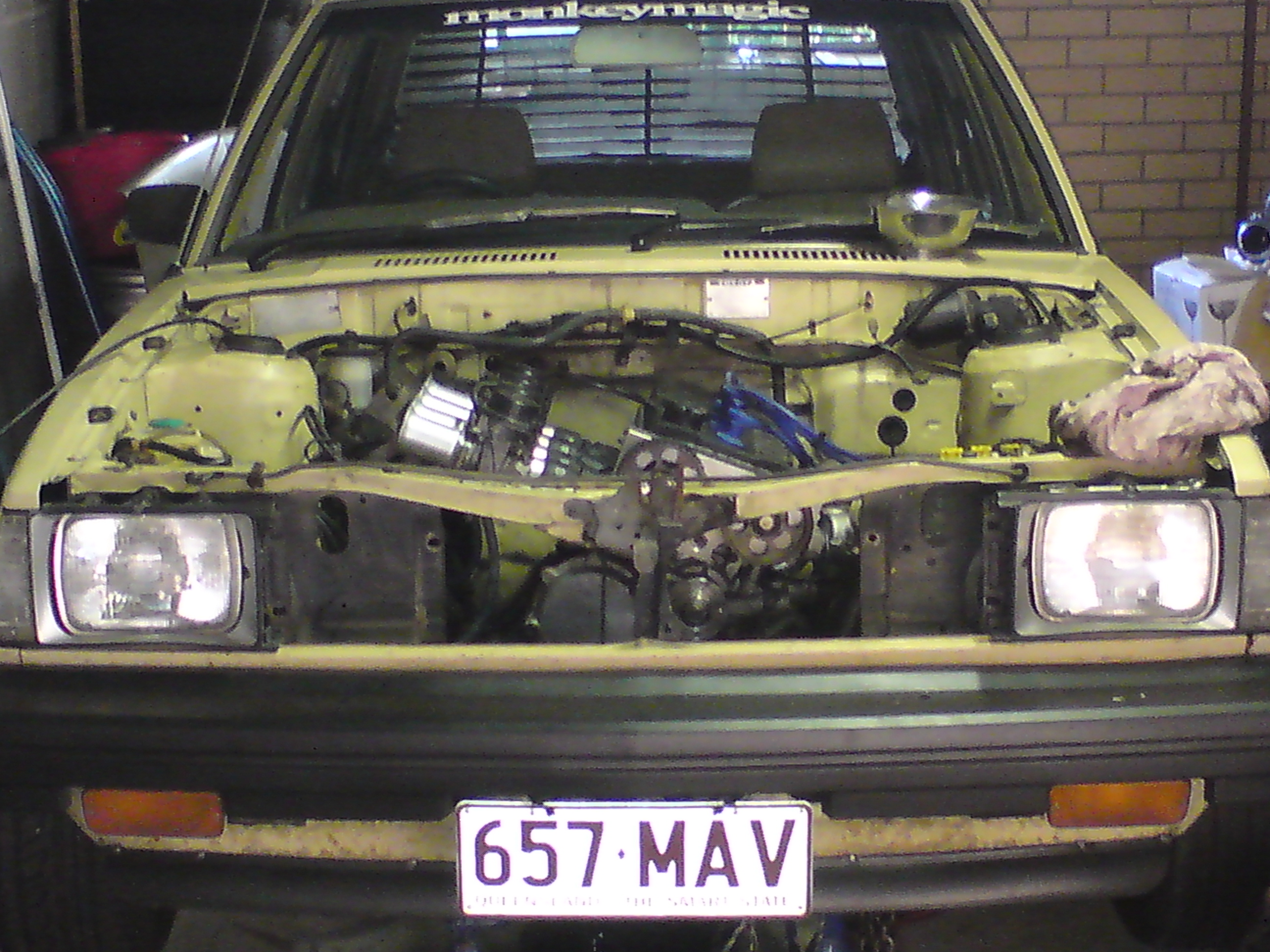

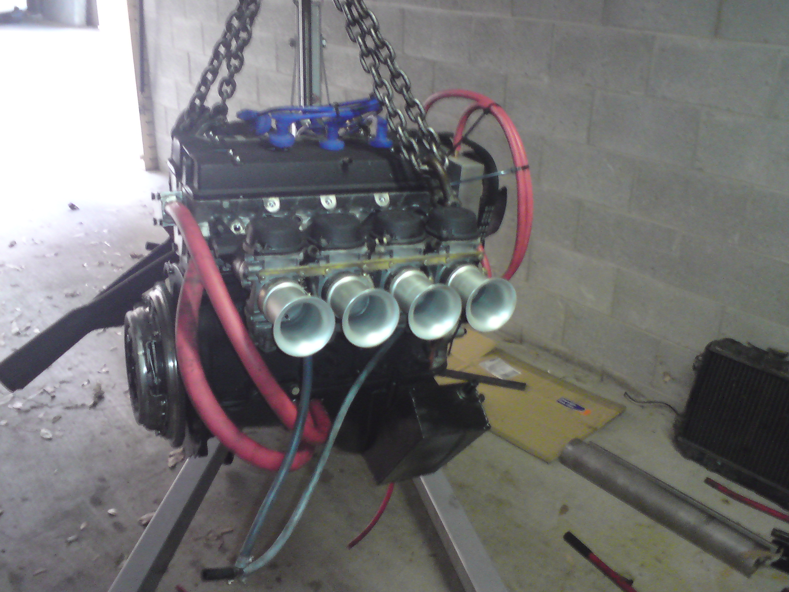

    each piston would need different relief locations, because the bore spacing on the head is different to the block. also if i did it again i would weld the sides of the combustion chambers and re-shape

extremely innovative. After all the work is it still a 1300cc? & how do you go about relocating a bore?
NB: it is a 1504cc.... :blush:

sure, but it will cost 10 grand and may take a few years.
but seriously, probably not it is a lot of effort, and i don't think anyone would be willing to pay what it would cost.

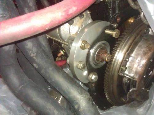

here is some more pics.
and i will get some decent footage when i get a chance.
