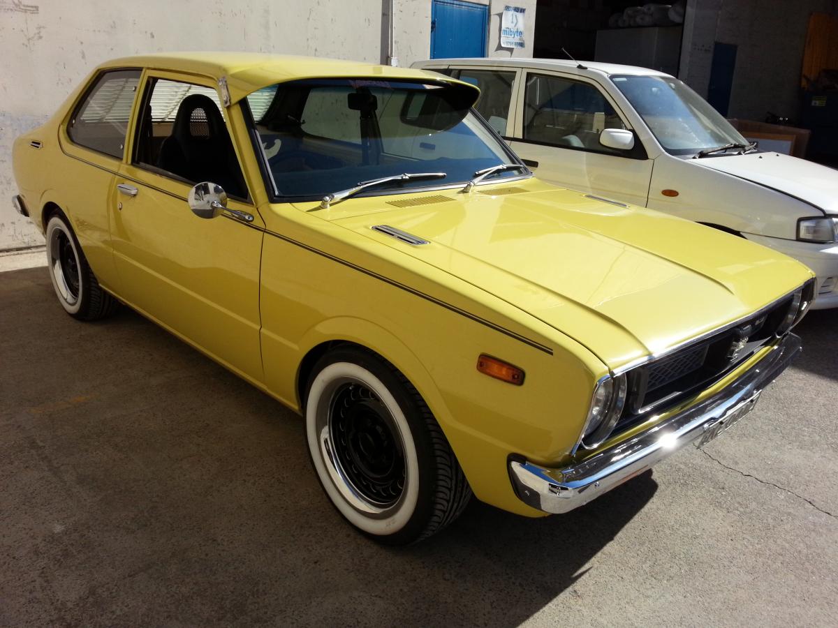

Hi mate i use dupont paint, its cob clear over base coat and i mixed a few silvers i had lying around and got that colour. Thete is a colour called fine alluminium which looks great for engine blocks etc.
Hi mate i use dupont paint, its cob clear over base coat and i mixed a few silvers i had lying around and got that colour. There is a colour called fine alluminium which looks great for engine blocks etc.

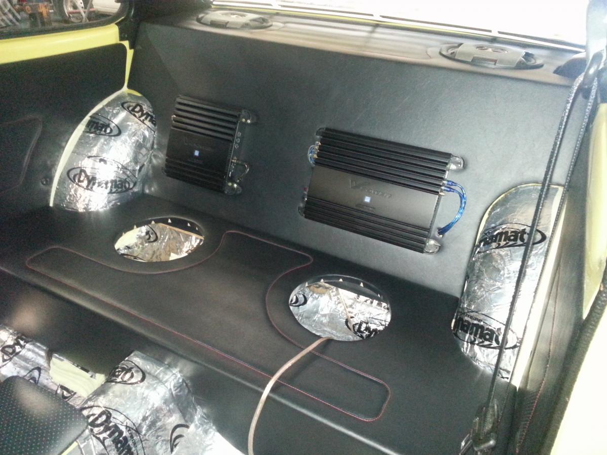

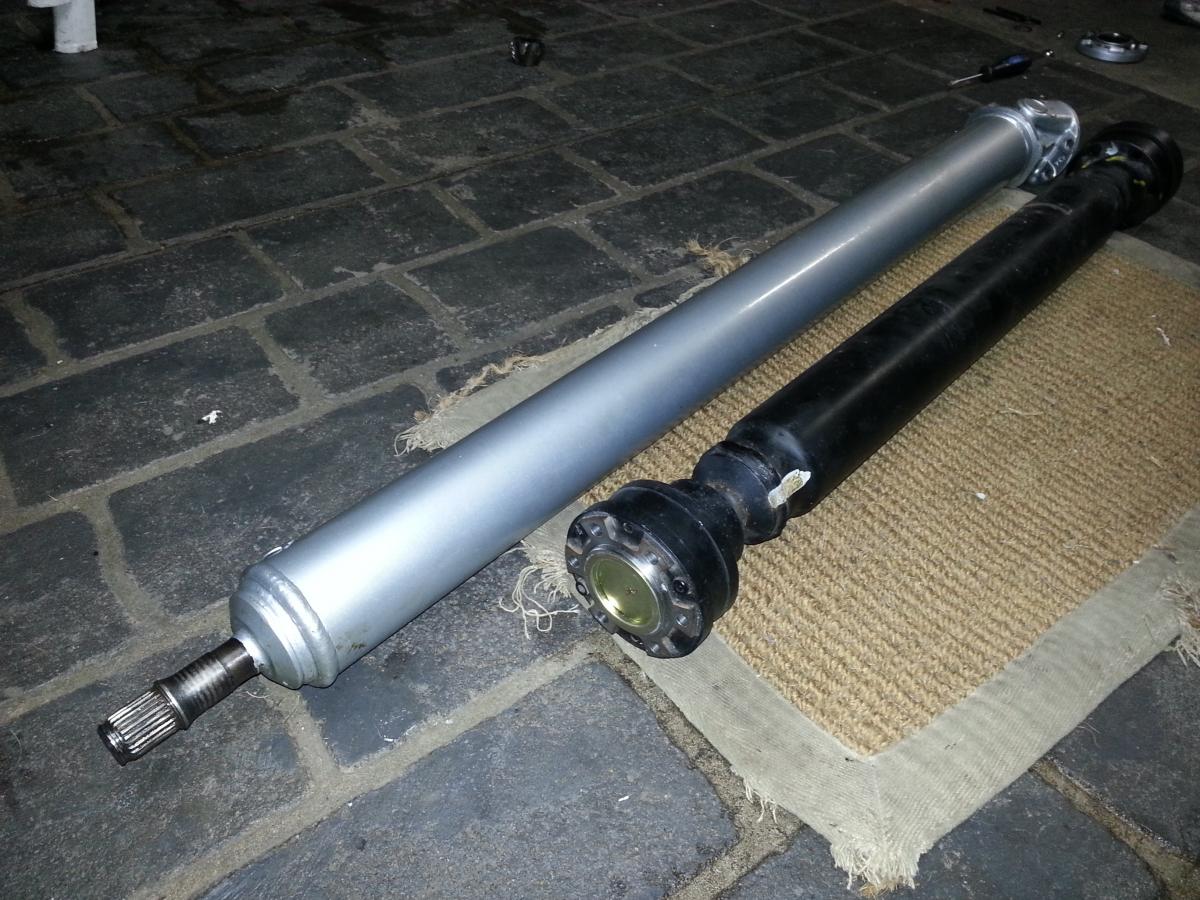

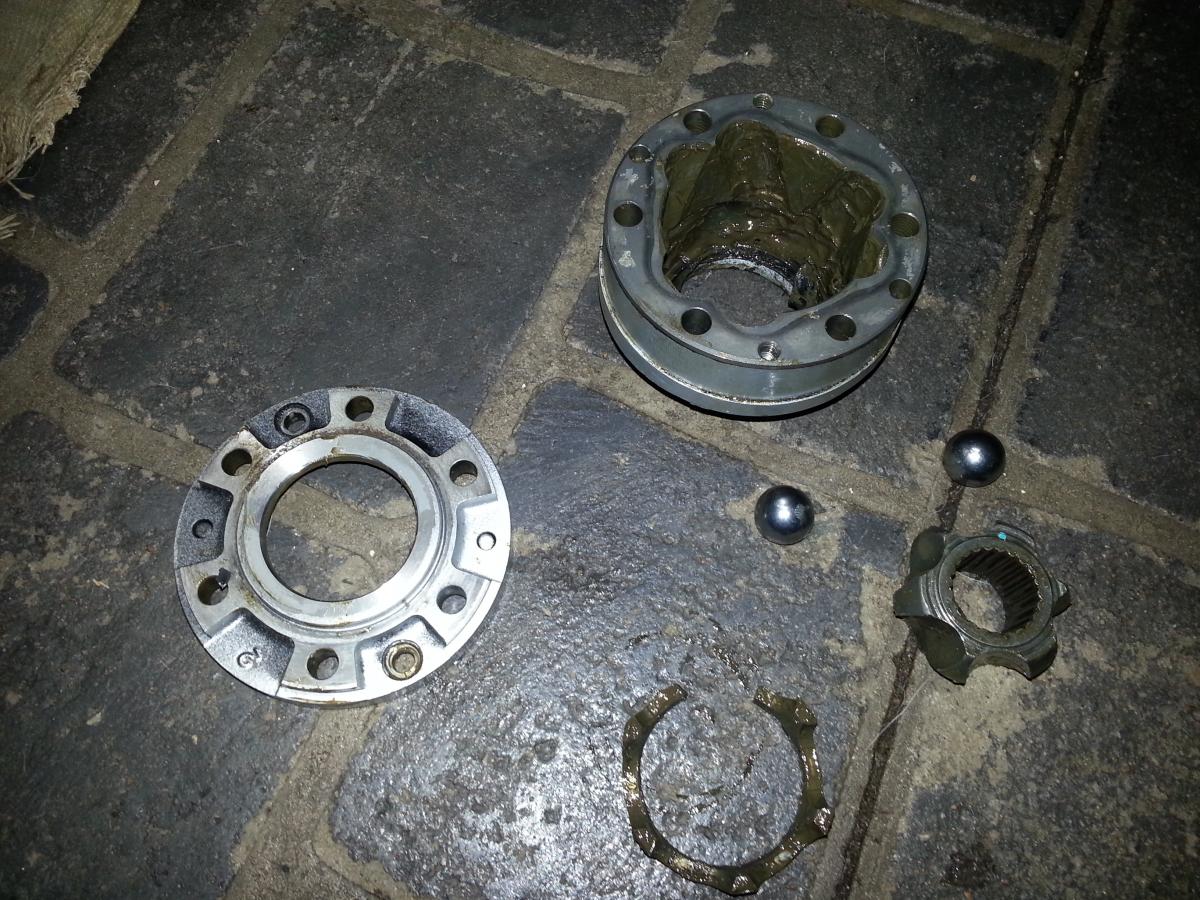

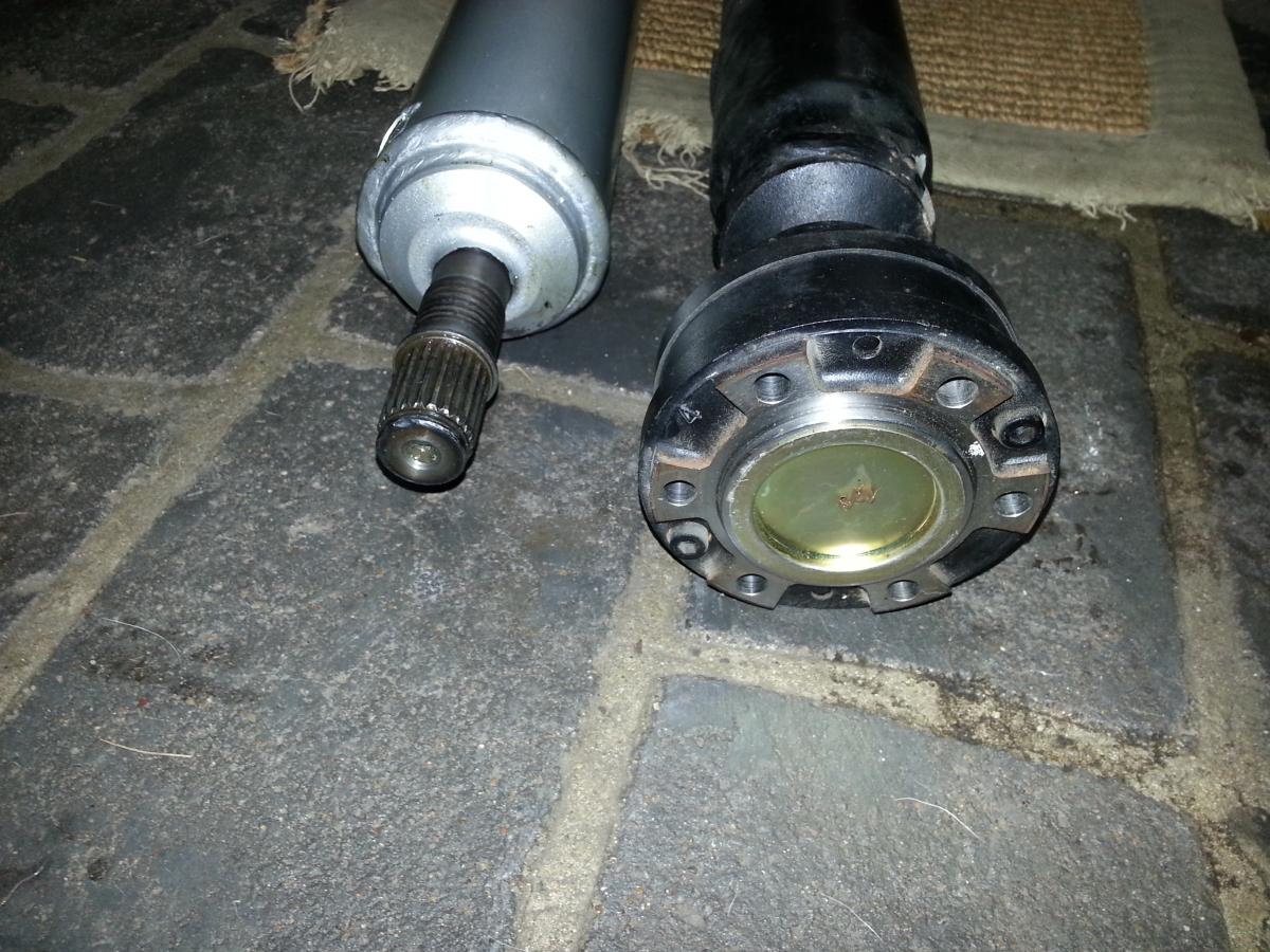

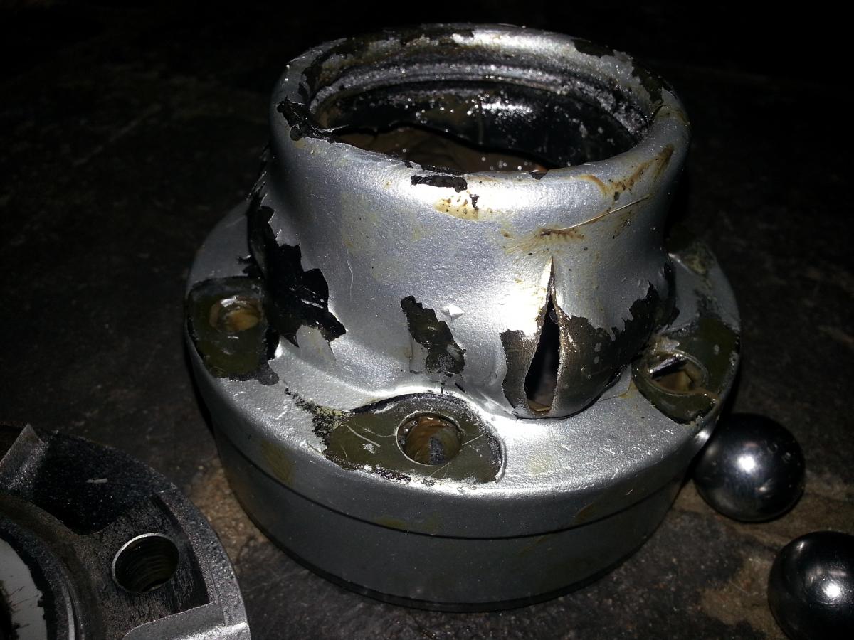

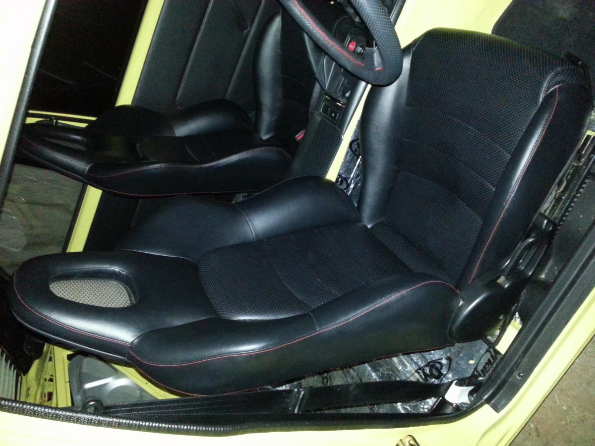

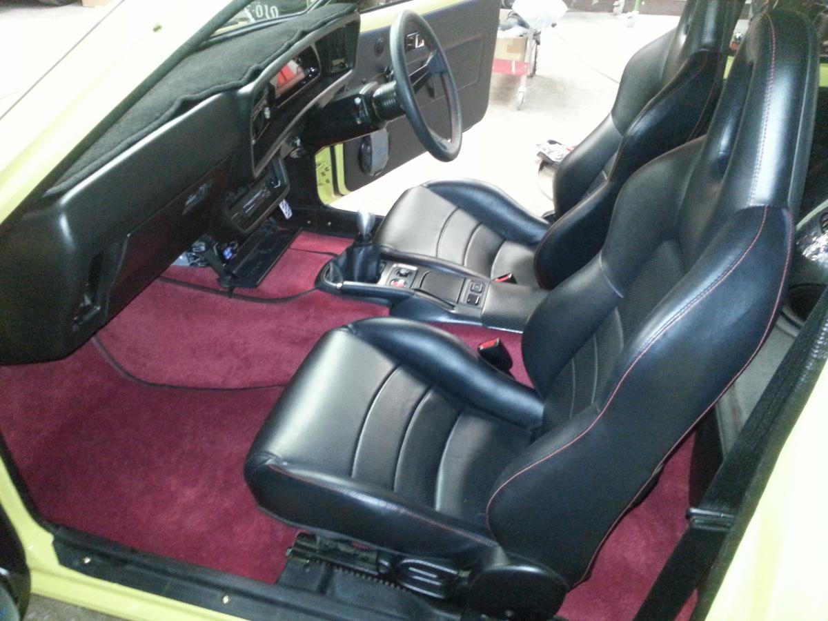

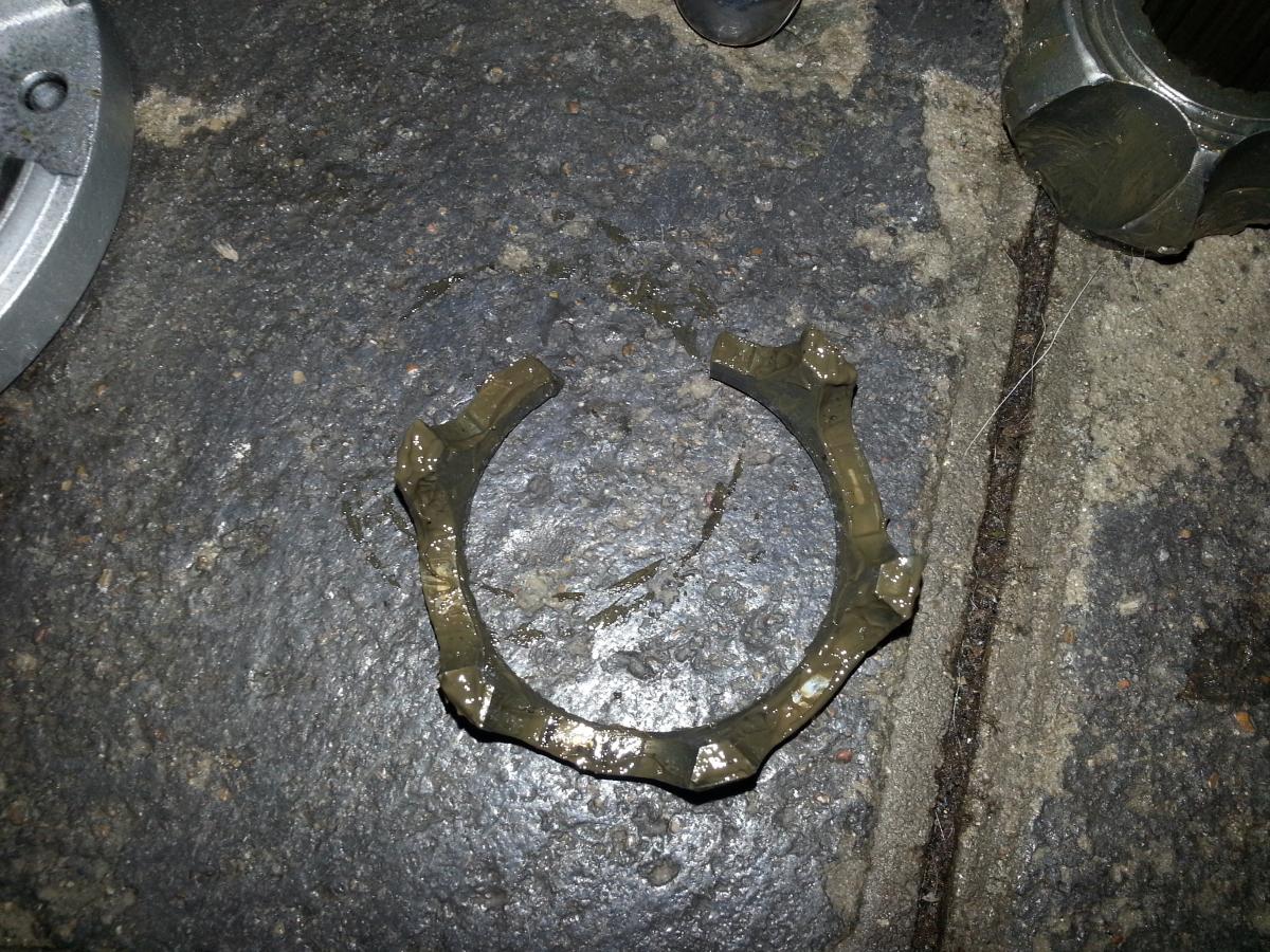

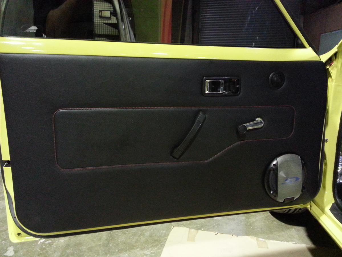

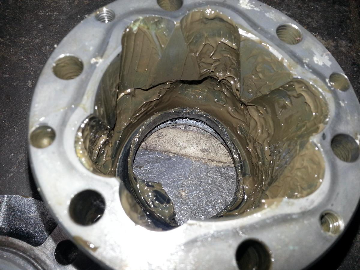

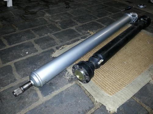

Hi guys, just thought id post an update on the rolla. Interior is nearly done just waiting on carpet now which should happen soon. finally put my sun visor on which gives daisy a more old skool look. managed to break the standard S2K tail shaft joint , luckaly it comes off easy and was an easy fix. looking into something stronger atm. they use uni joints in the states so might go that way. it took a 9000rpm flat change into second to brake the carrier bearing but its a weak link in the drive line in a standard s2k as the bearing cage brakes into pieaces and bearing try to exit the housing. check out pics ! enjoy.

well done pal. i thoroughly enjoy the choice of motor. and everything else for that matter. wouldn't change a thing, that's something i don't think i've ever said about a car !

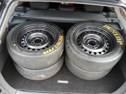

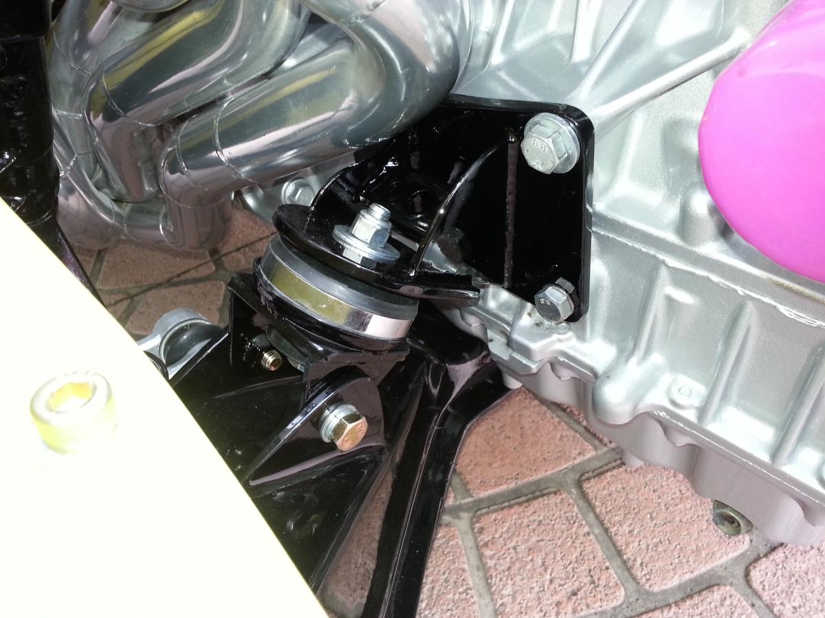

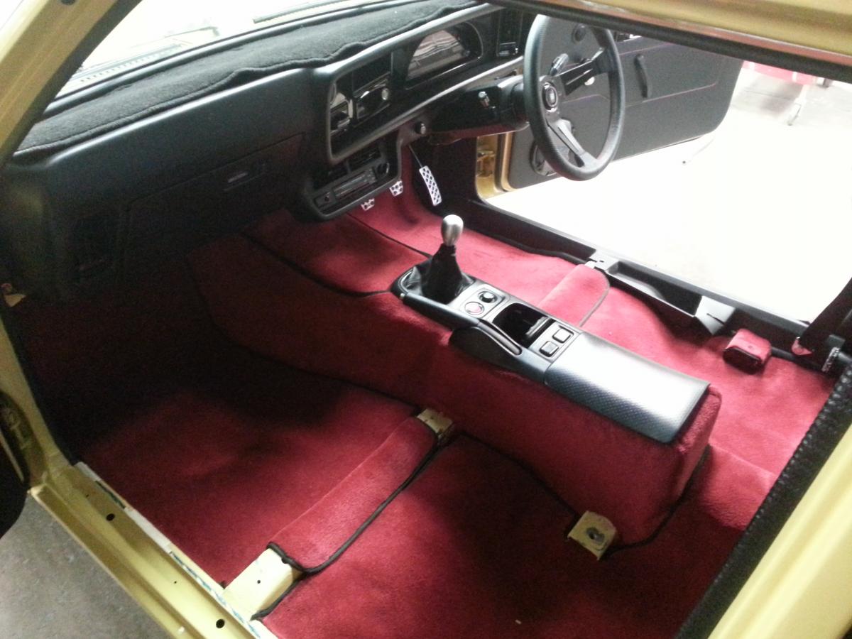

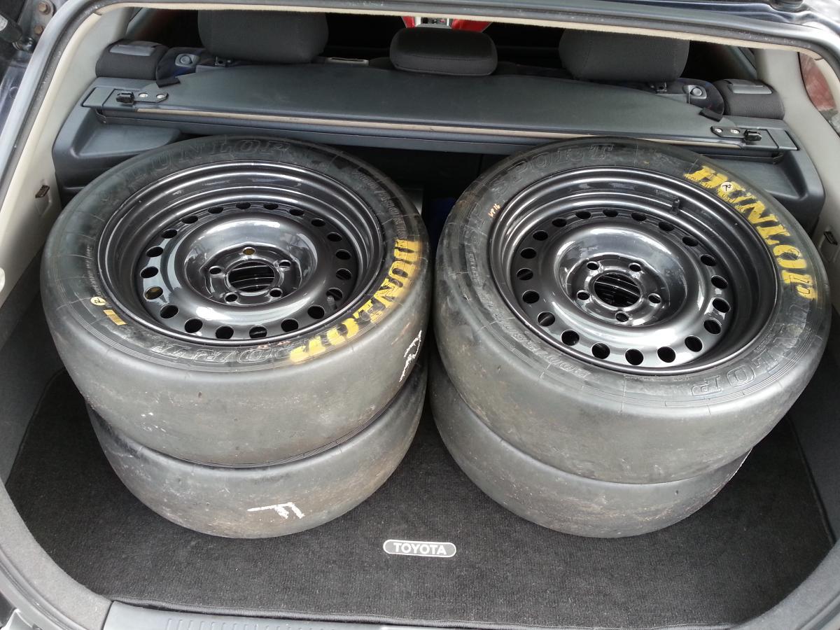

hi guys just a little update on the rolla, the interior is nearly all done. engine mounts have been re done as they were too solid for my likeing. Also painted up another set of chasers as my track rims on which ill put a set of Dunlop slicks that i scored of a mate. Next on the list is 4.11 diff gears and a detroit tru trac mechanical Lsd. enjoy !

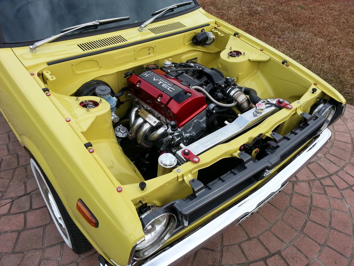

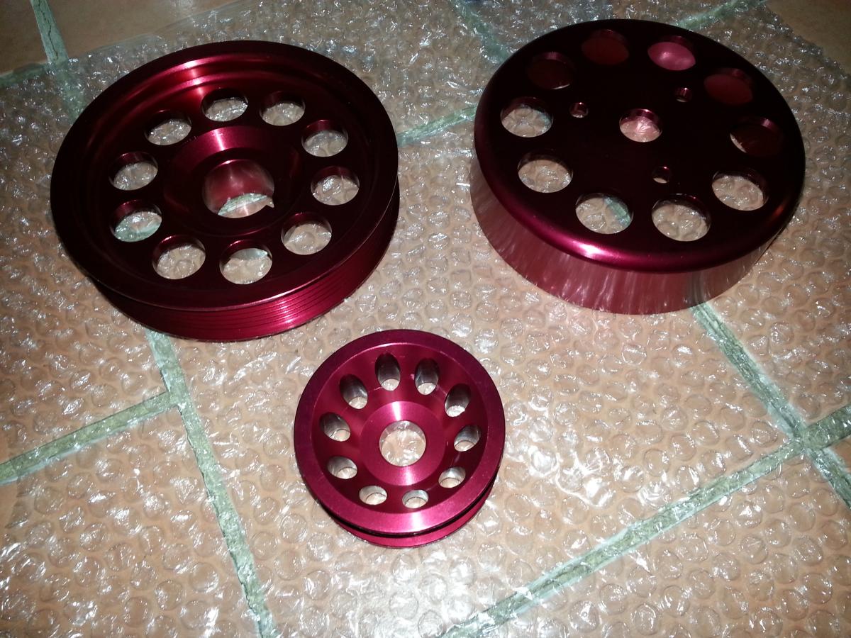

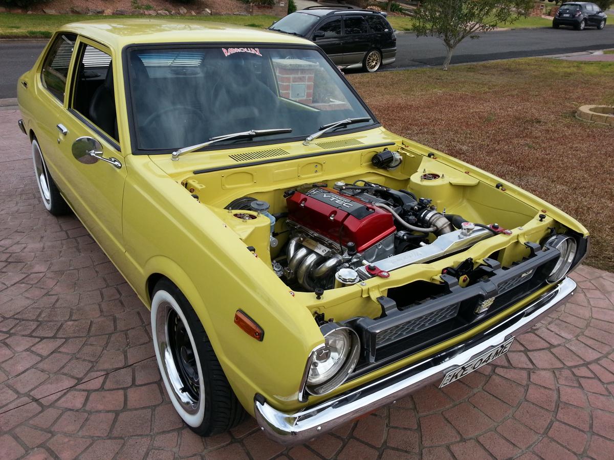

check out the cool custom painting of the rolla i got from the misses and the selfie present i got my self for bday. F20c pulley kit !
WOW Mick, The engine looks so clean and the car looks as though it was built with that engine in it from the factory.
