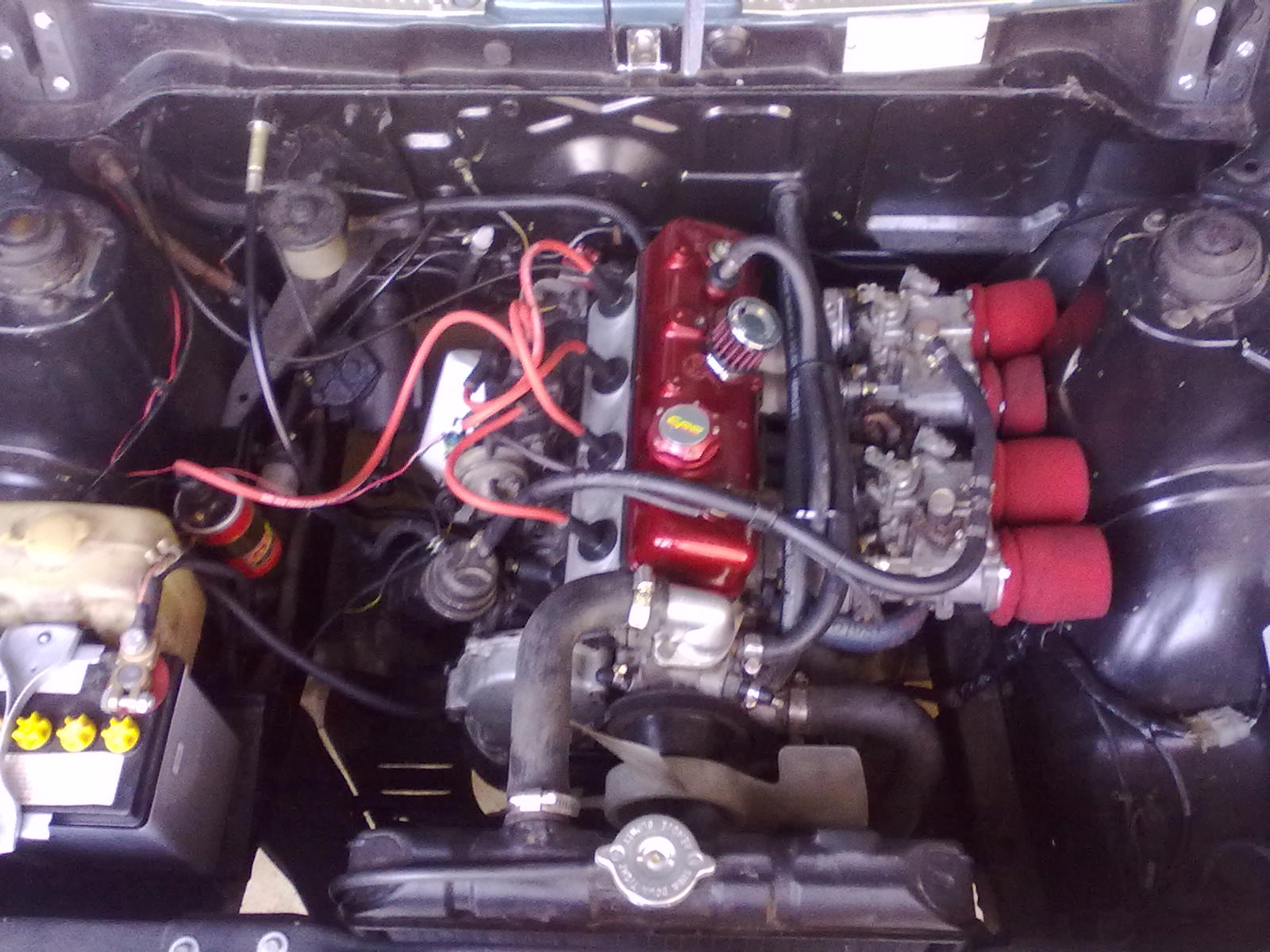

5k, cam, head job, sidedrafts, extractors, electronic ignition, exedy clutch, 5 speed in a ke20.

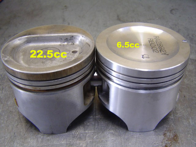

The shallow dish one here, also known as the round or 'O' dish. (deep one is 'D' dish)
