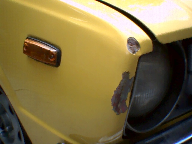

On Friday night after doing some shopping I found that someone had touch parked/smahed!! into my car, in the car park. The prick has obviously driven off and hasnt even left a note with his/her details. I suppose thats bloody typical of people these days though.

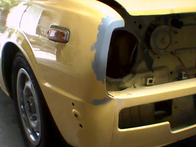

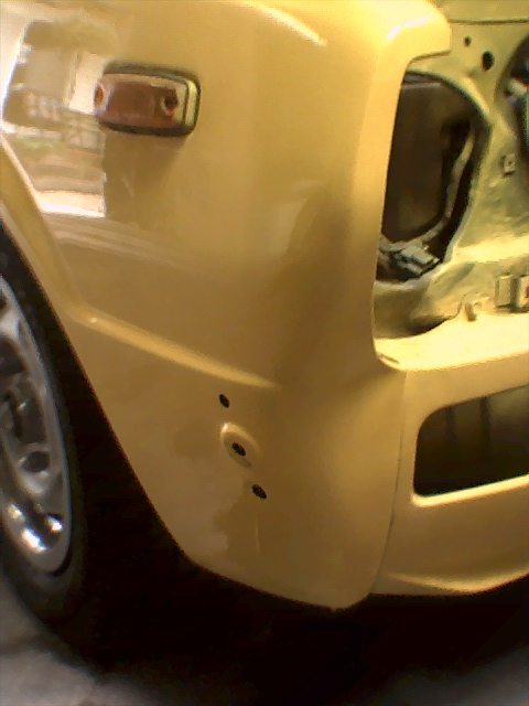

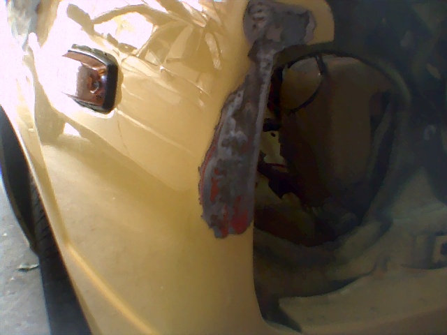

My car is my pride and joy, so Saturday I got started working on her. I hammered out the damage (the gaurd was dinted 10-15mm inwards), so it was a decent hit. My bumper was pushed back onto the gaurd, causing another dint to the front gaurd. The bumper has a few scratches and a small dint. So a few hours later it was bogged up, blocked back and in primer.

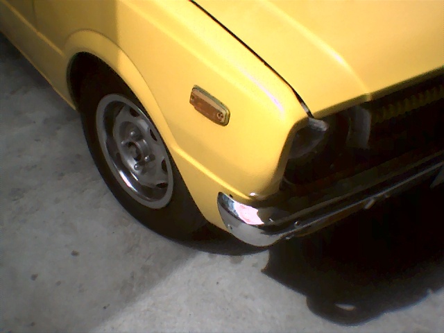

Sunday morning after letting the primer harden over night, I blocked it back and applied the top coat. So its all fixed now, and back as good as new.

Heres a few progress pics. My good camera is on loan, so heres a few lesser quality pics from my cheap camera.
I'll let the paint harden for a week or two, and then block it back and buff it.
