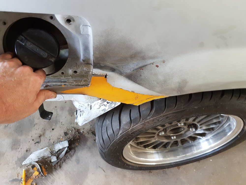

Got stuck into the rust in the ae86. I noticed it was coming through the panel under the roof layer so I drilled it out and got it out altogether to remove the rust as completely as possible. I also removed the rear 1/4 window trims and clips, and rubbed out the openings. I also rubbed around the windscreen, and rubbed down most of the rear 14 panels. I decided to bite the bullet and repair the fuel filler area completely. I cut out the old repair and the rusted bit of arch, but not until I used some paper to make a template, which I overlaid on a spare ke70 gaurd and cut the closest piece I could out of it. A bit of messing with a hammer and dolly and I had it looking pretty close.
Trying to go right over it, cutting sanding and fabricating all the issues away, before one final bout of welding to put it all back together. Then rub down the interior and paint it. Then finish prepping outside then Ill probably end up painting that too to make it last once its repaired.

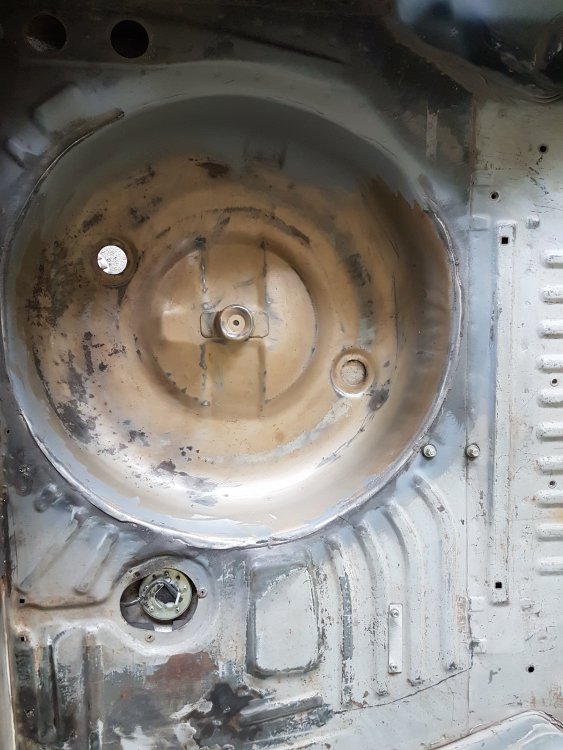

Spent quite a few hours over the weekend rubbing it down inside and out. Couple mates rolled by on Saturday and helped me gett he doors in a far better spot, got it aligned nice. Then removed mirrors, trims, and mouldings from the doors and rubbed em over as well. I have a couple small rust holes in the boot floor but it doesnt go through to the outer body, so I can just section it out and plate over. Will have to drop the fuel tank soon, and then maybe paint around it under the car too as its had a lot of work in the rear.
Looking to go over the whole thing, rubbing it down and looking for trouble spots, then once identified and rust sectioned out, fabricate all the patch pieces, and don't even think about welding until I can do it all in one session. I have the metal shop down the road folding me up some 1.6 steel I can use to repair the front windshield rot.
One of the least enjoyable things, someone has removed the sound deadening fromt he floor and firewall, but only about 92 percent of it, the rest is still there hiding under the undercoat they splashed over it, so to clean the floor up its been a combination of scraping, sanding and solvent. Its coming along though, Ive done the boot, its just the front passenger wells to sort now, and they seemed to be done more thoroughly. There are so many screw holes that need welding up. Whoever made this a race car just self tappered absolutely everything in, so if you ever raced it everything would have just rattled apart.

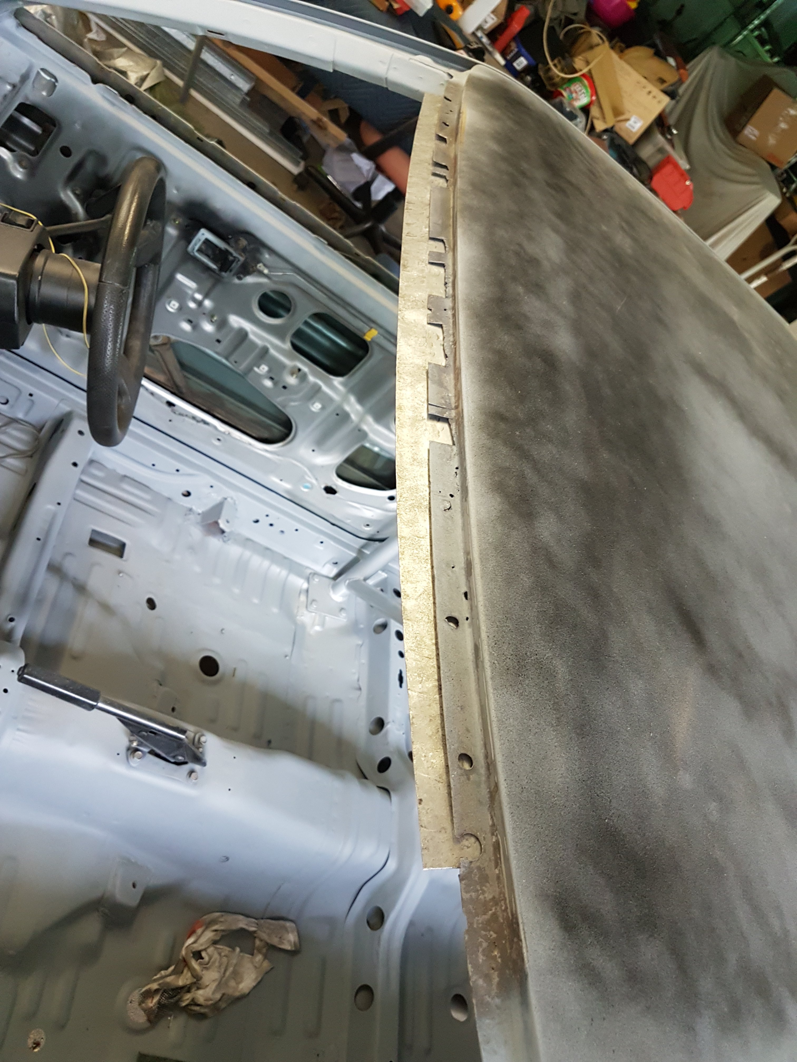

Have now done 1 stage of prep on the glass hatch. Since I want it to look like metal when done I will have to have a fine go over it with the lightweight filler and take out the small imperfections. I already did one broad fill from hinge to hinge to smooth out some overlapped fibre layers in the piece.
Looks a lot nicer with primer.

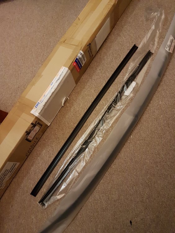

Also got this in the post from the motherland. A new top screen trim with the clips I needed, and the rubber seals for the sides.
